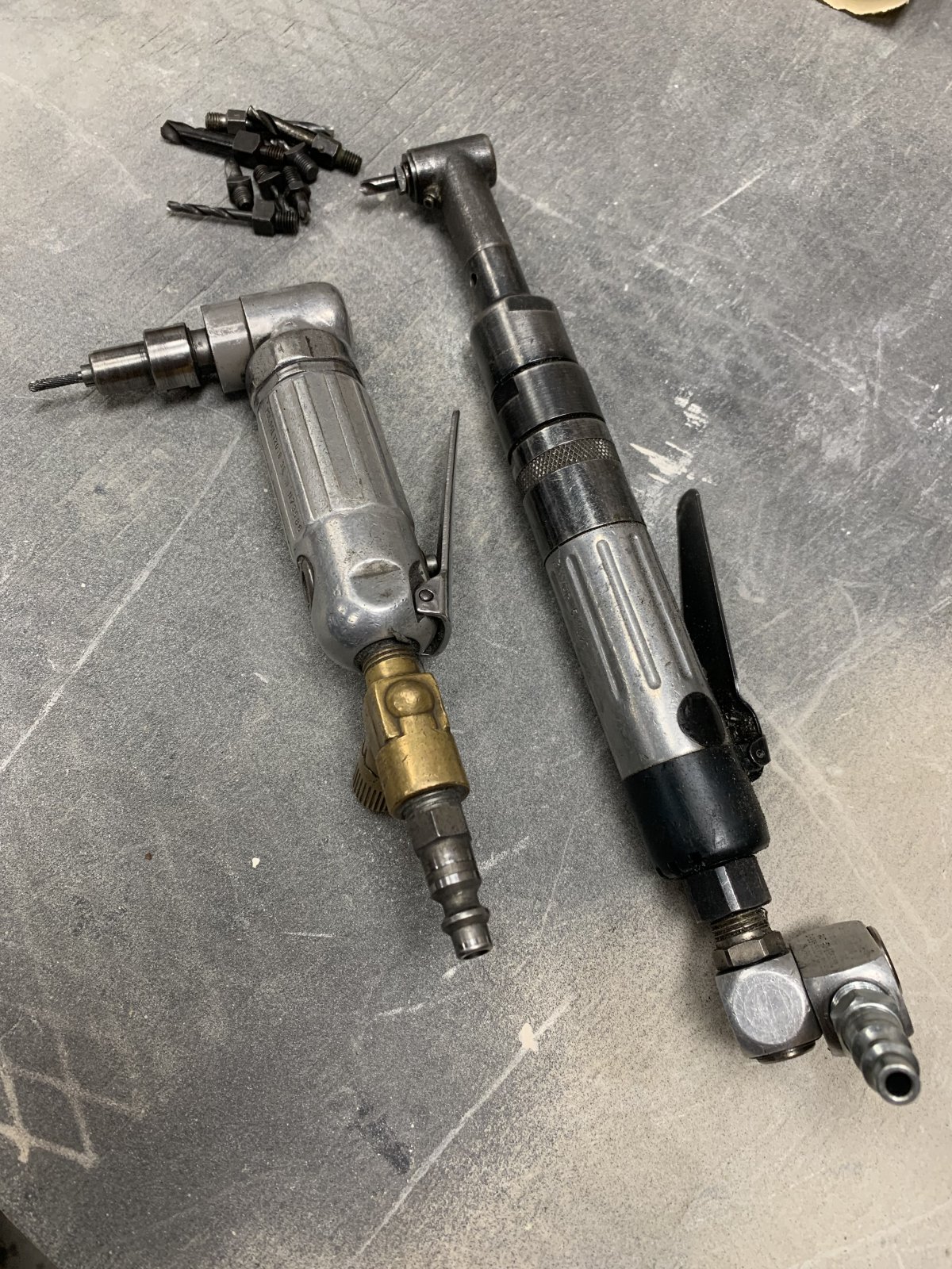

    IMG_0545.jpeg I've done a bunch of these fixes on aircraft over the years. I've gotten pretty good at running a 90 degree die grinder with a mirror. One thing that helps a bunch is if you can use a round tip 1/8" rotary file to create a dimple as close to center as you can, your drill bit will tend to stay on course. Next step, I don't expect you'll run out and buy a 90 degree aviation drill and threaded bits, but they do allow access in some very tight spaces. I have run drill bits in die grinder collets in a pinch, but the speed kills the bits. Good luck!
