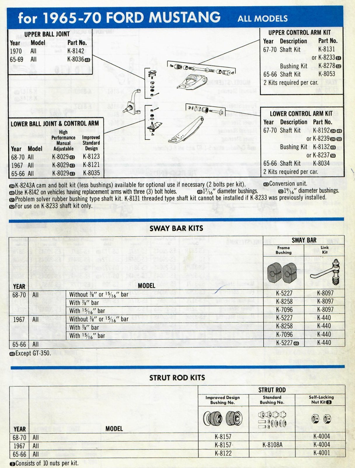

    Note that says "all models".
    There is NOT a suspension distinction between 6-cylinder and V8.
    Only the spindles/brakes/steering are different.
