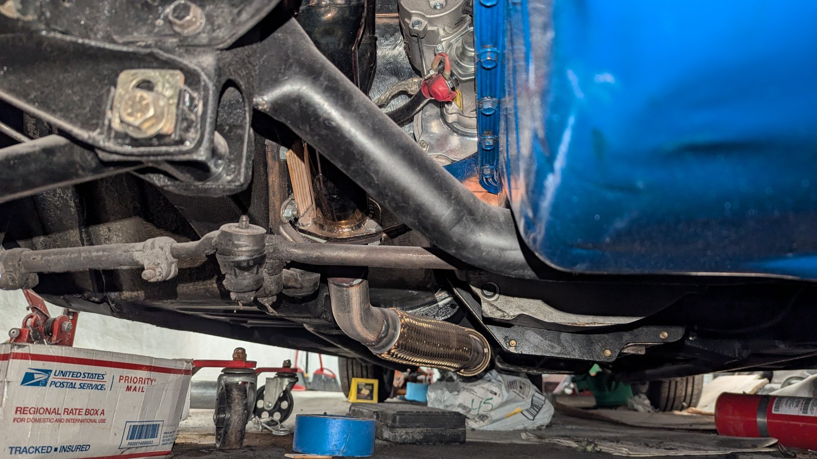

    Still right where Mark's dad put it, in 1960. PXL_20240725_031017294.RAW-01.COVER.jpg

  5. The mystery deepens.... I wonder if this was something only done at the San Jose plant? You can occasionally run into differences on Ford products depending on which plant it was built at. Although for me, I find it extremely interesting that virtually none of the cars I've seen had one even though I live on the west coast. Surely at least a few of the cars I saw originated out of San Jose. I'm ***uming this was a bolt-on part, not welded in.
    The other anomaly I spotted in your pic is the lower control arm pivot. It appears to be set up as an eccentric to adjust camber (a feature I know the later cars used) with the capture plate shown with the square washer in it. None of my cars had that ('64-65), camber was done old school with shims at the upper arm. This was reflected in the factory service manual also. Ford recommended defeating this for track use on the later models because the eccentric could move under hard usage.
    And @MOONRNR , I did read the two threads you linked to. Both were by owners lamenting the lack of a factory lower crossmember and were looking for a solution, available in the aftermarket. One guy showed a supposedly factory crossmember, but mentioned it required mods for use (six crossmember in a V8 application).

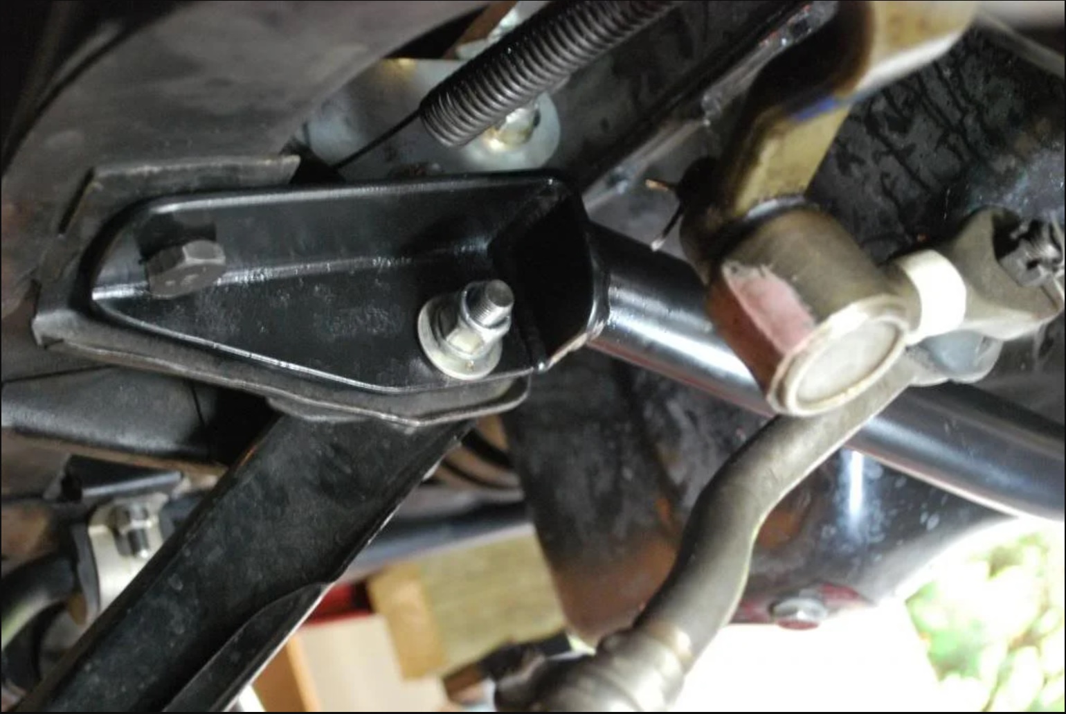

    On later cars the crossmember bolted to the frame rail behind the lower control arm. When the Mustangs went Trans-Am racing, the suspension mount flexed so they added an angle to to the crossmember mount for better support of the LCA.
    Mustangs and Fairlanes that had FE power added a reinforcement to the upper control arm mount.
