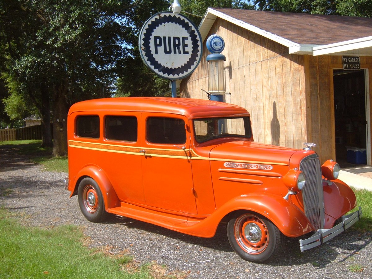

    pic of the suburban.

  24. That is a REALLY good looking truck! I think you can pick up a couple MPG but not 6. That visor is like a giant air brake on front. My experience with my old 54 Chevy sedan with a 350 was 18-20. Our 76 Blazer with a 350 ran its whole life, loaded or not and got 14mpg.
