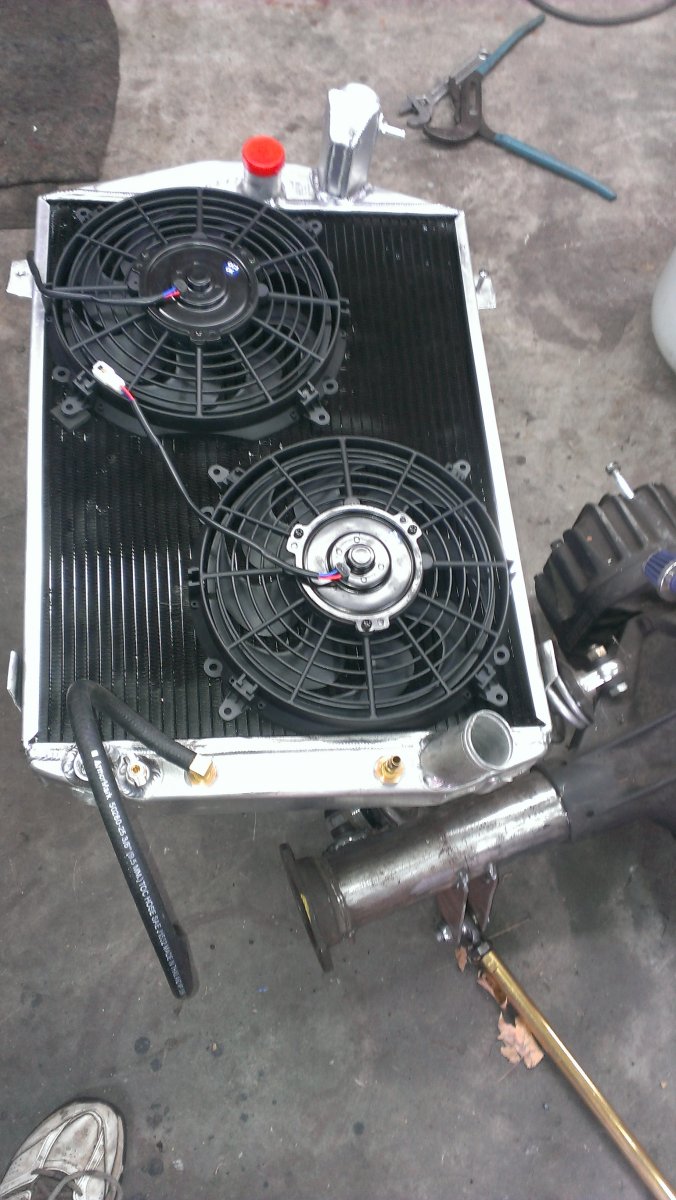

    on this 32 Ford radiator I used in my Jaguar I used two 10" fans to avoid the water pump. $20 each from Skip White Performance IMAG2716.jpg

    You can buy those controllers in the aftermarket.
    No need to fault a fan for faulty installation.
