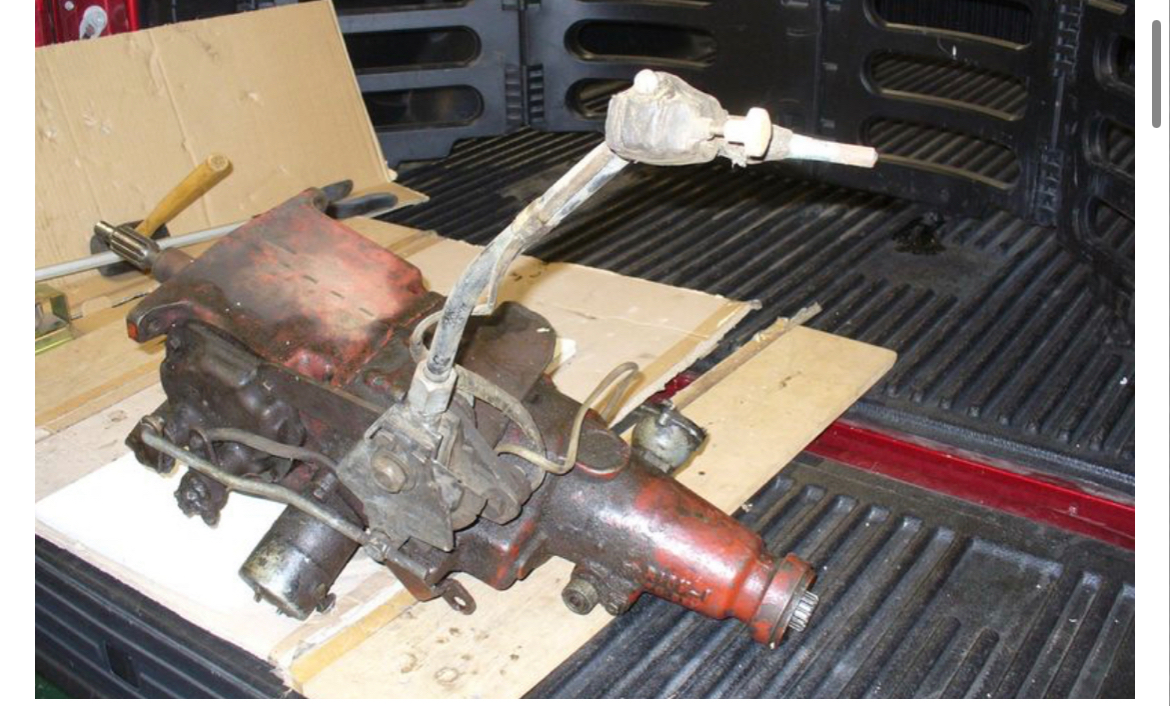

  21. You know a three speed with od from a trip five Chevy essentially goes for scrap weight these days. I imagine it could be made to work with original column shift. I mean I sold one of those transmissions for $65 a couple years ago
  22. Got any more of em?:)
    Paid a little more for this one
    Suposed to be picking up a Saginaw OD tail shaft set up tomorrow
    Plus some other odds and ends
    Toms Dogs likes this.
  23. Guy I sold it to would probably sell it lol. I see them fairly regular on marketplace
    anthony myrick likes this.
  24. Basically on the one that I sold I technically sold it for the guy that gave me my 283. He offered to give it to me but seeing as I foresaw no use for it myself I declined and helped him sell it. He actually told me to sell it for $100 and keep $35 of it. But seeing as the guy that bought it not only went to check out a 55 Pontiac rear end but also went ahead and bought it for me to reimburse him on after hearing I wanted it and then delivered it for $5 in gas I just sold it for the 65 bucks the owner wanted for the trans. Only had 45k on it lol

    Yea those were affordable back when. Don’t see any more now. They seem cool. Easy to use on the colum - the levers essentially need to be hooked up yo the matching levers on the trans. In theory I can run a 5 speed from
    The column. But less shifting is nice.
    as understand it, just drive it like a 3 speed, the off the gas and back on drops it to OD. I’d love that. Perfect for what I’m trying to do but again, hard to find

    To help out, here’s the BW manual. It explains the wiring, and most of what you’d need for a rebuild. A number of folks here can explain how to use a modern (cheaper) relay with an inline fuse, and a simple on off switch instead of the floor/throttle pedal kick down switch. If you find a take out with all the electrical stuff, use it. They worked really well once you understood them.
    http://www.oldwillysforum.com/forum/TechData/BWOverdriveManual.pdf

    Read that thanks! I was under the impression it can be set up to automatically go into overdrive and back out. Hopefully that’s the case.
    If I snag one from a 1955-6-7 car, I assume it will use the same bell housing as the 1956 engine I have with a 3 speed on it. If not I am sure I can find a bell. But does a bell with a v8 pattern exist in case I want to run it with a 230-250-292? Been years since I’ve been in the weeds of cross referencing and cobbling bells
