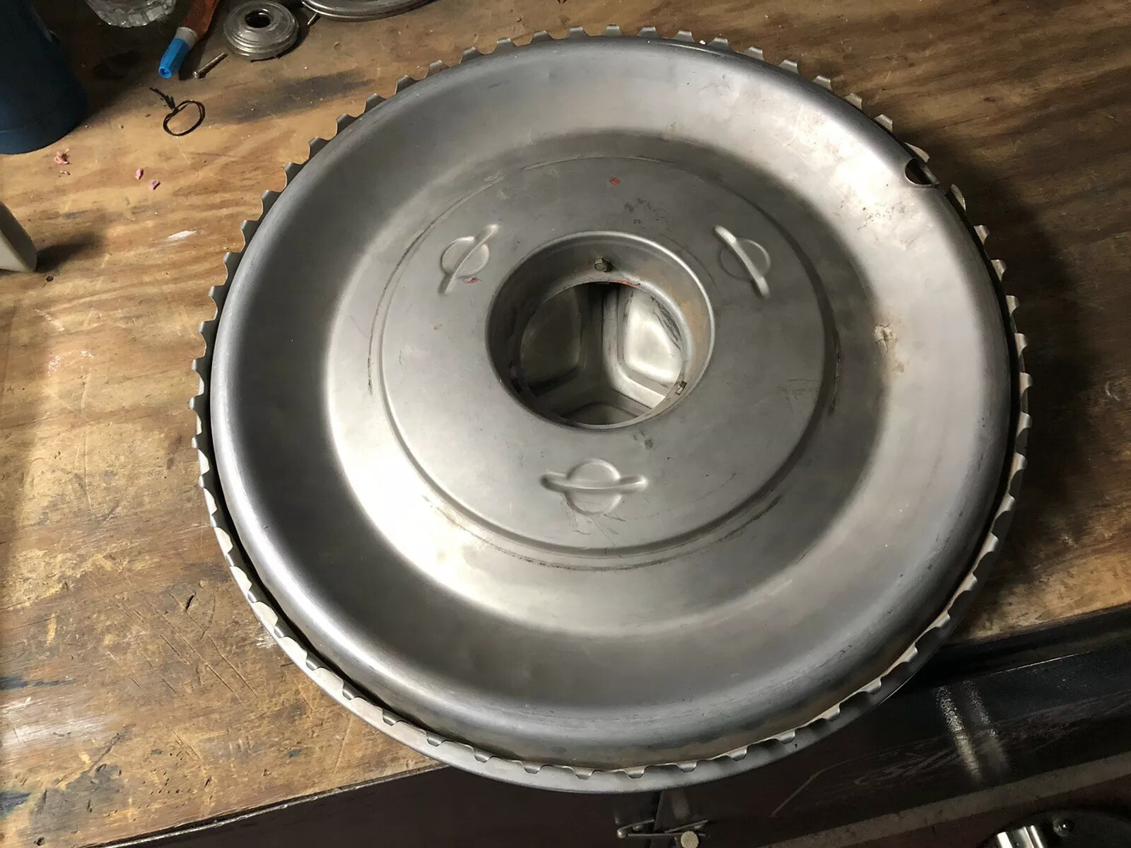

So I called a popular wheel company today to order some 15’s for a A Roadster project I’m about to start and they couldn’t tell me for sure that a 56’ Olds wheel cover would fit on anything they sold. In the past I ran 16’s all 40’ Ford stuff and now I just purchased $1,000 worth of bias tires for 15” wheels wanting to run wheel covers. My questions are: what early Ford bolt pattern 15” wheels should I look for? Tires purchased are Firestone 820’s and 560’s. Rear axle is banjo front brakes are Lincoln. Did I **** up yet? Thanks for any input Sent from my iPhone using H.A.M.B.

It’s these damn Olds Caps I got that I really fell in love with that started this idea otherwise I wouldn’t have even thought about trying this. It’s going to be a 50’s cruiser looking thing. Sent from my iPhone using H.A.M.B.

the biggest issue with running the Olds hubcaps on an early ford is the interference at the castle nut on the end of the rear axle. you need to make sure there is enough offset on the wheel so the nut doesn't hit inside the hubcap. Simply put a hubcap on a wheel and measure thru the center hole to the cap, then measure how far the nut sticks out from the face of the drum
How do the Olds caps attach? Do they have the multi-spring-angle or like 56 Chevs that fit on the 3-4 bumps. You need outer rims the same as the Olds if they are special or only a few years.
Star fire caps should fit. If yours are fiestas, they have a deep dish that interferes with the center of some wheels. Been there...
