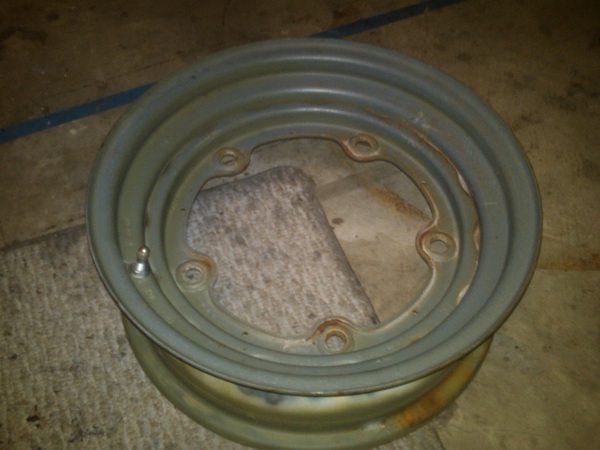

    What did this 15" wide five come off of? Its a Ford Kelsey Hayes wheel....if I remember right I wanna say it measured out to 5'' wide. The windows are almost non-existint in these compared to the 16" and 18"....looks different, but great with the hubcap. Just looking for more info on them. Not sure if Im gonna keep them (have 2)....and I havent seen anyone selling any like them...(hate to ask next part)...what are they worth?

  2. It was popular in the sixties to make 15" wheels out of 16" wheels. You could not buy 16" whitewalls and for some reason 16" tires were hard to find. I am kind of guessing but I think this wheel was modified to 15". This would explain the smaller openings by the rim.
    IT WAS MORE POPULAR WITH OLD CHEVY 16" THAN IT WAS WITH OLD FORDS. YOU COULD BUY 15" WHEELS THAT WOULD BOLT ON OLD FORDS BOLT PATTERN BUT NOT FOR 39 AND 38 CHEVYS.

    It a modified 16" wheel. Center turned down and new 15" rim welded on.

    That may be an old Stock Car racing wheel.

    They have ford script....im thinking they were cut down like the consensus is saying.
    Did they do this modification in the 50's at all? Is this mod desirable for someone building a '60's era rod?

    thease wheels came off a 36-39 ford. the center section was turned down and welded on to later 15 inch wheels. They will fit my car.

    The ones oldskoolflyer has are 5x10" bolt patern. 36-39 ford center section. If he had 4 of them I would like to have them. I am looking for 1 of the 5 on 5x10" 16 inch for a spare tire.

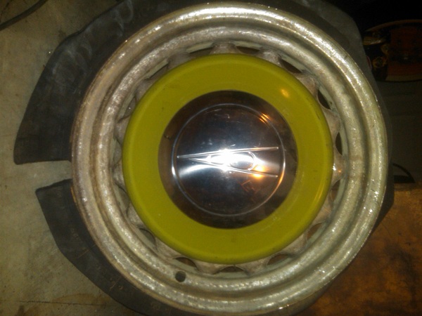

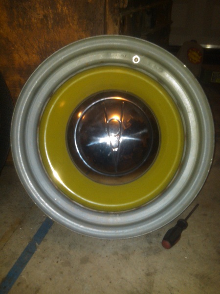

    here are some pics with hubcaps in comparison to 16''....cap and wheel colors are what they were when acquired
