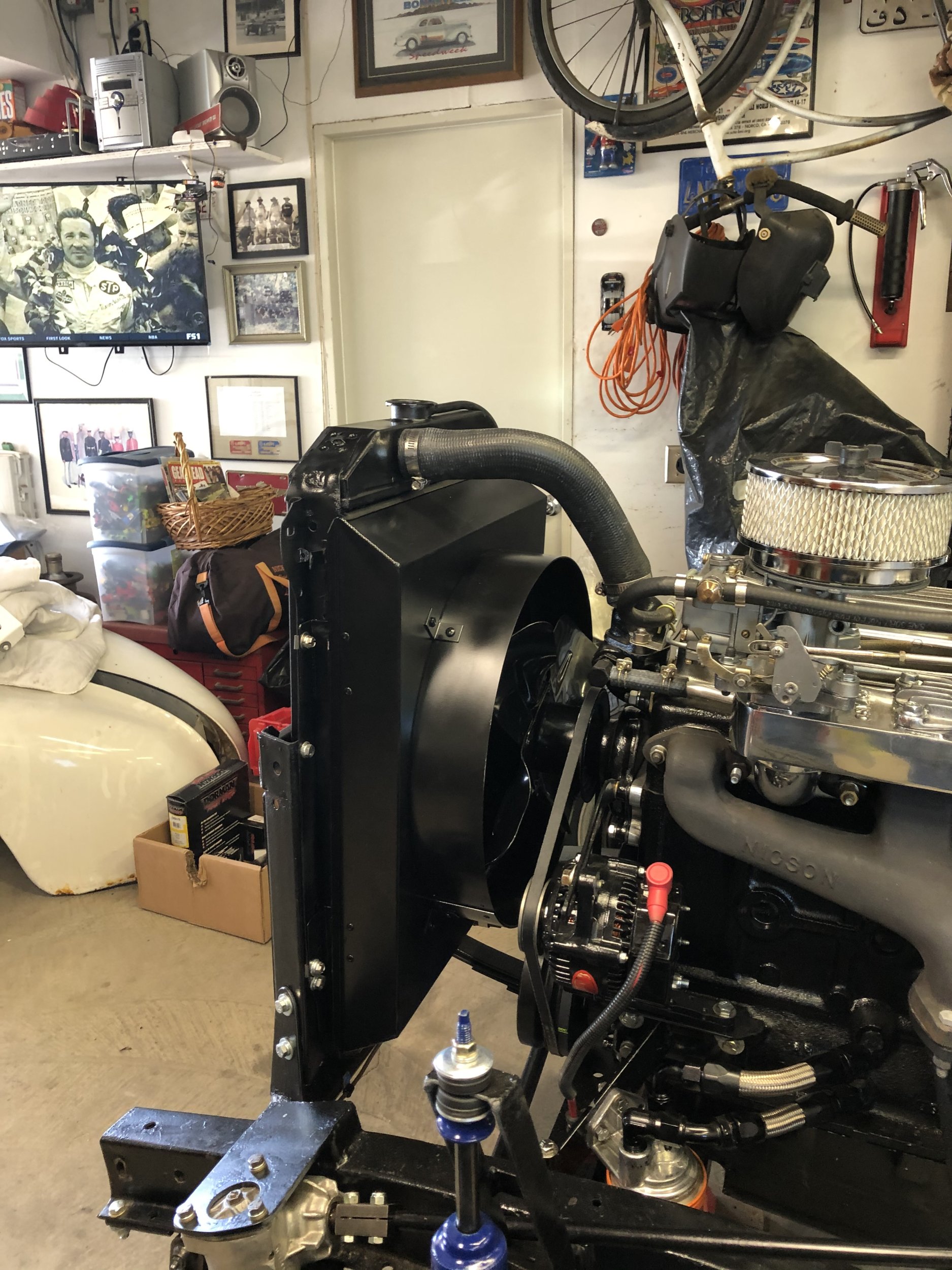

    A 50 Pontiac should have a lot of room to use a stock 4, 5, or 6 blade mechanical fan with shroud. Our 73 Monte Carlo had at least a 10 inch wide shroud. You can buy an aluminum kit from Speedway for your core size and then attach the included aluminum for the “tube” I’ve even added more for our circle track engine. Photo is of a kit mounted vertical on a 40 Chevrolet and painted BBQ black. IMG_2895.jpeg

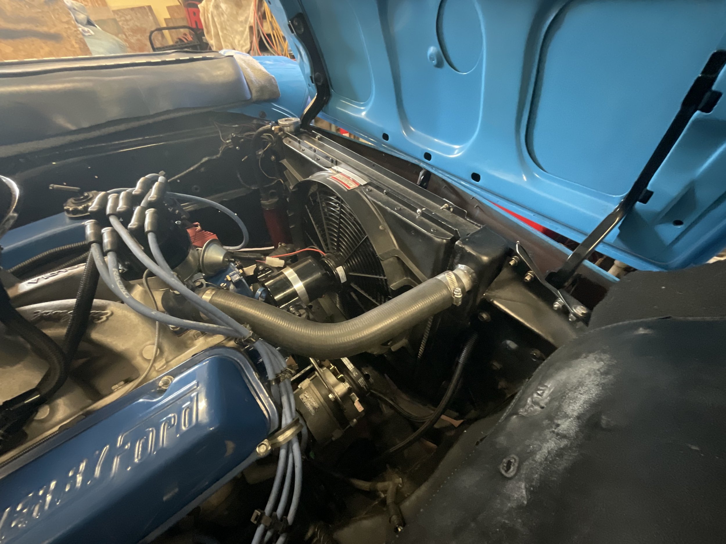

    Is just had my first test using a 16” Flex-A-lite, Flex Wave puller fan. 3000 cfm, they claim. Bracket racing on the weekend I could keep the temp at 160 easily. It’s cooling a big block Ford 502 cid with a fairly healthy cam. So far so good. IMG_1376.jpeg
