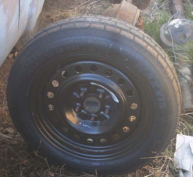

    I picked up this wheel for a spare and I thought somebody might need these for older cars, its a 16, 5 inch wide with the 5 on 4-1/2 bolt pattern. as you can see its sitting on a 8 inch axle. these are found as a spare on 94 and up mustangs, also newer crown vic highway patrol/police cars come with wide steel 16's about 7 inch I think. just dropping a line on what I noticed out there.

    Any idea what the backspacing is?
    And is the backspacing the same on the wider wheels?

    I'll try to get the info on the wider ones next time I work on a chp car, the 5's are a little bit over 3 inch backspace.

    the crown vic ones are 7 inch wide with a regular rear wheel drive backspace. although I believe they changed the backspace for 2003 and up, the track looks wider and the the backspace looks deeper on these.
    I also found the spare for 94 and up cobra mustang is a 17 inch steel that is smooth not with the holes like these above, hope this helps somebody find wheels out there.

    Ford Australia produce a 6x16" steelie for utilities, and taxis i think, same row of holes as that space saver above.
