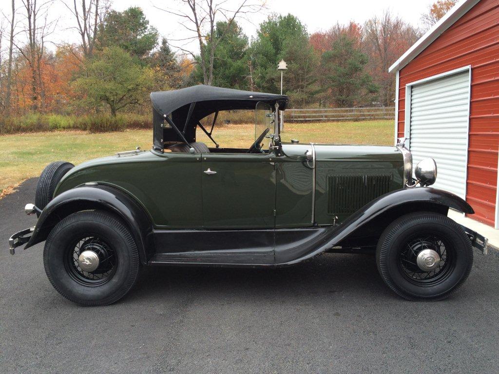

    Roadster1.jpg 6.00-16 front 7.50-16 in back.
    John Heckman and CTAV8 like this.

    So you got the 750's on the 4" rims O.K. I was thinking they would be too big but they look fine on your car. Thanks for the pic.
