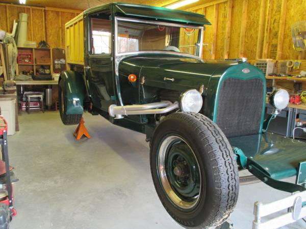

  15. orangeamcs
    Joined: Jun 23, 2007
    Posts: 609
    orangeamcs
    Frame leaning on car is a triumph. Most likely a 63-70 frame that's been hard tailed. If that's part of your dream too, your screwed. Sell it...pick one or the other. One project at a time

    Model A running gear for a daily driver? Not the way I'd go. How many days or weeks does one have to wait to get delivery of a replacement part for a model A engine? Compare that with parts for a SBC that are available at every parts store in every city. There are plenty of 305 v8's out there that can be had dirt cheap. 180hp or so in a roadster is very manageable.
    Remember, he said this will be a daily driver, not a weekend toy. So it needs to be reliable, and readily repairable, right?

    Another Model 'A: in progress, powered by a SBC 4.3L V6 - definitely not a daily driver!
