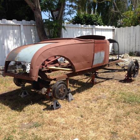

    The body is from an ex drag car from the Bay Area. When I get home I'll take
    More photos of the cage and the interior because it's really well done. It's different. There are ribs going down the body all along the interior.

    These are the ribs I was talking about. They make me feel somewhat safer but I'm still riding in a damn soda can!

    Here are the ribs in the body. Anyone ever see anything like this? ImageUploadedByH.A.M.B.1413297902.794730.jpg

    looks like that body was rodded or raced at some point in its past. If the body is straight as it sits, I'd leave it alone. Grind that gnarly, jagged stuff off the pipe though. Otherwise you WILL eventually get snagged on it and it will hurt; there's plenty of better ways to get hurt.

    If you're set on channeling, get yourself an original Model A frame with good numbers on it. From what i can tell, that body looks like it is already set up for a 4" channel on an A frame. The numbers on the frame can be used to ***le the car. Make sure you get a legal Bill of Sale on it; you'll need that.
    The thin ribs look like they're just there to keep the sheetmetal from flopping all around. It's there in lieu of the original body structure, subframe, and wood. I'd leave them be. I'd also leave the vintage cage alone, just clean up the sharp edges. It will make for a cool look when you open the doors and make your car stand apart for sure. Besides, it's part of the cars history (not to mention its structure). Hell, you might be able to run with no doors even!
    Also, X2 to @dana barlow , 7" of channel and a deep Z sounds like too much. If you want to go LOW, put in a 32 style crossmember from So-Cal, reverse eye springs, drop axle, and consider running later wishbones with the spring hangers on the front or using spring behind mounts to locate the spring even lower.

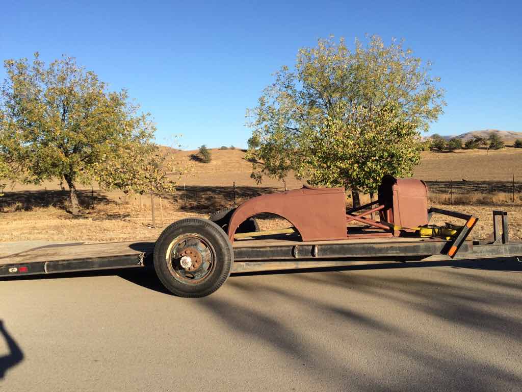

    Is anyone p***ing through Nebraska to CA with an empty trailer? This is a complete ch***is with engine. Ch***is has no numbers but engine does. It has everything.
    For some reason the link isn't working. Look under "parts for sale" and you'll see it. Posted today or last night.

    So the guy who gave me the roadster body sold all the other stuff. There may have been a miscommunication but I thought I was getting everything. Sadly all I got was the body. And the reason I started two threads is because I hadn't posted on there for a long time and I was worried nobody would see. Also I'm not sure how to do anything on the forum other than reply to a topic and post photos.

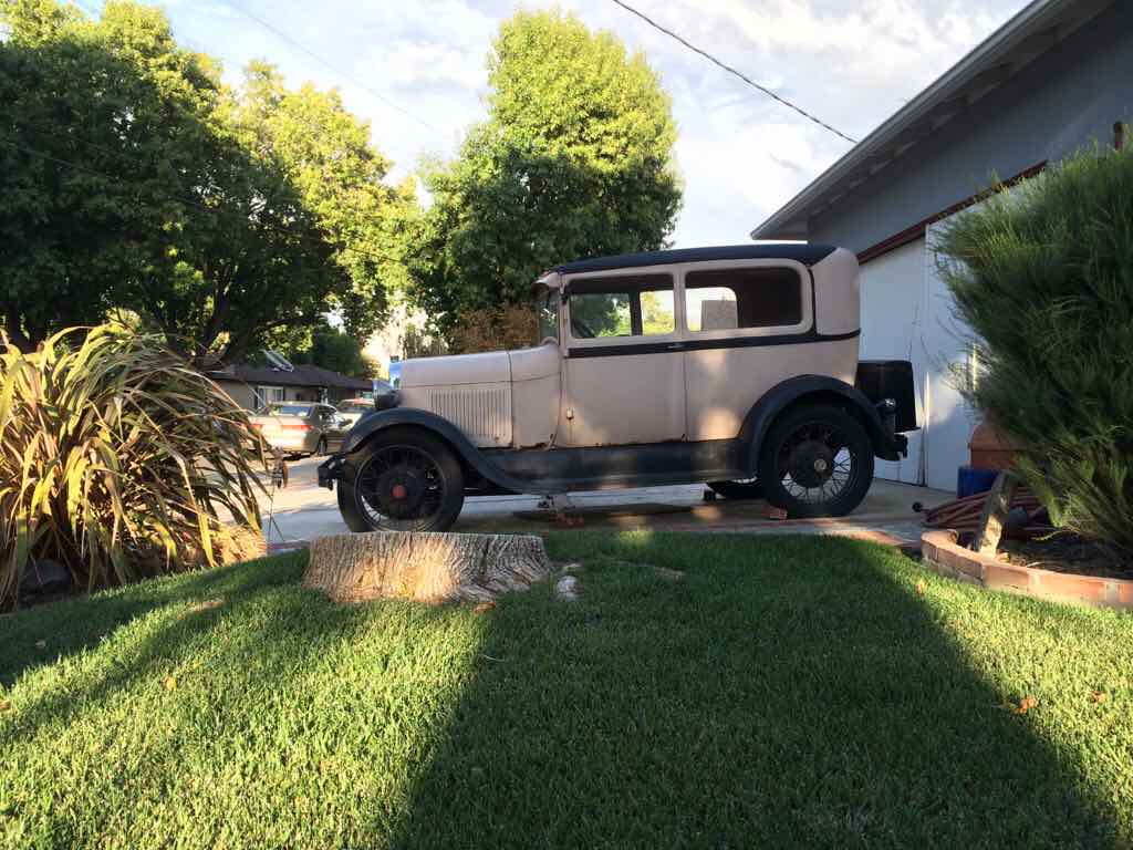

    Does anyone know if a roadater body will work on a 29 two door sedan? I may be able to buy a full car for 3 grand, but if I do I wanna build this... ImageUploadedByH.A.M.B.1413416472.529259.jpg
    The car currently looks like this... ImageUploadedByH.A.M.B.1413416498.146067.jpg

    Pretty much same "A" frame from 1928 to 1931,a few holes were in other places but thats about it.

    Slippery slope there. Easy to get sidetracked buying more bodies. I speak from experience.

    You are going to build a '32 sedan out of a '28 roadster?
