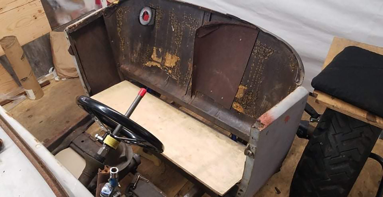

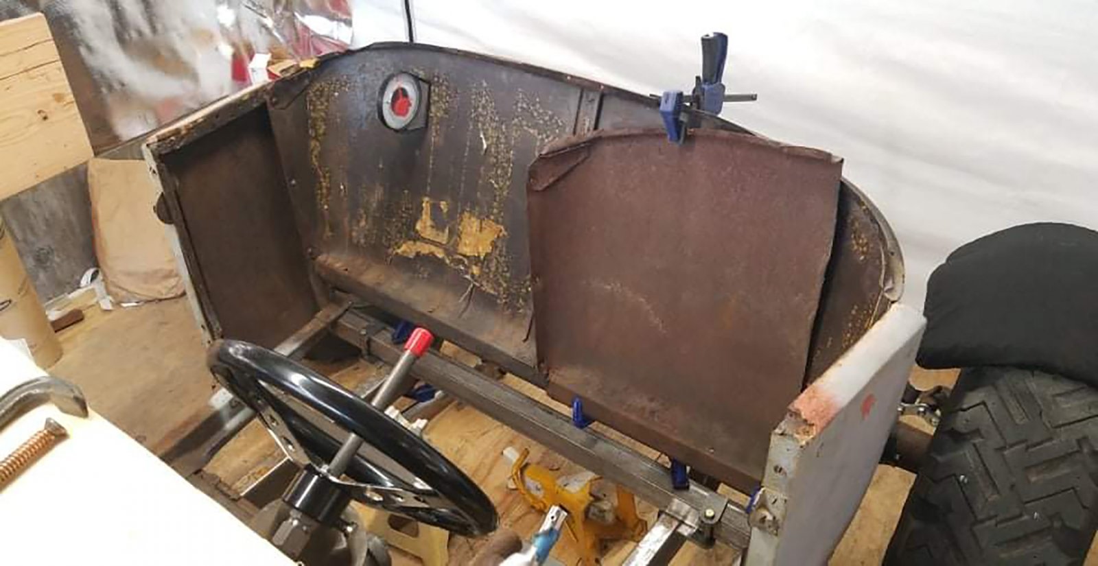

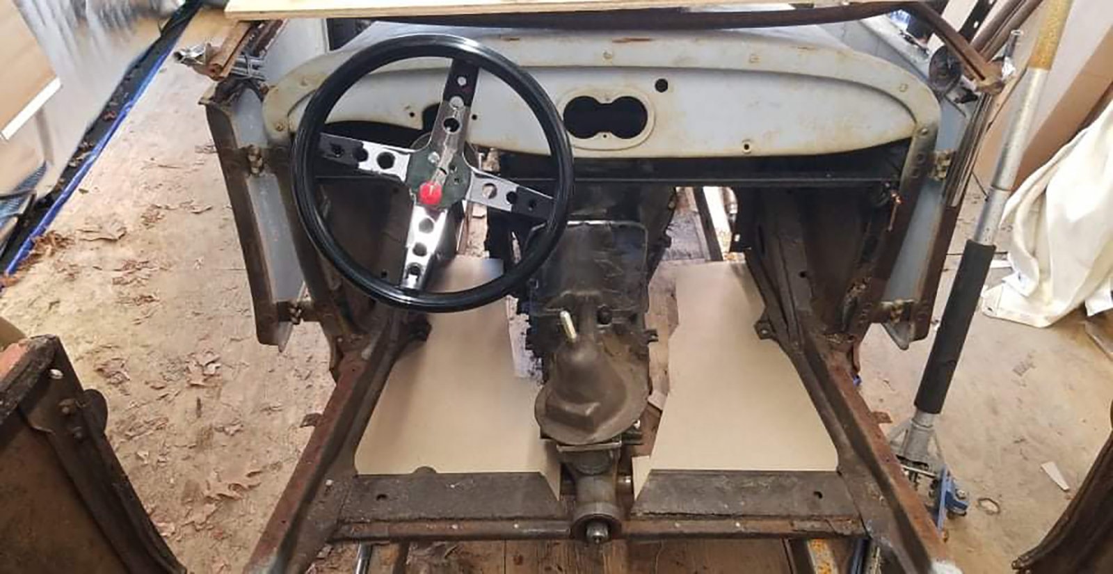

    from Woburn, MA
    We made some temporary plywood floor inserts for the floor so our feet don't just go through the car all the time. We re thinking about just putting a flat 16ga floor under the subframe. The idea is to get as much room as possible. We also removed the driver side floor brace to leave as much room as possible for swing pedals. Sitting as low as it looks like we are going, it may be needed. I forgot to take pictures of that.
    That was mostly driven by work on the seating we did earlier in the day. We moved the seatback cutoffs to the center because I noticed they were digging in a little when they were offset. The plan currently is to set some firm 1" foam into the seat back with another 1" to 2" of memory foam on top of that to be upholstered. The bottom of the seat back needs to be cut out, brought down and the gap filled. I think I may do some wood behind it and a soft brace to the frame too since putting weight on it makes the car want to fold up a bit.
    We are working on coming up with the actual seats now. I am not sure if I want to use plywood or some kind of tubing to make the frames to put webbing into (and a pad on) yet but that is the direction I am leaning. I want to put a hinge at the back and possibly make the pitch adjustable. Currently I have that sheet of plywood in there butted against the frame and the back of the body for about 15° pitch (to the ground, I forgot to read the frame and do math). With the seat pad out of my car (yes, we are robbing like, all my cars right now) we got @justa170 into what we think is going to be close to comfortable enough to order steering column components.
    ignore what looks like a roll bar there; that was just to demonstrate/simulate some things.

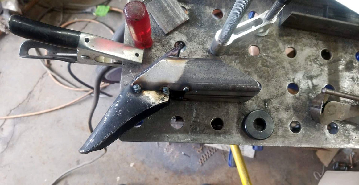

    Those rear end brackets from Speedway showed up, we will be posting a parts list for anyone who wants to run an original banjo on the Speedway Tribute T frame. You need to actually call them and order all the bits over the phone and knowing the part numbers saves everybody a lot of time since this is all 'secret menu' stuff.
    I managed to get them cut to size before I ran out of steam on Saturday. I believe these brackets are all made the same for the 9" or the Winters kit for this chassis and their fab team just opens them up to somewhere near 3.5" from the 3" they come. Anyway, some time and focus on the band saw and I had them fitting snug enough in what we're fairly confident is the right spot on the tubes with the rods parallel to the frame.

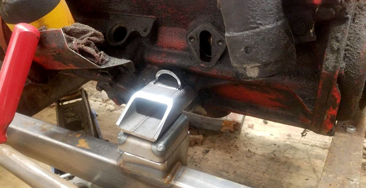

    The GOOD: We got the engine sitting on flat mounts that will take biscuit style dampers.
    The BAD: It took a long time and I am still not exactly happy with them. We ended up realizing we had the engine clocked wrong by 10º and had to remove the head to finally find an accurate measurement which told us that the mounts do not actually interface with the frame (or K member) on the same plane. Rather than giraffe neck the driver side mount, I cut the frame adapter on the passenger side.
    The UGLY:
    20220320_142206.jpg 20220320_142216.jpg received_310292367861730.jpeg received_374546917632661.jpeg received_491015669352598.jpeg received_750344192552933.jpeg received_4744755268966372.jpeg
    These are functional, but they are ugly and I worry a bit about the driver side mount eventually breaking itself as it is currently. A gusset would seem to be in order there. I really did not like cutting the frame side mount but we needed an inch and a quarter somewhere to get the bottom of the bell to 0º and the deck to 30º so out came the cutoff wheel. The pas side mount is flat to the frame but the driver side needs another revision. If I can get access to a plasma table I may CAD some new mounts based on measurements I take from these then fold them up from some 3/16" plate.
    chryslerfan55, Stogy, Tim and 6 others like this.
