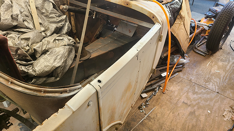

    This past weekend, we went after the seating and drive shaft tunnel. I'm trying to get that figured out since the seat back is in such a critical, structural area of the body AND we're scratching our heads about pedals/shifter/column length still so the sooner we have the driver position sorted out the better.
    I think I mentioned earlier that we went back to a stock seat frame, chopped/shortened 2"/2" then stretched the seat back down about 4" give or take, and incorporated another seat back for an early Vette style arrangement (Which I am not quite sure how I'm going to upholster yet).
    20220814_181130.jpg This is the good metal I was able to cut out of a roached 37 sedan floor that was donated to the cause and saved us having to buy fresh 16 ga and build a pipe anvil just to get the seat platform cut.
    Here is a little bit of the ugly going on behind the seat in the tub back still. You can see the new 2x4 there that holds the tub up. The old gray 2x4 is what supports the seat back. Neither is permanent and I am working out how I want to accomplish their function with steel that's less in the way. Currently both would interfere with the rear ends articulation. I will probably build 2x2 steel offsets into the brace for the back and bolster them against the frame with wood. The rear of the tub needs a big hoop tied to the B pillar and some feet to grab the rear crossmember I'm thinking.

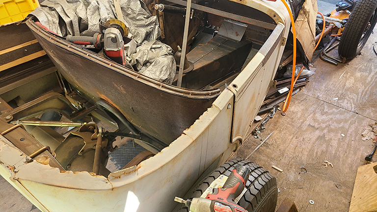

    The big work I did over the weekend was getting some repairs roughed in on the wheel wells with some pieces that I cut off my own car years ago and a small army of sheet metal screws. Once I get all that locked in, I can finish on the doors.
    20220924_195833.jpg 20220924_195837.jpg 20220925_153530.jpg 20220925_153917.jpg 20220925_160815.jpg 20220925_160826.jpg

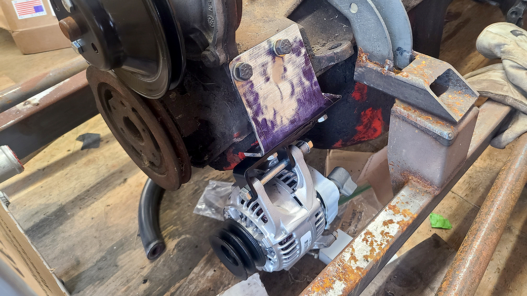

    Wee also got a working bracket to relocate the Alternator finally. Hopefully this will A. work and B. not put the thing too low. It IS sitting between the rails now which will make hood sides easier down the road. We have not put the adjuster on yet so it won't be hanging down like this for long.

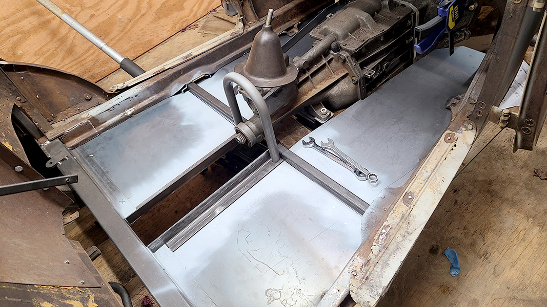

    Been a minute since I've made updates! We've been working most Saturday afternoons on this car since the last update. Most of those efforts have been focused on getting a floor in there and working with seating. I have not been good about taking pictures at all.
    The floors are 16ga sheet which we ran some 2" angle around the inside edge for stiffening and to give us a good lip for the drive shaft and transmission tunnels. I ended up not using the tubing hoop and making a loop out of bar sock to join both sides.

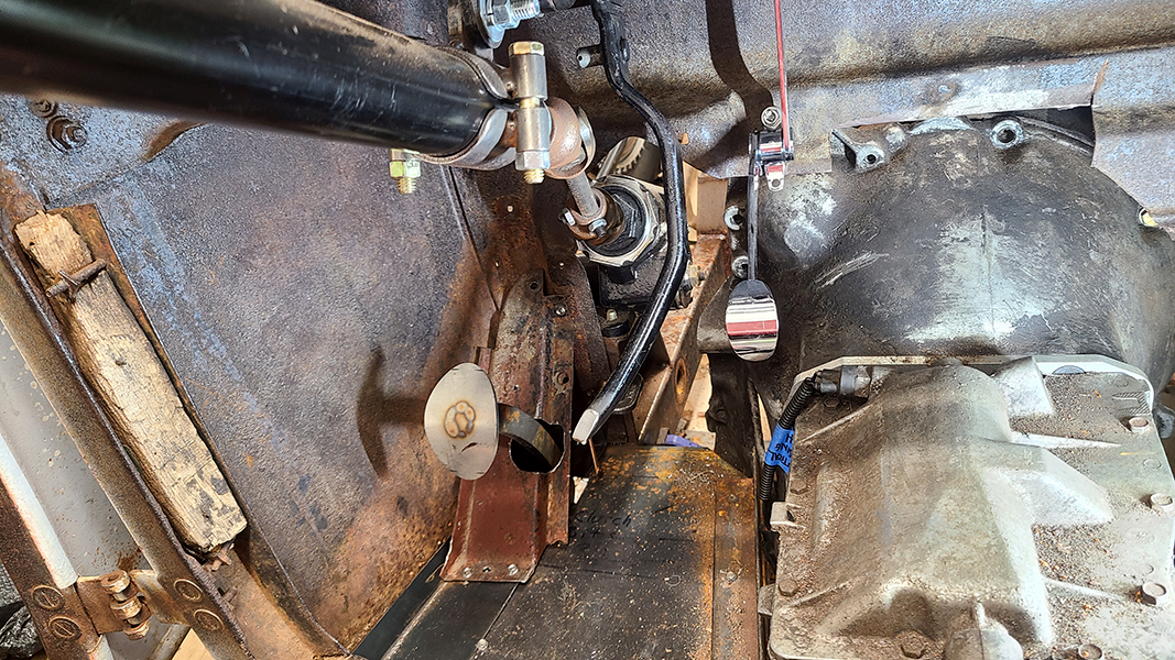

    I keep hitting a mental wall with the floor to firewall to transmission cover to subframe to cowl to pedals problem on this car.
    The transmission eats up SO MUCH space (like 10") that squeezing 3 pedals in there is proving to be more challenging than is fun to tackle. We are at the point where we are discussing things like:
    • Remove the front of the subrail and replace it with something lower
    • Replace the lower portion of the firewall with a wider one
    • Cut the cowl side and weld in a blister for clearance
    None of this is what I consider to be the fun part of doing this stuff when it's this maddening. 10lbs of shit in a 5lb box is fine but 15 isn't.
    Anybody else faced this problem?

    Basically everything we have done for the past 6 or 7 months has been ERGONOMICS. Fitting the driver in this can with the TRANSMISSION IN THERE TOO has been A CHORE... BUT we have finally gotten things dialed in!
    We have a solution for all 3 pedals being safely operated, comfortable seating, shifting, & steering!
    My goal has been to be able to operate this car in work boots if I could and do so without blistering the cowl.
    Between making a very minimal seat (it's a 15" square with 3" of padding on a bracket on the floor with a half inch pad on the back which I totally messed up), using the kit chassis brake pedal for the hyd. clutch MC, & re-purposing an old Falcon/Mustang brake pedal, we finally hit it. We were even able to fit @BOSTONCAMARO in there comfortably and he is taller than either of us.

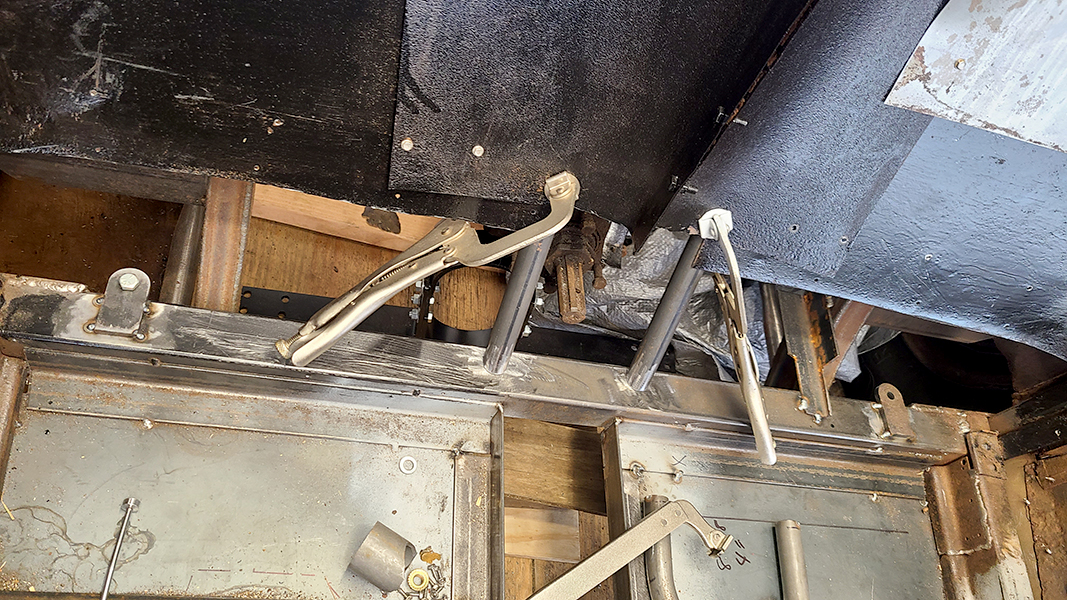

    I ended up having to cut the subframe forward of the A pillar, make some 16ga angled extensions, & use later Model A kickboard brackets for legroom (well, heels mostly). We also got the seat back supported with a drive shaft hoop and cut. The hump is 16ga & will get some strap inside it by the U joint for safety.
    The brake pedal will be moved an inch or so to the left and the clutch will get an offset too.
    20230506_155641.jpg 20230506_154700.jpg 20230423_170712.jpg 20230423_170708.jpg 20230423_134158.jpg 20230423_134153.jpg 20230408_154413.jpg 20230408_135627.jpg 20230408_135616.jpg
    We are picking away at the firewall now to get enough in there to do the transmission cover.

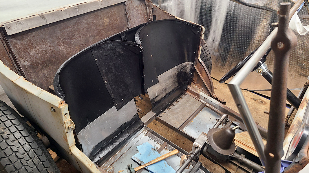

    OK, looks like I did cover the drive shaft tunnel already, so the next thing we fought with (and have been for a loooong time) was pedal location. We did finally get it. We can get 3 pedals in there. It will be snug but shouldn't be unsafe when we do the final adjustments.
    You will see both versions of the transmission cover in here. The first had multiple brakes and was 18ga. I decided that was going to be a pain to fit to the firewall and was unsatisfied with the strength (it was flexing too much for my liking). What's in there now is a simpler 16ga 2 piece design that I'm much happier with.
    Version 1
    THE PEDALS WILL FIT! We are going to offset the clutch an inch or so left. The brake will get torched and bent when we are ready to lock everything in and have the throttle mounted and operable. The firewall is a mess but I'm waiting until we pull the body next time to fool with it & do it right. We are using some Model A pedals that I rescued from the earth in the woods on a pick I was invited on. I cut them & welded some bolts to the back so we can run them vertical. We'll hopefully end up as good or better than an original VW Bug down there but we shall see. I had to cut the subframe out and replace it with a plate. You may also notice that I installed Model A kickboard brackets flush with the floor for added legroom.
    20230813_182506.jpg 20230627_174855.jpg 20230627_174840.jpg 20230618_195803.jpg 20230618_142646.jpg 20230611_191010.jpg 20230611_190924.jpg
    Here is where we are at now with the new transmission cover. I am going to smooth out the relief cut a bit. I actually need to make it deeper first but this works for now; the concept is proven. I can hit each pedal without hitting another in my clunky work shoes.
    I firewall mounted the MC too (first, actually). I happened to have a pedal arm out of an automatic early Mustang/Falcon in my pile that would work great, so that's what we ended up going with (we did not like the other swing pedal we bought for this application). We were able to find an inexpensive repop bracket which I cut down (I will close it up and add a tab to the front later). This saved us a ton of time tryint to re-invent & fabricate this piece of the puzzle which was already losing its fun. Cutting the stock bracket and having it JUST WORK was just what we needed that day.
