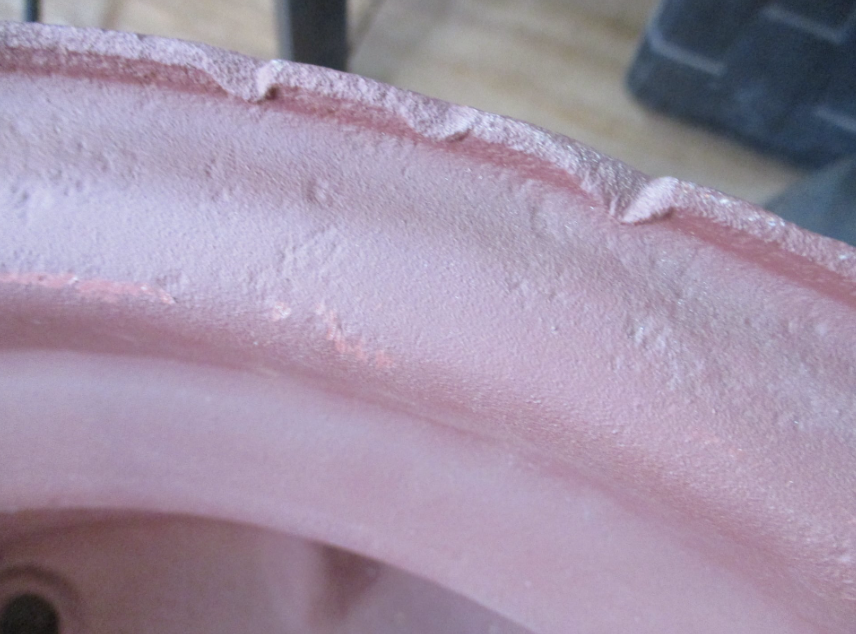

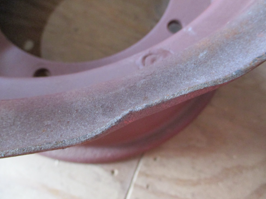

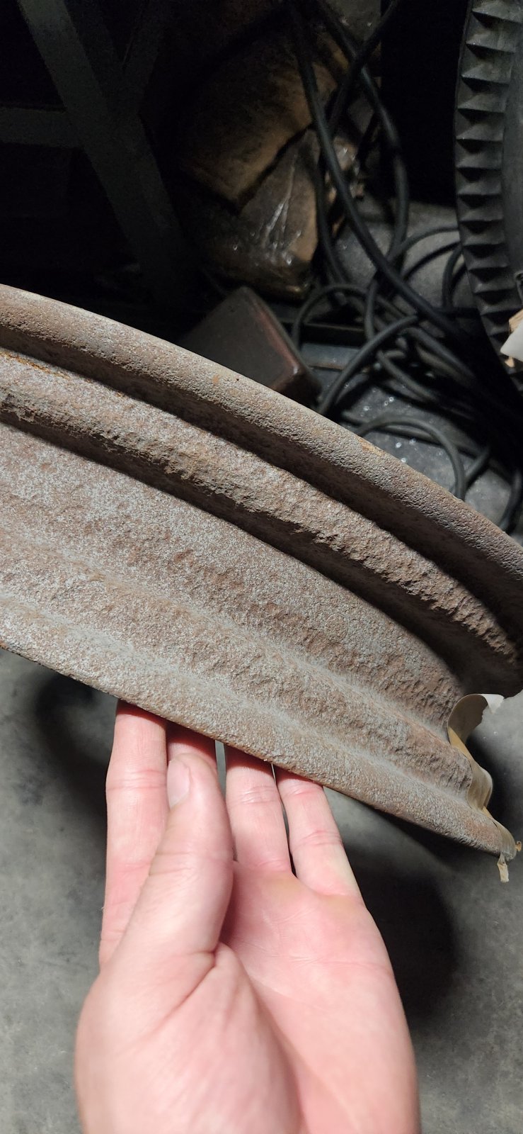

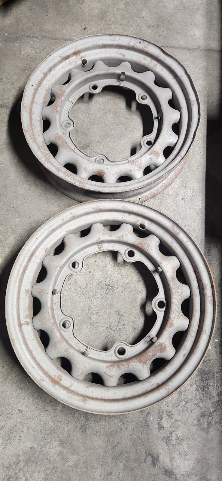

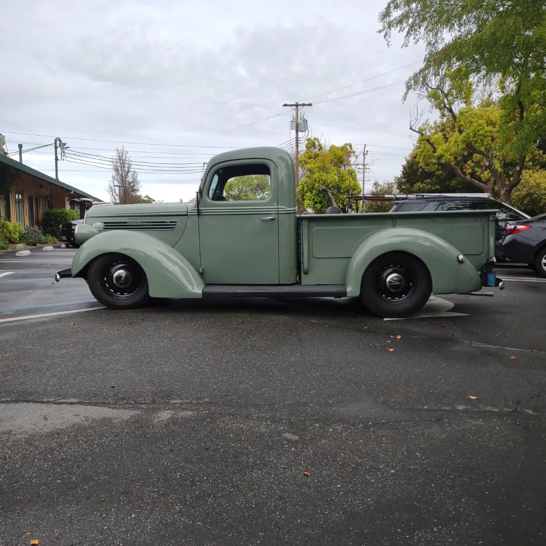

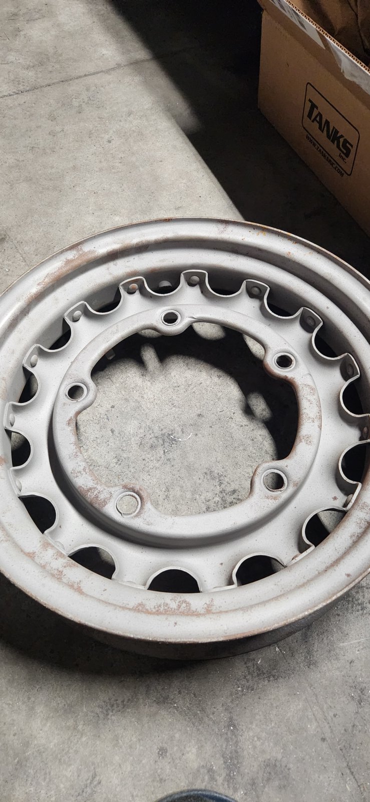

    I searched for 10 years to find a pair of 18-inch wide five wheels for my 39 Ford pickup, and a local friend of mine found a couple for me. The centers are in good shape, but the rims have seen better days. I'm not too concerned about the bends in a couple of the lips, since those can be straightened. I am, however, concerned about the pitting. I've seen worse, but I drive my truck hard, and I'd rather not have a wheel fail on me at speed.
    My question is: are they usable as is, or do the rims (hoops, outers, whatever you want to call them) need to be replaced? If they should be replaced, does anyone have suggestions on where to find a suitable rim? So far, it's been challenging to find a rim that would work because the inside diameter of each rim is about 16", and that's larger than that of any of the new rims I've found.
    Thank you very much in advance.

    I've got a set of sixteens that are about that shape on my car for 10 years now.

    What is your concern? That the hoop will fail? Bead sealing? I'd run em.

    The hoop failing is my only concern. I'm not worried about the bead sealing since I'll be using tubes.

  8. I also have a set equally as bad, maybe a bit worse where they sat in mud for decades, that have been in use for a decade with no issues. I blasted, and powder coated them to protect what was left. With a cycle style rim liner and new tubes, running Firestone bias plys.

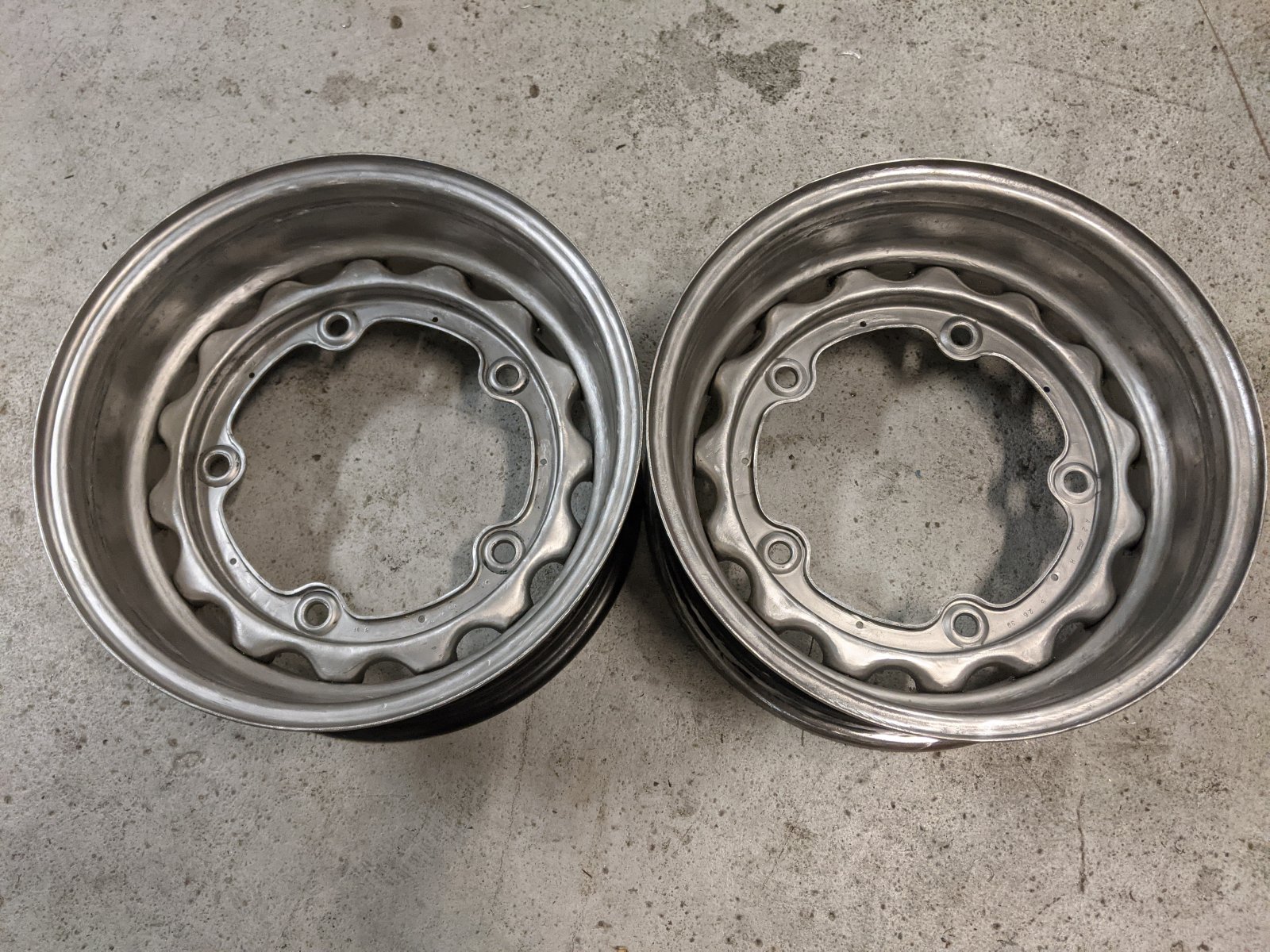

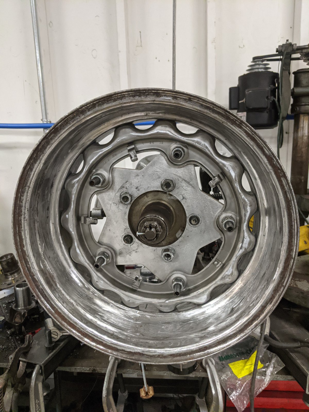

    The hangup in getting them straightened will be two-fold.
    The average shop might not want to touch them for liability reasons.
    Beyond that, no wheel shop that I know of is equipped to do anything but a hub-centric wheel.
    You'd have to supply them with an adapter to even try.
    Re-hooping them is totally possible, provided that an appropriate hoop can be found.
    I only know what fits the 16-inch ones.
    You might be surprised to know that on those is the exact diameter of a Chrysler minivan steel wheel. It's still a standard.

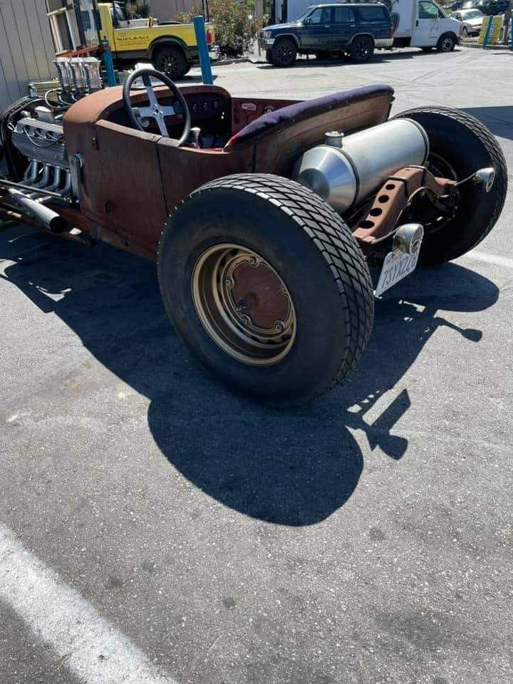

    All of the ones in these photos are Ford/Chrysler composites that I made.
    It is possible that the 18-inch is still a standard too. It's worth a look.

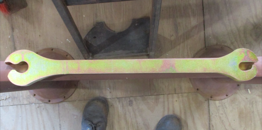

    An adjustable wrench works well for tweaking the outer lip & save the hammer torture, however I have also used a wheel weight properly positioned to hammer on if a bit of hammer work is required it saves the edge from unsightly dimpling & additional labor.

    The Speedway wrench is well worth the price. I’ve used it MANY times.

    That's all customer stuff.
    My cars have HAMB unfriendly wheels.
    The owner of the rusty T lives in San Carlos, so you might see it around.

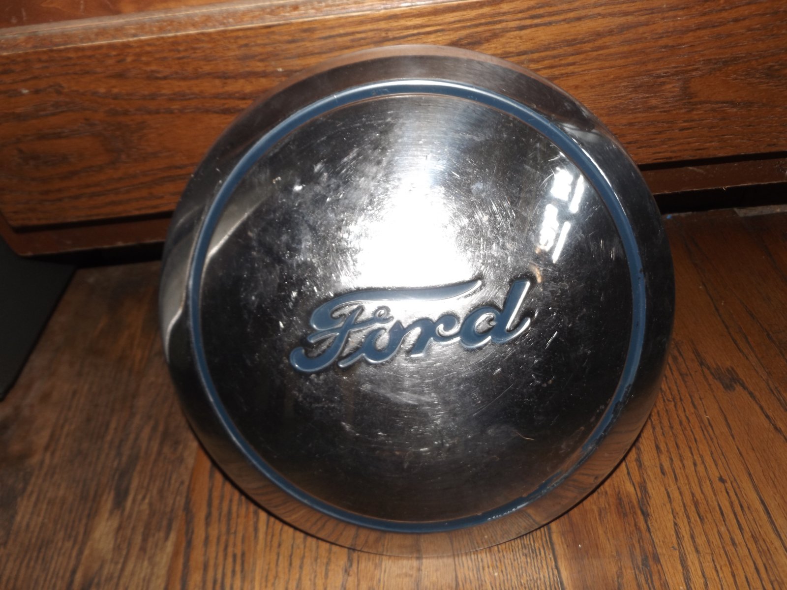

    Do the 18 inch wheels tale the larger hub caps?

    No, they take the same size hub caps. The "spokes" are longer than the 16" version, but the center pocket is the same diameter.

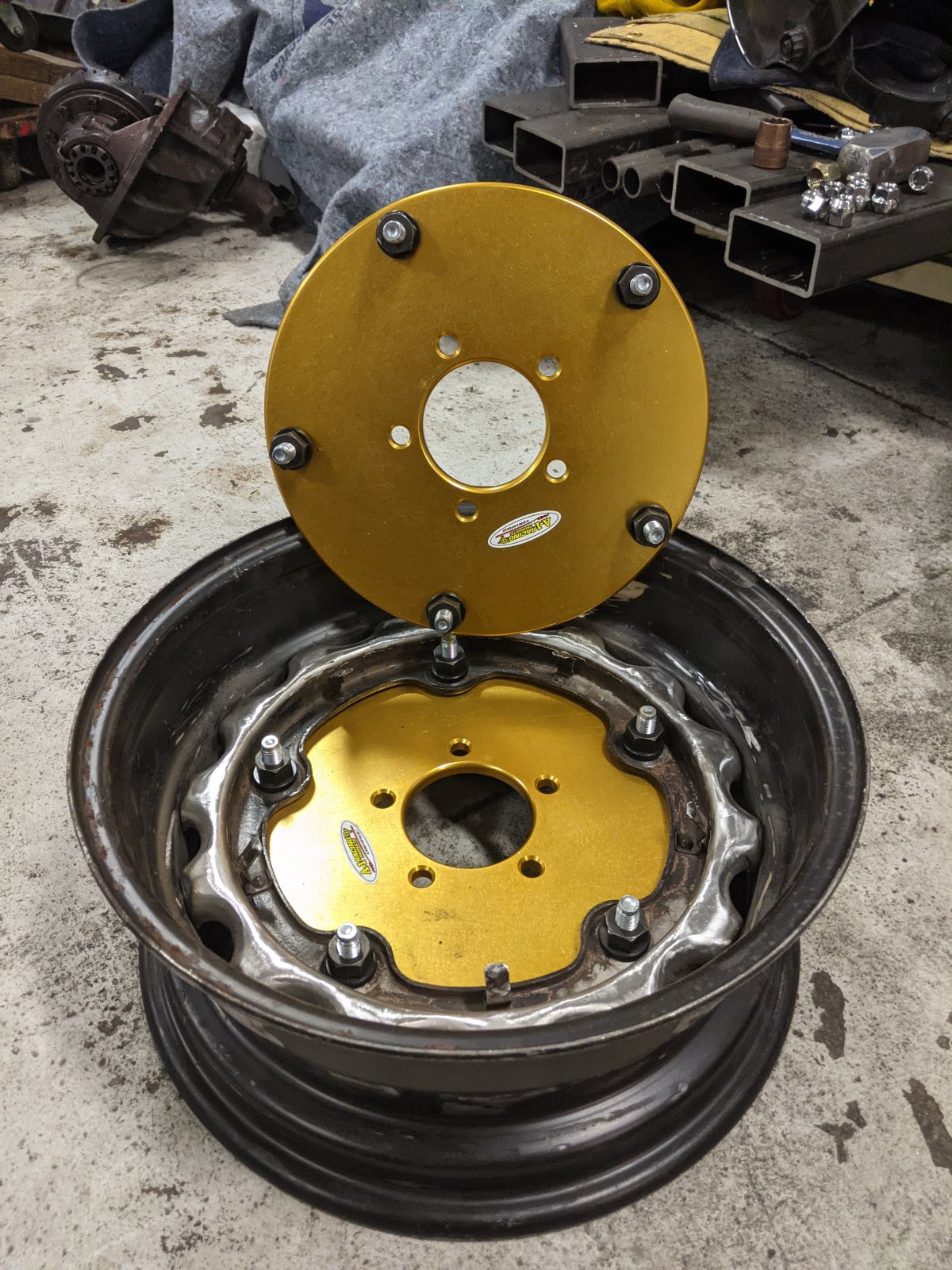

  30. @alchemy nailed it one of the best tools I have ever bought!
    upload_2024-9-16_18-43-17.png upload_2024-9-16_18-45-8.png upload_2024-9-16_18-45-33.png upload_2024-9-16_18-46-2.png
    The wheel after straightened and welded a bead protector on it
    Racerex likes this.
