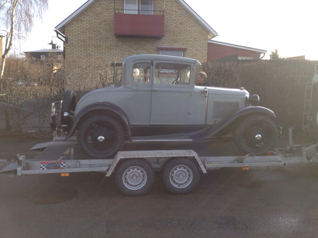

    Im 18 years old and i live in Sweden. For as long as i can remember i have alwaysed like hot rods and it's now finally time for My first build.
    As i Said i live in Sweden and My english is not the best, but i hope you guys understand!
    In january this year i got hold of a Ford model a Coupe. Bought it of an old man living in west sweden. It was more or less all stock. The old coupe is in quite good condition, except som rust on the back of the frame and some under the body. but hey, what can you expect from a car that is 86 year old?
    As i Said, more or less a stock model A. But someone has converted it to juicebrakes, and it is not the best work i have ever seen. Because instead of changing the spindles to something that Would match the backing plates they just welded the stock model a spindles on the backing plates (i hope it was a good welder haha)
    Hope you guys Will like My build thread, im gonna try to keep you updated!

    Congrats - great ride to start with - post close up pics of backing plates, etc
