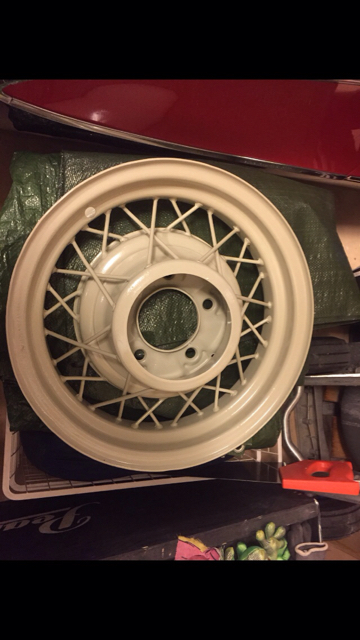

    Not Sure if anyone still follows My build thread but it's time to update it now.
    I finally got hold of some 16" wires. Just the expensive Tires left...
    kiwijeff likes this.
  20. The wheels look great. Remember that there are several hubcaps from 1932-35 that will fit. The ones for the 4 cylinder cars just have a ford script. They make them smooth for hot rods and the V8 caps changed style several times. Also remember that if you run wire wheels on early Ford hydraulic brake drums you need adapters. The lug nut pattern is the same but the wire wheels need to be supported at two levels or they will eventually crack around the lug nuts. See: http://www.jalopyjournal.com/forum/threads/40-ford-wheels-on-a-model-a.750368/#post-8330045 . These spacers are available from many suppliers such as MT Car Products: http://www.mtcarproducts.com/productsgrid.html .
    Charlie Stephens
  21. hasty
    Joined: Jul 5, 2009
    Posts: 1,411
    hasty
    Looks like you found a great car to work with
  22. The welding on those backing plates and spindles are a bunch of ugly but they are still functional. My recommendation is to run them while you work on other things, like the flathead, and keep your eye open for good deals on parts that you will need to upgrade. My experience is that if you need something right now you will pay more than if you can wait a bit and make a score.
