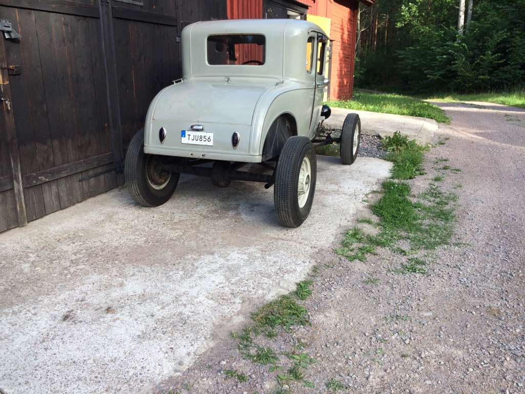

    Need some feedback!
    I'm thinking about painting my wheels black. I think it would look cool, it looks a bit more "hot rod" If you ask me.
    But at the same time it's a bit different using the primer paint that is on right now.
    What do u guys think, should i paint them black?

    Personally, I like the white. I'd use my time, energy, and money for something else!

    For your information they are not really white, more of a combination between grey/white/yellow ;) haha just kidding, i have to wait and see how it turns out with hubcaps on!

    I'm considering a roof chop. However im 6 feet 2 (187cm). Will i fit in a coupe with 4" roof chop? Off course i have to lower the couch. Maybe someone tall can tell?
    My coupe looks so f**kin high right now. And i alwaysed thought chop coupes are cooler.

    On chops I like them cut just enough to make the quarter windows square. About 3 inches.

    I know how i like them, and that wasn't the question. The question was however I'm going to fit in a chopped coupe...

    I understand that too. That is why I didn't chop mine. I couldn't fit comfortably in one that is chopped.

    I'm 6'2", and my 30 coupe has a 4" chop. The seat is on the floor, my knees are at almost shoulder height, because I have to slouch down to drive. Cool, yes, but not terribly comfortable. Tape some cardboard inside your car to lower the roof temporarily so you'll know how it would feel if you chopped it.

    Let me add something on height.
    Model A's bounce.... a lot!
    I'm 6-1 (I used to be 6-2!) My car is un-chopped.
    I fit in it fine with about a stock height seat.
    But sitting in a car that is not moving is only half the story.
    Hammering on the back roads,
    (yes we still have them in New York!),
    my head will still come in contact with the roof
    due to spring bounce. Even really good shocks
    will not stop it all. I have MG TD shocks on mine.
    They look very period and work great. Your dad will know!
    Just giving some insight.
    Keep it up. I think you were a teen ager in 1946!
