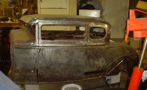

    And the teaser pic of the body. Like I said before, I will not do anything but rub it down with oil for th Roundup trip. I have no time to do anything else. It is chopped 3 inches, and channelled the full height of the A frame. The floor is in, and there are 4 patch panels that have been welded in, but not much else.
    Sorry about the big red engine hoist in the way. Was too lazy to move it.

    Me being 6'2", and the car already chopped 3" and channeled 5", I would have to sell it to a circus midget. The look is cool, but there would have to be a sunroof or something for me stick my head through enough to see.

    Dang, Hatch even did yer body work for ya!
