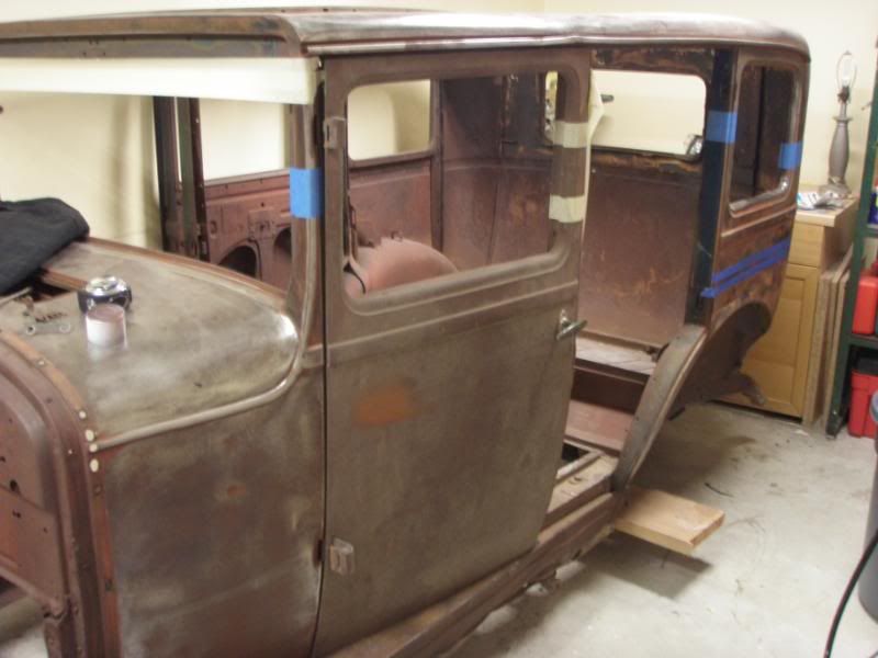

  21. pstreet
    Joined: Aug 13, 2008
    Posts: 46
    pstreet

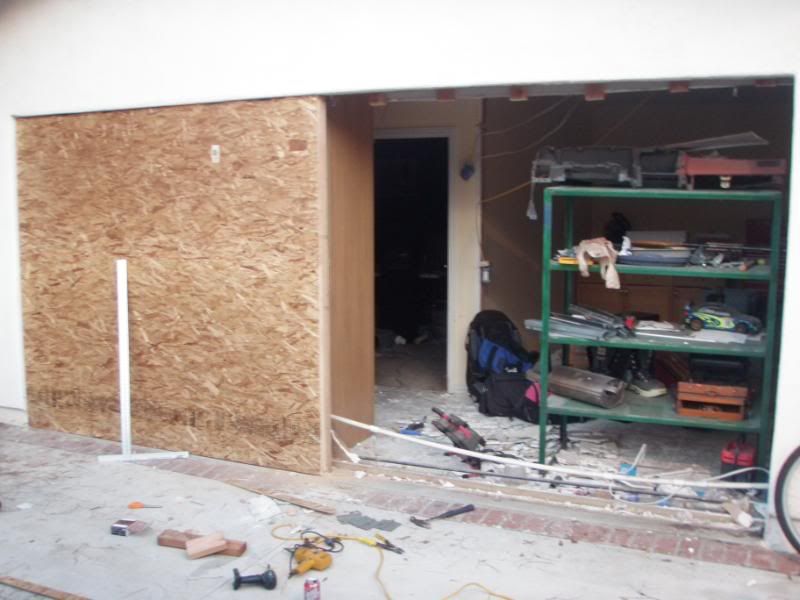

    Found some time after work over a few days to get a temporary garage wall/door up. It should hold just fine until the whopping month of rain we receive each year p***es, and i can put up something permanent.

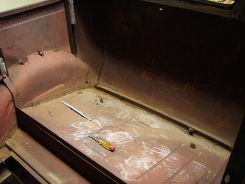

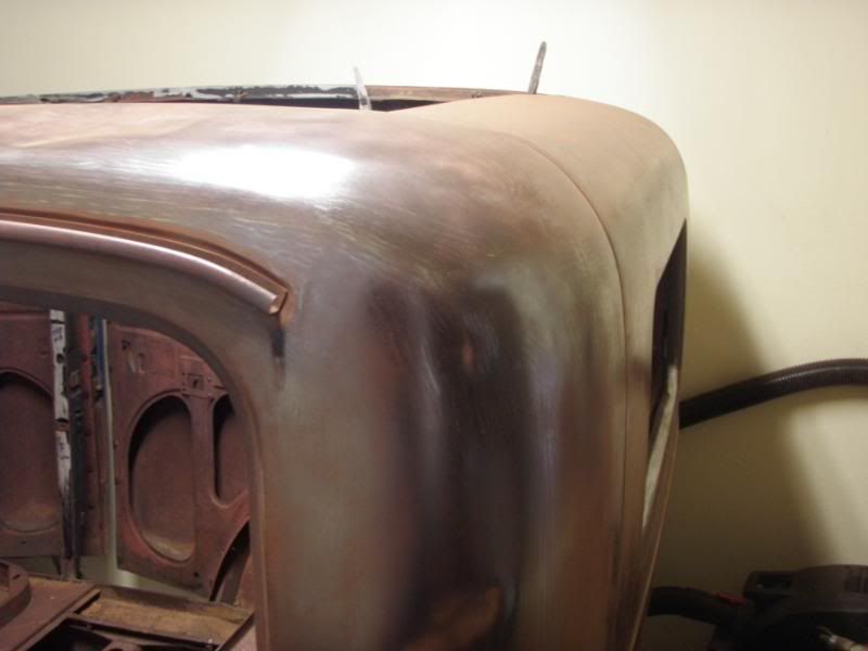

    Now that the car is in the garage i've begun cleaning it up. A flat blade screwdriver and a shop vac took care of most of the caked in dirt and brush in the door panels and other tight areas.
    The drivers side rear door was a bit worse off than i thought, oh well.
    Ive just started in on stripping the surface rust and finding all the hidden dings and dents. I was surprised when i went to remove the doors, the bolts came out like they were just put in there yesterday. Long ways to go still, but my DA is working great, and i have a stockpile of 80 grit disks.

  23. pstreet
    Posts: 46
    pstreet
    Haven't had a lot of time lately with the holidays and work.

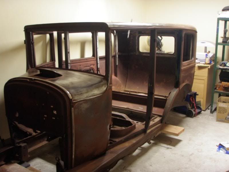

    I did find some time to get about 85 percent of the structural wood out though.
    Most of it is in pretty good shape to make patterns from. Even the pieces that have been a bit rotted, ive been lucky enough to have the other sides copy still intact. I plan to get started on rebuilding the structure and a lot of body hammering/patching come January.

  27. pstreet
    Posts: 46
    pstreet
    Well its been a while since i've posted an update.
    Been spending the past few months doing my research. Trying to see just exactly what i want this to be and i think i have a pretty good idea now.
    A couple months back i scored a drivers front door from a fellow hamber here in the cl***ifieds. Its in much better shape than the taco'd door i got with the car. Under a light coat of surface rust and dirt it really shines. Luckily for me the original door has the few pieces i need to make this door perfect.

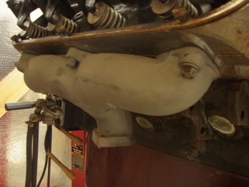

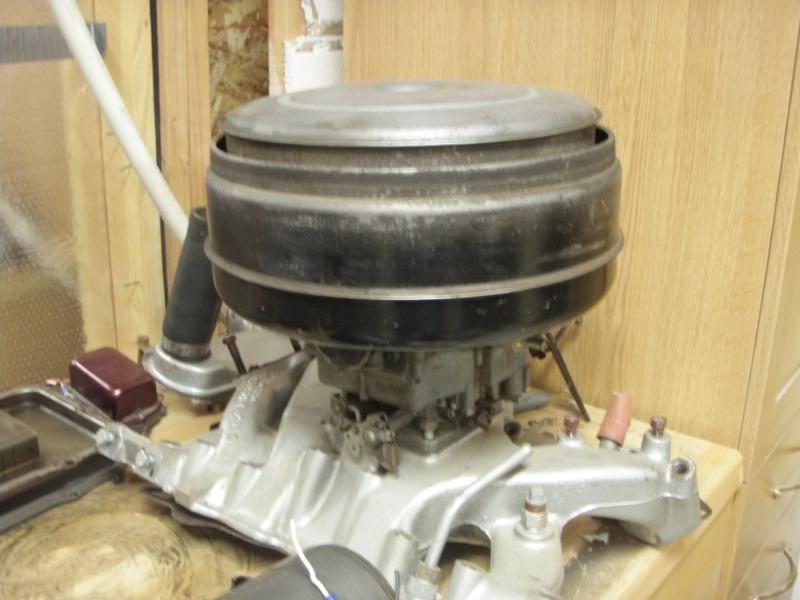

    A couple of weeks ago i found my 'motor-vation'. Again from a fellow hamber. It's a 1954 chrysler 331 hemi with the short bell housing. it was said to have been rebuilt about 8 years ago, and has sat in a garage since then.
    It came complete from carb to pan.
    Ive done a light tear down of the engine and everything seems to look good so far. I haven't taken the heads off yet, but im hoping everything else is in good shape too. Ive also found a local willys guy that deals in early hemi parts as well. Aside from cleaning it out and making sure its good to run, i don't plan on doing much to it except a new intake manifold and valley cover for now. Cant wait to hear this thing fire up.
    Instead of starting on the body like i had planned, i think ill get the rolling ch***is built first. I figure i might as well get the part i understand less about done first. After some thinking, i decided that ill put a transverse leaf setup on the front replacing the parallel leafs. The front will run hairpins to a 4" dropped axle.
    For the rear i'm leaning towards ladder bars but i'm not positive yet.
    The frame will get a small step in the rear and possibly under the cowl, but well see.
    The body for now, i'm thinking a four inch channel all around. Also if space permits, id also like to take 1.5-2" off of the top.
