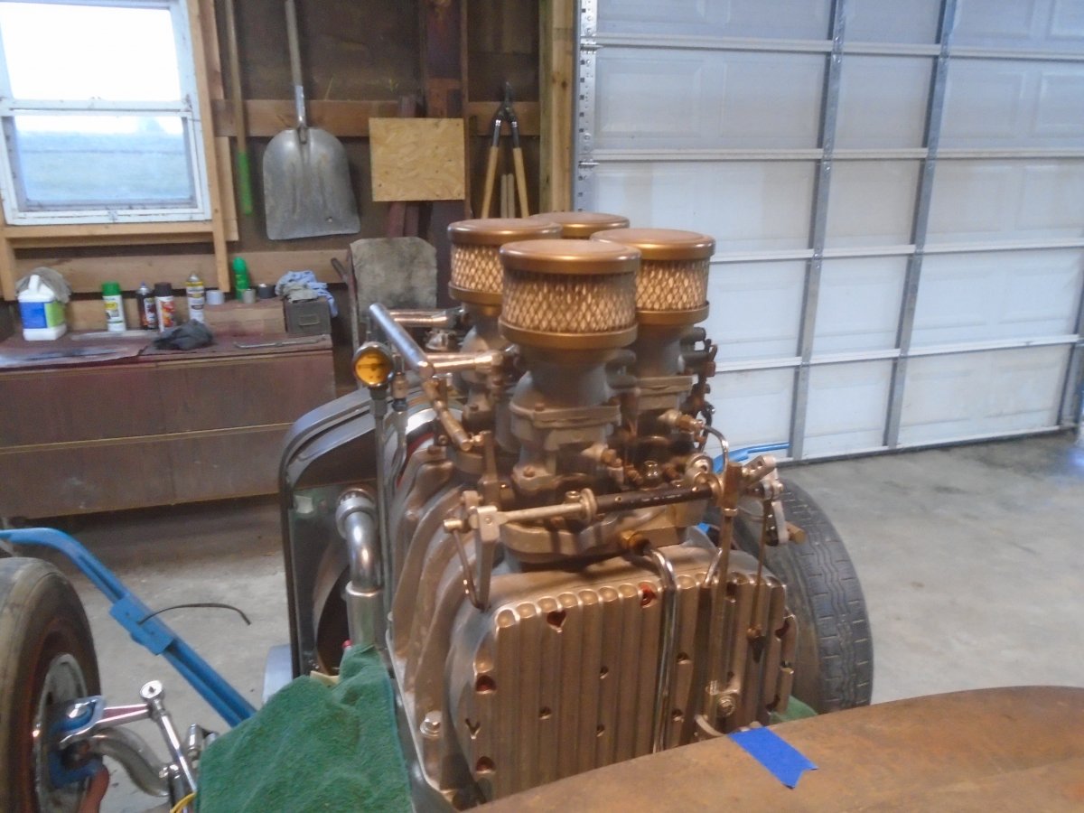

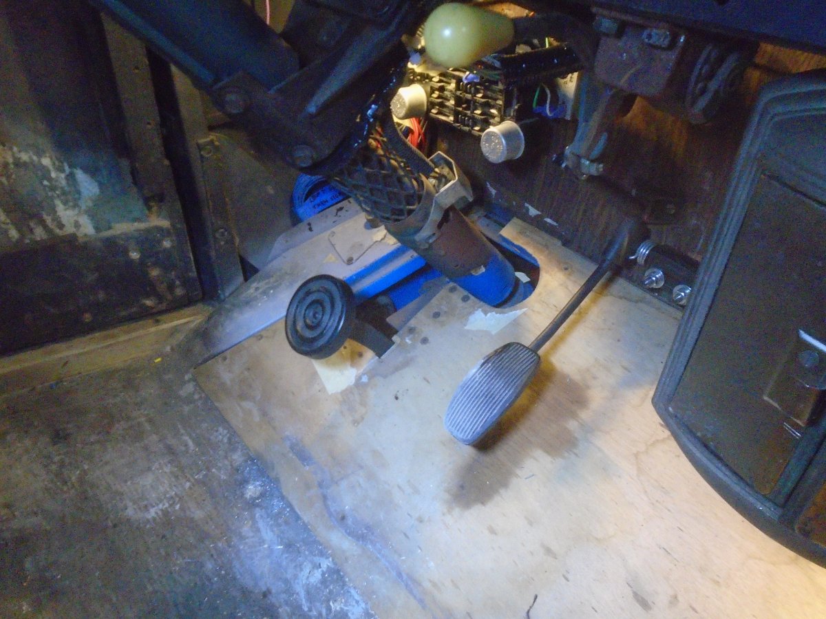

    The gas pedal is made up and mounted in the car.
    I also put the rubber pad onto the brake arm.

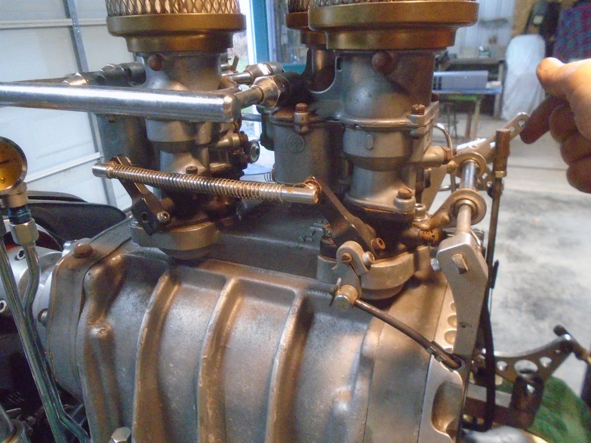

    The gas pedal is connected to the throttle linkage on the back of the blower with a cable coming out of the firewall.
    The throttle return springs are installed on the linkage on the side of the carbs.

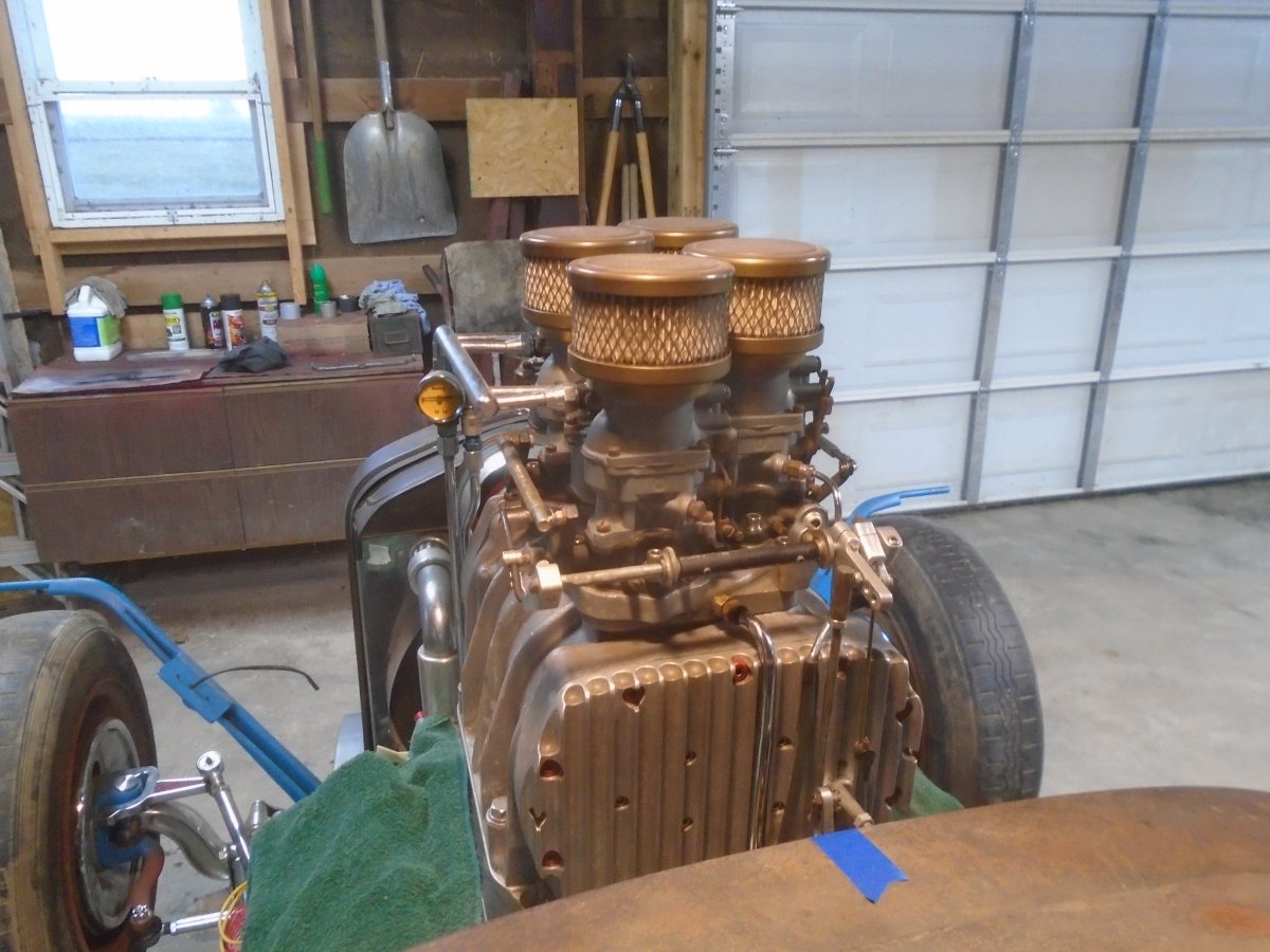

    Sitting in the drivers seat ... this is the position of the throttle linkage at idle.
    And the linkage with the gas pedal pressed all the way down.
    Previously .... this red linkage rod had two holes in it for the clip pin so I could set these two carbs to not open at full throttle.
    After discussing this with my resident speed enthusiast ( my son ), he convinced me that these two carbs need to open all the time for full throttle running so that the engine doesn't lean out.
    So I cut the front part of this linkage rod off and put in a fixed cotter pin so these two carbs will always go full open with the other two carbs at full throttle.
    This is idle position.
    And full throttle position.
