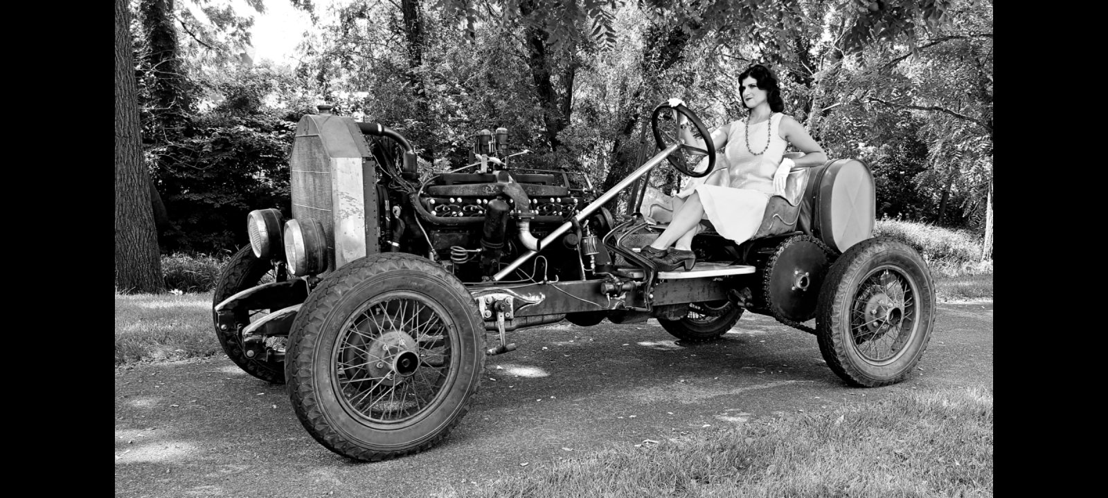

    Did alittle photo shoot today.
  5. chiro
    Joined: Jun 23, 2008
    Posts: 1,287
    chiro
    Awesome.
    I gotta say it...that open chain sprocket scares the shit out of me.
    Andy
    Stogy, winduptoy, Squablow and 3 others like this.

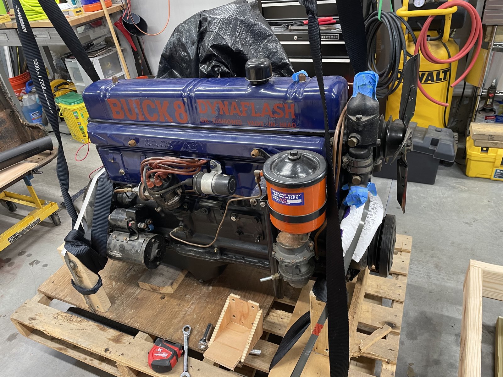

  23. Rj27buick
    Joined: Feb 14, 2012
    Posts: 117
    Rj27buick
    This is awesome! Here is my starting point for my speedster! Keep posting fun to watch and learn. 662826C0-DCCF-426C-94E5-4BAEC86A5E22.jpeg
    Stogy, 41 GMC K-18, winduptoy and 8 others like this.

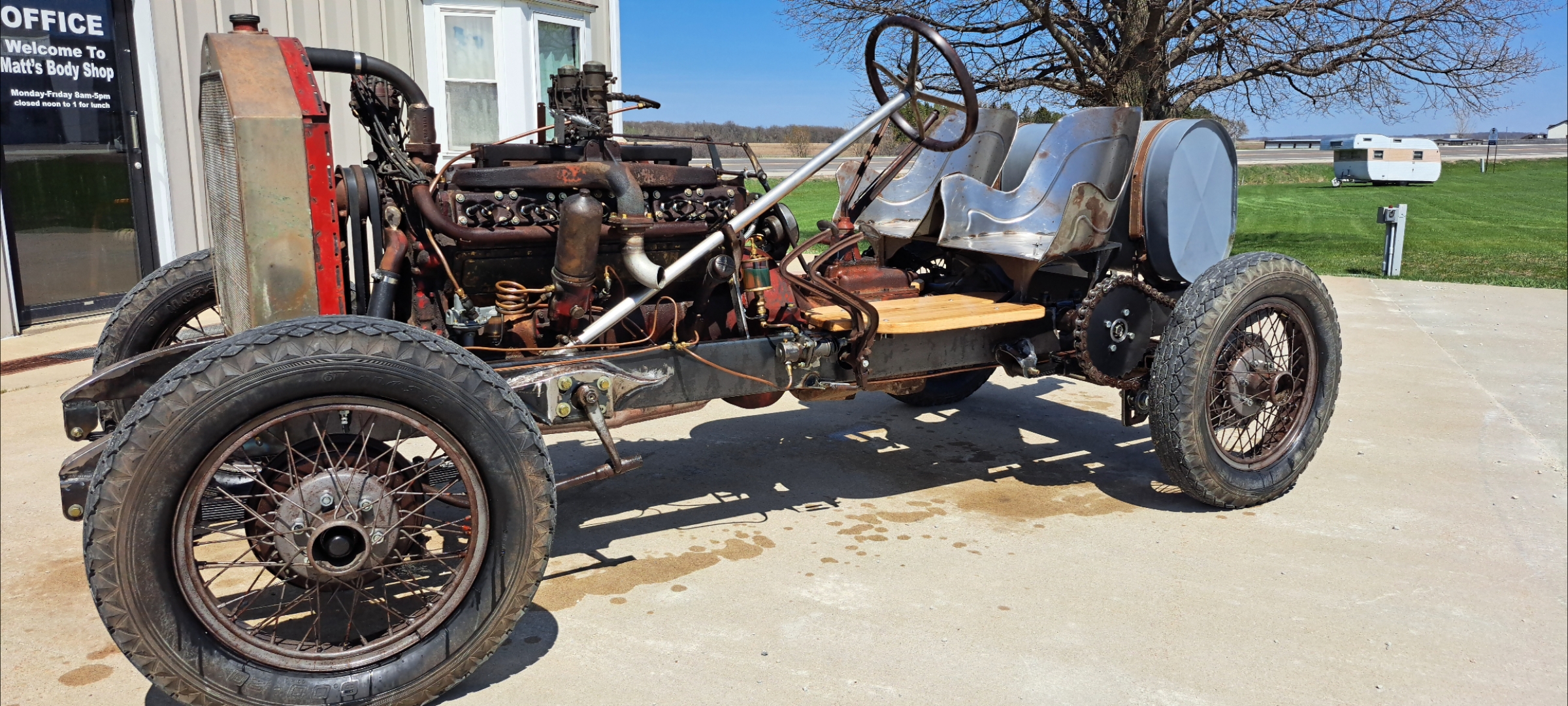

    Had the Axles normalized and hardened. Will get it back on the road this weekend. Wish me luck on not snapping axles! Screenshot_20250425_211351_Gallery.jpg
    Stogy, Thor1, 41 GMC K-18 and 5 others like this.
