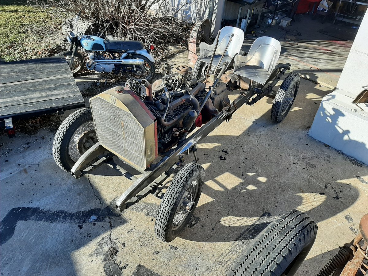

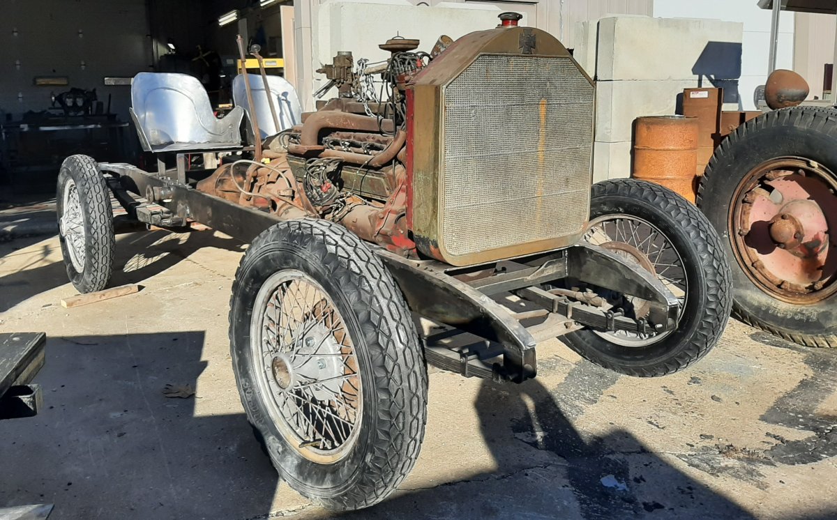

    Rolled it outside today
    20201204_143831.jpg 20201204_140759.jpg 20201204_140833.jpg 20201204_140853.jpg 20201204_140916.jpg
    VANDENPLAS, SS327, 48fordnut and 18 others like this.
  7. Hate to say it, but you may want to consider adding 12-16 inches to that wheelbase- with the size/width of that radiator, your body is gonna look pretty stubby- almost like a caricature?
  8. animal8324
    Joined: Sep 28, 2012
    Posts: 179
    animal8324
    from nj
    I don't mind them short and thick

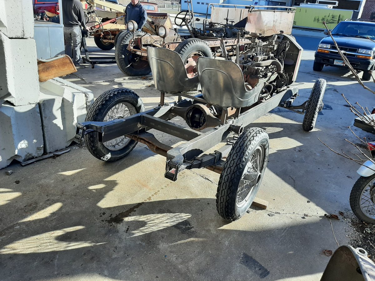

    Got my master mounted. Next up mounting rear brakes and figuring out sprockets

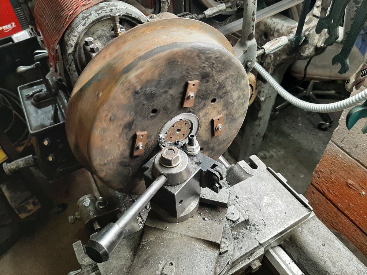

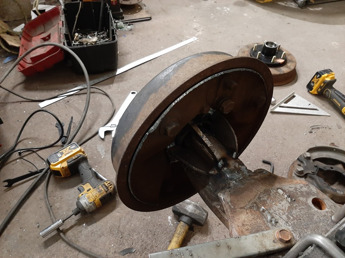

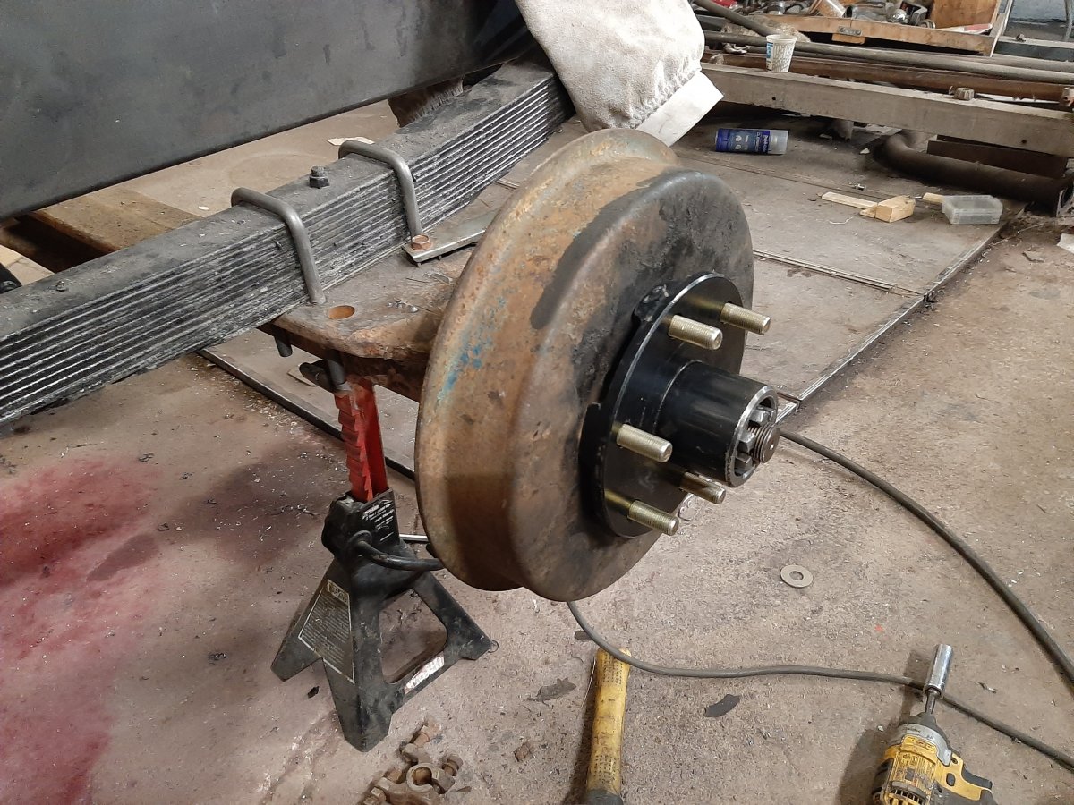

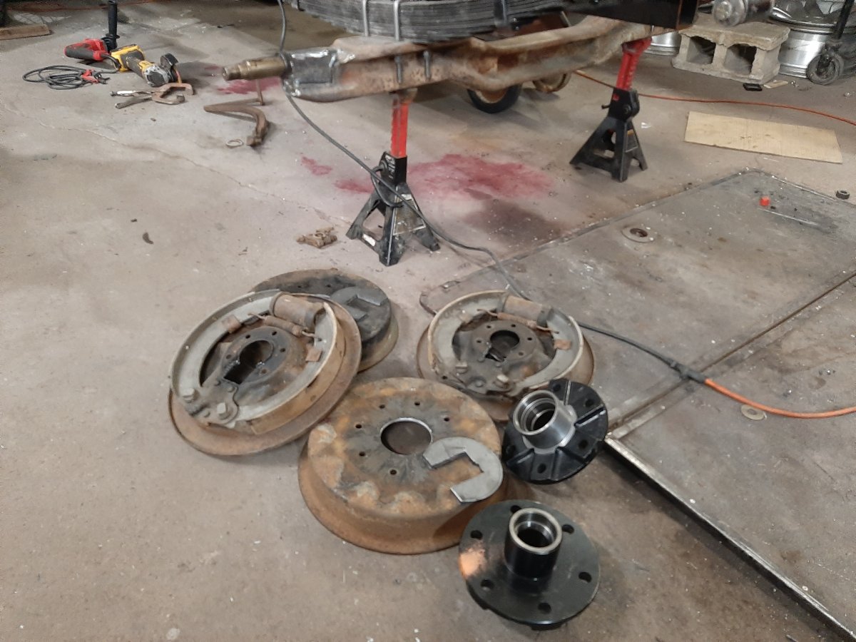

    Surprisingly 1928 Plymouth Brakes arn't exactly bolt on for the rear axle on my speedster.
    No bother have lathe, can weld

    Looks great. The jack stands are an improvement over the concrete blocks and bits of wood but larger stands would be better. Those are maxed out. Be safe bro and be careful. And...I'm sure we would all love to see some video of the engine running:D

    from nj

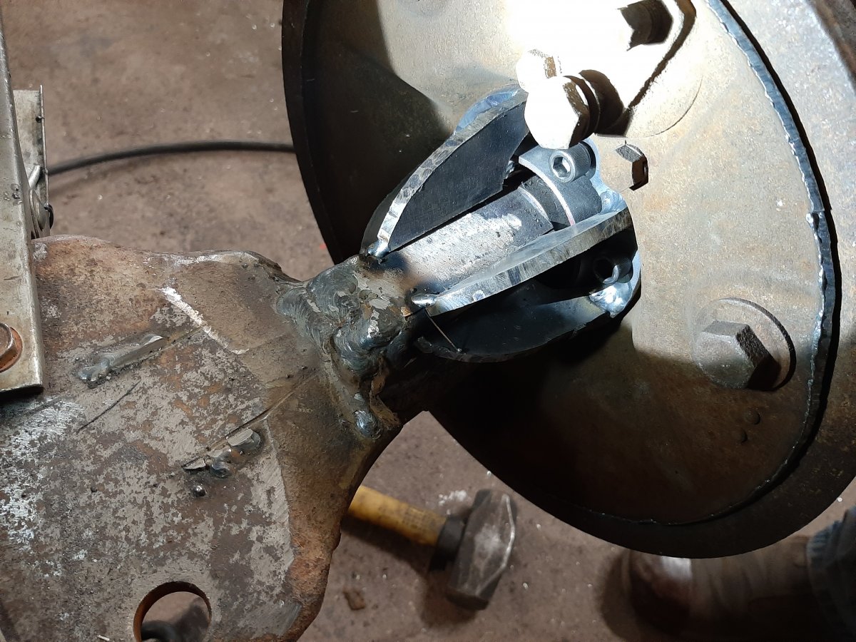

    Got one side of the rear brakes tacked together. Tommorow i'll knock out the other side and burn the mounts in with some 7018 stick welds.
    Note the trimmed backing plates. This is so I can mount the sprockets to the drums. 20201207_173721.jpg 20201207_173736.jpg 20201207_173957.jpg

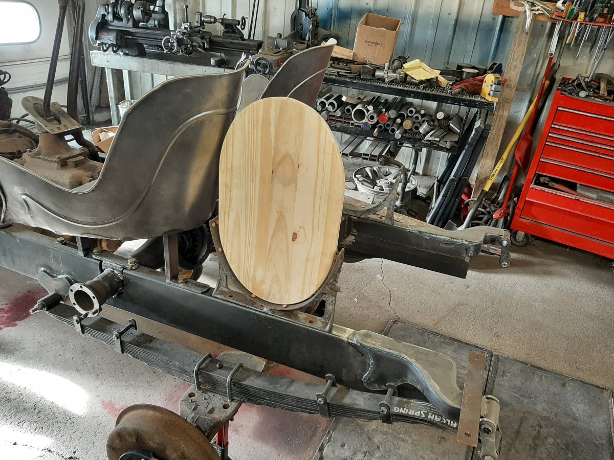

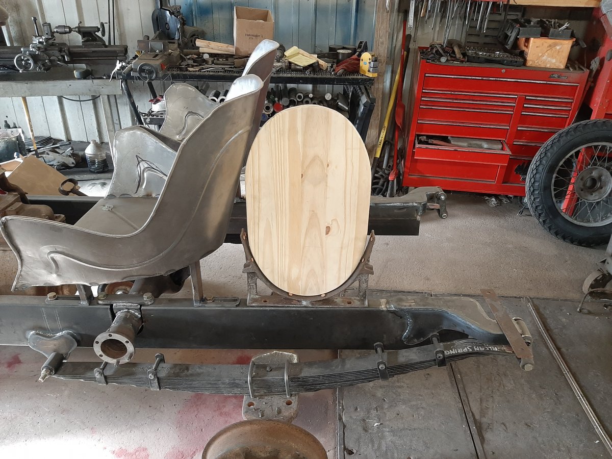

    Started my tank design.
    It's gonna hang around 2 inches over the mounts on each side. Have leather traps holding it to the mounts with beads rolled on either sides of the straps. The end caps will be inset about half an inch with a soldered seam
    I'm debating between copper or steel.

  25. atch
    Joined: Sep 3, 2002
    Posts: 6,187
    atch
    I don't know about structural integrity but polished copper sure would be beautiful.
