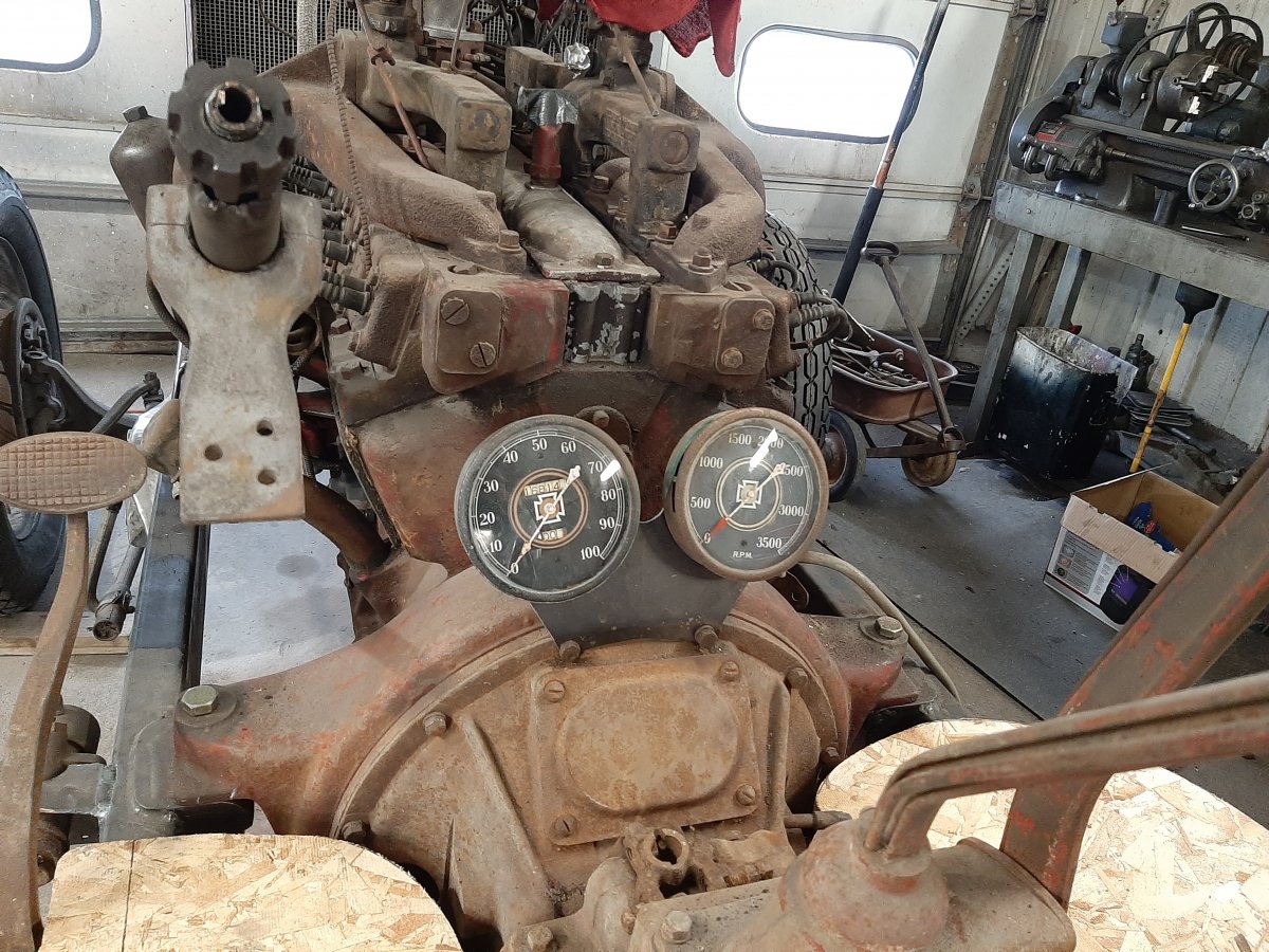

    I had enough time to get my gauge cluster bracket built tonight.

    Just enough!!!

    Hah, seems like a pretty optimistic speedometer for a fire truck, huh? Where does it drive from?

    haha! I wouldn’t be surprised if that thing can do 100 mph if sprocket gearing is done right. One of my favourite vids of prewar cars. Mark Walker is a genius, and if you like the Darracq, check out his GN Thunderbug. One day, I’ve got to get to Goodwood to see these creations in person.

    It drives from the driver seat.

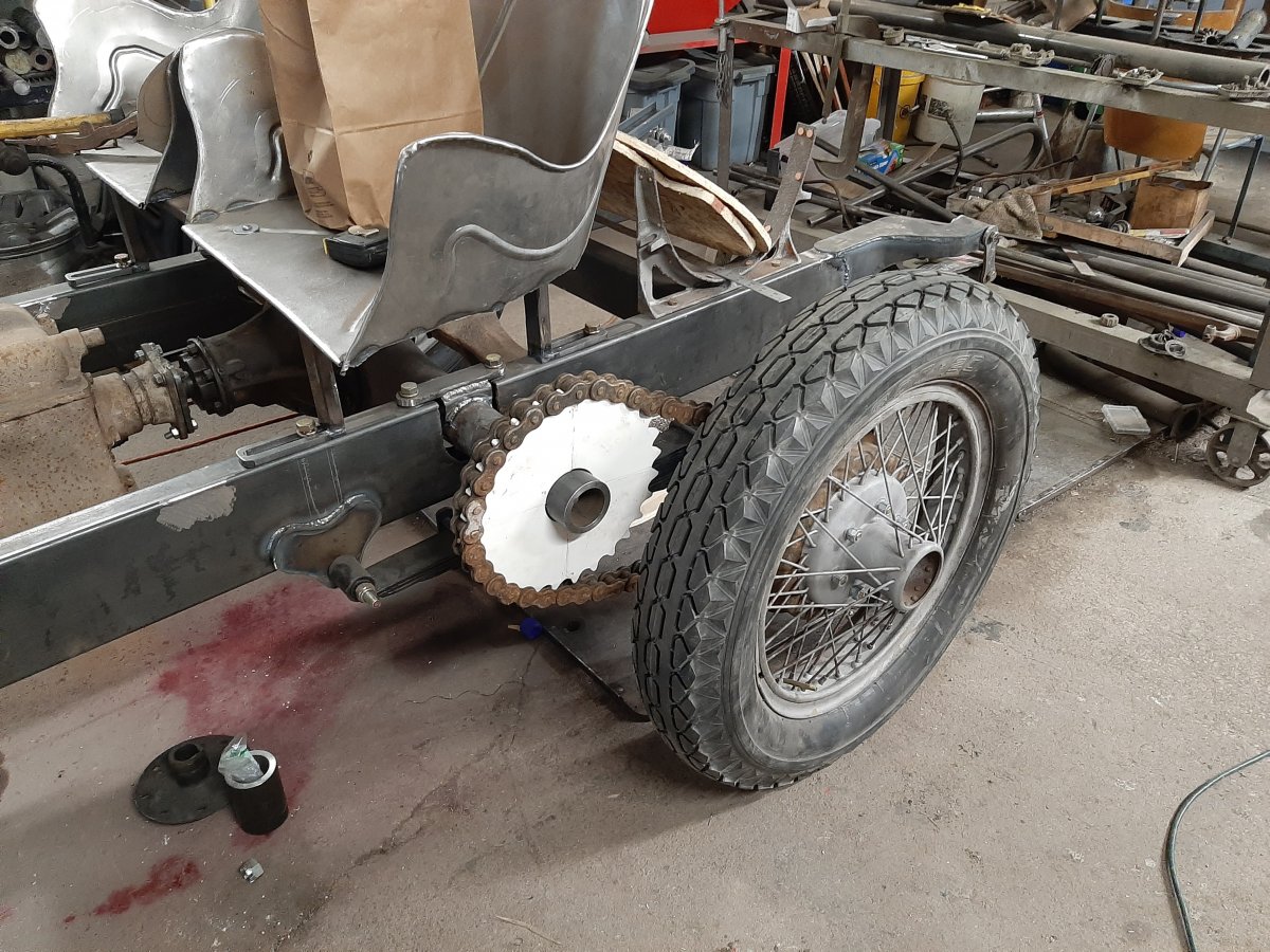

    I got my 3d printed front sprocket today! It looks like it's gonna work great!

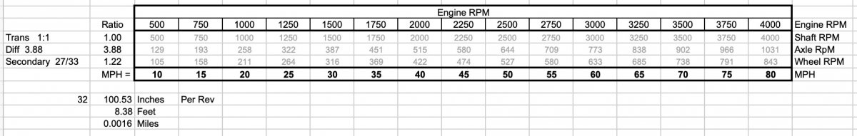

    If anyone wants to figure out my engine rpms at different speeds thatd be awesome lol
    The trans is a 38 American Lafrance with 3rd gear beaing a 1:1 ratio i think.
    The Differential is 28 Pontiac. Ithink it's 3.88 ratio
    The front sprocket is 27 tooth #100 chain and the rear is 33 tooth #100 chain.
    Tires are 20"x6" lucas blackwalls. 32" od
    D'oh! I put them in the wrong order but the results should be the same.

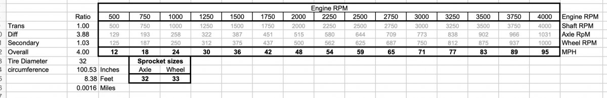

    EDIT: A different version of the same basic thing.

    Looking good. Just a comment about your notch in the frame rail for the axle tube. Not sure what your plans are, but that could be a huge stress riser for cracks to start as it appears as though it is almost halfway through the frame rail.

    Thanks DesmoDog. What front sprocket would I need to be around 2500 rpm at 60 mph?
    You're correct Ziggster. Itll be plated inside and the differential mount plate acts asan upper plate as well.

    I got the same results as you for your speed calcs. I think you would want to “overdrive” the two sprockets, meaning the one attached to the axle should have more teeth than that of the sprocket attached to the wheel. Just swapping the two sprockets will give you an “overall” gear ratio of 3.18. Speed is then as follows:
    2000 rpm = 60 mph
    2500 rpm = 75 mph
    3000 rpm = 90 mph
    3500 rpm = 105 mph
  22. Ziggster

    I can go no smaller than 33 teeth in the rear

    You can up the tooth count on the front sprocket to get the lower ratio Ziggster was talking about.

    If you can manage 40 teeth on tbe driving sprocket and keep the 33 teeth on the driven sprocket you can achieve the 3.18 overall gear ratio.

    With all that torque and a relatively light car, you may not need 2500 at 60. 2000, or 2200 might be fine.

  28. It's bad form to use the same size sprocket front and rear so here's what it would look like with a 32/33 combination.

  29. I didn't see how you are adjusting chain tension? If the distance is relatively fixed between the two sprockets, you are limited to the combinations you can use based on chain pitch and sprocket diameters. There are ways to figure that out too but it's not a five minute spreadsheet. I may already have one that could be modded to work here though...
