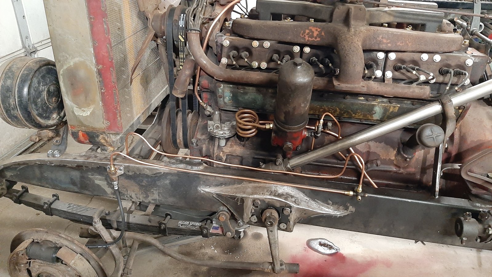

    Got the front brakes in order tonight. Rebuilt both wheel cylinders. New hoses. New copper single flare brake lines!!! ****ing gorgeousness

    Joined: Dec 26, 2006
    Posts: 2,834
    warhorseracing
    from cameron wv
    Are they plain soft copper or Nicop? I would not trust copper tubing and on any vehicle copper will not p*** a safety inspection. I do not want to see any one hurt due to a brake failure when the copper blows out from pressure and brake pressures can be in excess of 1200 Lbs. Per Square Inch.
  7. 51504bat
    Joined: May 22, 2010
    Posts: 5,659
    51504bat
    Single flare??
    Boneyard51, loudbang and LWEL9226 like this.
  8. animal8324
    Joined: Sep 28, 2012
    Posts: 198
    animal8324
    from nj
    They are real copper. The copper nickle didnt look right.
    If i was planning on having this car see any real road service and not have a back up braking system. I wouldnt sacrifice funtion for form.
  9. animal8324
    Posts: 198
    animal8324
    from nj
    Yup single flare
  10. warhorseracing
    Posts: 2,834
    warhorseracing
    from cameron wv
    Thank you Sir. I just wanted to make sure that you were aware of the serious safety issues of using copper. I agree that it will and does look great especially when polished but is and never was designed to hold the kind of pressure that a hydraulic brake system can generate.
  11. noboD
    Joined: Jan 29, 2004
    Posts: 8,994
    noboD
    Cunifer tubing looks close to copper but has a higher burst pressure then steel. All early Chrysler Products with hydraulic brakes used copper. Copper is illegal for inspection in PA.

    Finished the front lines and master resivoir plumbing. She holds the front wheels by hand. I capped the rear line for now. Ill attack them after retro rewind.
    Cunnifer is much lighter in color than copper. If this master cylinder is ever pushed hard enough to build enough pressure to burst this tubing than something else is terribly wrong.
    Posts: 2,834
    warhorseracing
    from cameron wv
    Thank you @animal18324. There is a very big difference between "copper" and "https://cunifer.com/". When you stated "They are real copper." it immediately threw up a safety hazard that I would not want to see you make. Cunifer on the other hand is safe for brake systems and you should be OK as far as your brake system is concerned.
    chryslerfan55 and Thor1 like this.
  15. 51504bat
    Posts: 5,659
    51504bat
    Still would be concerned about the single flares for anything but light use/display. but that's JMO.
  16. animal8324
    Posts: 198
    animal8324
    from nj
    The lines are xopper not cunnifer. The look is more important than reliability to me.
    It's not going to be a daily driver and if I ever attempted something like the great race I would probably make some reliability enhancements such as an all metal fluid resivoir and steel lines.
    That said I will be doing top speed runs and some vintage racing with it.

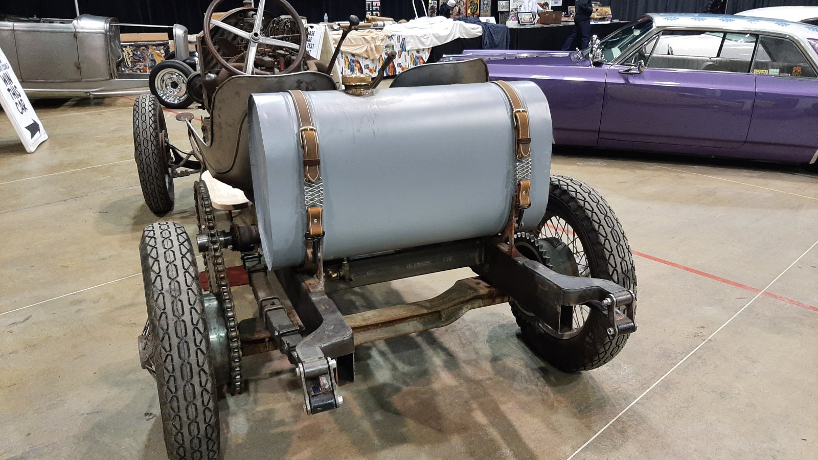

    Tank straps are finished

  22. warhorseracing
    Posts: 2,834
    warhorseracing
    from cameron wv
    Will those springs on the straps keep the tank secure?
    Overall. It looks marvelous!
    VANDENPLAS, Boneyard51, Stogy and 3 others like this.
  23. animal8324
    Posts: 198
    animal8324
    from nj
    I hope they hold it securely

  27. 62pan
    Joined: Jun 8, 2008
    Posts: 910
    62pan
    Love the look but I would suggest taking a little more slack out of that chain. Looks loose enough to jump the teeth.
    Boneyard51 and loudbang like this.

  29. animal8324
    Posts: 198
    animal8324
    from nj
    Nice edit!
    It's name is "The Beast of the Valley? Though
    VANDENPLAS, Boneyard51, Thor1 and 2 others like this.
