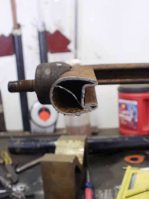

    Next was the chopping and leaning back of the windshield. Or as Wendell put it, "Fabbing 101." I had a bunch of parts from a few different years to combine to make what I wanted.
    Those that aren't familiar with Model T differences wouldn't notice the changes, or that is, how things are mixed and matched. When it's all painted up it'll look like a chopped and leaned wind screen. Mission accomplished!
    Here's what we did.
    We took 23-25 stanchions and a great 23-25 lower frame (still has the channel for the gl***) and zipped off the stanchions at the top of the lower frame.
    Next, after some measuring. We cut off more than half of the upper frame from a late teens (to 20s?) frame. Inside this space a new threaded piece will be installed, rather than fumbling with the old pieces which were a little worse for wear.
    Although they could have been used, it'll be nice to be able to take the screws out at a later date to make repairs and such.
    Here it is, the new top windscreen frame. A little more than 3" of gl*** on the top.
    Once the upper frame was set we could figure how much to chop off the "other" stanchions. Once cut, we plopped them up there for a photo.
    The stanchions (both sets) taper toward the top. So some pie cuts needed to be made.
    Then another test.

    Both sides got the same treatment. Then, a bunch of eying and using the artistic thumb and such until we felt like things were where they should be. We did some measuring too but the "thumb" thing worked so well. :D
    Wendell tacked them up while I asked a ton of welding questions. Below are a some welded pics (before being ground down).
    Next came leaning the windscreen back. Which, to me, was the icing on the cake. It was a little tricky since the door side measure differently then the driver's on these T's. But that's where the "squinting" technique comes into play.
    After cuts and re-cuts we got the stanchions leaned back to where I wanted them. There's enough room between the gl*** and the wheel, if I were to have my hand up there.
    We took apart and ***embled the windshield at least a 8 or 9 times to get the fit correct.
    One of my favorite comparisons. Meet Wendell. :D
    After all the welding some grinding took place. The combination of the two stanchions isn't noticeable other than the top one is slightly wider. It will get softened up and be unnoticeable once painted.
    Below are a couple other shots for perspective.
