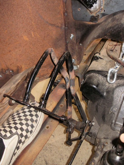

    The stock A pedals needed to be changed. In stock form they'd hit the firewall and the motor mount.
    Above are the stock pedals. We decided to heat and bend the the pedals and the cut off the excess steel behind the pedal.
    One bent, one to go.
    Next, the foot pads need to be cut off.
  4. -Brent-
    Joined: Nov 20, 2006
    Posts: 7,921
    -Brent-
    Once the foot pads were cut off, everything was cleaned, prepped and welded. They need to be cleaned up and will get any additional attention when the car is broken down to be finished.
    Measuring so that each pedal is symmetrical.
    Torch.
    This is how much we removed from each pedal.
    Ready to be prepped for the pedals.
    They look like they came that way.
