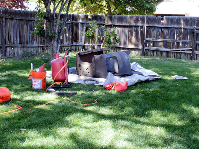

    Here's the latest on the T. I took full advantage of the three-day weekend and set out to get a long list of things done. On Saturday, I spent the better part of the day chasing down materials and running other errands related to this project. I dropped my frame off to the place that had blasted my coupe and picked up sand for my own at-home sandblasting project. A task that I soon won't forget.
    Anyhow, here are some pics... clean ones. Sorry I have no grimy, dusty photos, just take my word that it's a super super messy job. I have a new-found respect for blasters.
    When I was waiting for my too-small air tank to refill I cleaned up a bunch of parts. Aside from the front bones, most of the other ch***is stuff is ready for finishing.

    After two days of a dusty, cuss-filled fight, here's the body ready for metalwork.
    This section is getting a new patch panel made.
    The same goes for this pinhole-filled area.
    The body looks a heck of a lot better though, huh?

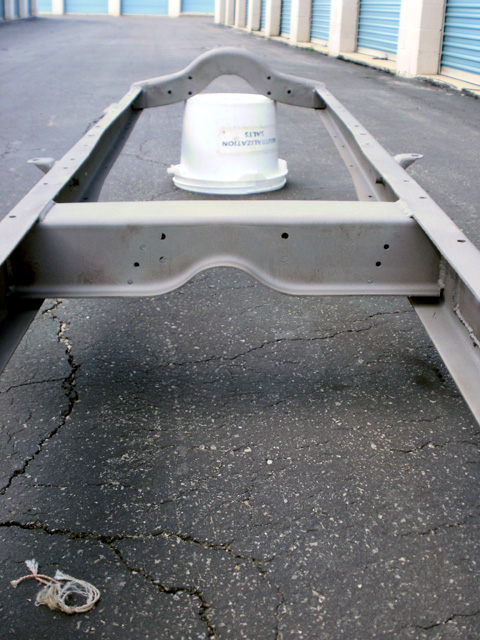

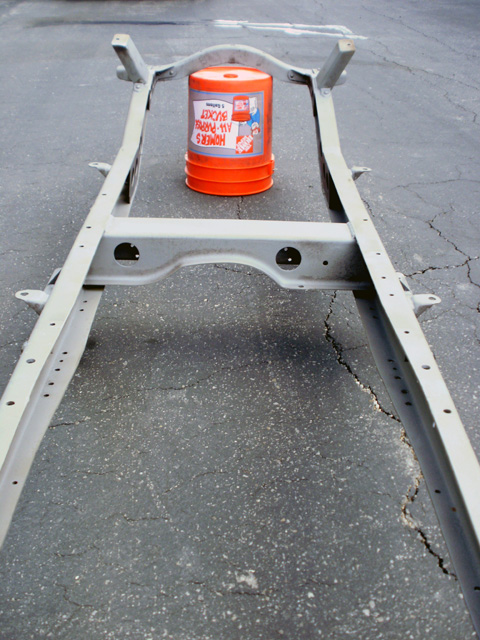

    Here are some detail shots of the frame and some stuff that was done after I broke down the car.
    I popped some holes in the back boxing plate to make it easier to keep it clean... plus it looks cool. :D
    I trimmed off the ends of the rear cross-member where it interfered with the how the turtle deck will mount.
    I blended the weld. Not to worry, there'll be a full bead in the seam below.
    I made some notch pieces (out of remaining T frame steel). This is roughly where they'll be cut in. The headlight mounts will be welded right above this. I'll have this stuff ready to rock by the weekend.
    I wrapped the rod end balls in electrical tape so they wouldn't get damaged by the sand.
