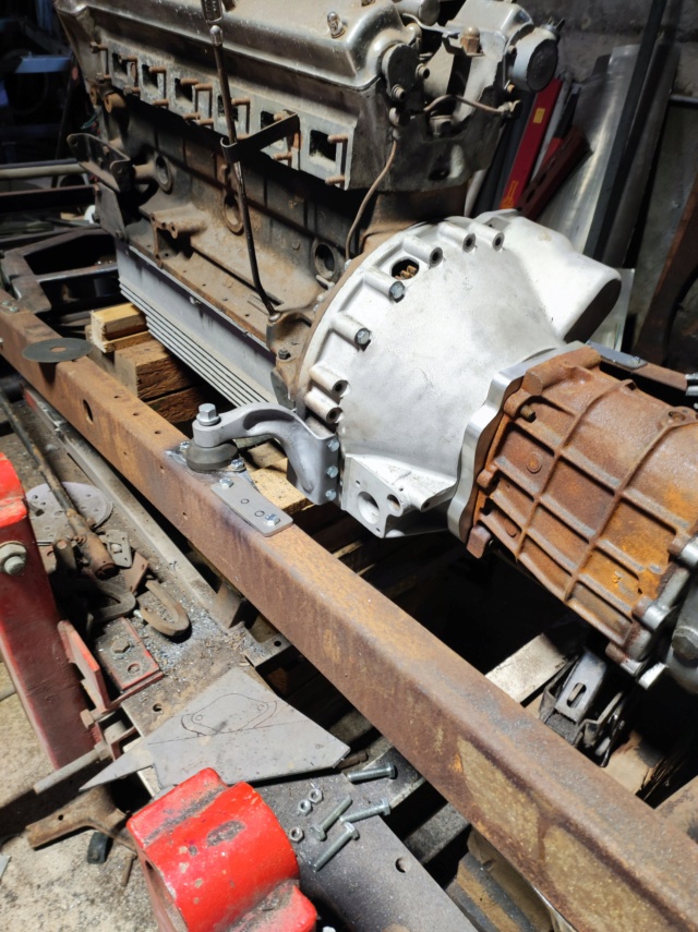

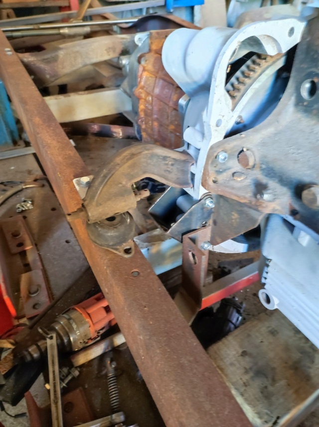

    So the engine is leveled and centered I decided to finalize the trans mount to stabilize a little the whole ***embly before I tackle the motor mounts.
    I built the last crossmember too, the original Zedel one was too far gone to use.
    Now here's how I'm gonna use the banjo hockey sticks with a little cutting, welding and grinding that is pretty much the final product.
    I really like the way it looks. On the floor there's the modified model A battery tray I will use. I found the perfect spot for it and it will be as accessible as on a stock model A lol.
    And here's about what it will look like once done. It still needs to be shortened by about 1" and welded to the bracket I made that bolts on the trans and engine just as Jag did it, I'm also using original Jag bushings.
    The pain in the *** will be finding the correct bolts because everything non metric, especially oddball stuff is extremely difficult to find if at all in the EU.

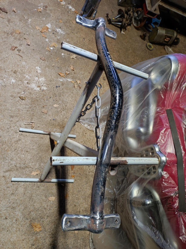

  8. chrisp
    Joined: Jan 27, 2007
    Posts: 1,359
    chrisp
    The last 3 weeks didn't go as planned : like a complete idiot I fell into a hole I dug and hurt a knee so I couldn't work, it still hurt but I'm back at it.
    Anyway here's the first finished rear motor mount
    Once in place
    I realy like the end product

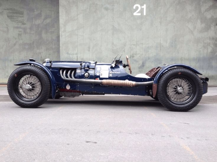

  15. @chrisp , heres a hood ornament for your Renault.
    chrisp likes this.
