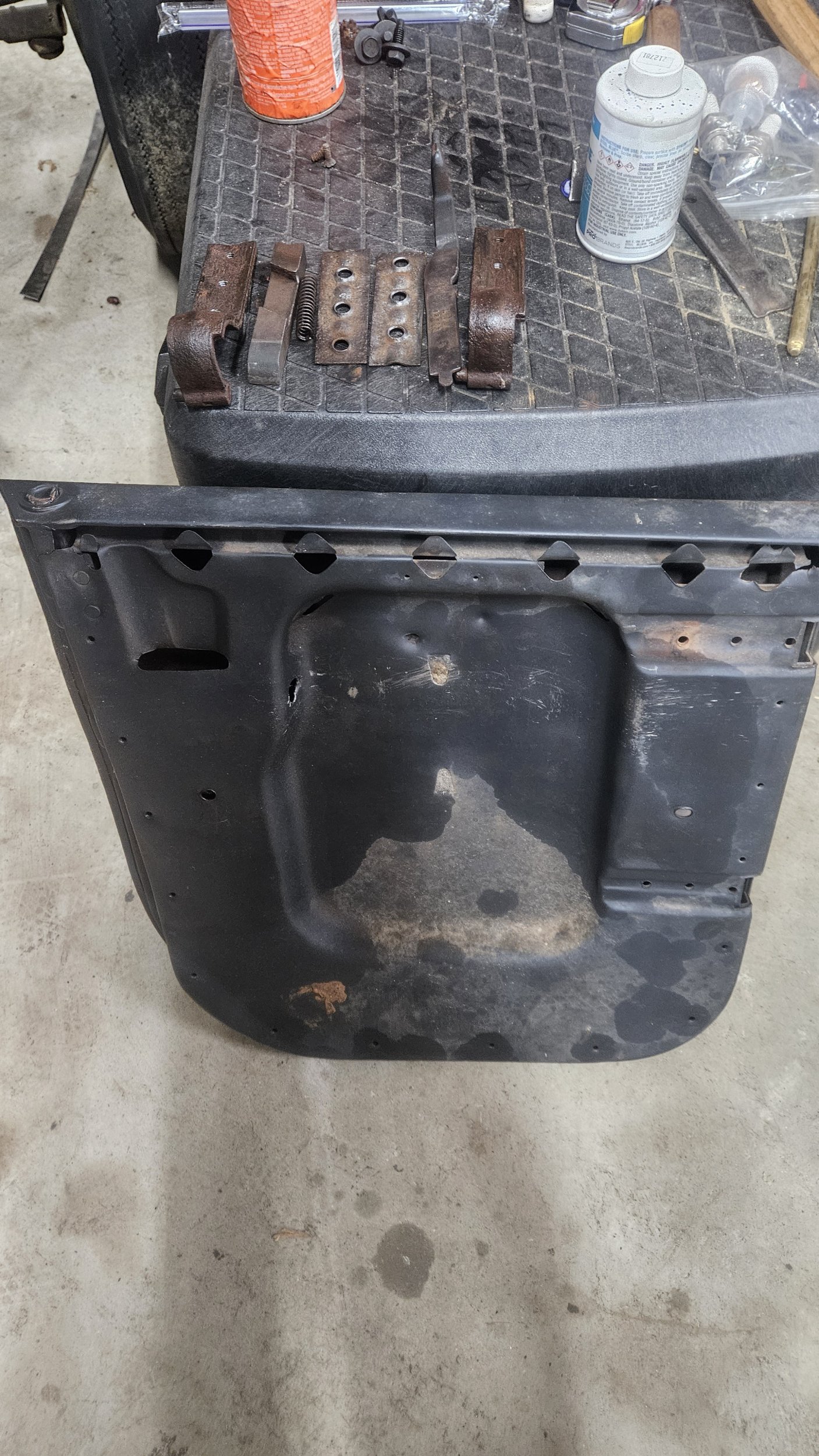

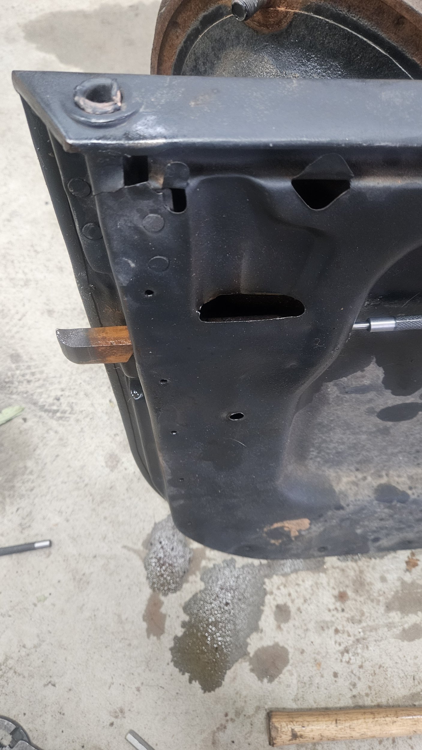

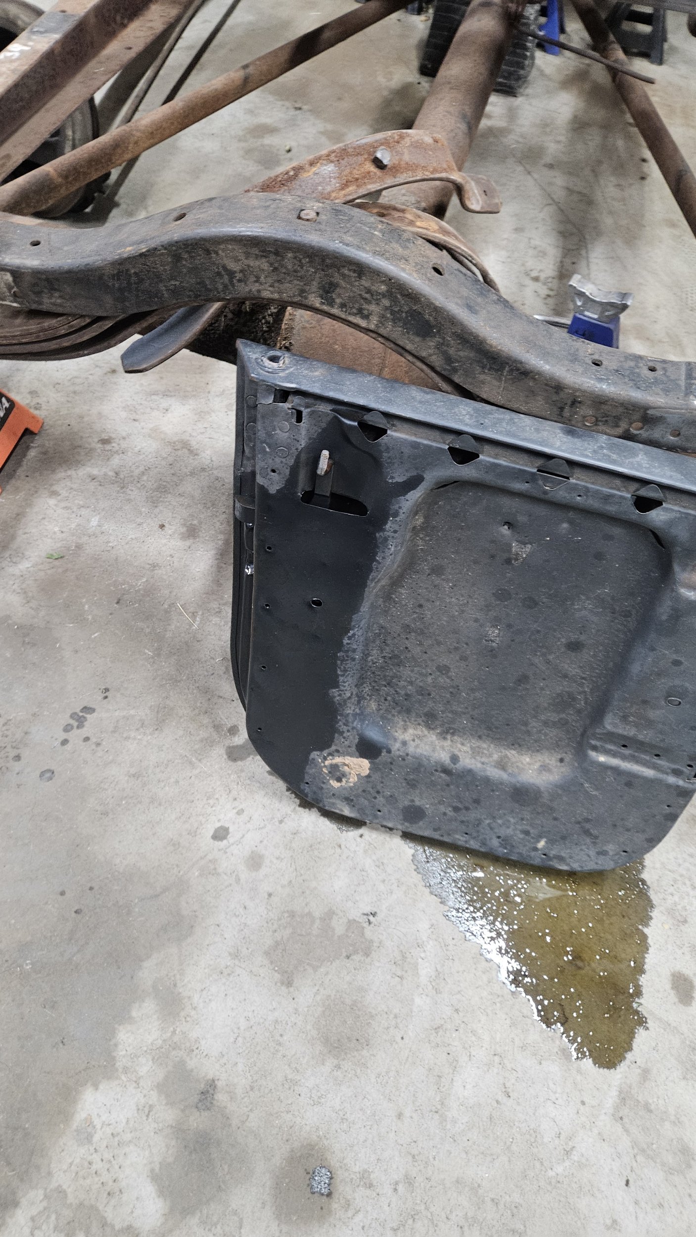

    Here's my version of door repair. @lucky, being the truly wonderful guy that he is, gifted me this pristine door (to me) to replace the one that came with the car (which had a family of mice living in it that escaped out the bottom once the car was put in my garage!). I had to transfer the hinges and loosen the latch.
    Spray copious amounts of "Knock 'er Loose" and PB Blaster into the affected areas. Allow to brine overnight.
    While that's brining, center drill the hinge screwheads of the old door, then follow up with a 11/64 drill. Screws are 1/4-20, so that gives some wiggle room.
    I skipped a few pics, but, once the heads are drilled off, the screw remains in the hinge. Gotta get them puppies out.

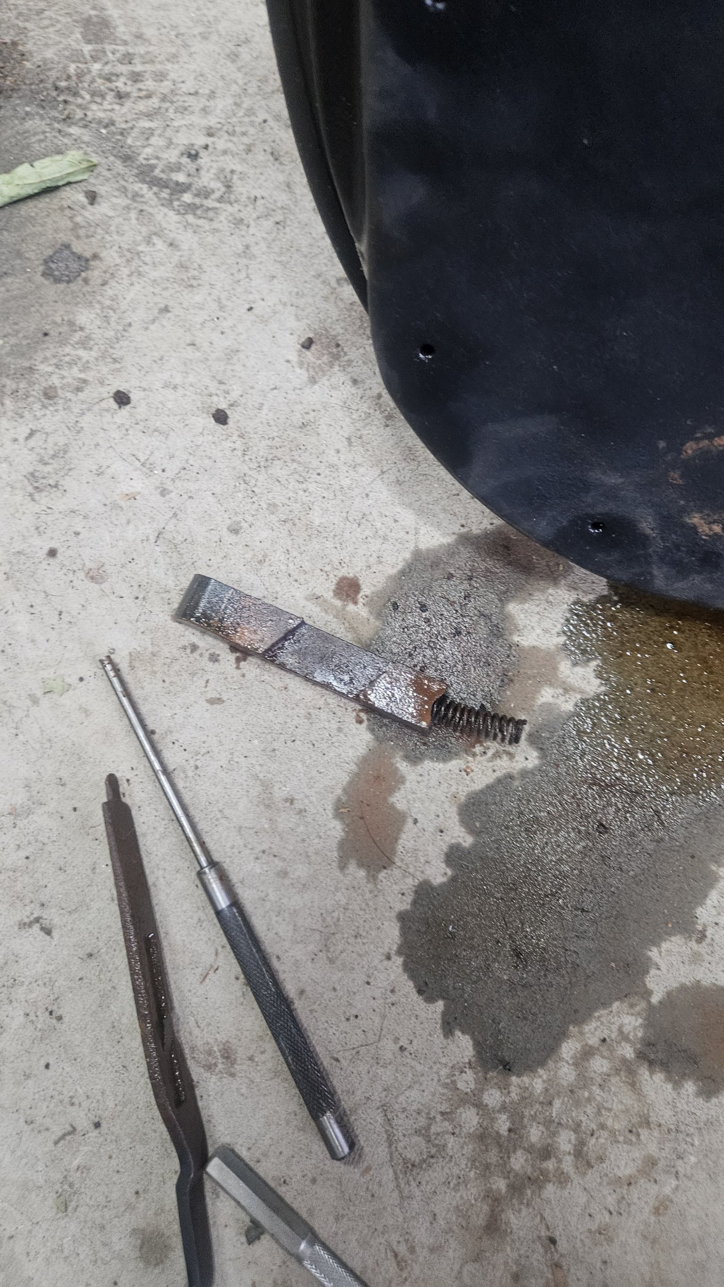

    For the latch, I drilled a hole inside, parallel with the travel of the striker. There's the outer skin layer, then the inner structure that encases the striker.
    This shows what I mean. Basically gotta punch it out. Beat it with a hammer back and forth, spray copious amounts of stuff on it, removing the handle once it starts getting loose.
    I'm not great at keeping up with pictures, but this is the end result.

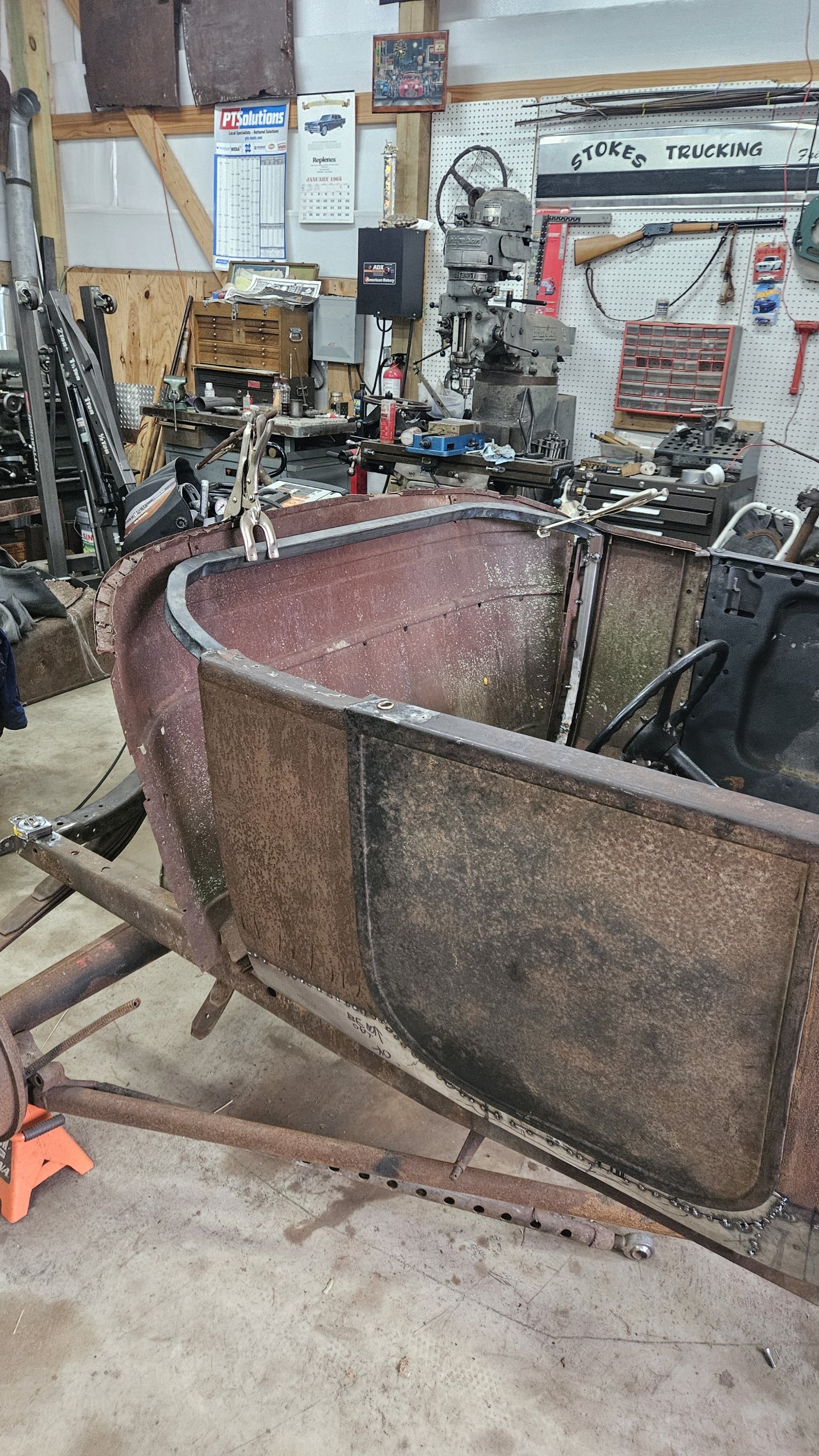

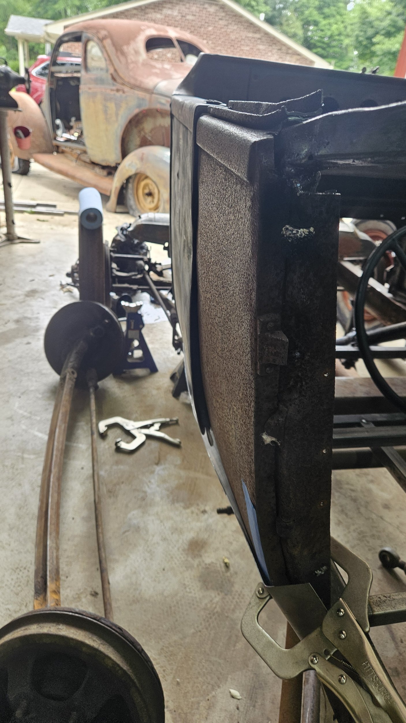

    Next up, re***emble and see how far off it is from the body..
    Fancy 1/4-20 flathead screws from Menards (woo)..
    Same issues as the other side. Looks like someone pushed a grocery cart into this one.
    Front lined up pretty well, with a little bit of conversation via sign language..
    Much closer. Let's see if I can post a video.
    P***enger side:
    https://www.youtube.com/shorts/nE2g5zqaEZ4
    Driver's side:
    https://www.youtube.com/shorts/rlrnT924jZw
    dwollam, Outback, flyin-t and 11 others like this.

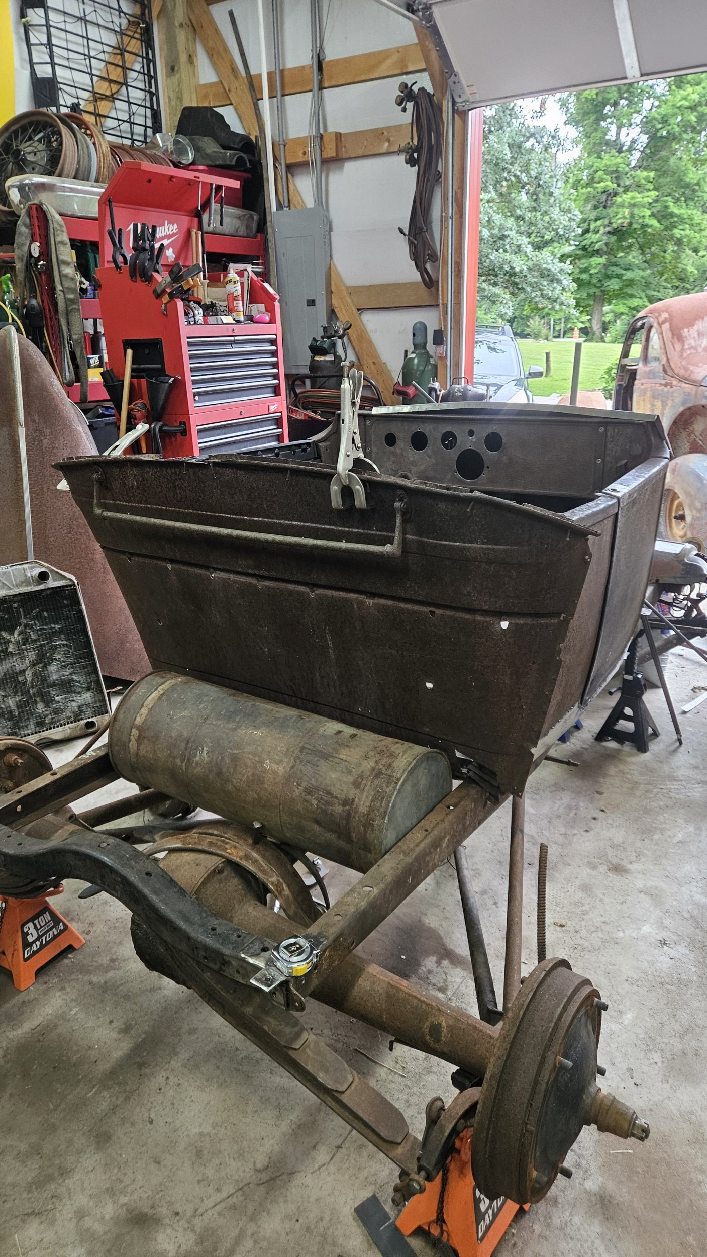

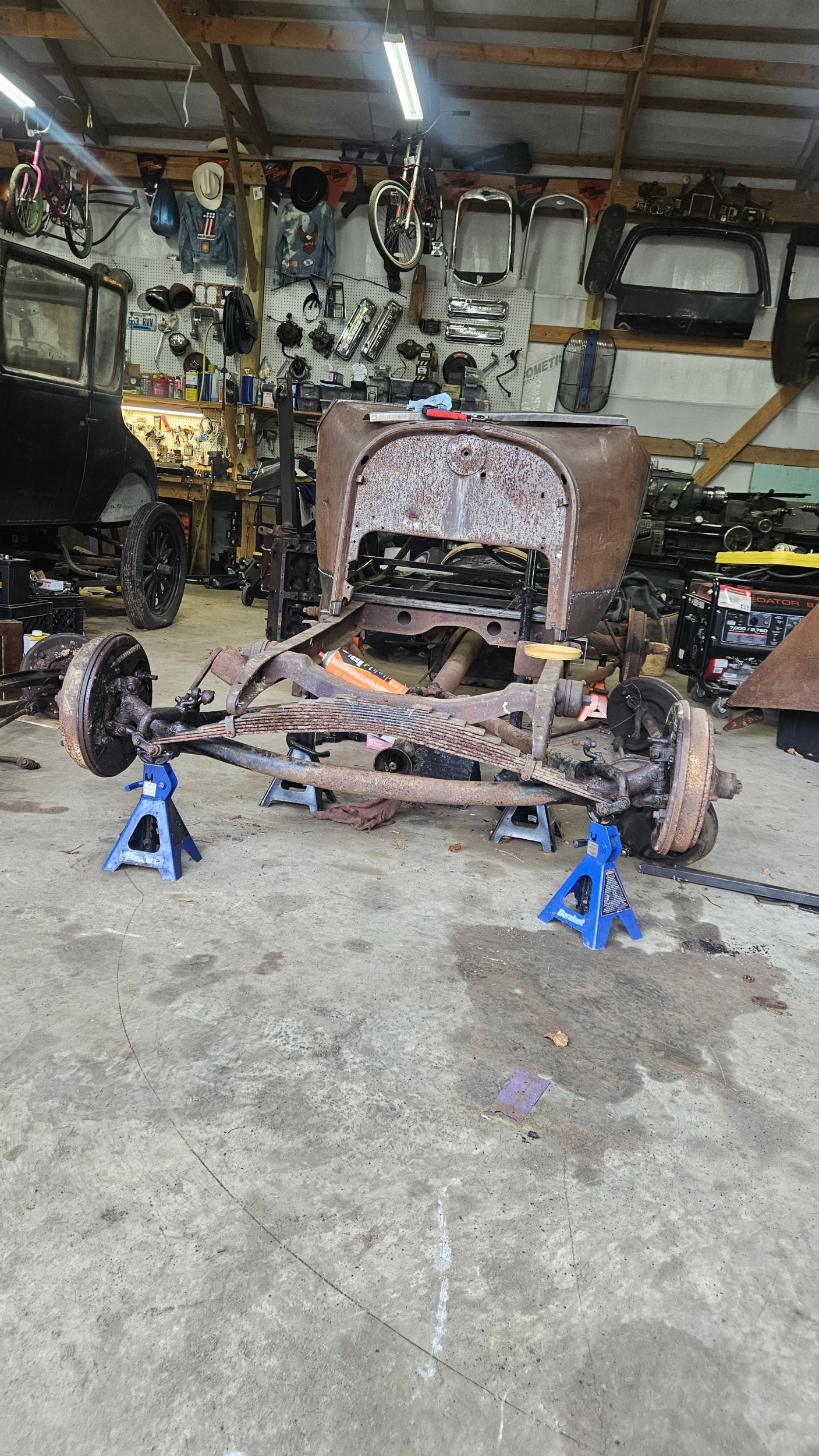

    First, thanks for compliments and encouragement from everyone. Other than several unforseen welder issues, its been a lot of fun so far, especially for a car I really wasn't that in to initially.
    Aight fellas...I'm at a bit of an imp***e. I felt like I was going to make my own rear panel with one or three pieces of sheet metal. Then I thought of the piece it came with and figured I might be able to make it fit...which I believe it could, with some work. So, I'd like some opinions on this; how did or would you do this rear panel? I'm sure there are other options I'm not thinking of, and some I'm not capable of doing.
    Top pics are the panel I got with it, bottom three are a mock of a skeleton I'd wrap 18g around to make a rear.
    It's admittedly pretty cool to have a fake back panel and get a feel of the completed body.

    That is actually a front seat back. Was it original to that car? Very easy to make it work nonetheless.
    Outback and fatassbuick like this.
  12. fatassbuick
    Joined: Jul 6, 2001
    Posts: 1,081
    fatassbuick
    from Kentucky
    This was a touring cut in half, so, yes, it's a front seat back. This is what came screwed to the back of the body when I got it. Seems like it would be easier than making one or more all new panels, since I don't really have much for sheet metal tools.
    I guess I've got nothing to lose trying to make it work..

    Picked up the last big piece to the puzzle yesterday. The final verdict is in! Wide 5s and cable actuated mechanical brakes it shall be! 20250708_193937.jpg 20250708_175711.jpg
