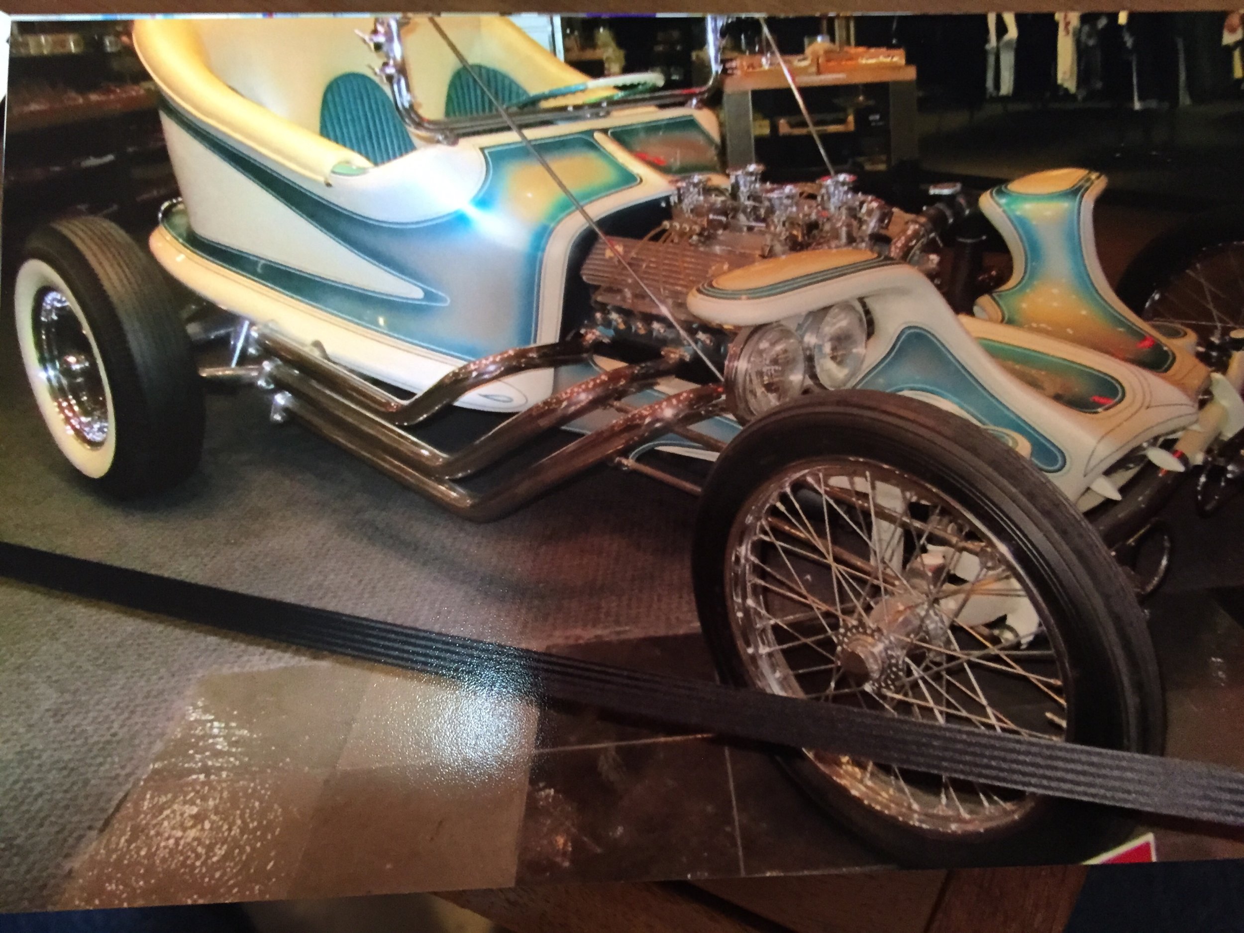

    In my humble opinion, the Dodge cowl & windshield is the best looking of the early cars. Checkout a movie called “The Lively Set”. That bucket was built using a Dodge cowl. Also, checkout Ed Roth’s OutLaw and its cowl & windshield. IMG_2034.jpeg

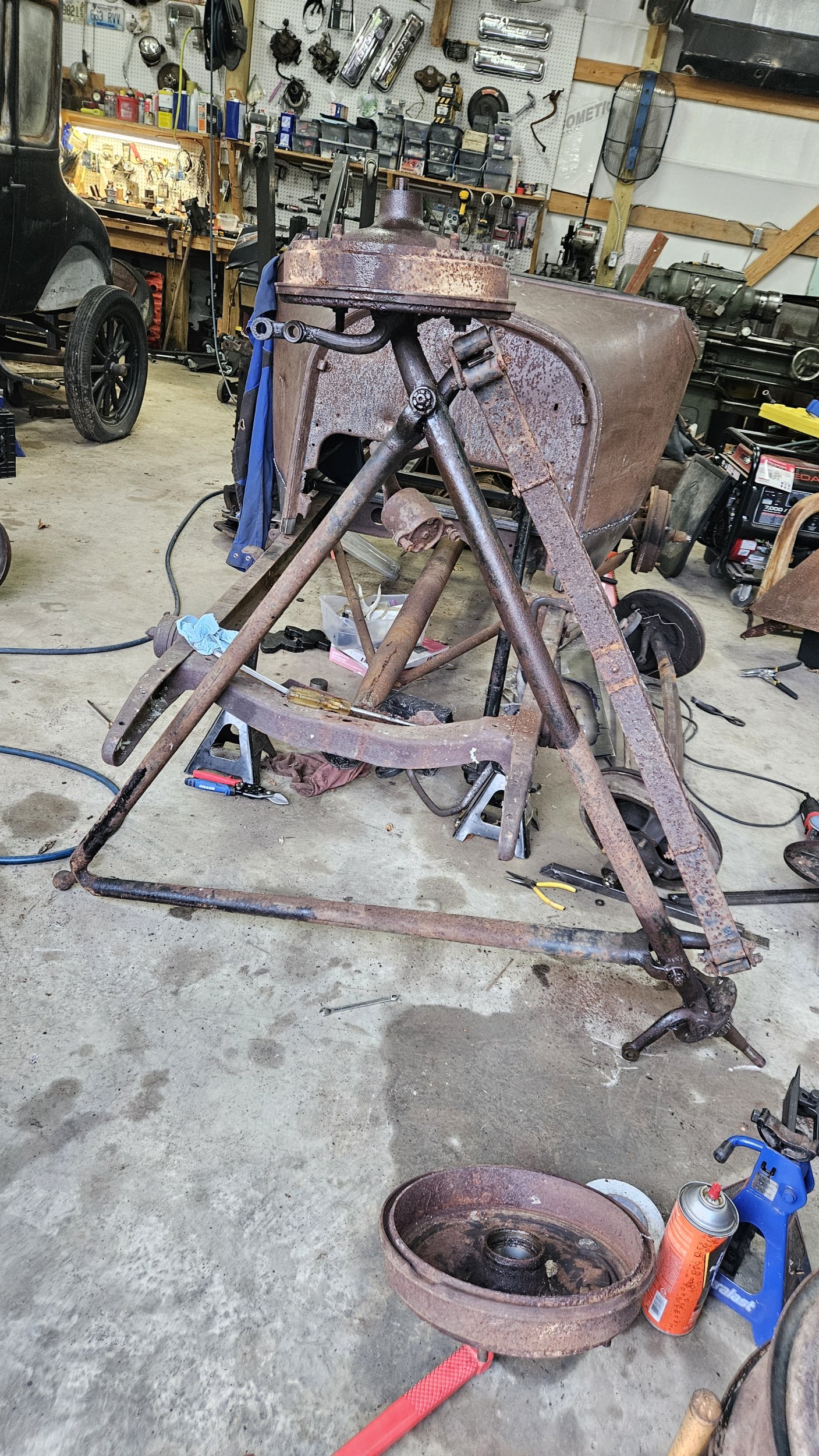

    I'm not the fastest turtle on the log, but I eked out some time to get side two tacked in.
    Also started taking the axle apart. She's a little tight, but some magic elixir will help.
    Poured half a jar of poor man's Kroil into the spindle and let 'er eat. DS came right apart, but I think due to not having an brake hardware inside.
    I'm hoping my new shift makes finding time a little easier. I reckon I'll sleep when I'm dead.

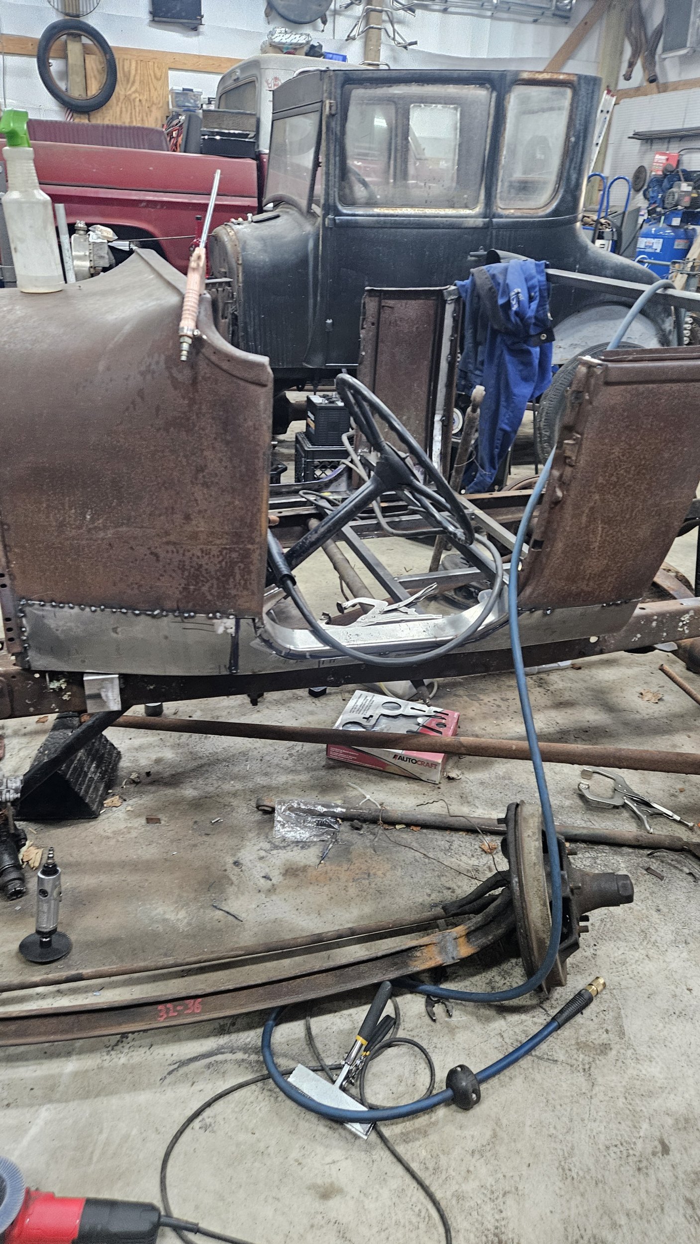

    Anywho, here's a bit of an update.
    I decided to stop clutching pearls and terminate the body with the piece I already had. I'm guess this is never going to be a Rodder's Journal feature car, I am not a body man, and this is not a pristine car to start with...so here it is.
    Messing around with the turtle deck height. If I Z the frame, it will move it up around 3", unless I narrow the rear of the frame....etc
    20250828_170837.jpg 20250828_174257.jpg 20250904_175852.jpg 20250904_175904.jpg 20250908_212048.jpg 20250909_194653.jpg
    The last two pics are my new and improved front spring mount. We'll see how everything sits once it has weight and a full spring pack mounted up. Nothing is forever.
