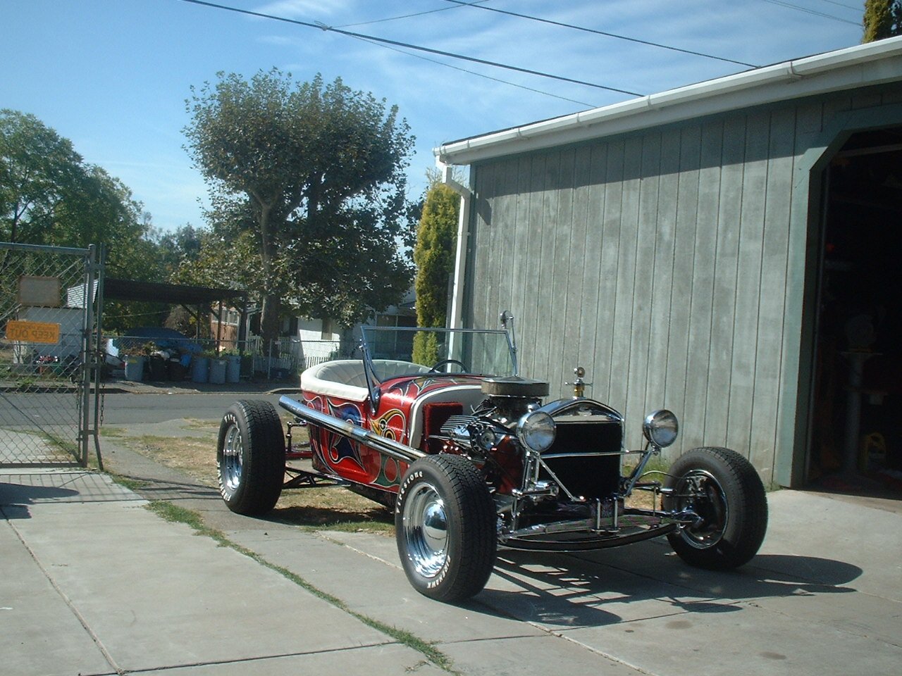

    Just heard about this thread and figured I should chime in.
    Anji is a close friend of mine and a fellow Swanx member.
    In 2005/2006 I was fortunate enough (with the help of her father and a couple of our club members) to restore this car back to the way her grandfather had it in the 1950's.
    The car was originally built in Vallejo in around 1945/46 by Paul Werdig and was powered by a 21 stud flathead.
    When Anjis grandfather got the car in 1948/49 it had a Hispano Suiza aircraft engine in it. The story from family members was that no one could get it to run, so out it came. In went a 297" flathead with a S.C.o.T blower.
    In 1959 the flathead was swapped for a blown 331 Caddy (bored to 365). The Cad and a B&M Hydro were still in the car (less blower) when she found it in 1997.
    To answer a few of the concerns...
    The body was not narrowed. After stripping the paint and upholstery it appears that they shortened a T touring body.
    A '25 T truck frame was used, stepped front and rear. The rumor was that they used 1/2" armor plate to box the rear of the frame. When drilling mounting holes for brake lines I found this to be true.
    The car is a '27, but somewhere along the line it was registered as a '22 to be able to run CA Horseless Carriage license plates.
    The chrome (actually polished stainless) box on the firewall is the front portion of the battery box and was installed in 1949/50.
    First pic is from around 1973, after the T was sold out of the family.
    Second pic is how the car looked right before we tore into it for the rebuild.
    Fortunately, with all the upgrades (or downgrades), the cars structure wasn't changed much over the years.

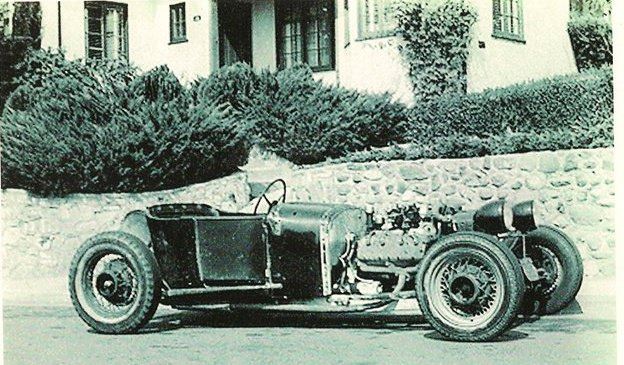

    Here is the earliest pic they have of the car, taken in 1946/47.

    Very cool car indeed. I was going to say it was an ex tourer and not narrowed as the dash has the 5 screws along the top as does mine, I just checked. JW
