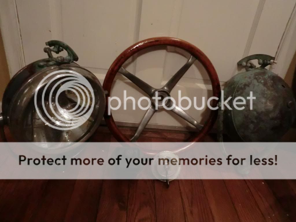

    I've had these two old br*** One-Mile Ray marine spot light shells laying around forever. I've just found my new headlights. I'll have to find a matching reflector and ring for the other bucket. I'll put 1920's car headlight lenses in them. I also got this 17" aluminum and wood steering wheel today. The 1910'/20's cast iron foot starter and the 1920's magneto switch came in off of Ebay.

    I got the steering wheel mounted today. I just wanted to see if it would fit and it did! I'll pull it back off because I don't want to leave it out in the weather. I also got this neat long sight gauge that I will be mounted to the side of the gas tank. I found it and this small oil flow gauge on Ebay.
