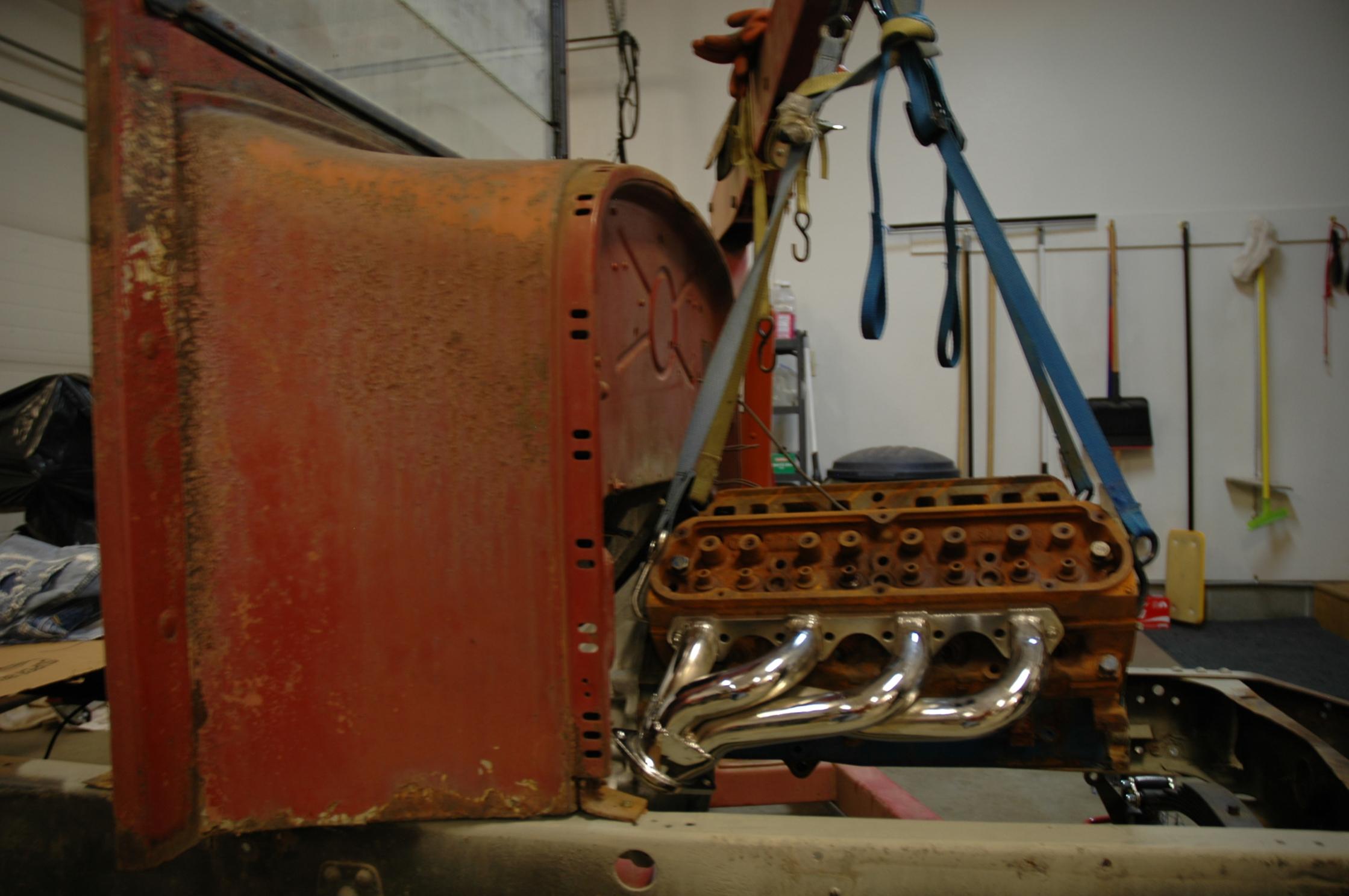

    Frame was 3"x6" stamped rail. The truck sat a towering 25" off the ground so I cut it down to 2" at the crossmember. I dont think it would have been strong enough if i boxed it with 1/8", so instead, I made it square via 2x2x3/16 square pipe. The opening will be boxed, along with the rest of the frame.

    Here is the frame turned right side up and at ride height. Going down to Arizona for christmas and gonna bring back all sorts of goodies. More pictures to come after christmas!
