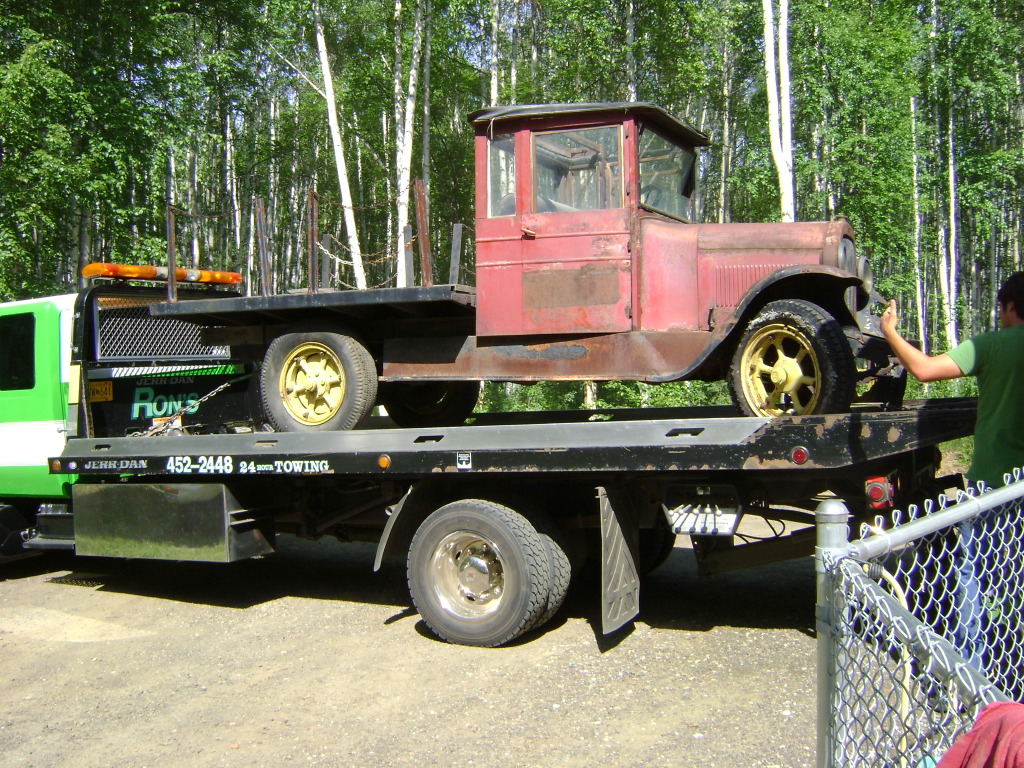

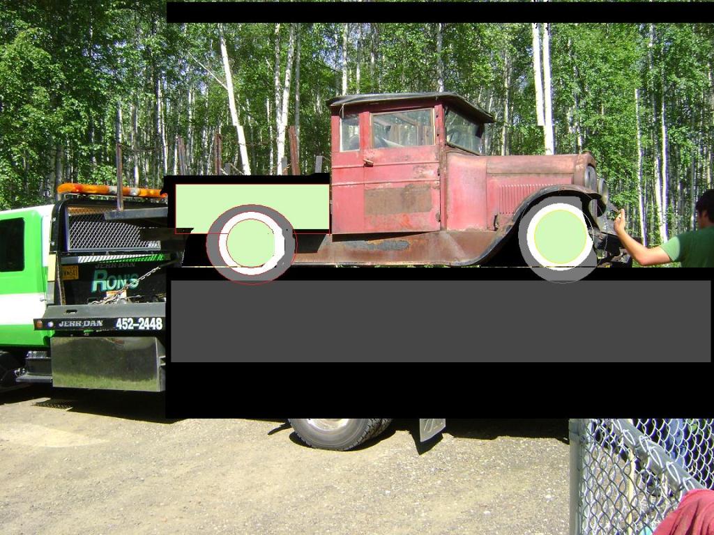

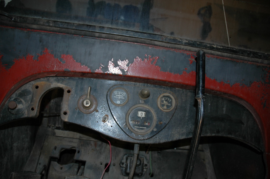

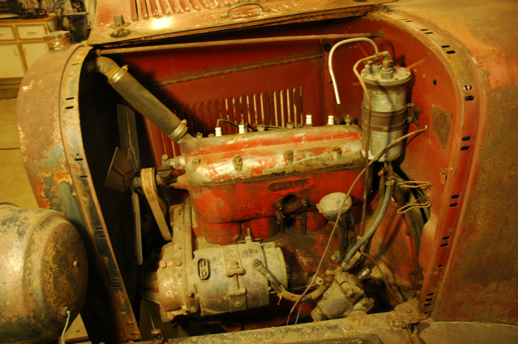

    In its original condition. Being torn apart.... again, purists im sorry.

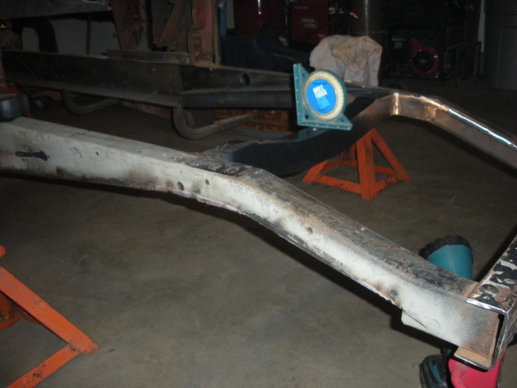

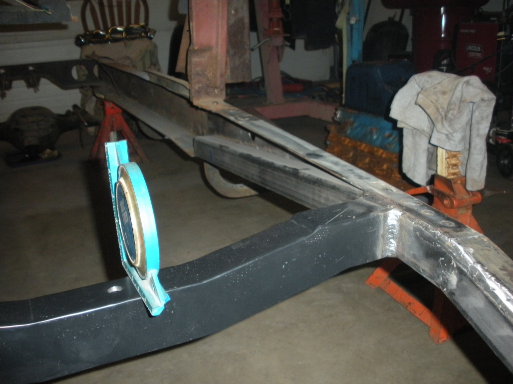

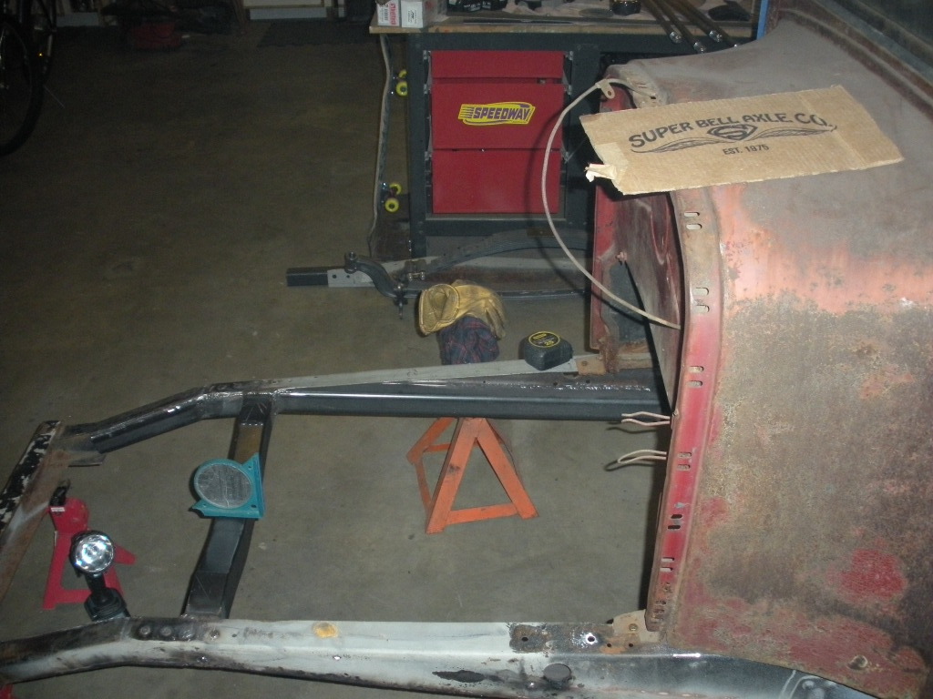

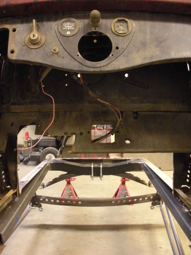

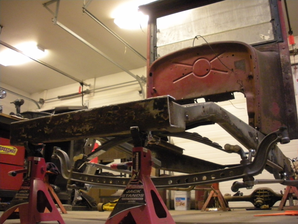

    Frame has been re-crossmembered with a cheater 'model a' copy. not as neat but just as effective. 3 degree rake accounted for so dont worry if you notice the lack of plumbnesss

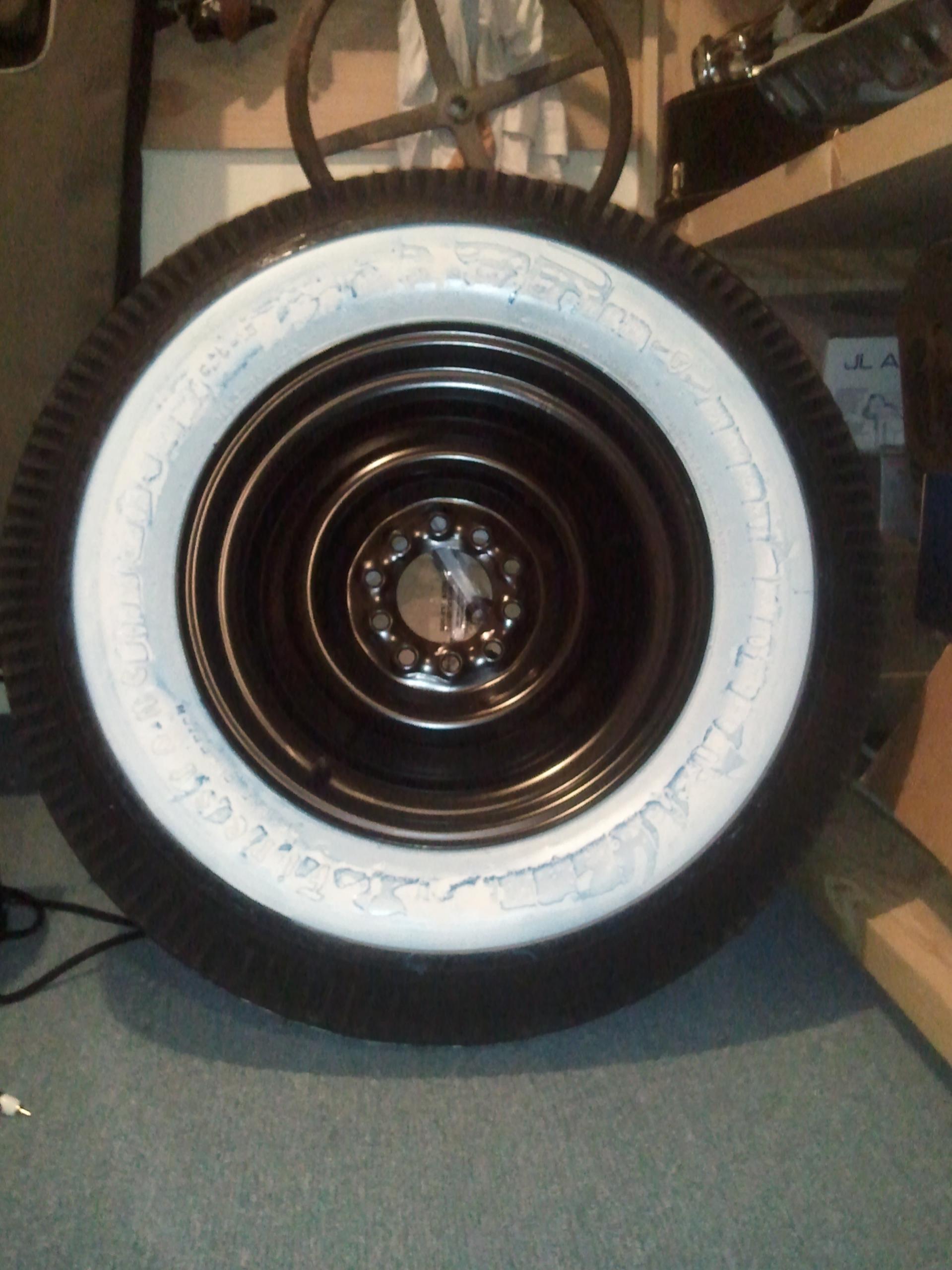

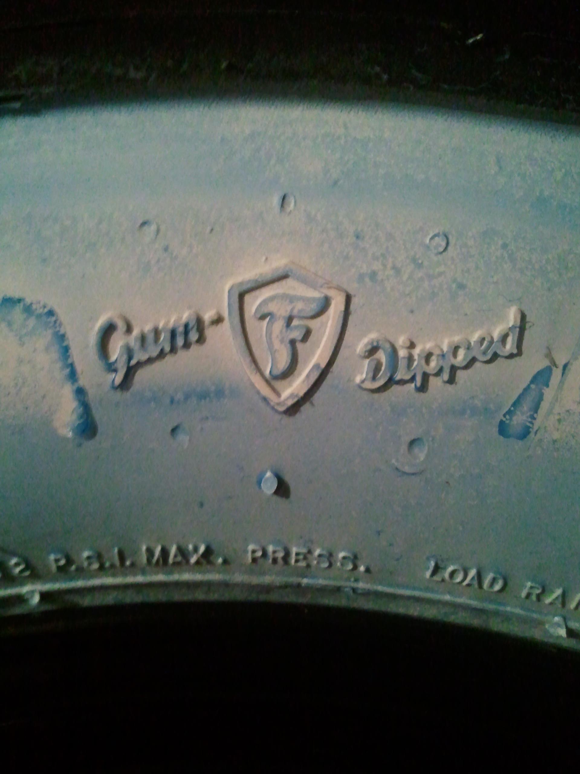

    Got my firestone pie-crusted white wall sneakers in from the freight company. Coker helped me out with shipping, not many companies like alaskans.
    15 / 6.70 's (2 11/16")

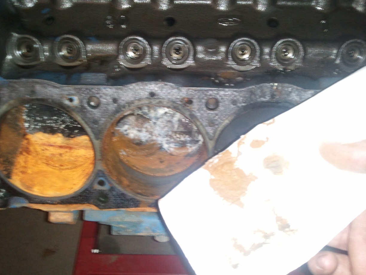

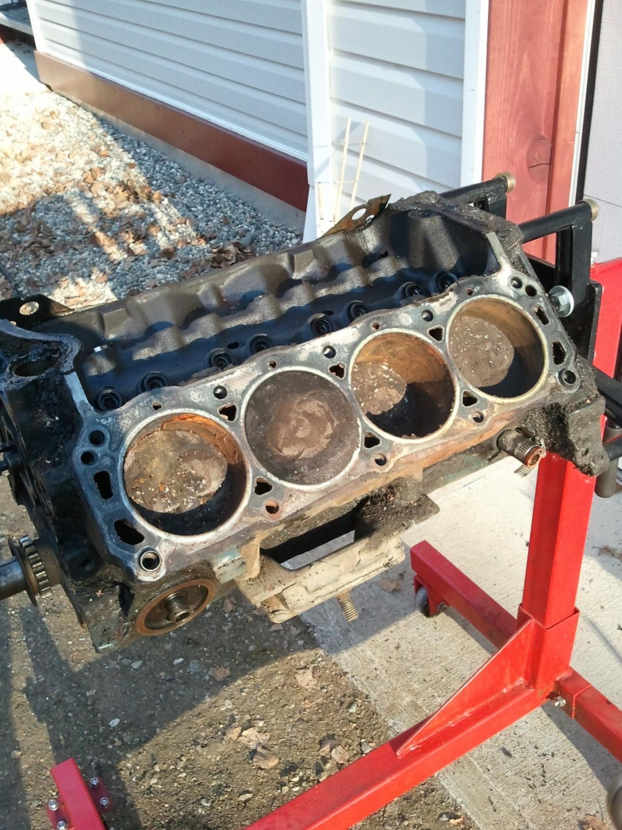

    1980 302 try #1 rusty as hell and 60 over so noooo good
    1972 302 ford try #2 lightly rusted and 9/1000 wear ready to be torn down

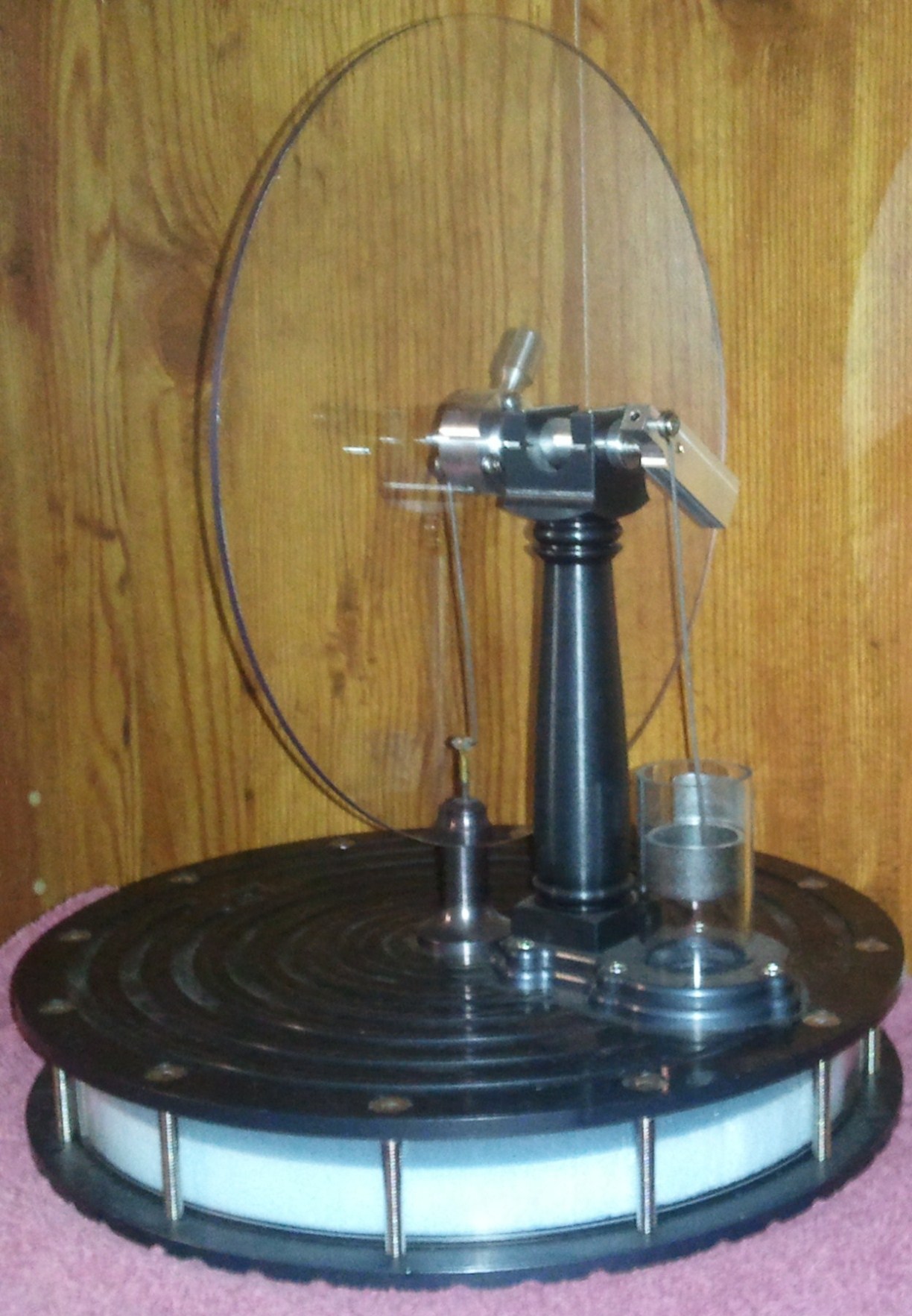

    And as a side note I built this stirling engine in the university machine shop. It runs good on a temperature differential of about 10 degrees

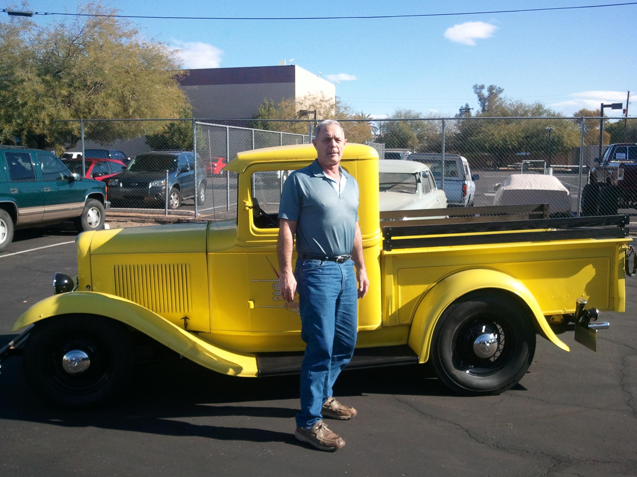

    The look I am going for- out at so-cal az in phoenix, and dad
    I dont know whats up with this, I tried to delete these pics uploaded by mistake but they remain so enjoy??

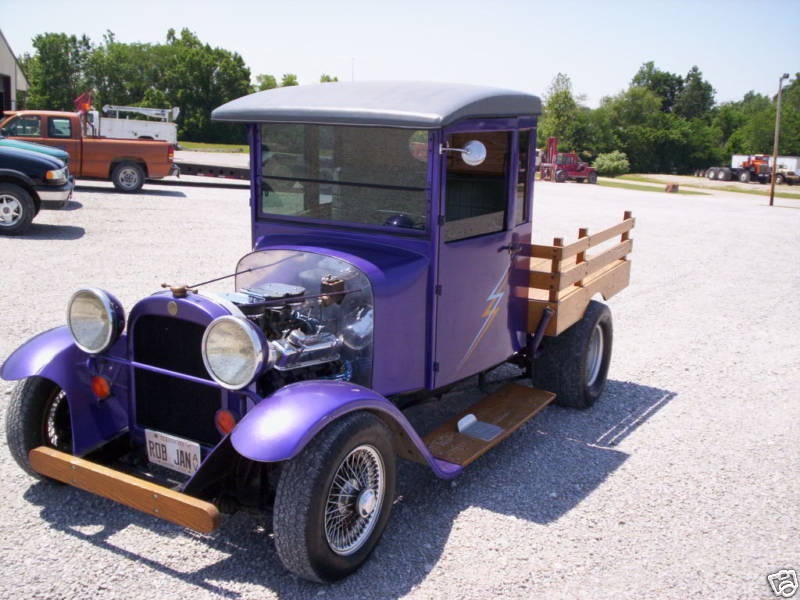

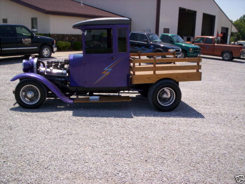

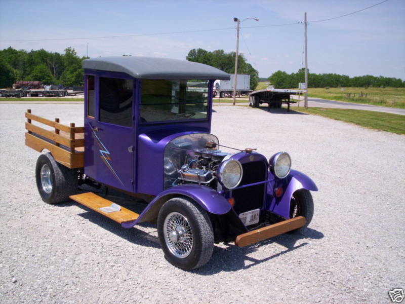

    Here's a few pic of a 1926 Graham, I had 2 chances to buy it and p***ed!
    There is a "LONG" story about how this truck has p***ed through, and affected my life since I was 16 years old...
    Anyway, the truck was built in 1972-73 by a good friend of mine and his brother-in law (it was his brother-in laws truck), it was finished up the night before they left to go to the Street Rod Nationals, they drove it 450 miles to the nationals in Tulsa, OK on its first time out. How crazy was that?
    The truck had all cutting edge tech for '73... Big Block Pontiac with a tri-power, 4-speed trans and custom built ch***is with XKE Jag front & rear suspension, knock off wheels and one off 10" wide spokes on the back.
    The wild thing about this story is everything except for the original engine still exists on the truck!
    Hey just wanted to share, I've always loved these trucks and kick myself every time I think about it.

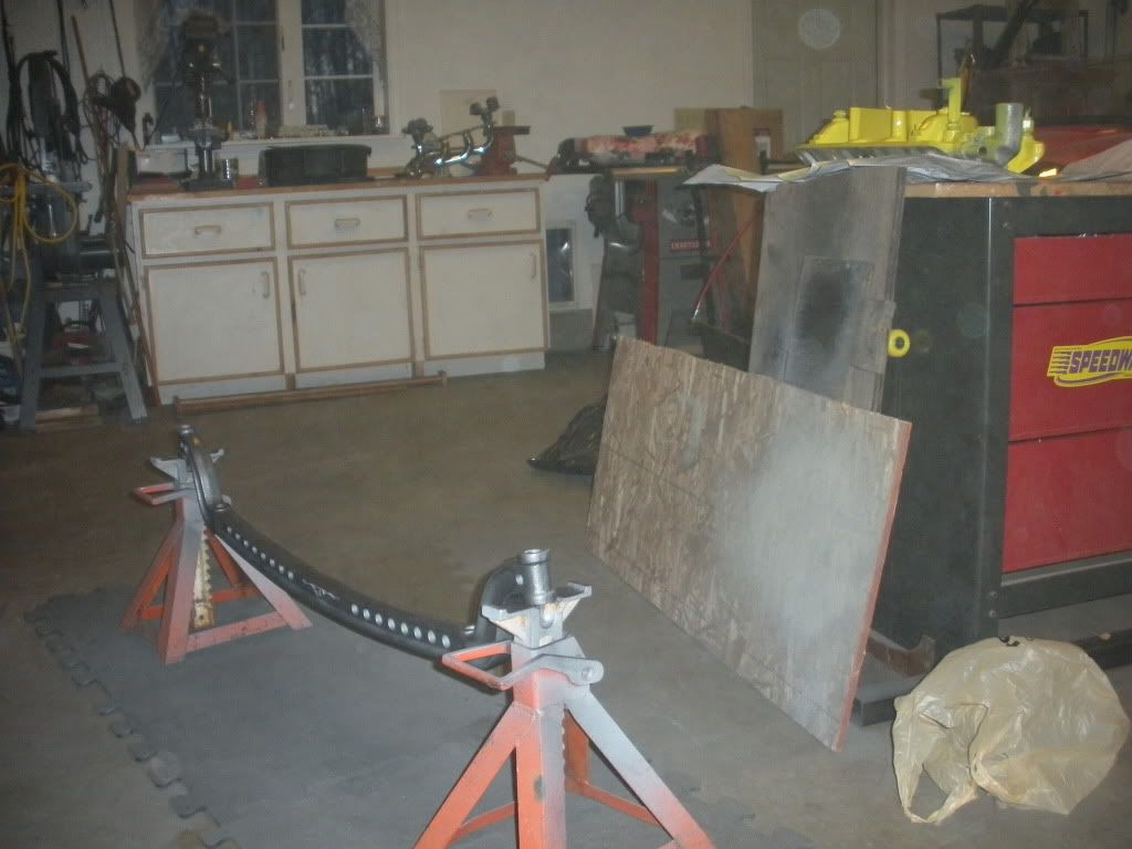

    Pete and jakes model a front plain drilled solid axle goodness. Next are motor mounts and trans. mount.

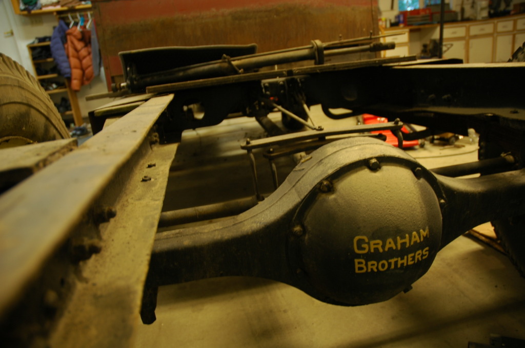

    Just got the Graham records for what serial numbers were stamped on what dates and can say for certain this truck is actually a 1926 Graham Brothers Truck made in late April/ early May of '26.
