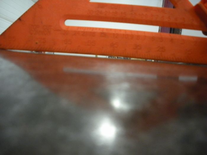

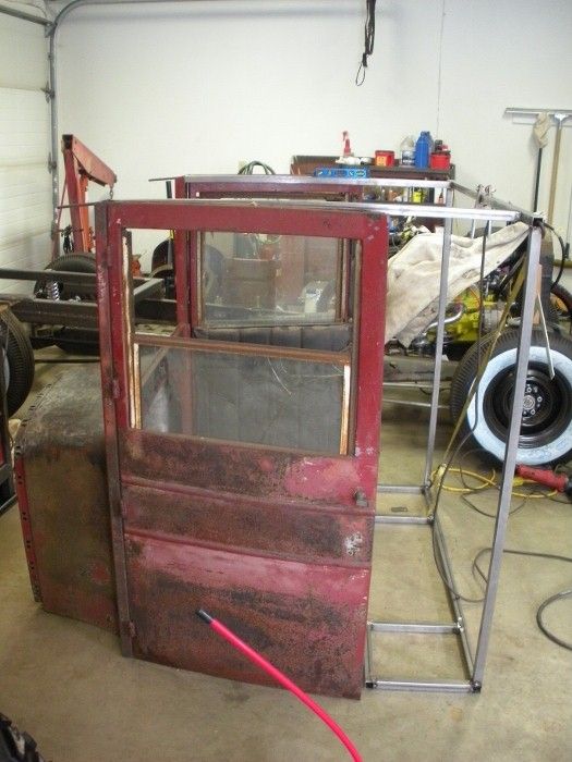

    Here is a tiny bit of progress. The floor skeleton is temporarily tacked into position and the dents in the cowl are coming out nicely.... But because I have no metal working experience I planished the top too much and sorta wrong so it's alsmost flat. It should be a "reverse curve."
    I should have shrunk the lows instead of planishing them... doesnt make sense to me but some sheet metal guys are giving me the run down.

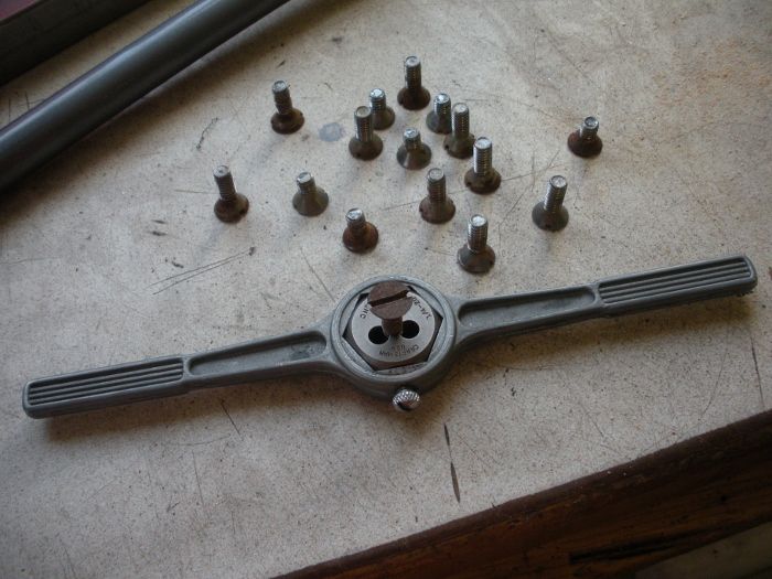

    Here I got the doors ready for temporary hanging. I need new hinges, but I will have to make them later... posibly buy some T hinges from macs and modify them. The screws went into a VINEGAR bath (I hate plain vinegar for some reason) and an hour or so later they were nearly rust free. Then tap-n-die and install.

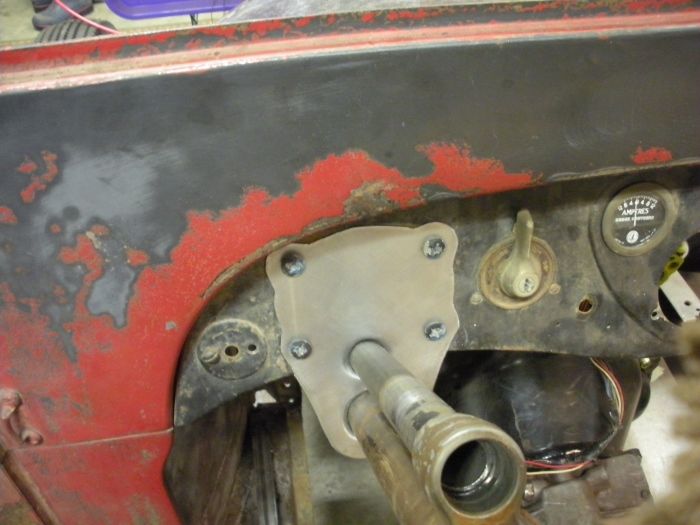

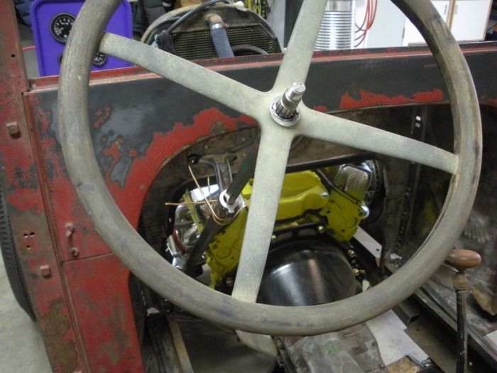

    So, it's been a while. I have been trying to fix the problem I created for my steering by wanting the pitman arm in line with the hair pins and steering arms.... Big mess. So I bought an ugly double U joint and decided to just go ahead even though it's not the greatest looking. I have everything in place at the bottom but the three pice DD shaft out of a vega just looked ugly and the connecting rod with custom copper bearing just didn't make me happy. It was kinda rat roddy too so I decided to go a different route.
  14. austinhunt
    Joined: Nov 26, 2011
    Posts: 533
    austinhunt
    There was a '48 ish chevy fleetline/master? woodie out in the woods that I knew of so I went and claimed the steering column out of the rusty carcus. The 3/4 shaft was a little orange, but in good shape. It was a good workout cutting it out with a hack saw, because it's burried past the steering box in mud. The wheel Is beat up, the shaft has no DD end on it but the column shifter will be a nice blinker lever and the column still has decent bearings in it.

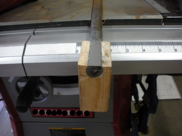

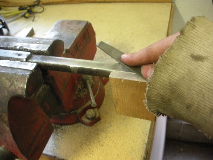

    It was gonna cost me about $37 worth of tooling and a couple weeks wait to get in the machine shop so my plan was to 'machine' my own DD end By hand. The old 3/4 DD shaft was 0.750 in diameter and 0.550 from flat to flat. To take off 100 (thousanths) from each side evenly was going to be interesting but I tried anyway.
    I started with the old DD and a block of wood. Drill 3/4 hole, cut cut it close with a saw and file the rest of the way with a wood rasp and finish with a fine file till you just barely get the surface of the shaft... and it needs to be a tight fit. Transfer it over to your 3/4 round and scribe a line or three through the cnter of the shaft so when you go to do the other side you know where 180 degrees is.Go slow with the grinder and flap disk to avoid burning your wood (never a good thing).
    Then finish with a fine file till you just barely start taking wood (on the file) and flipe 'er over.
    Rinse and repeat, then measure with calipers and file with the guide block on till you are within your tolerances. I got the flat-to-flat between 0.551 and 0.548 inches and the flats are dead parallel.So you don't need a mill to do good work all the time. If you do this, be patient. It took me about 3 hours total for one inch of DD.

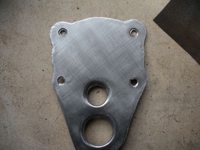

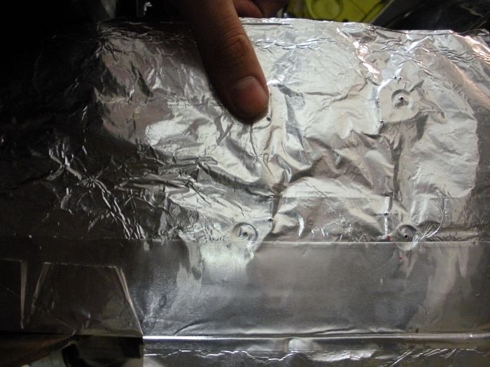

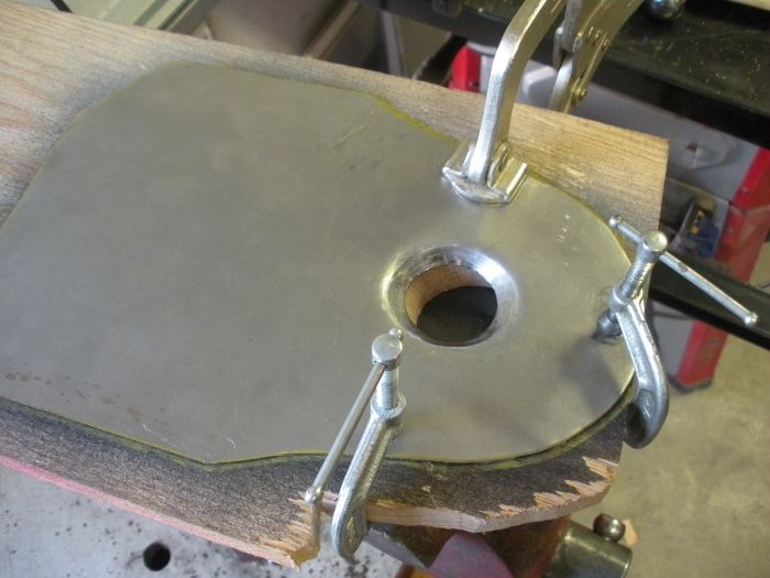

    No more word on the flatty, so I'm going to try to forget about it... I am going slow because I signed up for two engineering cl***es this summer and I'm short on money... but here are some updates!

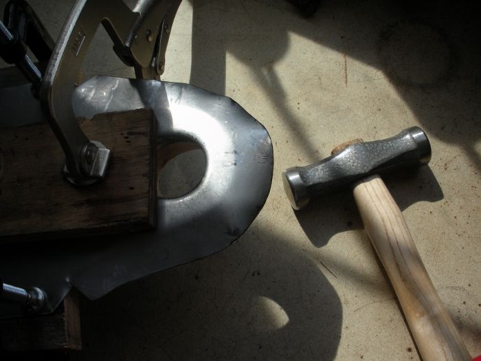

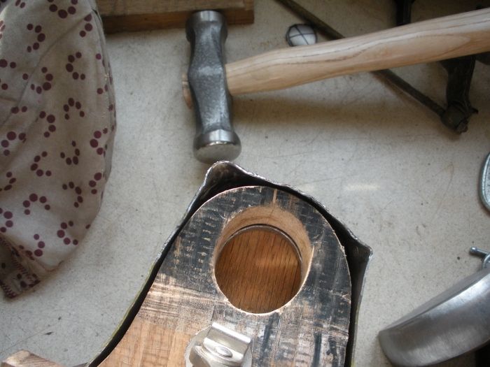

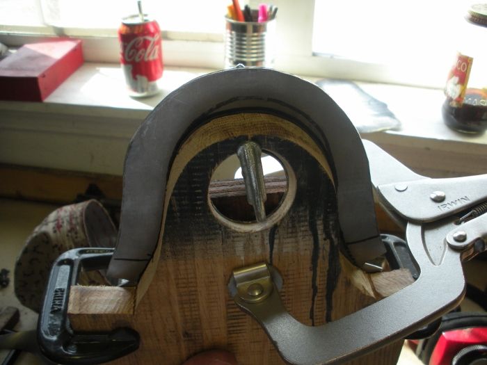

    Steering column drop progress. It's 18 gauge, formed with only a couple hammers, a dolly, and a ratchet handle. The first pattern was taken from the truck using the creasy hands method. then the second was drawn free hand... no measuring involved!
