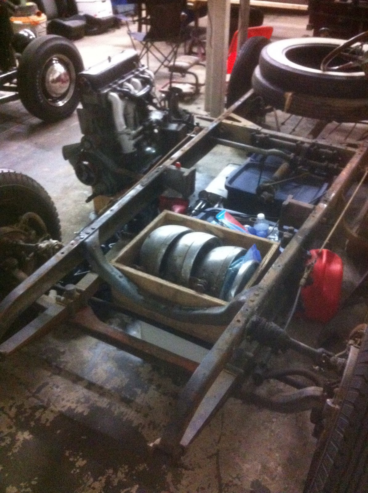

  4. Deeluxe
    Joined: Dec 16, 2005
    Posts: 167
    Deeluxe
    from island
    More details to follow. For now, some of my inspiration images for this project.

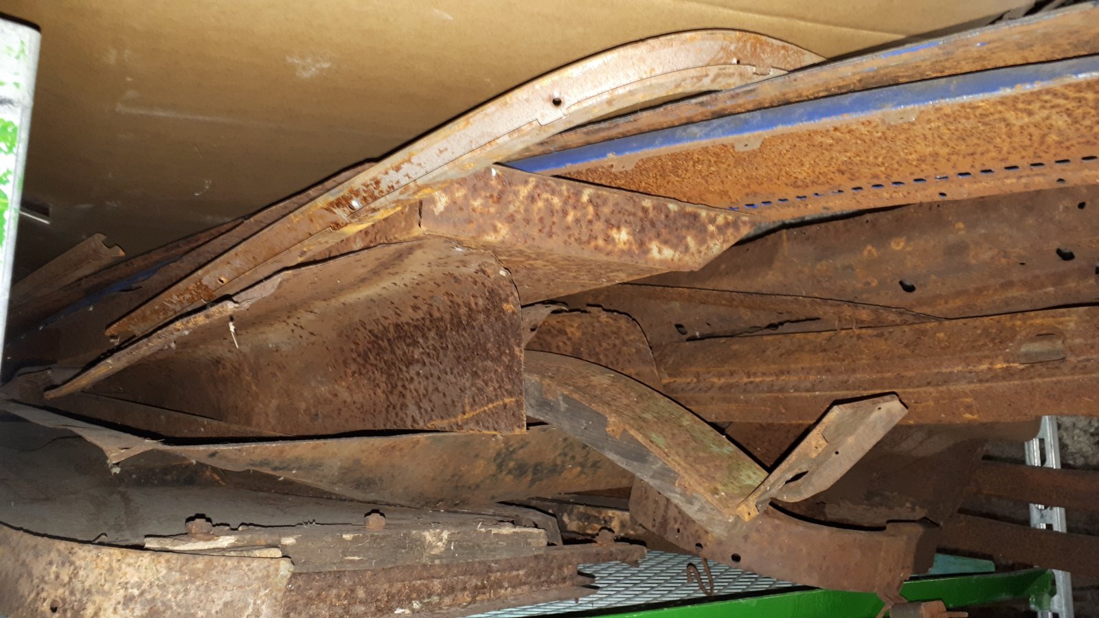

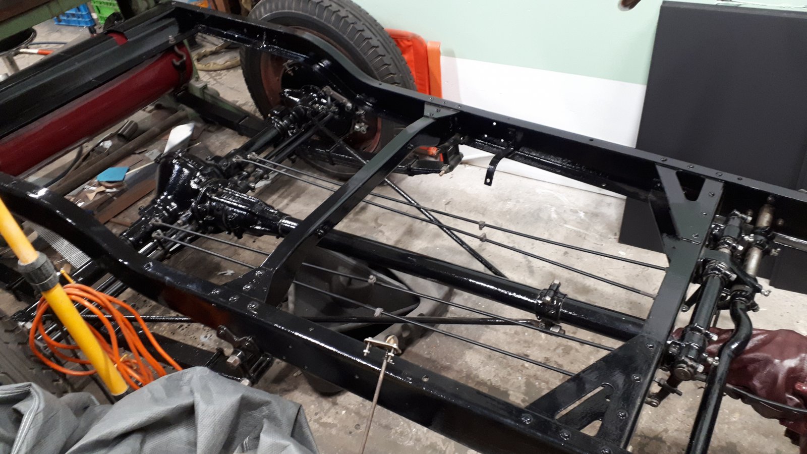

    After finding the rolling ch***is to be fairly complete, I began total dis***embly. Then parts prep and re-***embly
    We all know what this looks like, but here we go.
    Taking things like this...

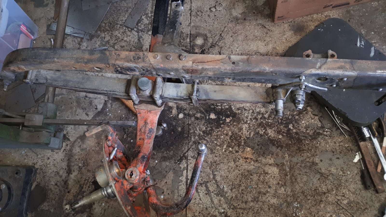

  16. Deeluxe
    Posts: 167
    Deeluxe
    from island
    Then doing things like this...
    Note: I had decided to keep this build era-correct for the late 1920's....so only pre-1930 parts and build tech. Because that is a rational thing to do... right?

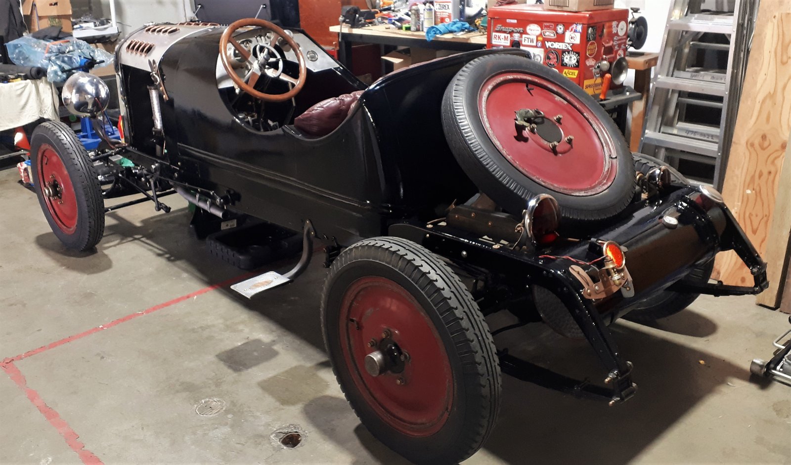

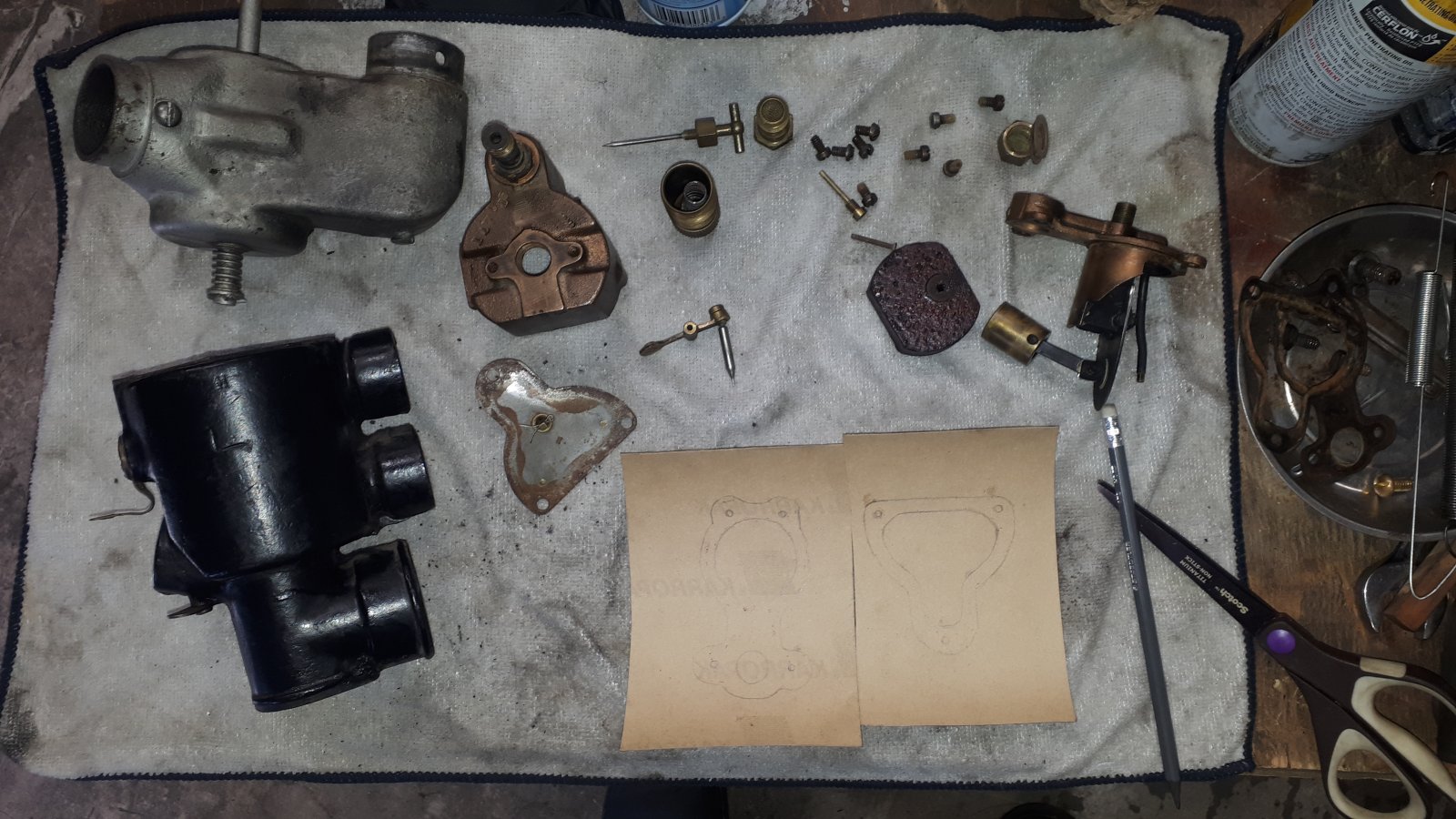

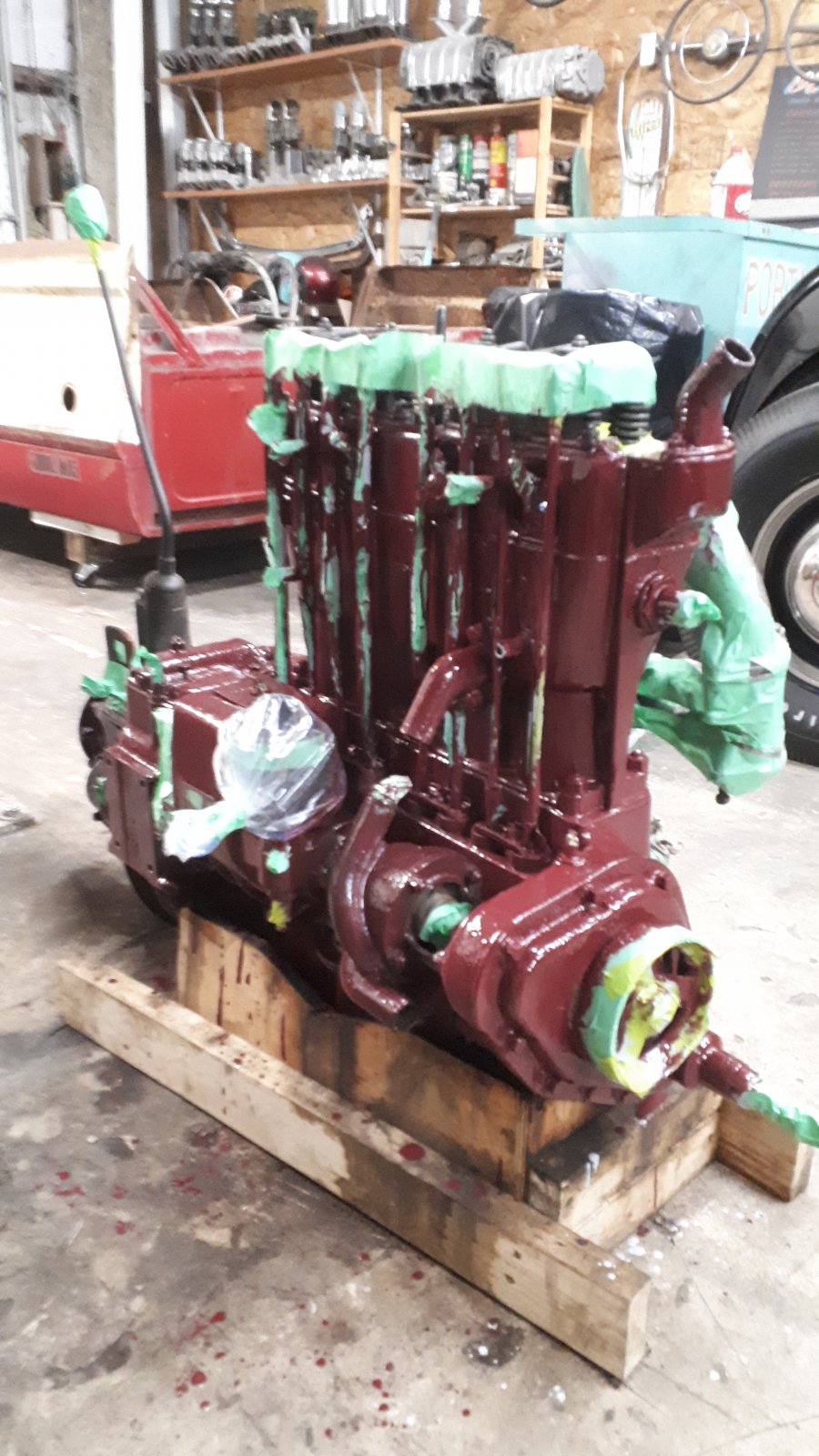

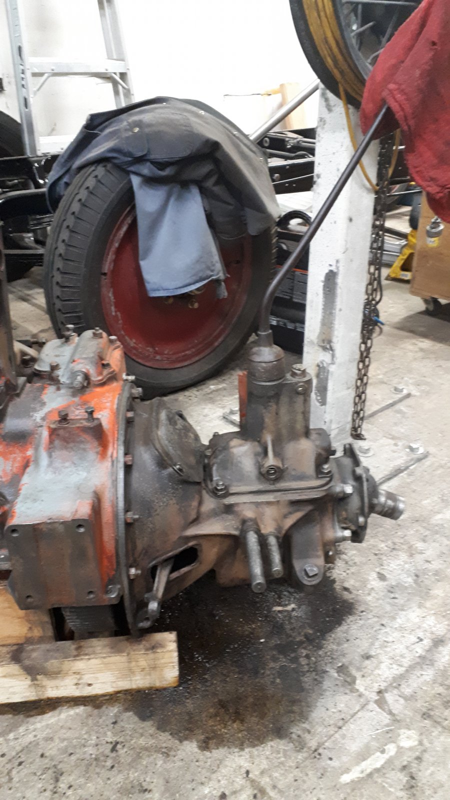

  24. Deeluxe
    Posts: 167
    Deeluxe
    from island

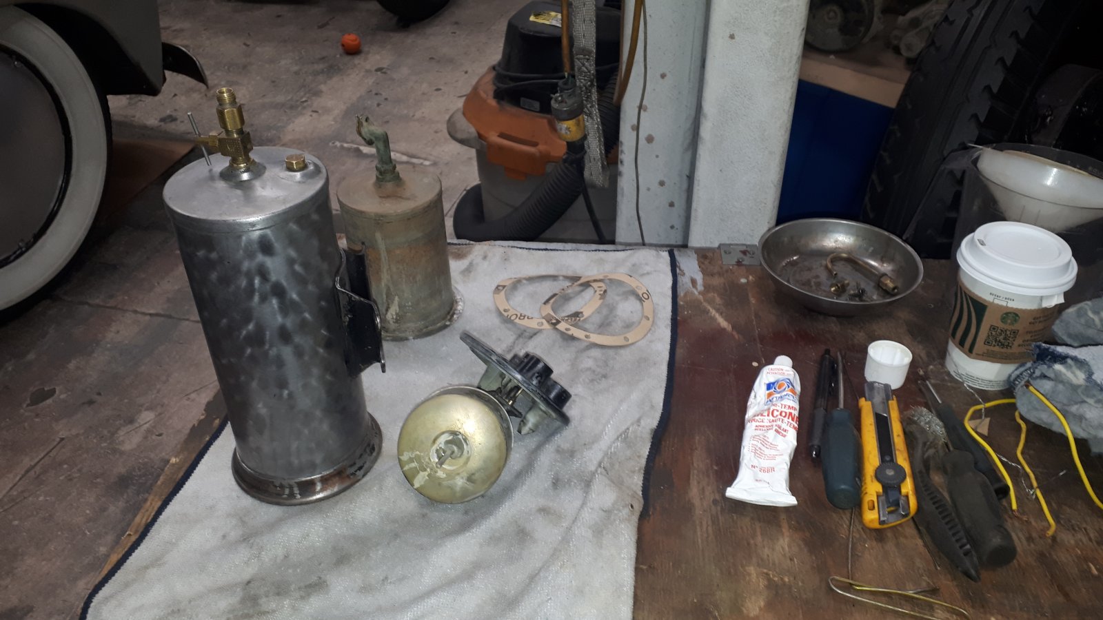

    The Gods had smiled upon me! The motor was a keeper!
    So, I got to proceed with Fun activities like...
    rebuilding a Stewart Vacuum Feed Fuel Pump and Marvel Updraft Carburetor,
    Repairing a banged up oil-pan, etc.
    20211025_113307.jpg 20211026_131035.jpg 20211026_131040.jpg 20200131_135444.jpg
    Stogy, burl and Hamtown Al like this.

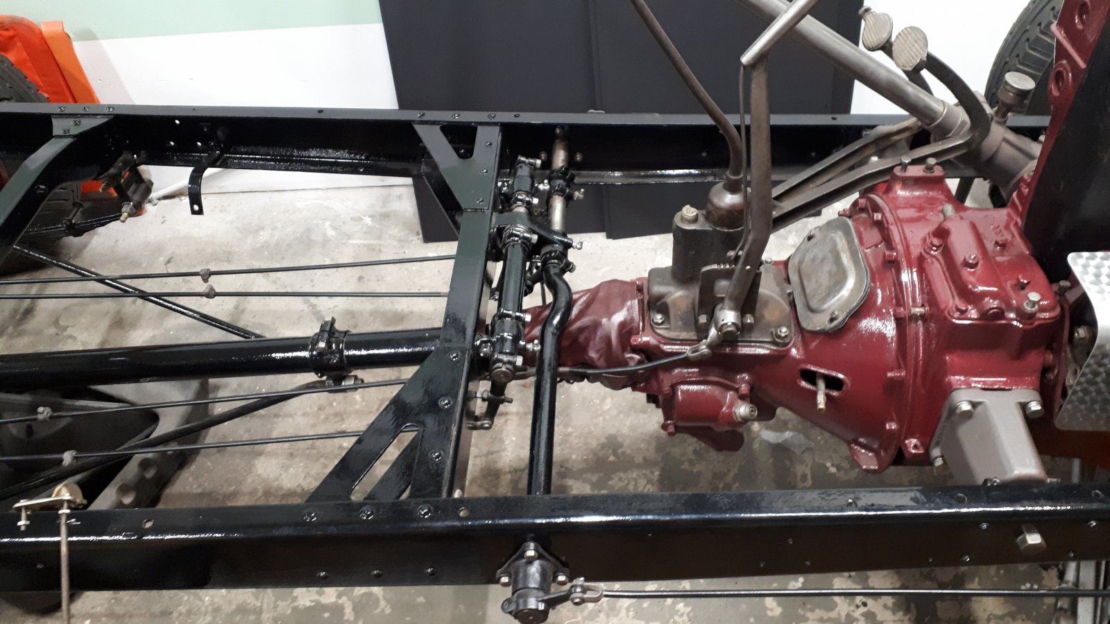

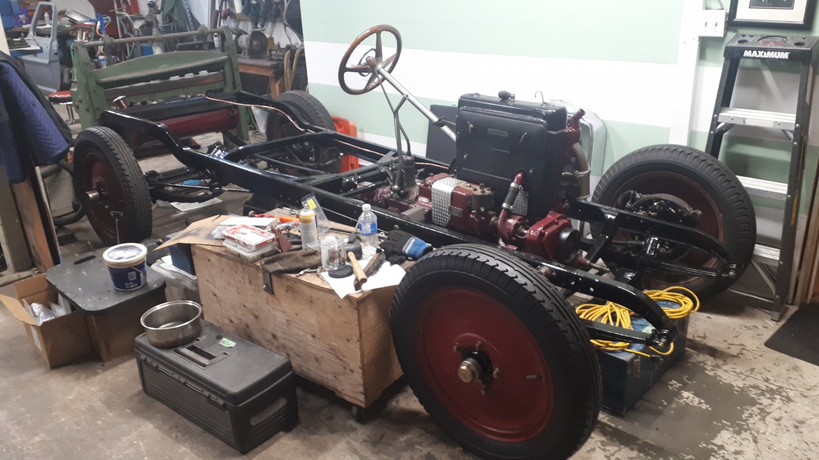

    Some pictures of the motor, accessories and linkages progressing.
    Check, repair, test fit, repeat.
    20190422_201910crop.jpg 20190423_221750.jpg 20200124_125139.jpg 20200128_214916.jpg
    302GMC, Squablow, Stogy and 2 others like this.

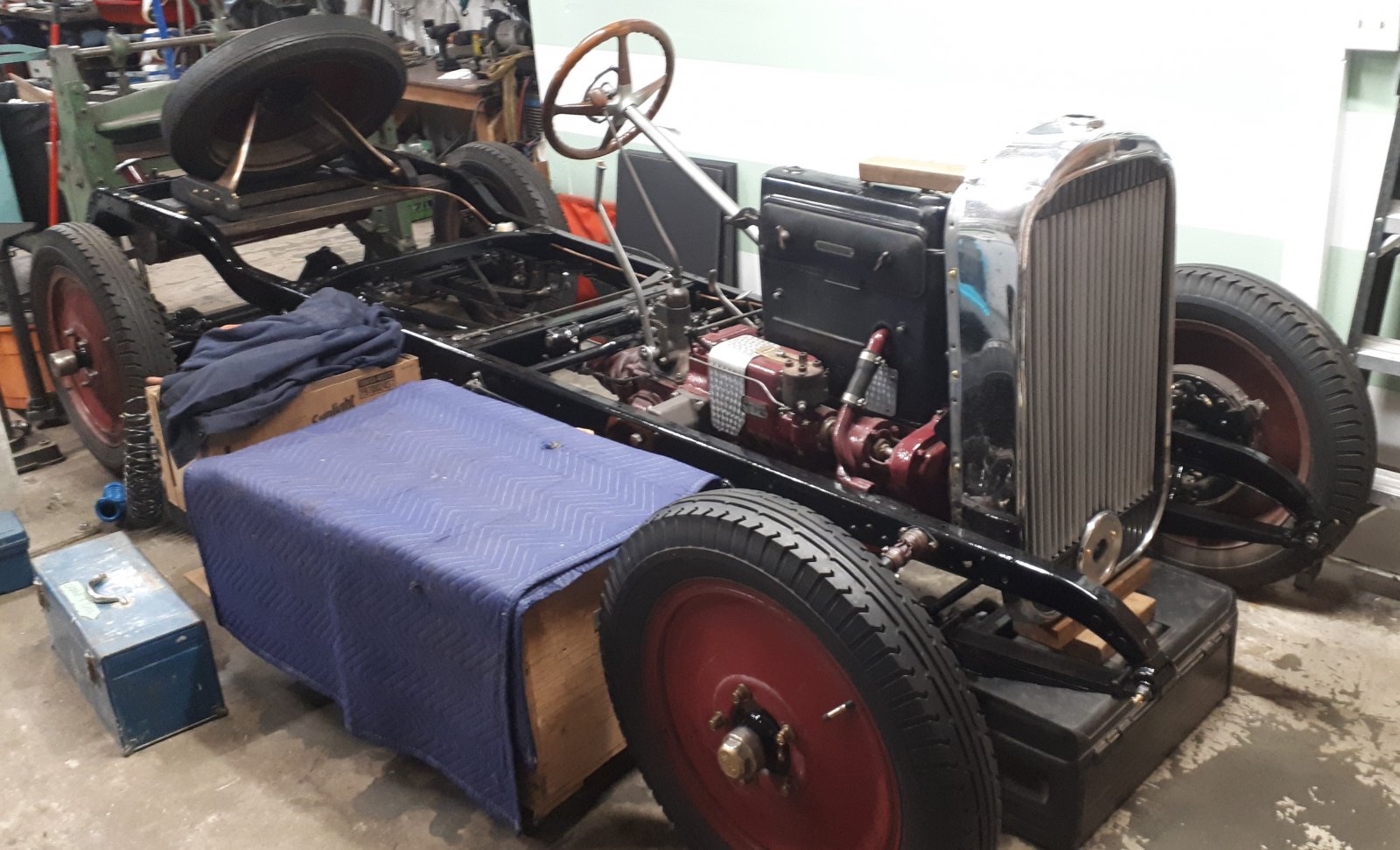

  28. Deeluxe
    Posts: 167
    Deeluxe
    from island

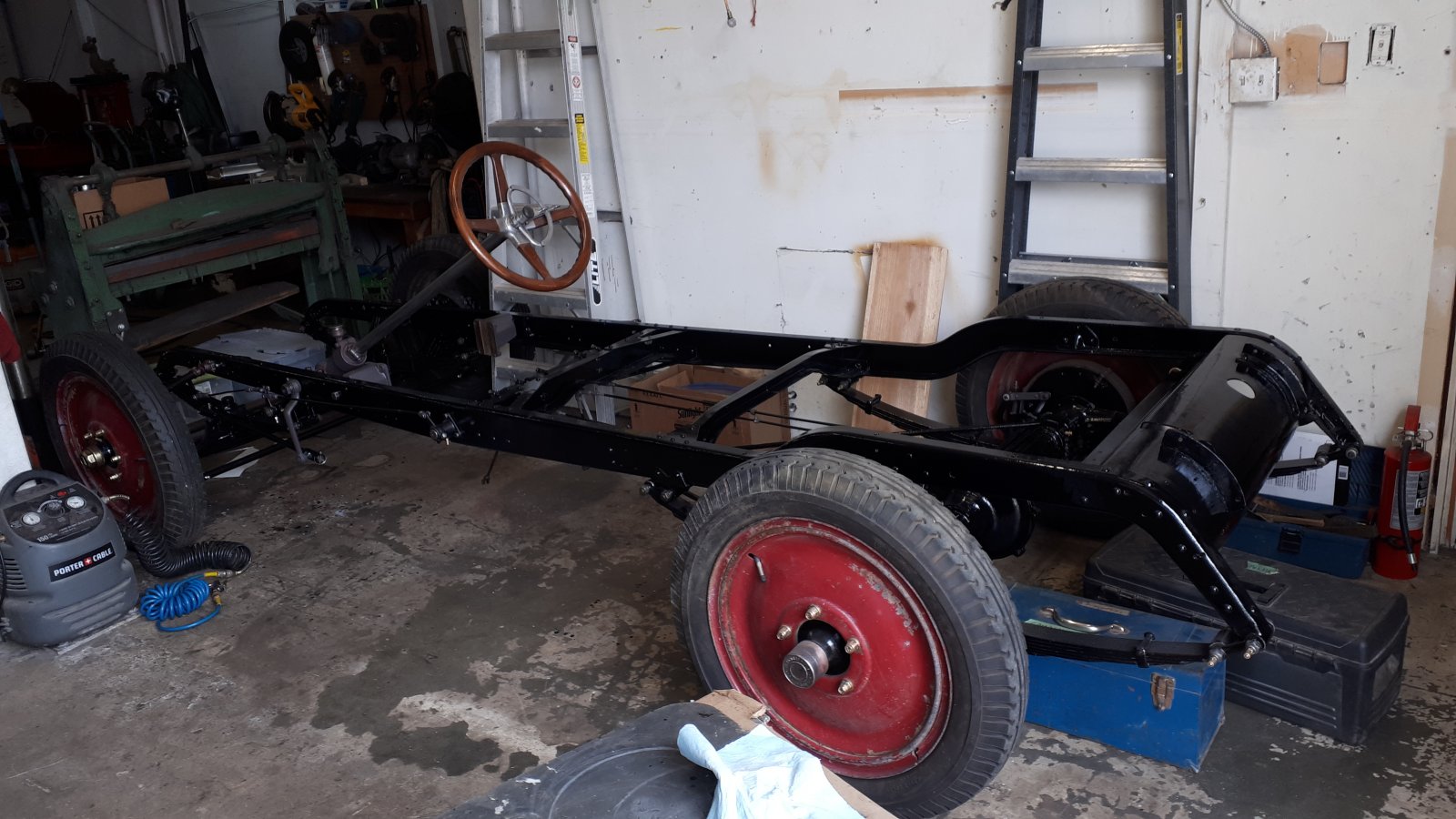

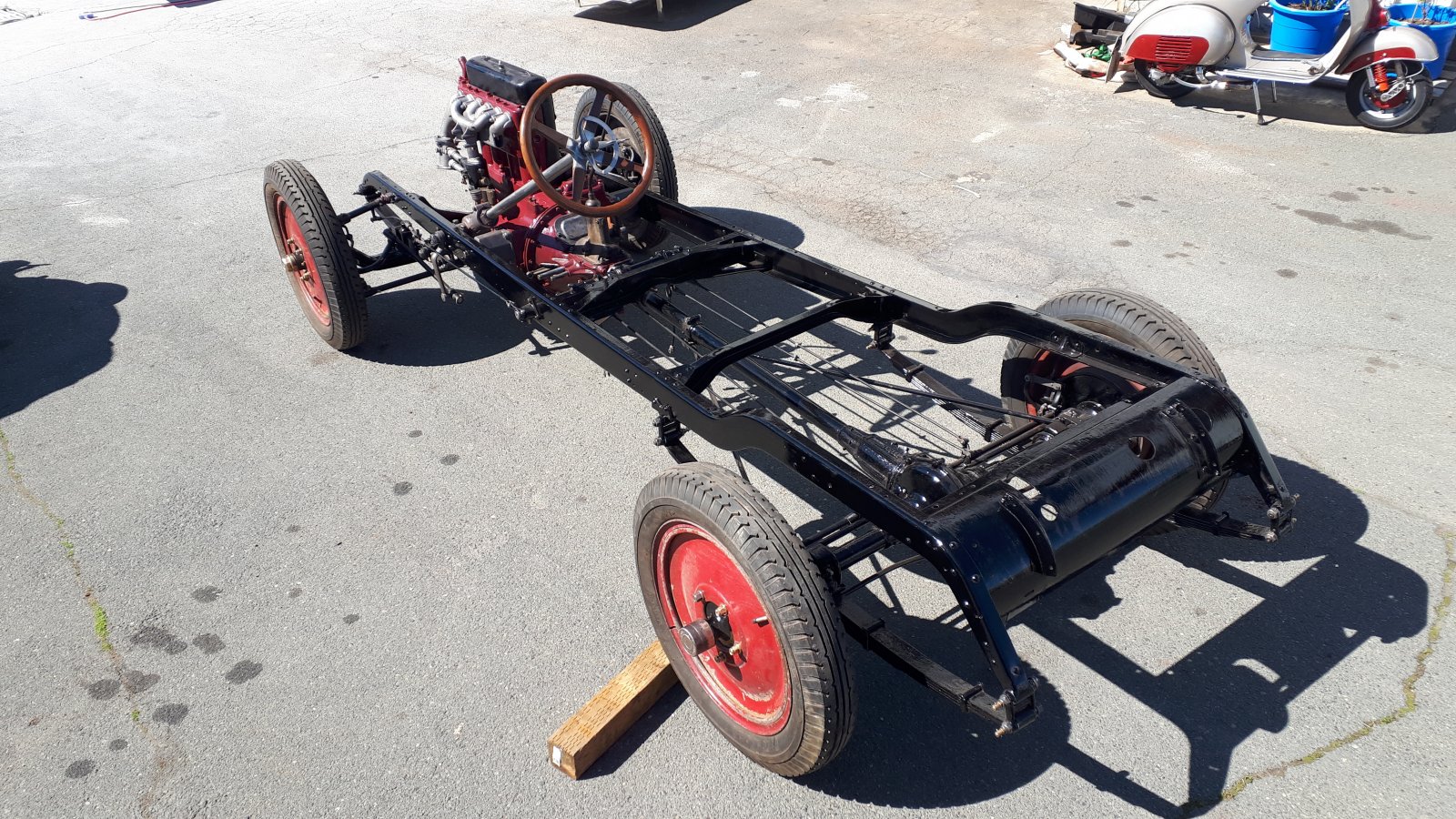

    Suddenly it was a rolling ch***is!
    Photography is Not in my skill-set. I tried to capture the stages of the build, regardless.
    Nailhead A-V8, hfh, Stogy and 3 others like this.

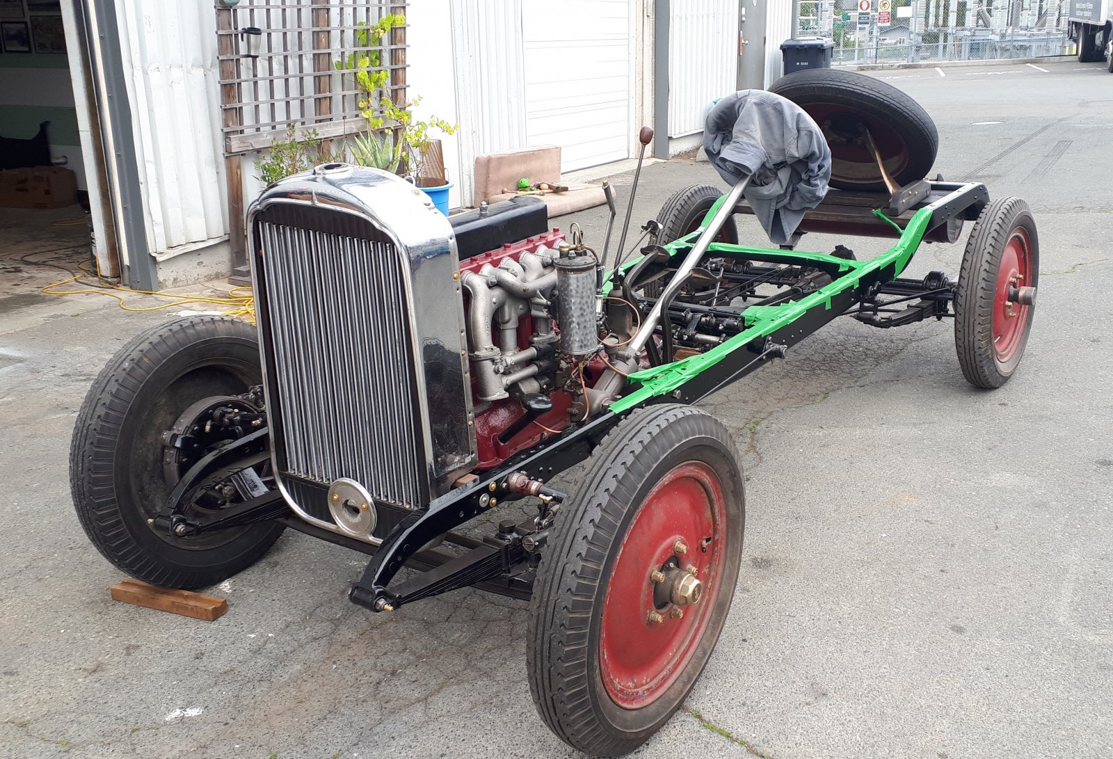

  29. Deeluxe
    Posts: 167
    Deeluxe
    from island
    After many trials and tribulations, I finally got a Ford Model B Radiator to fit the Buick Rad Shell.
    Then Modified them both to fit this ch***is and motor.
    These photos also show the huge cast bronze spare tire mount. It is an original McLaughlin part, I just changed the location.
