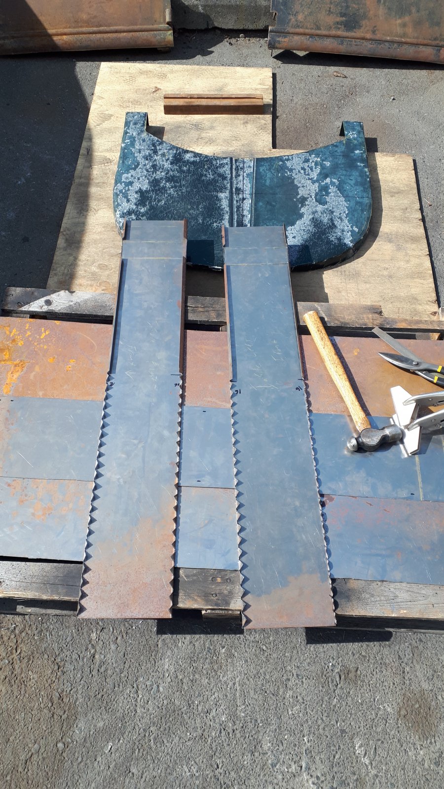

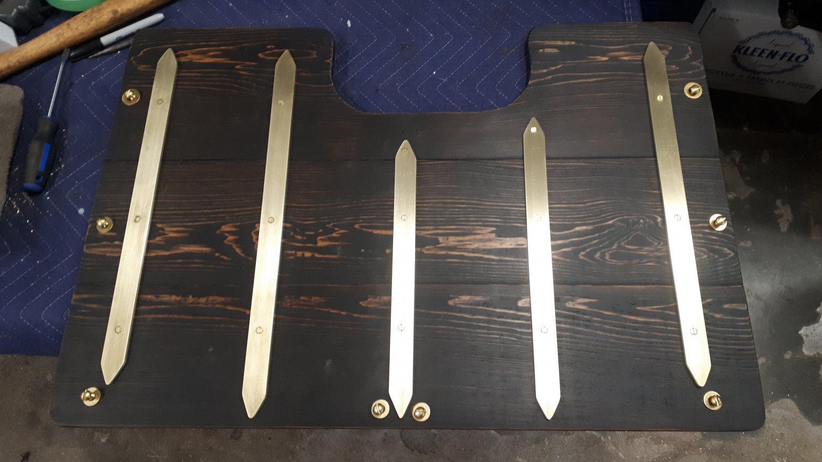

    Seat! Narrowed shape, shortened and re-curved sides around the wood base.
    Here it is along with some other modified floor bits, ready for rust stripping.
    You can also see parts for the drop-floor, also made of model A s****s and being narrowed to fit.
    20200716_125021.jpg 20200718_093709.jpg 20200718_111217.jpg 20201225_135739.jpg

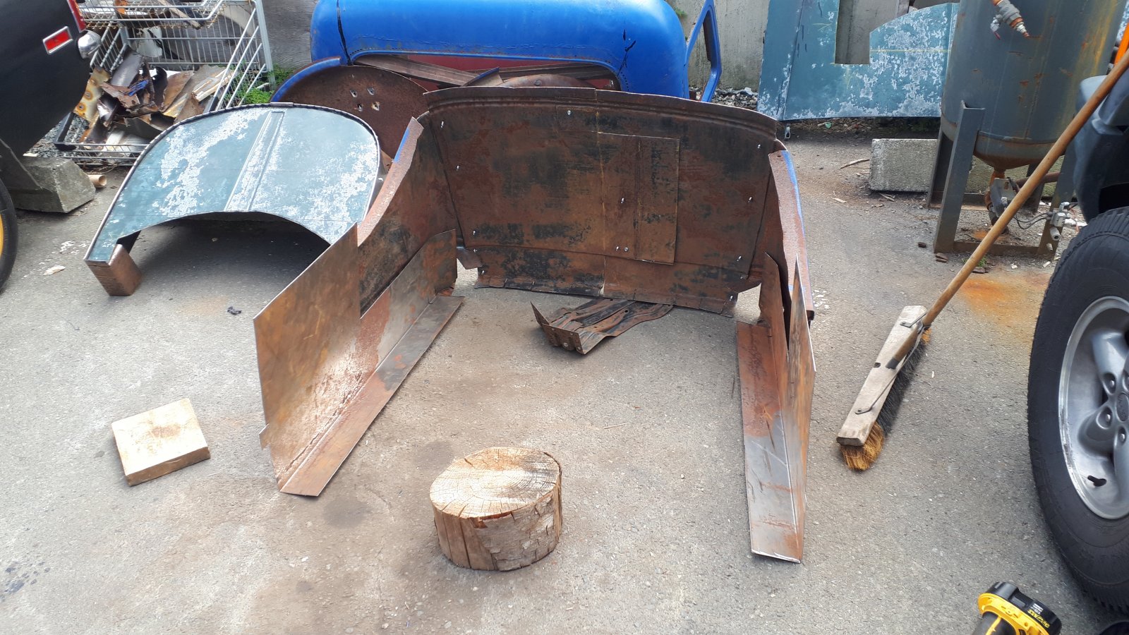

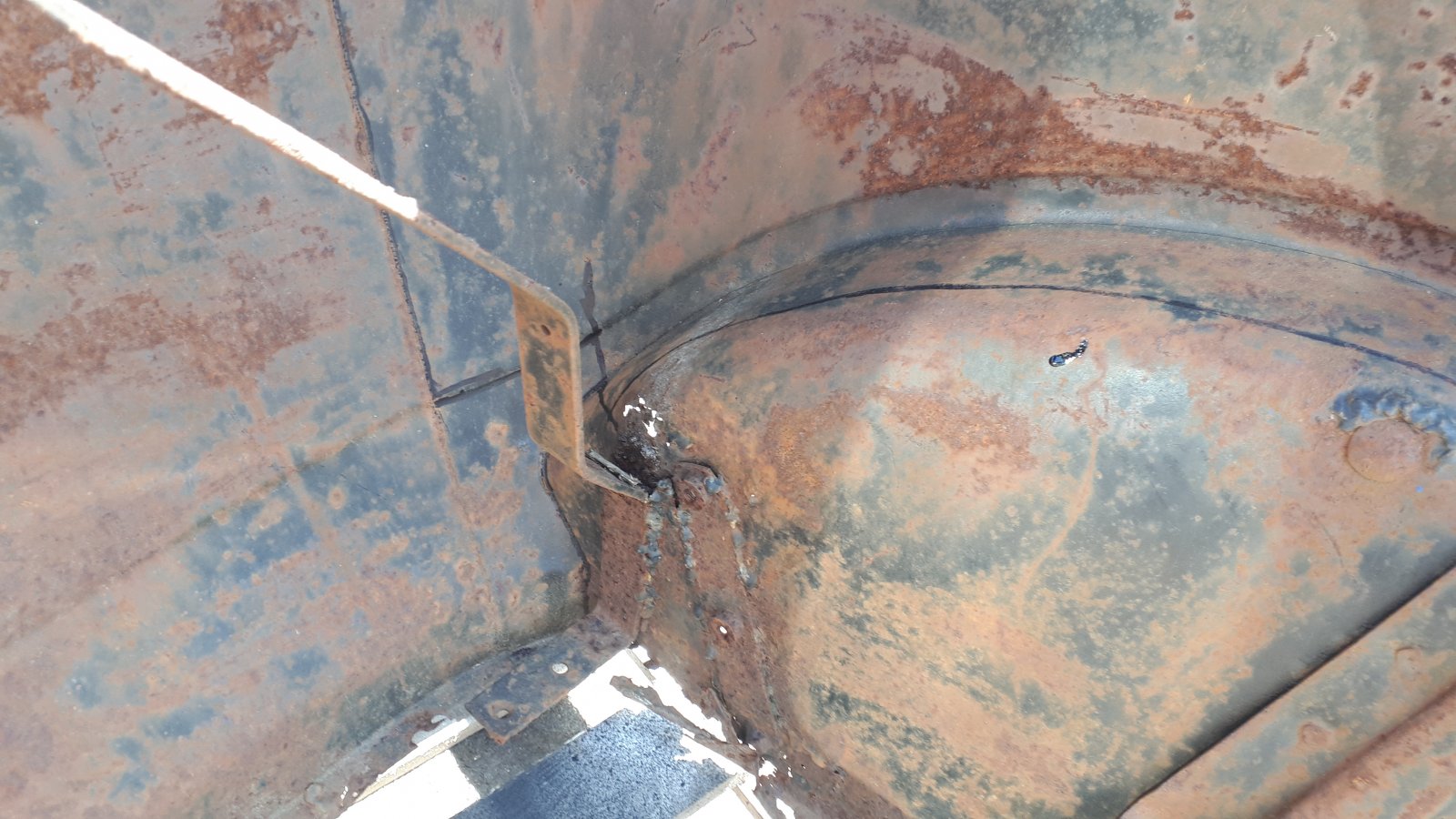

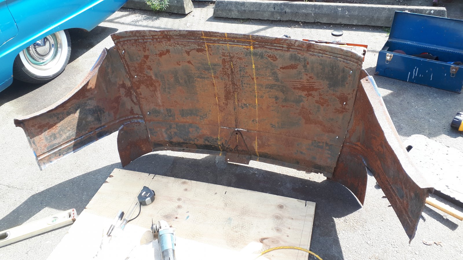

    Cowl and Firewall happening.
    More s****s re-shaped...and Yes, some fresh 18 Gauge.

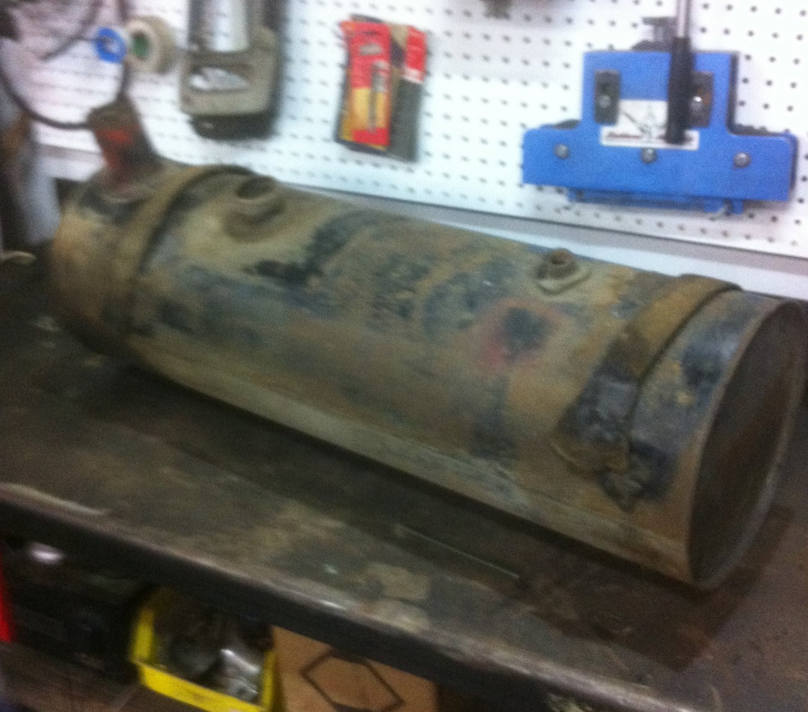

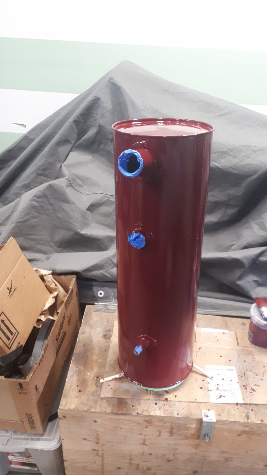

    And the Gas Tank. This little pile of crud got:
    Boiled, hammered, welded, sealed, primed, painted and engine-turned. Then cap and strap repairs.

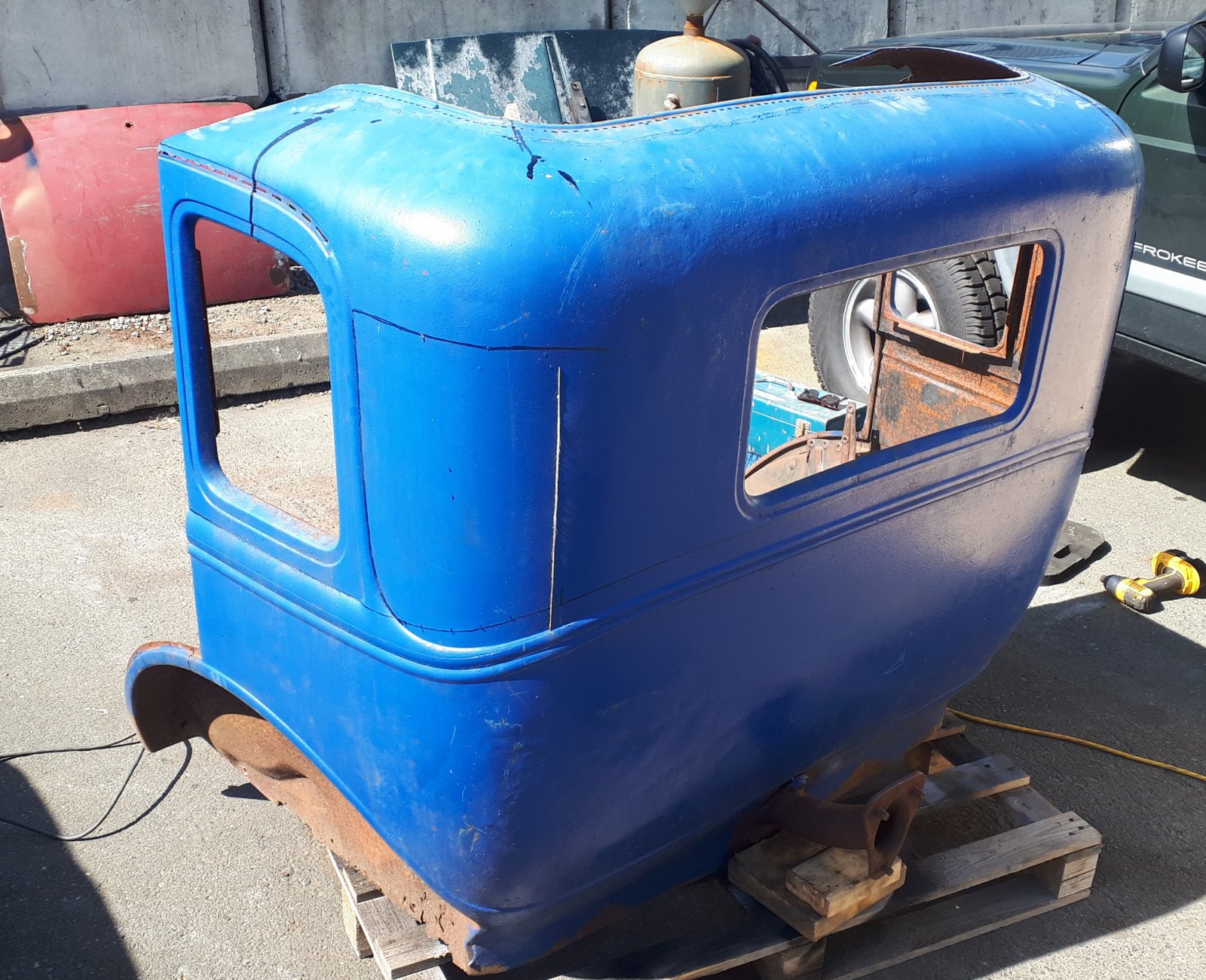

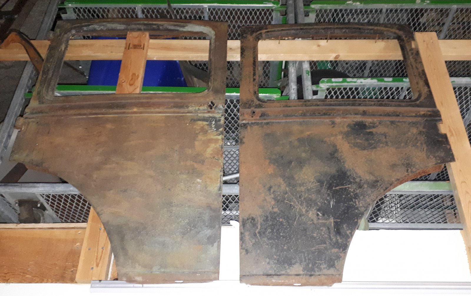

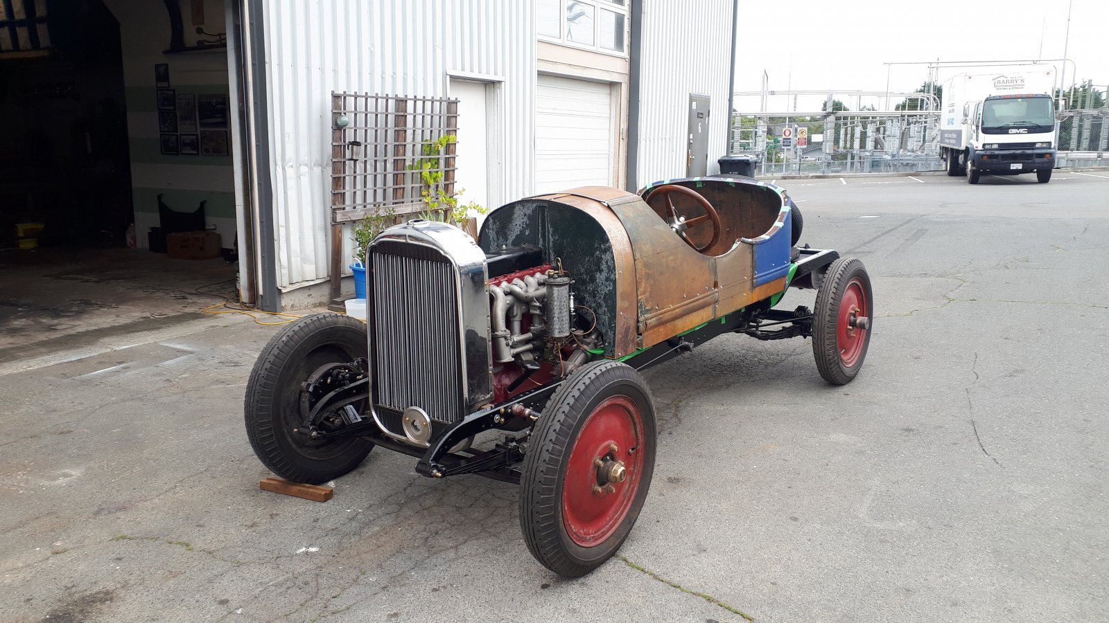

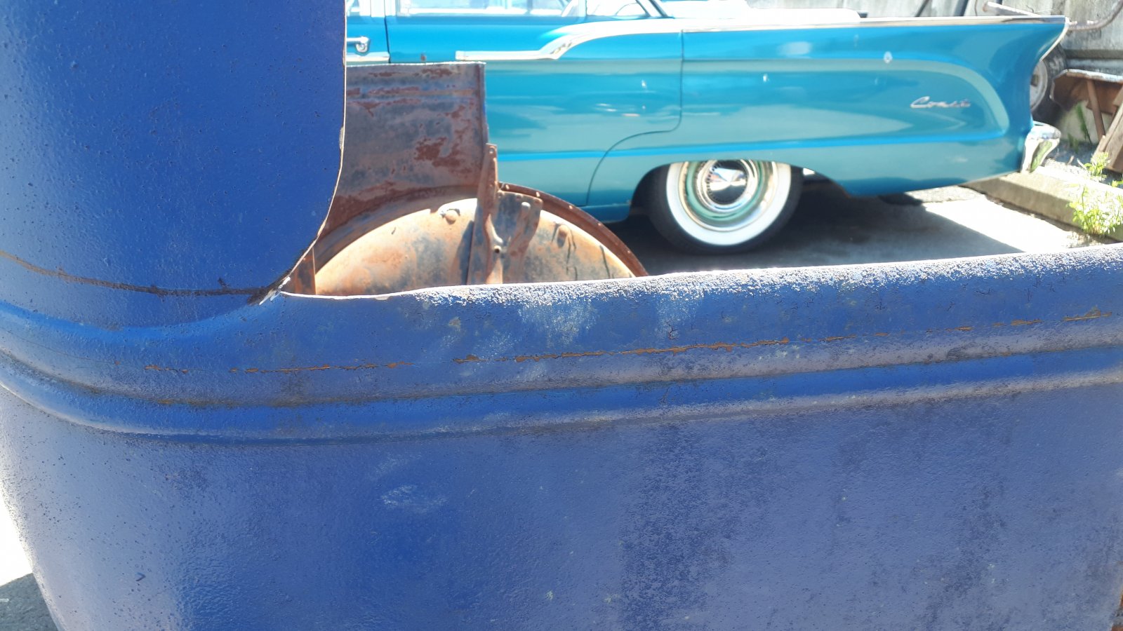

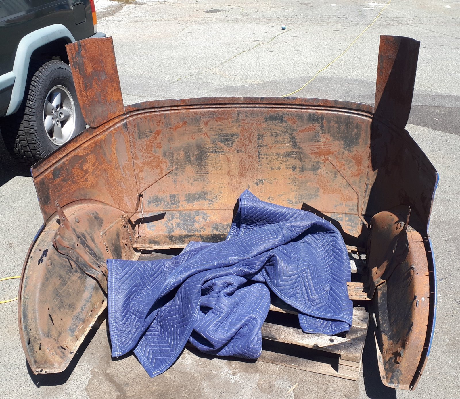

    So, it was now a roller with a motor. Need Body. Thus begins the real fun!
    Please keep in mind, I did all of this bodywork in a parking stall at a friend's shop. And in a tent.
    Yep, the neighbors love me....
    Anyway...Gotta turn these 1929 s****s into Speed and Beauty.

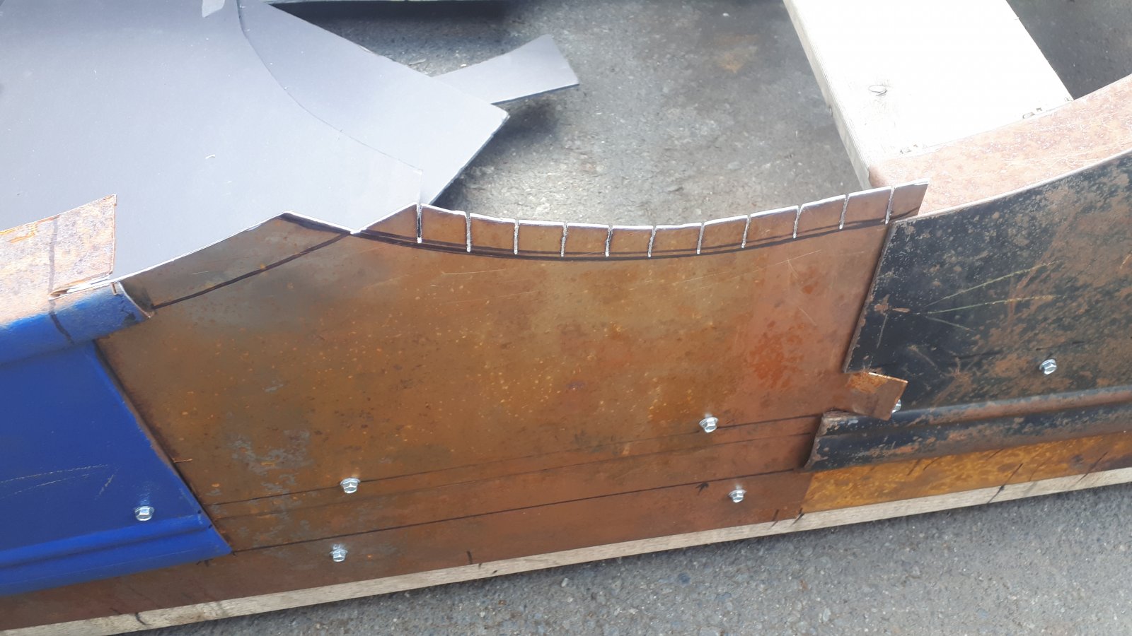

    We start with the back of a trashed 1929 Model A 4dr and two rear doors. I will try to explain the steps in following posts.
    Here I have shown the first rough fit of the new metal shapes. Still had a long ways to go.
    But I will do my best to explain the cuts.

    And then...many careful cuts.
    Everything got screwed together until the shape started happening.
    Then it all gets torn apart, trimmed up, de-rusted, riveted, welded, and primed.

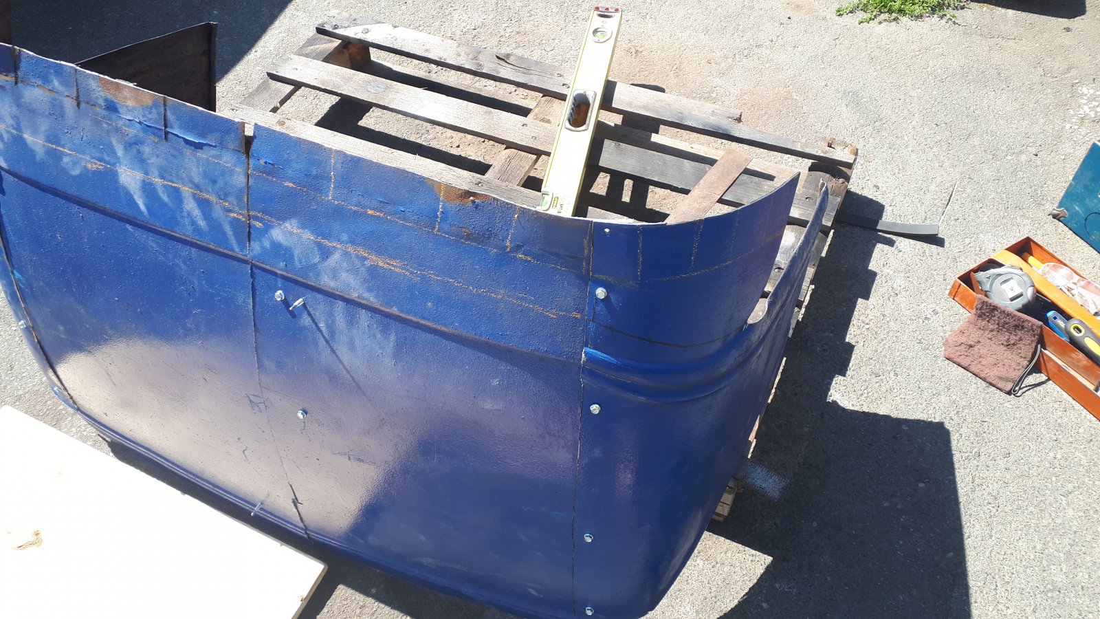

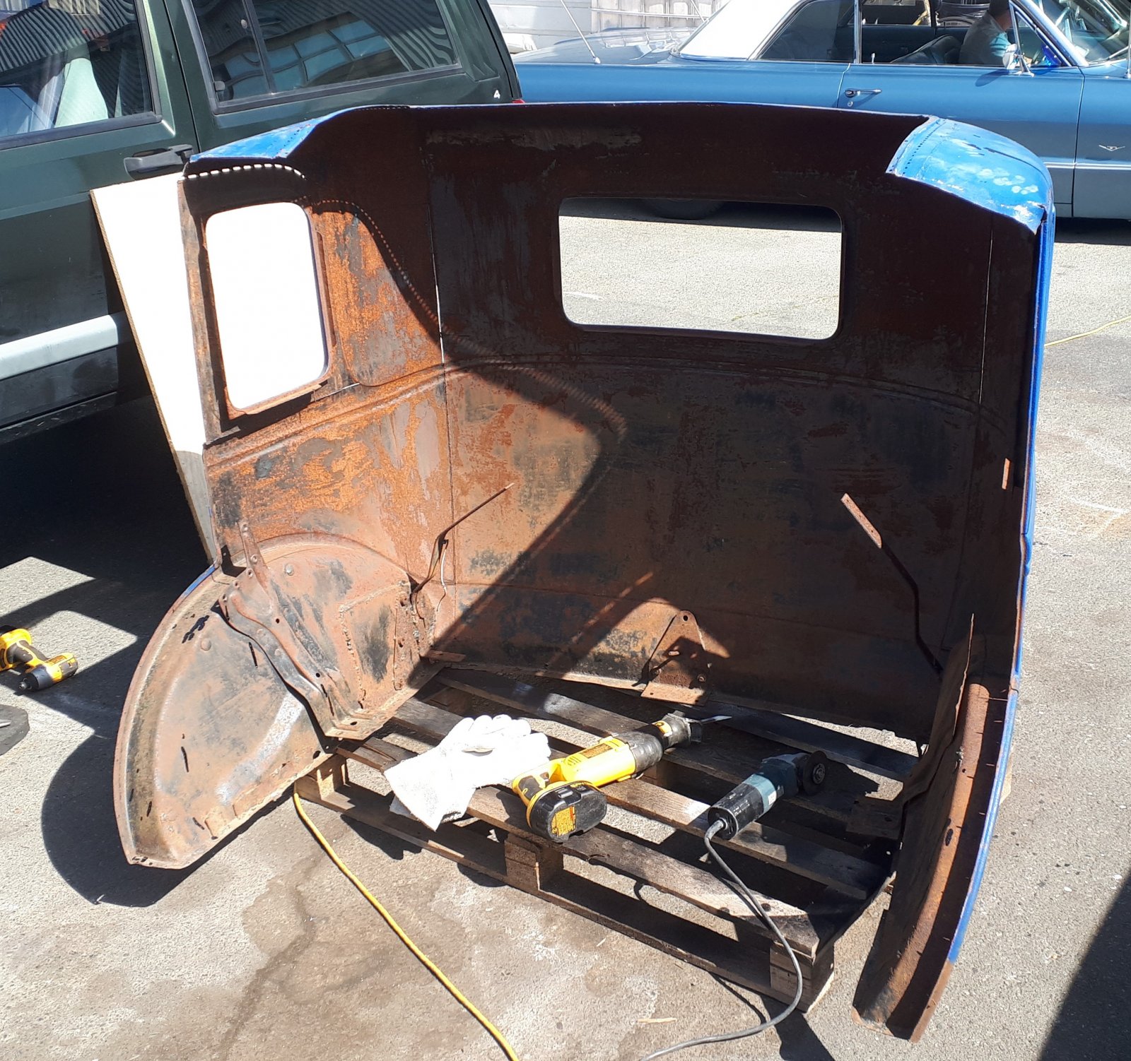

    Wheel-well removal. Cut side panels. Flip side panels. Layout for narrowing.
    20200527_103326.jpg 20200527_103311.jpg 20200527_154639crop.jpg 20200527_154624.jpg

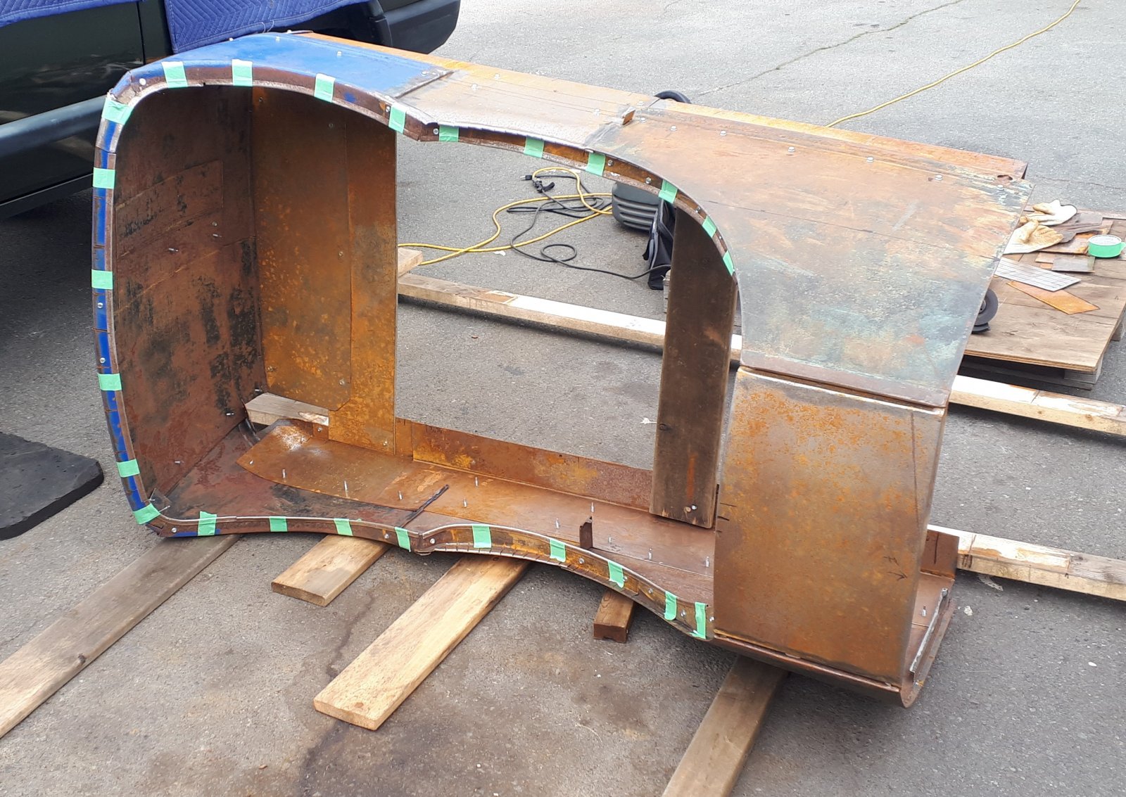

    And Narrowing.
    I used careful cuts, many measurements and the factory body lines to re-align it all.
    20200527_160346crop.jpg 20200527_161325crop.jpg 20200527_161344crop.jpg 20200527_161354crop.jpg

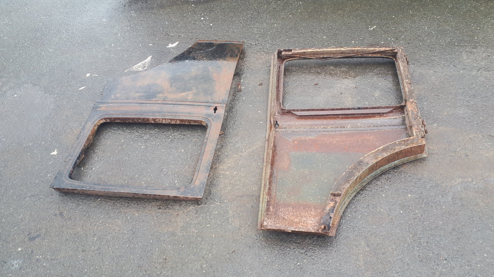

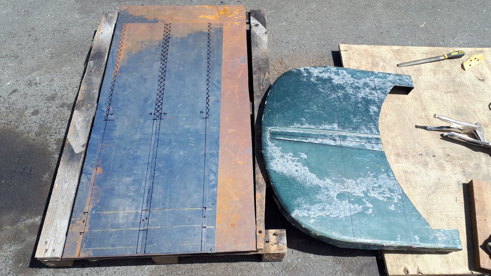

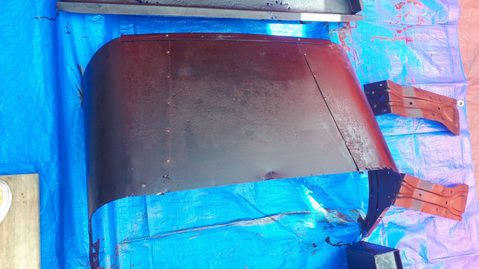

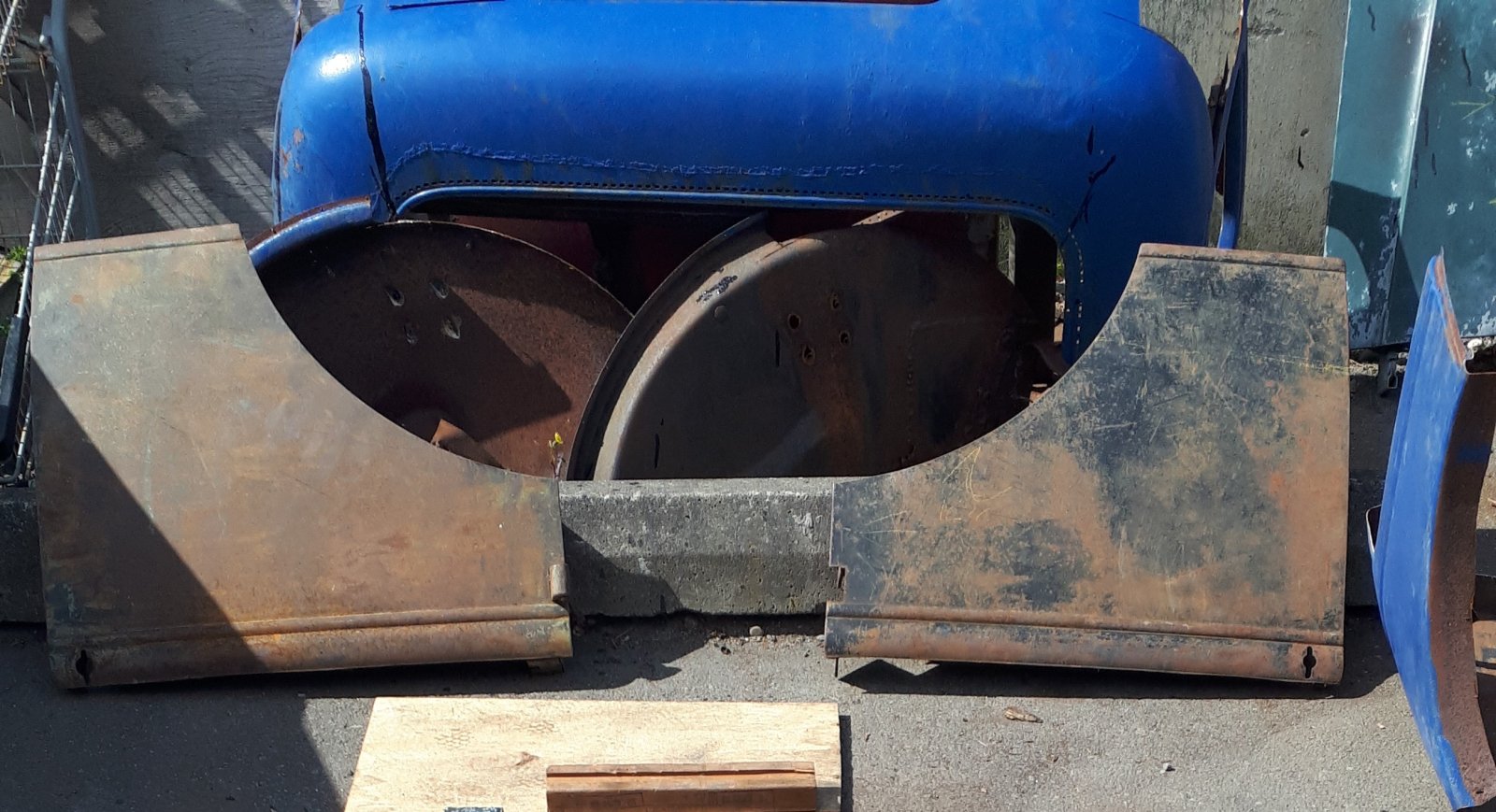

    Now the doors will become the start of body sides.
    This stage took many hours. Still very rough. These show...
    Cut the window frames off. Cut most of the door frame out. Flip them. Reshape the door-skin to fit the cowl shape. Make a pile of new pieces.
    20200218_152259crop.jpg 20200605_101755crop.jpg 20200608_162644crop.jpg 20200611_180908crop.jpg

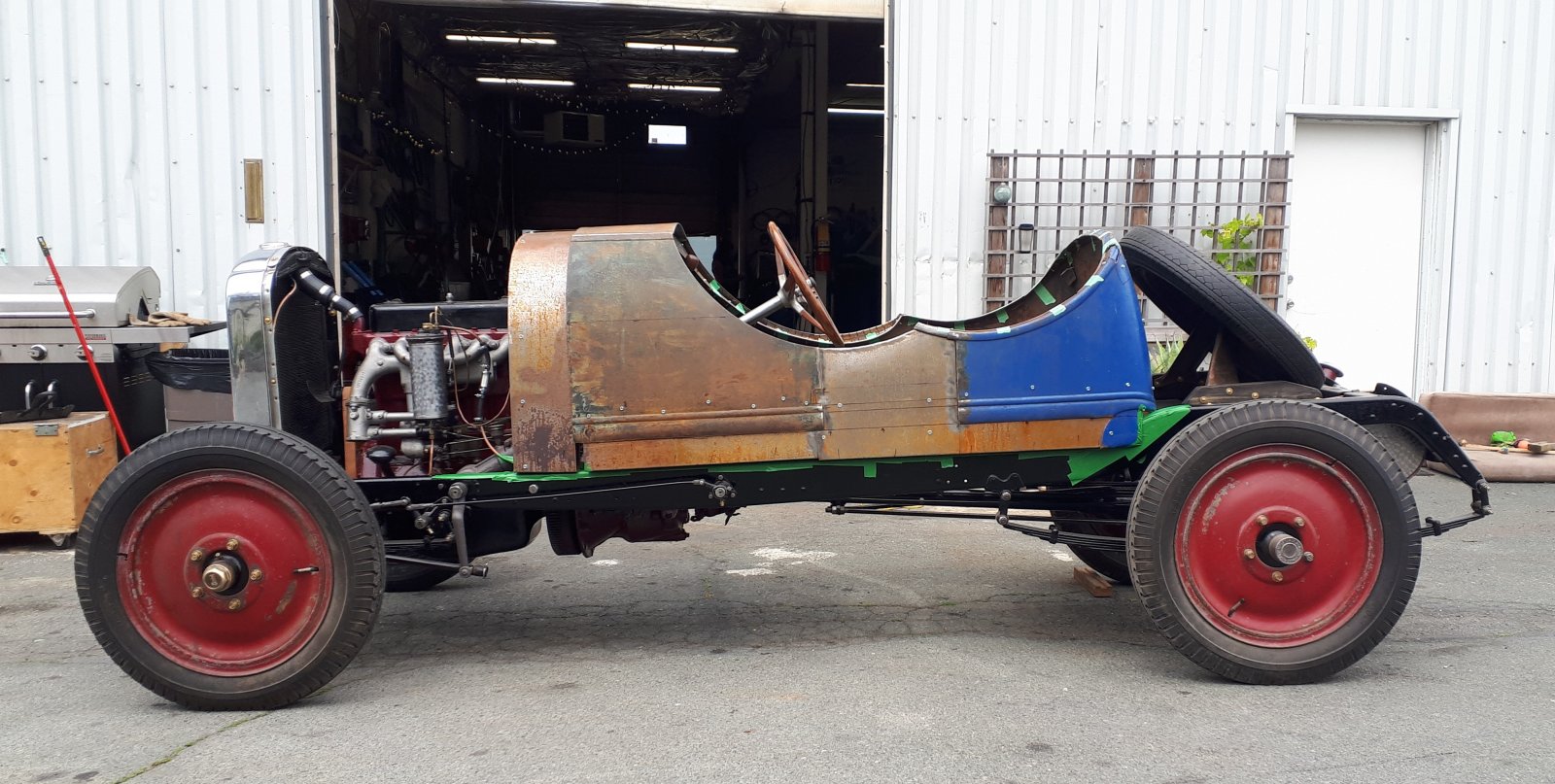

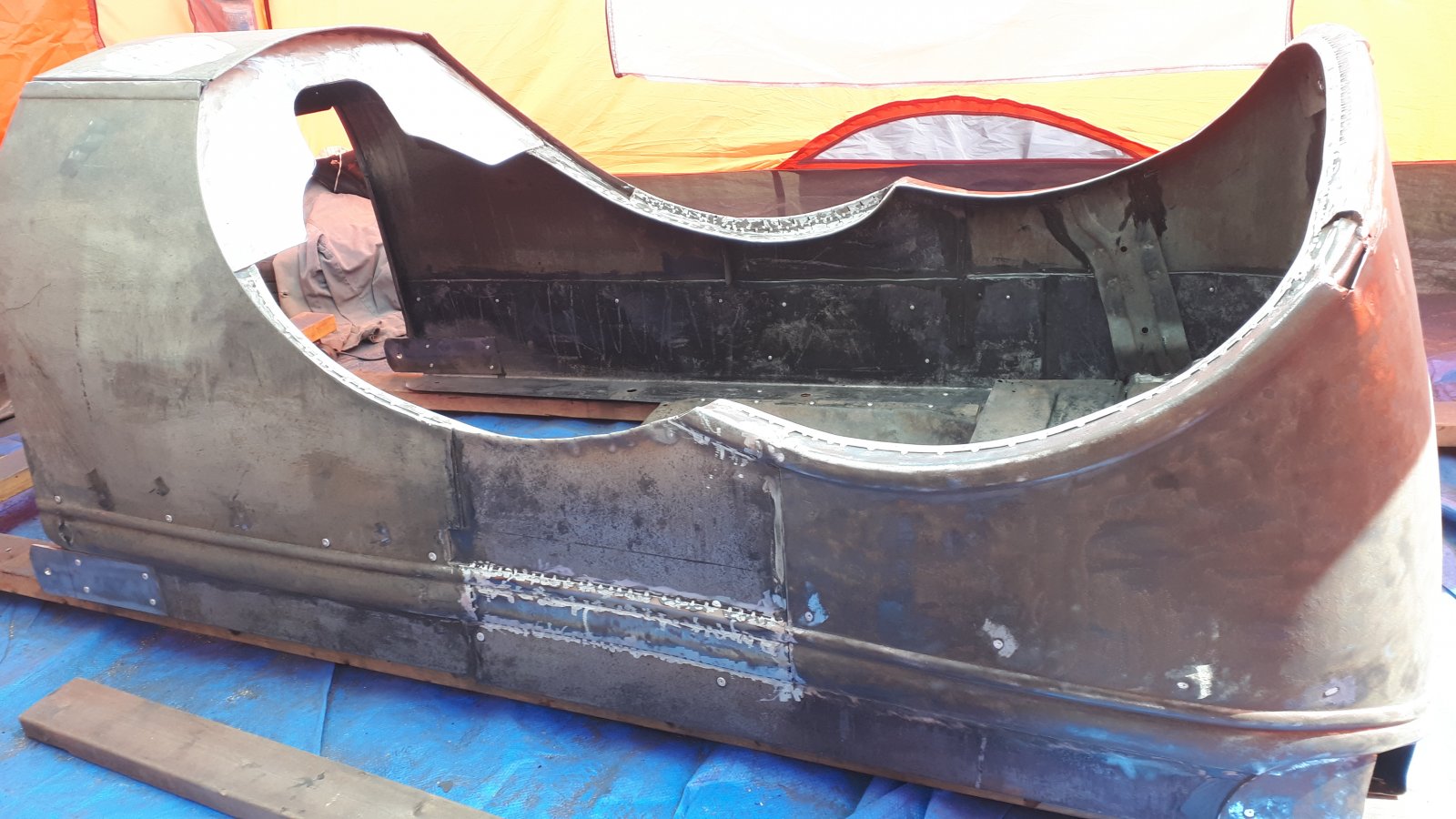

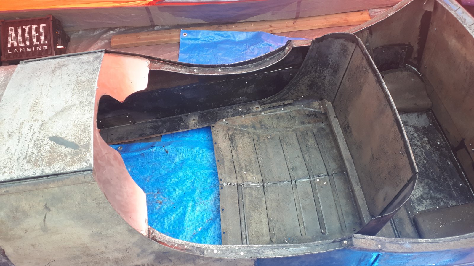

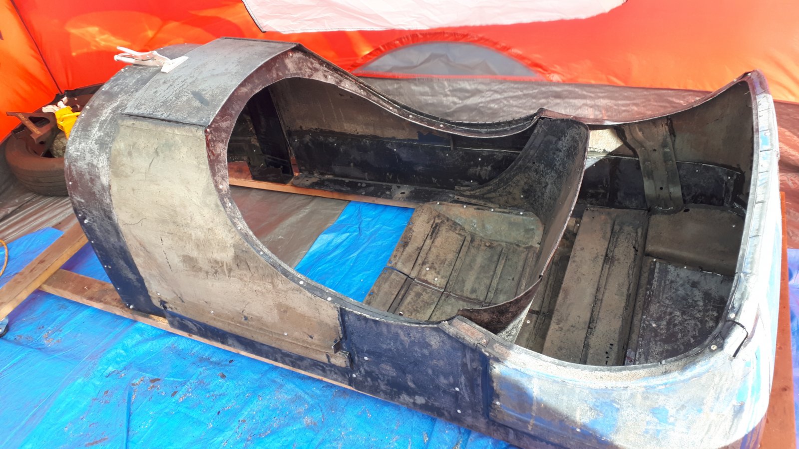

    Then, Many more hours and situations like these...
    And I arrived at the over-all desired shape. Of course, it still had to all get torn apart again...
    I chose to do without the typical wooden framework for the body.
    My preference was a variety of interlocking and folded seams; relying on the whole shape for strength.
    Result is Very solid and light enough for two people to lift.
    20200616_110604.jpg 20200623_122454crop.jpg 20200623_145346crop.jpg 20200623_145417crop.jpg

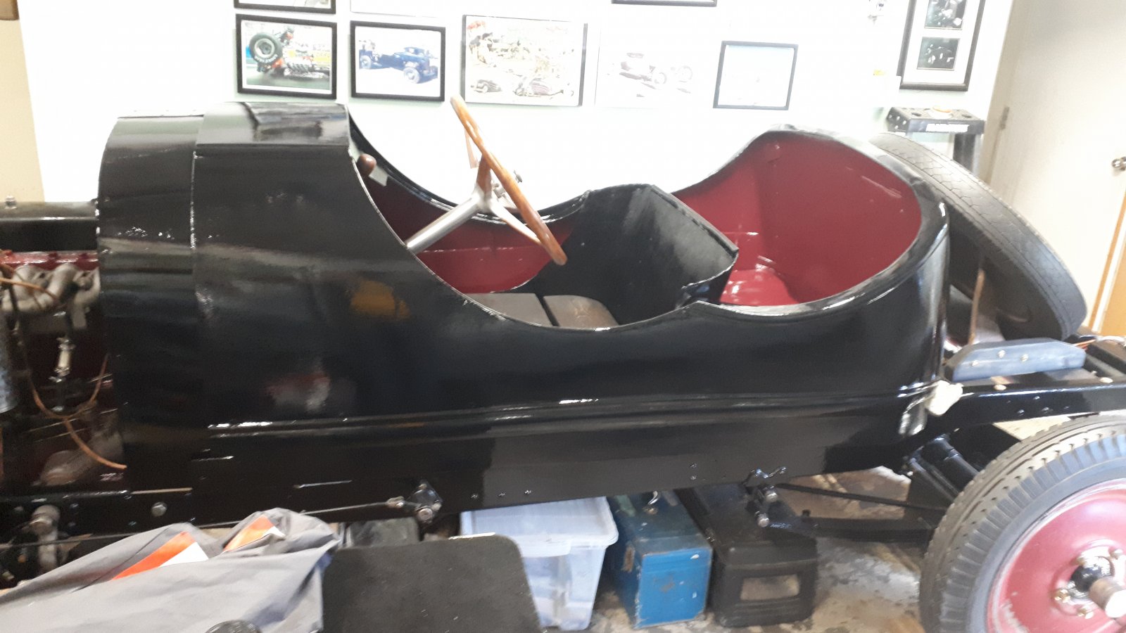

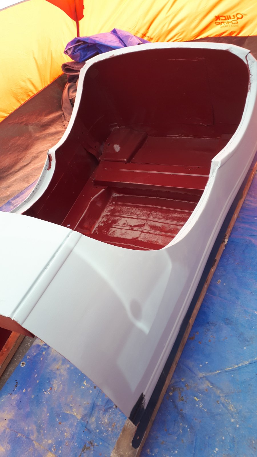

    Now, I had a real problem.
    This thing was showing signs of possible Radness! It seemed I would have to finish it and see.
    More time in the tent. Grinding, body work, primer, filler, repeat.
    Paint was done using quality modern products...BUT was all applied with a brush.
    Actually, many brushes.
    20200804_140156.jpg 20200818_125545.jpg 20200819_161848.jpg 20200820_181548.jpg

    So, I convinced a shop neighbor and his son to help me lift and place the body. Car Folks unite!
    All mounts line up with the factory locations on the ch***is.
    Everything sits on 1/4" rubber setting blocks. Only good vibes.
    2o'sSpecial.jpg b20200820_185826crop.jpg b20200821_163954.jpg b20201224_114701cropped.jpg

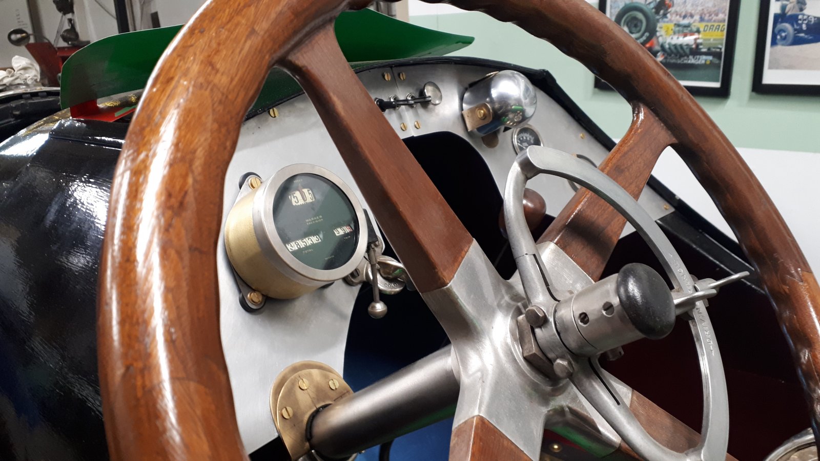

    Well, after a taking a moment to step back and catch my breath...
    I decided to begin all the devilish details.
    Track down bits, repair, make or modify, then stick them on with bubble gum.
    Here are some teasers.
    1924 McLaughlin Ad in 'The Goblin' magazine.
    Dash progress, gauges, drivers-floor, controls, switches etc.
    Motor accessories and wiring. Yadda.
    More details to follow.

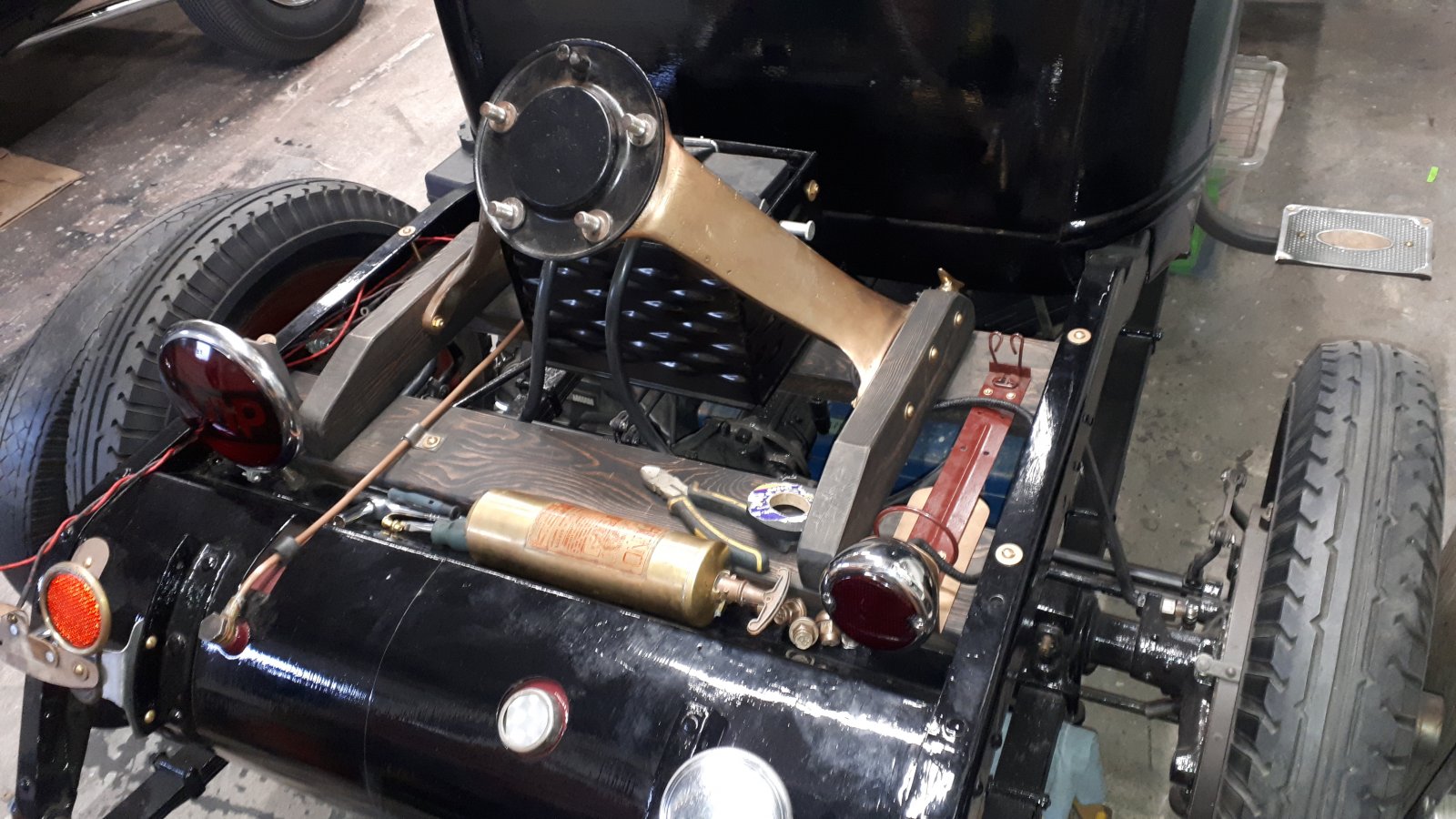

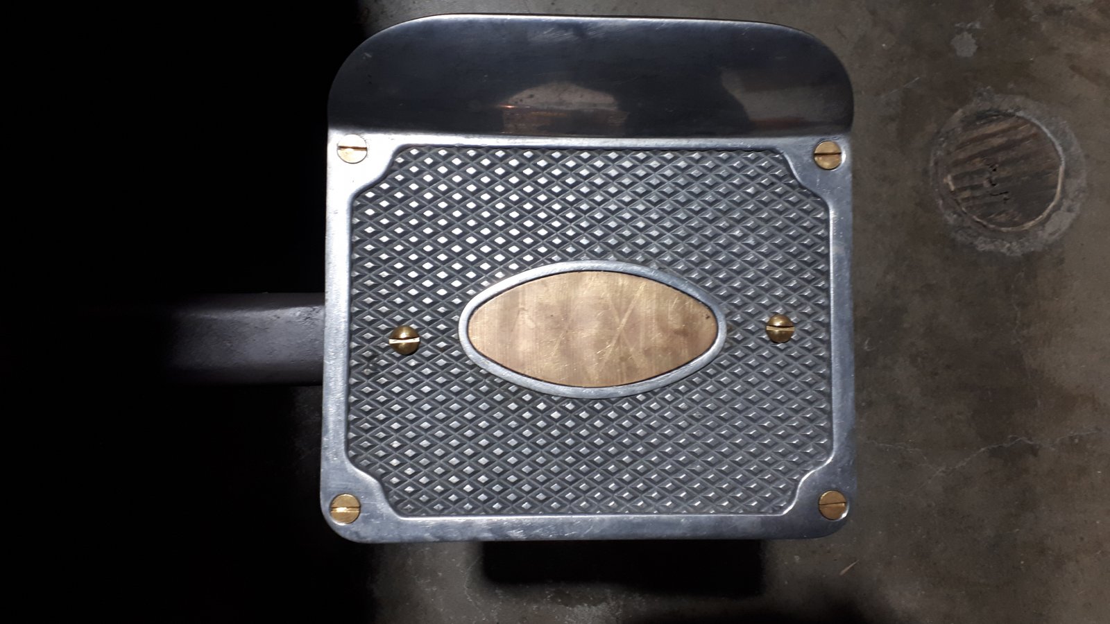

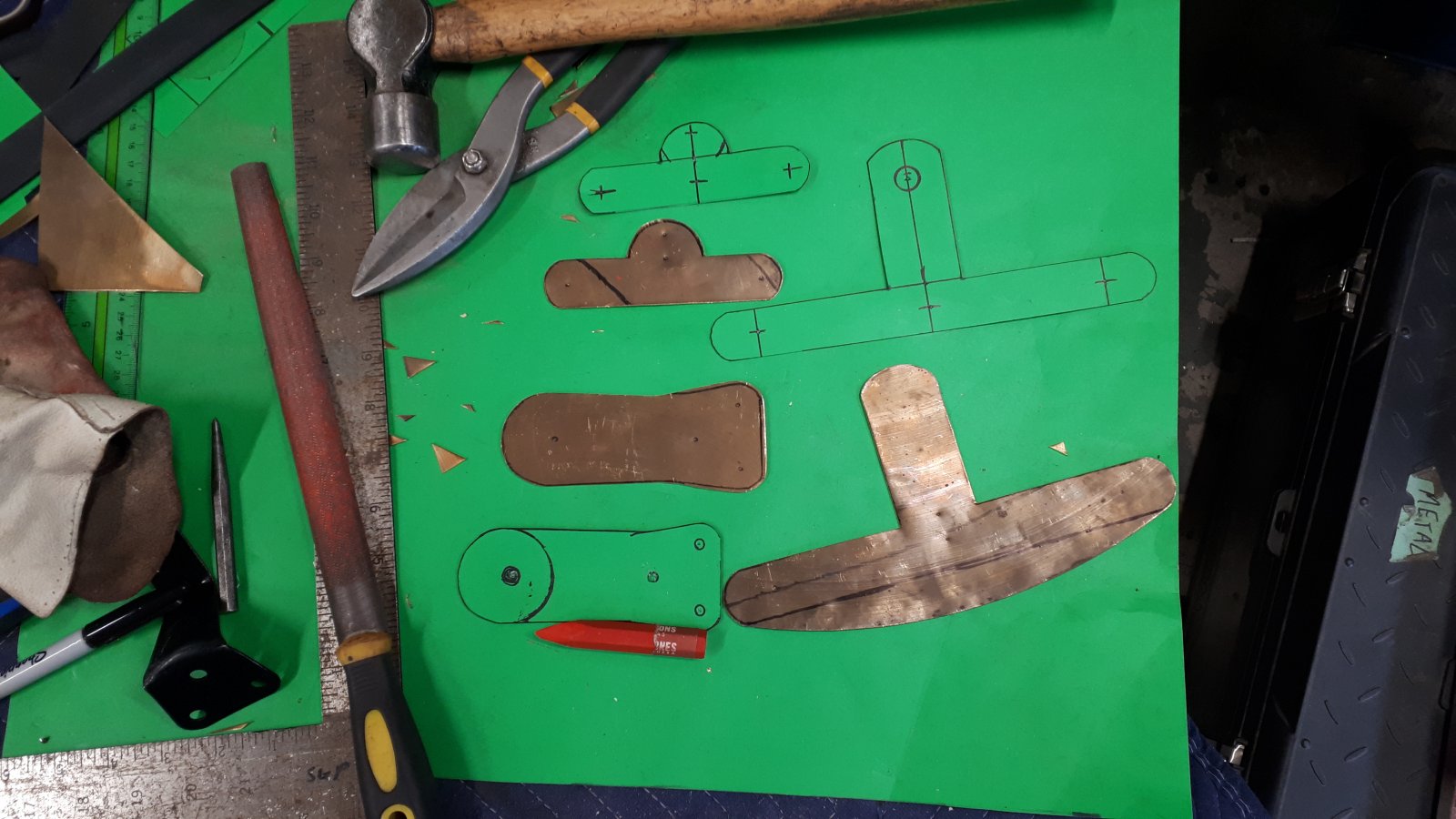

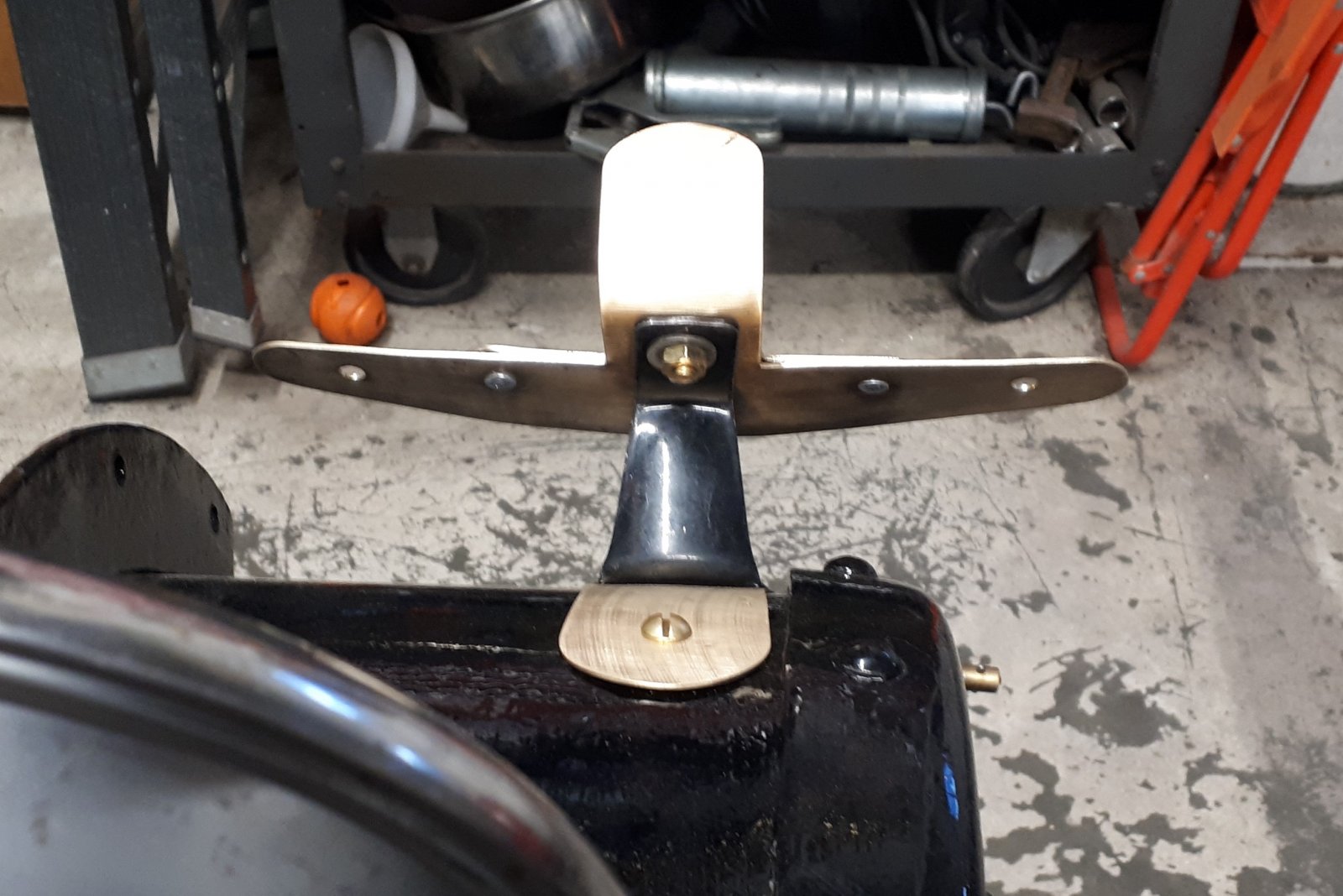

    And now some quick bits and pieces.
    Thanks here to Gary B. and John A. @Chevbucket for the extra parts. You guys rock!

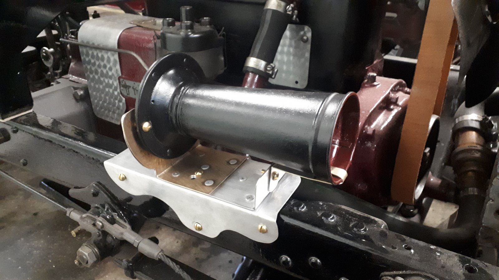

    Horn repair and bracket.
    Model T boot-s****ers + Buick running-board stanchions+ s**** bronze = step plates.
    Tail light bracket and Exterior kill-switch.
    bu20210120_105937.jpg bu20210121_113556.jpg 20220202_131428.jpg bu20210512_144847crop.jpg

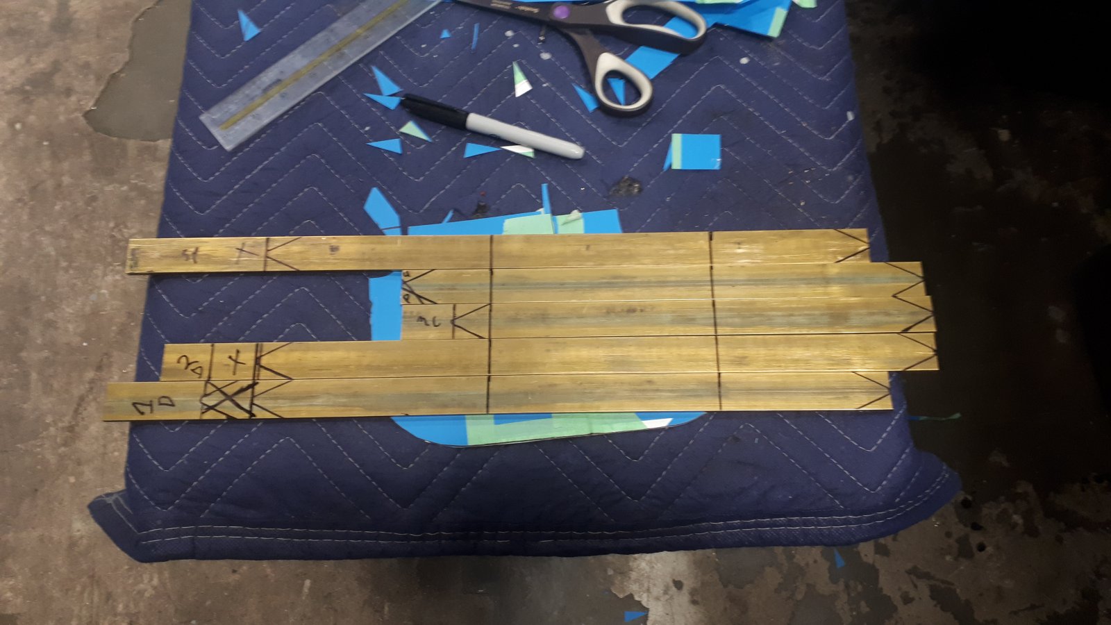

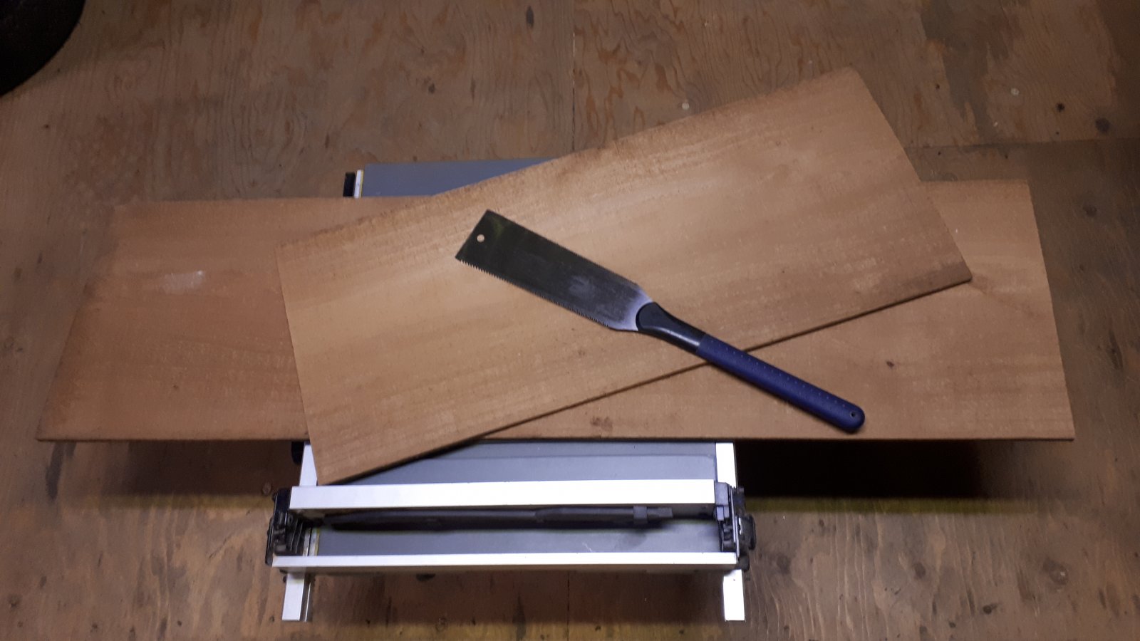

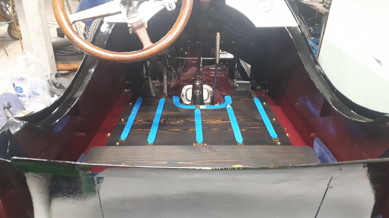

    And the Driver's Floor.
    More cedar cut-offs and some br***-strap from the br***-strap store....

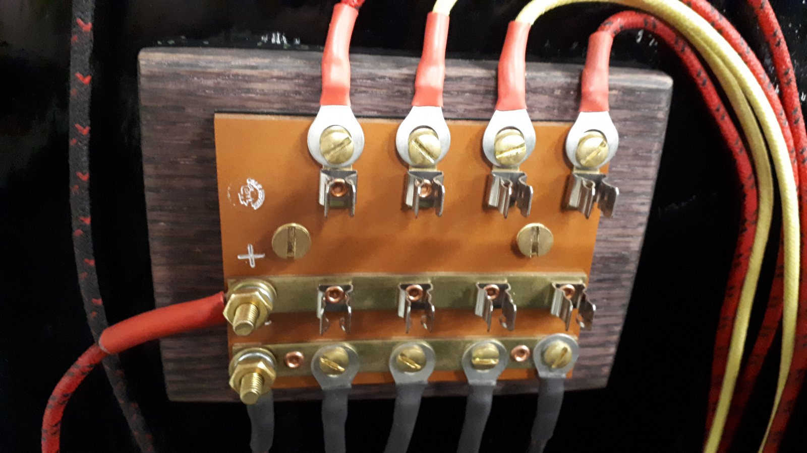

    Wirey...
    All the lights have vintage GM quick disconnects.
    I sourced the cloth wiring, ign. ballast and other bits from Brillman Co. from Mt Jackson, VA, USA
    The starter/generator took much reading and research, but was relatively simple to service in the end.
    So, Make dash light and plan. Mystery panel. Black n Red. Ignition bits and starter/generator.
    bu20211015_134543crop.jpg bu20211018_133616.jpg bu20211012_121910crop.jpg bu20220202_124317.jpg
