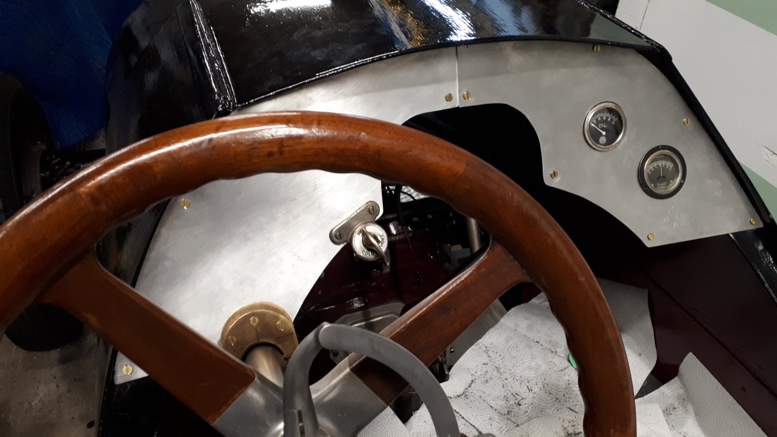

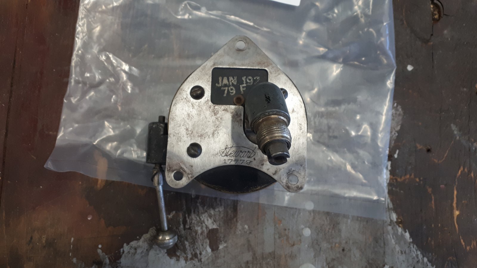

    The Speedometer is a 1923 Warner 75 mph on original Stewart mount.
    These companies would later merge to become Stewart Warner.
    I purchased it as non-functional, but it worked fine, just took some elbow grease, lithium grease and patience to sort it.
    20210205_101647.jpg 20210205_101632.jpg 20210626_105948.jpg 20210626_105925.jpg

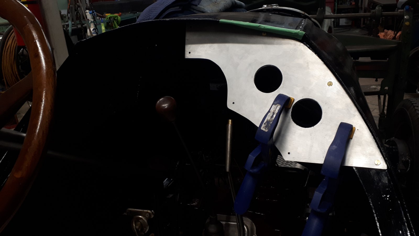

    Dashing!
    Just moving along with the progress shots.
    These gauges are original McLaughlin parts. The stock ammeter was manufactured by Tiffany Co.
    Yes.... That Tiffany's... Bling!
    bu20210104_165153.jpg bu20201226_124857.jpg bu20210105_121801crop.jpg bu20210106_144636.jpg

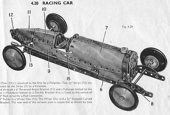

    And a bit of history and inspiration to close this round.
    Photo 1... is a 1925, 50 mile race. I see a Buick, a Ford? a Bugatti and a Vauxhall?
    I am not sure. Please post up if you know.

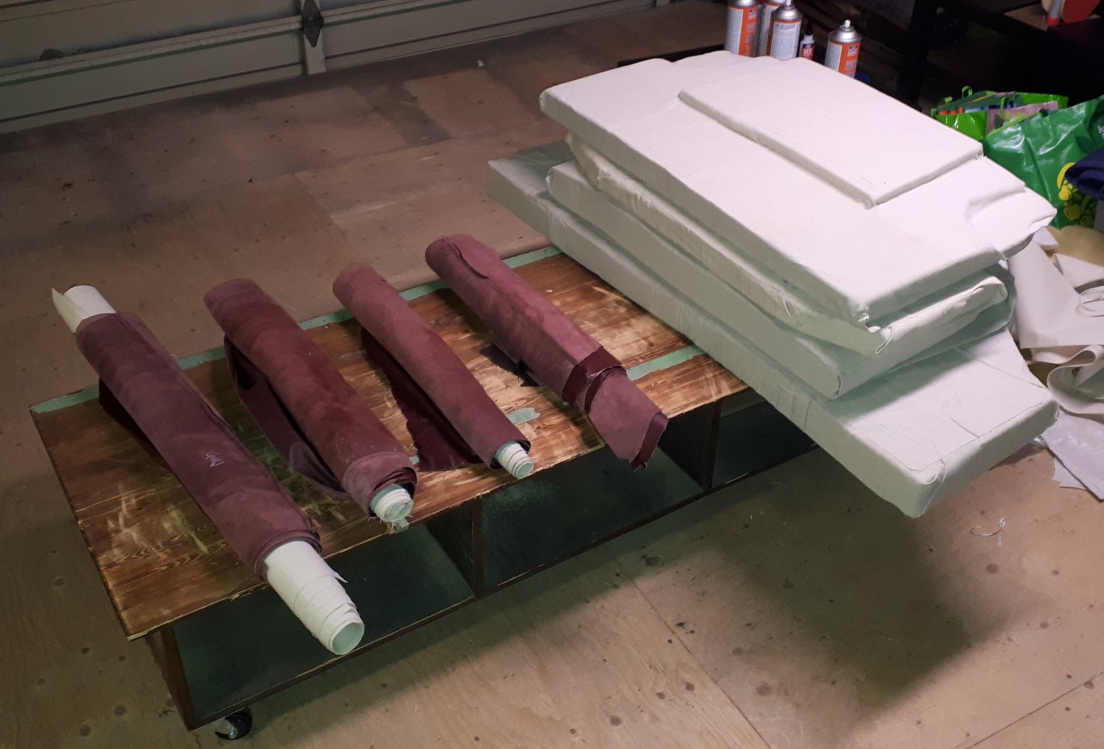

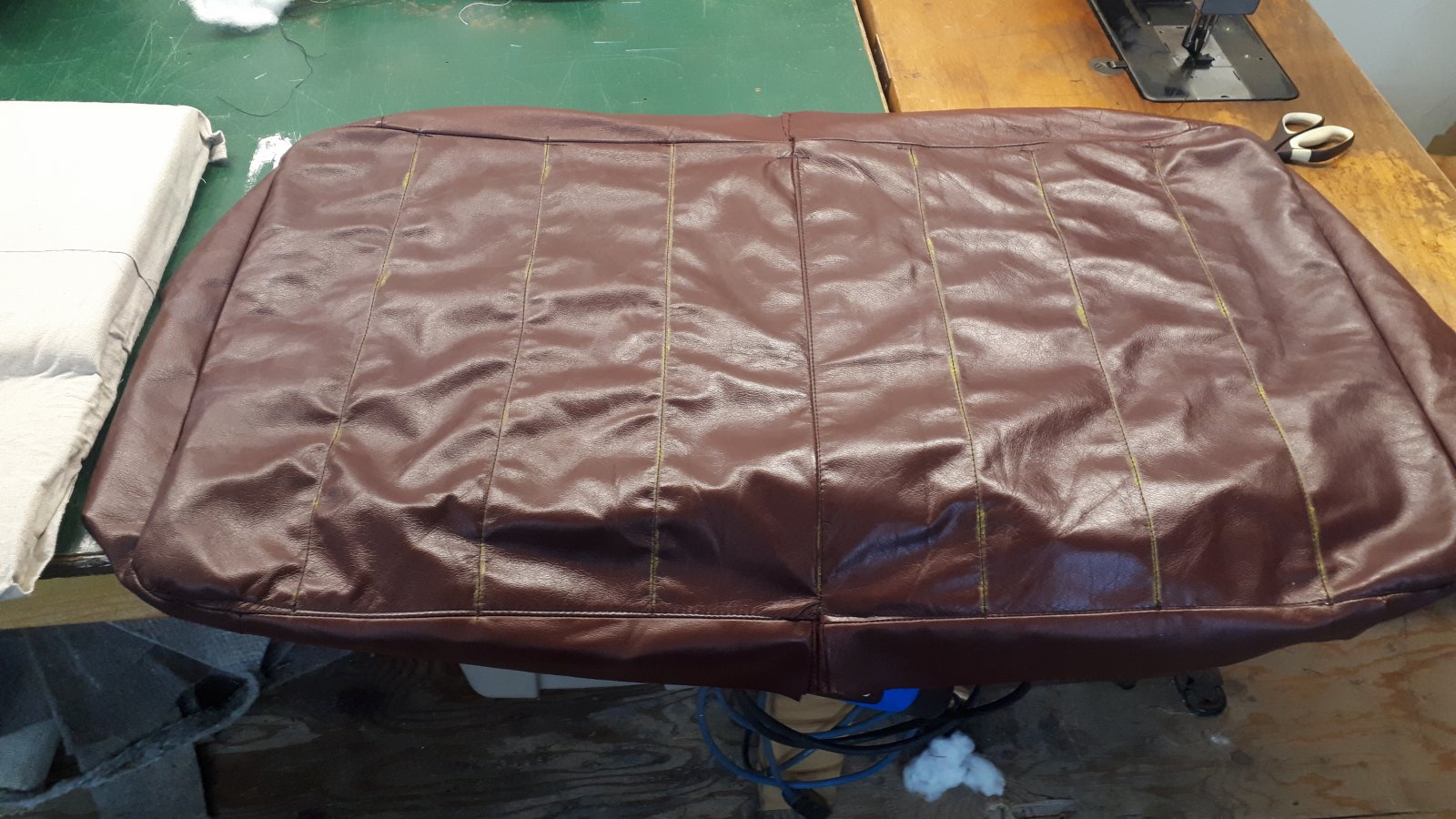

    So i will do an update with some Interior action...
    'Cause it's what's inside that counts!

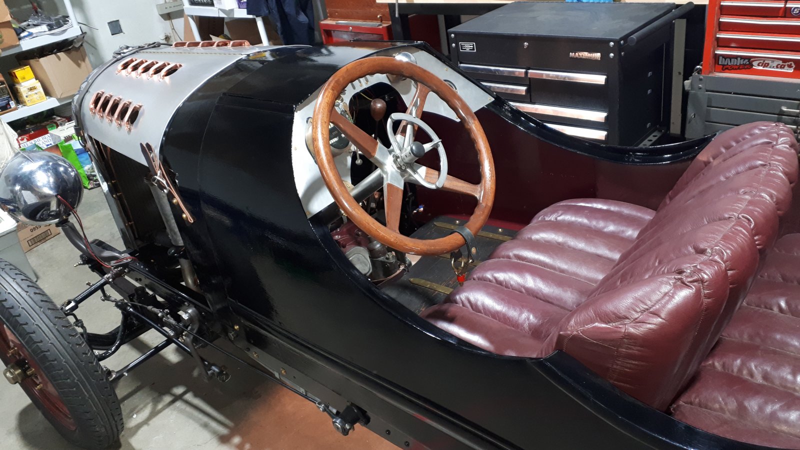

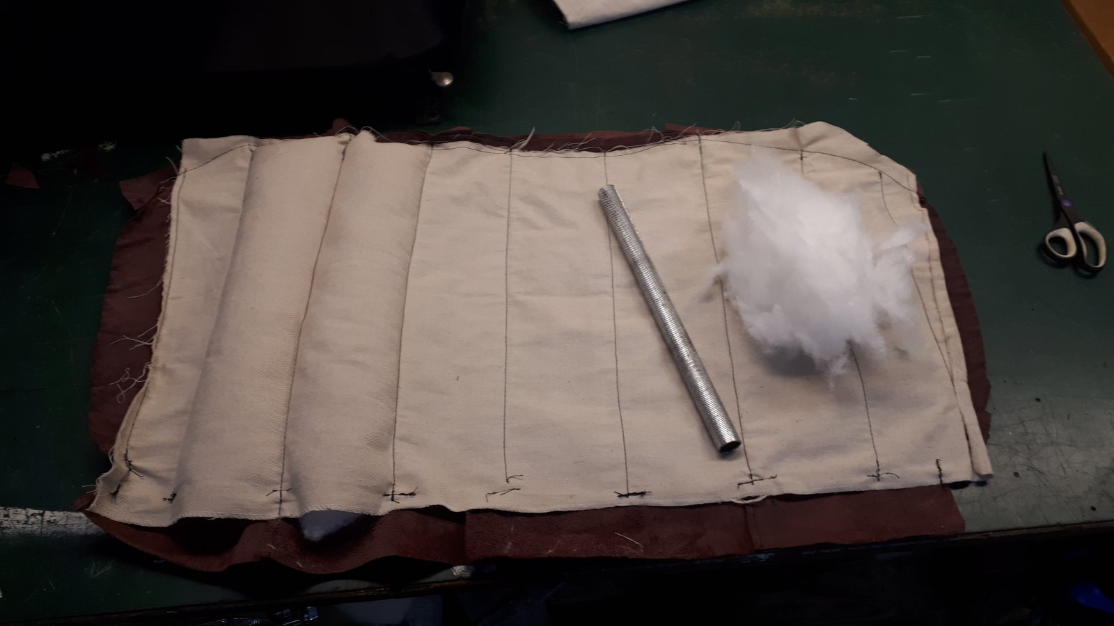

    First, I tracked and skinned a burgundy-hairless-chesterfield and purchased some canvas.
    Layout and s***ching. Stuffing the pleats the old fashioned way. Good times in the upholstery loft.
    bu20210915_154853crop.jpg bu20210918_124551.jpg bu20210918_161657.jpg bu20210918_124543crop.jpg
    Note: My pal Lee Grant was kind enough to let me use his sewing machine AND some of the larger equipment in the main shop to get this whole project done. Big Thanks go out to Lee and his partner Shannon!

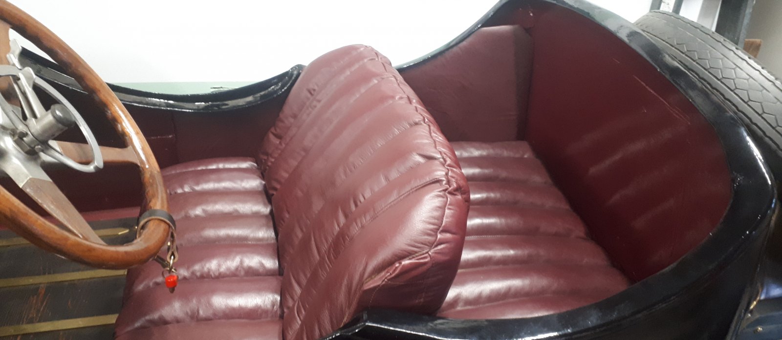

    And then...
    Do more of the same. Much more. Side panels too. Progress.
    I desired that the seating and interior be comfortable enough for longer drives.
    bu20210919_133250.jpg 20210920_155558.jpg bu20210914_123507.jpg bu20210921_181415crop.jpg
    burl, Shadow Creek, 282doorUK and 2 others like this.
  8. 282doorUK
    Joined: Mar 6, 2015
    Posts: 533
    282doorUK
    Those seats are looking very deluxe!
    I used the old leather furniture trick for mine too, you did well to get all that from one chesterfield.

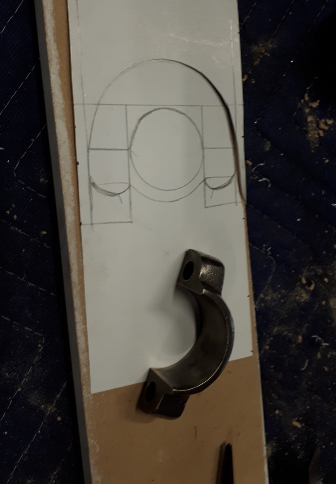

    So, I liked the look of the stamped-br*** scoops on this restored 1912 Sunbeam.
    It seems the use of cabinet hardware on cars goes all the way back!
    So, I made a hinged hood and added the same, but More.

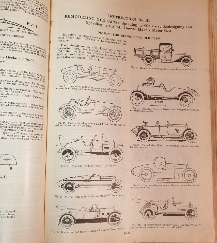

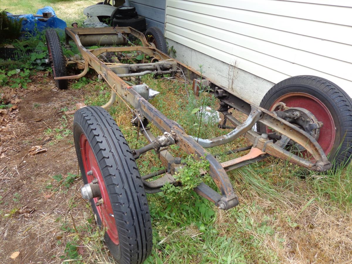

    To Sum it all up... Find something like this.
    Use old concepts like these. And a few new ideas ;)
    To build things like these.
    1924 buick as found.JPG dykesmanual2crop.jpg Williams-Pratt-Duke-Meddaugh.jpg 01.jpg
    Note: My aesthetic concept for this car was to place it right in the middle of these two style examples.
    One a home-built flivver, the other a factory designed racer.
    I wanted a bit of both worlds.

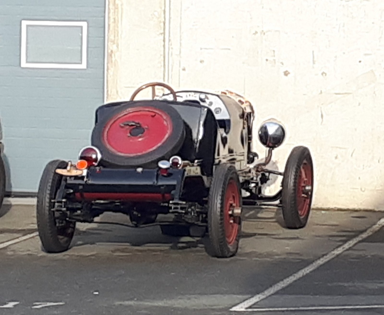

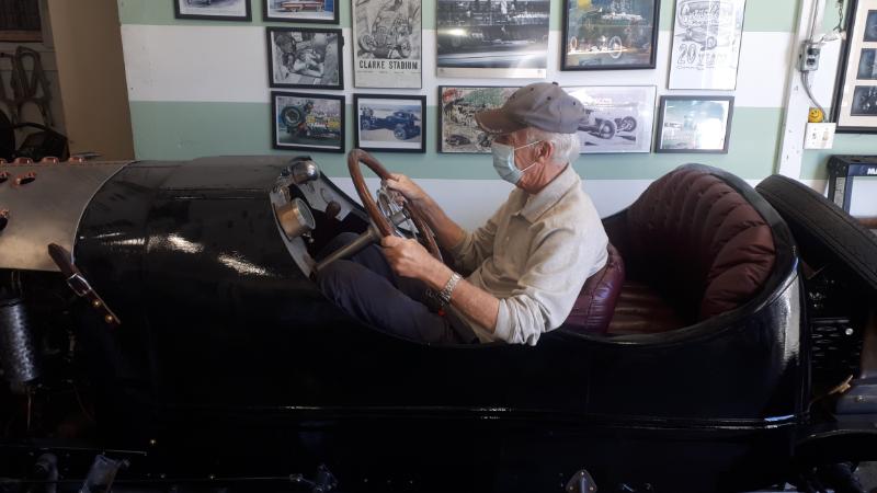

    Which brings us to this point. Still working on more details and adjustments, but it is now a real live car and spring is on the way!
    bu20211205_110552crop (1).jpg bu20211205_110552crop (2).jpg bu20220202_133938.jpg Buick 1924 07.jpg

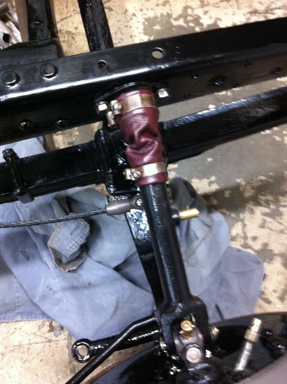

  15. AmishMike
    Joined: Mar 27, 2014
    Posts: 1,449
    AmishMike
    Deeluxe likes this.
  16. Deeluxe
    Joined: Dec 16, 2005
    Posts: 166
    Deeluxe
    from island

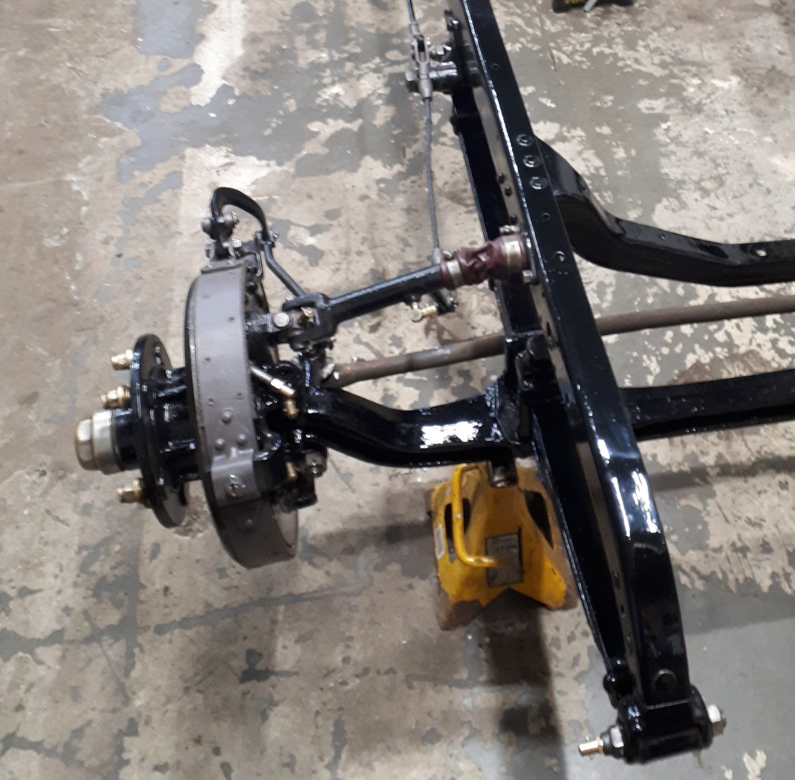

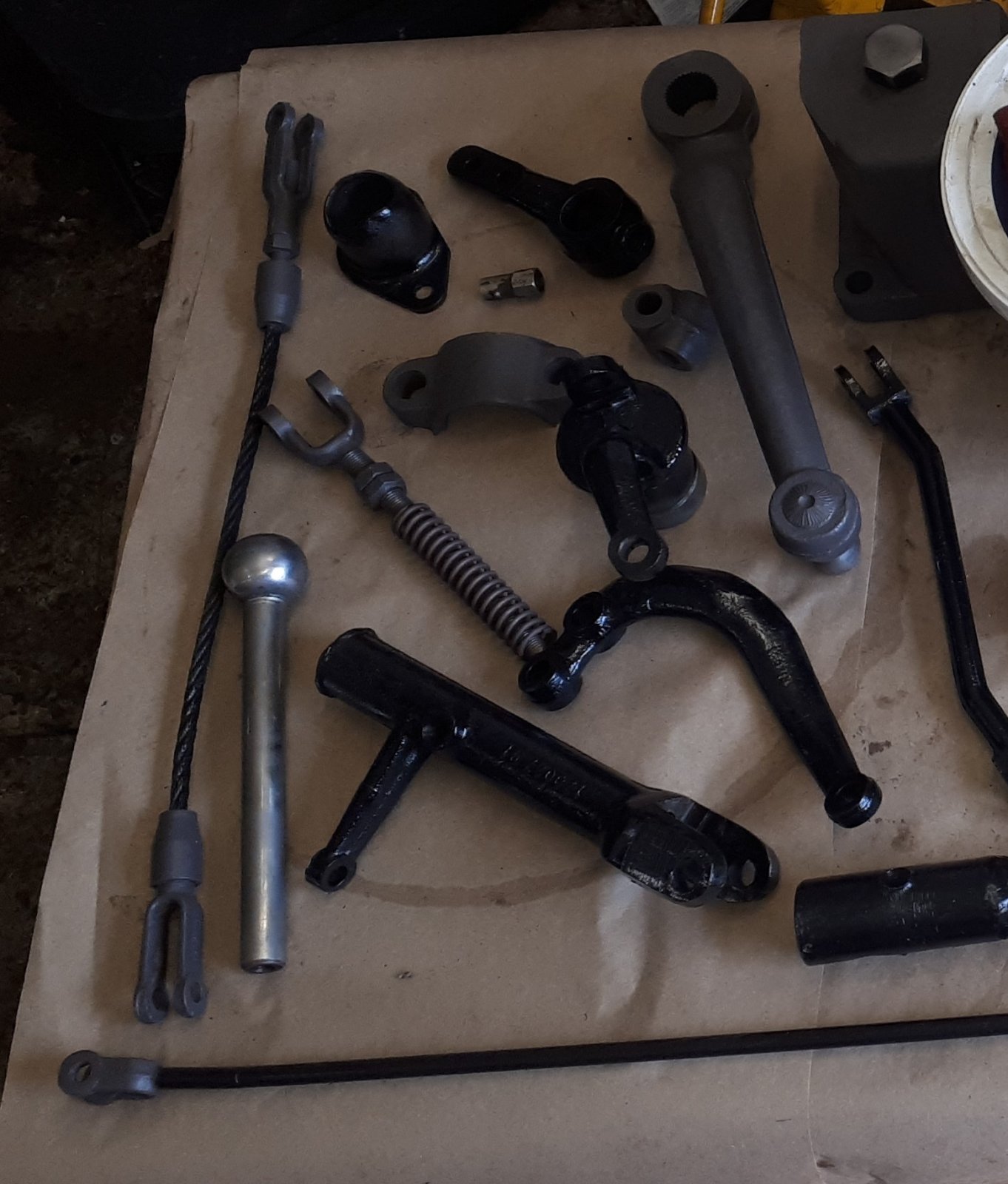

    Hey AmishMike. Do you mean this brake pivot shaft?
    Photo is taken standing at the wheel, looking down.
  17. Deeluxe
    Posts: 166
    Deeluxe
    from island
    There is an inner shaft and outer sleeve. There is a captured-pivot at the frame side and a U-joint at the backing plate side.
    These photos should help. Note the shiny inner pivot shaft, it slides and pivots, allowing the suspension to travel freely.
    The brake rod and cable pulls on the arm, turns the outer shaft...and actuates the front brakes.
    Note: Having brakes on all four wheels was a Major selling feature in 1924. Wild.
  18. AmishMike
    Posts: 1,449
    AmishMike
    Tks for answer. Saw brake rod could not see where connected. Never seen one like that. Real strange & sure new to me
    Deeluxe likes this.
  19. Deeluxe
    Posts: 166
    Deeluxe
    from island
    ...That is exactly what I thought when I was dealing with them...
    Actually a very stout, yet finely adjustable, brake system from those engineers back then.
