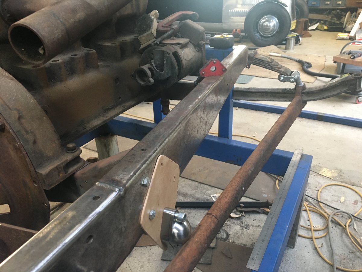

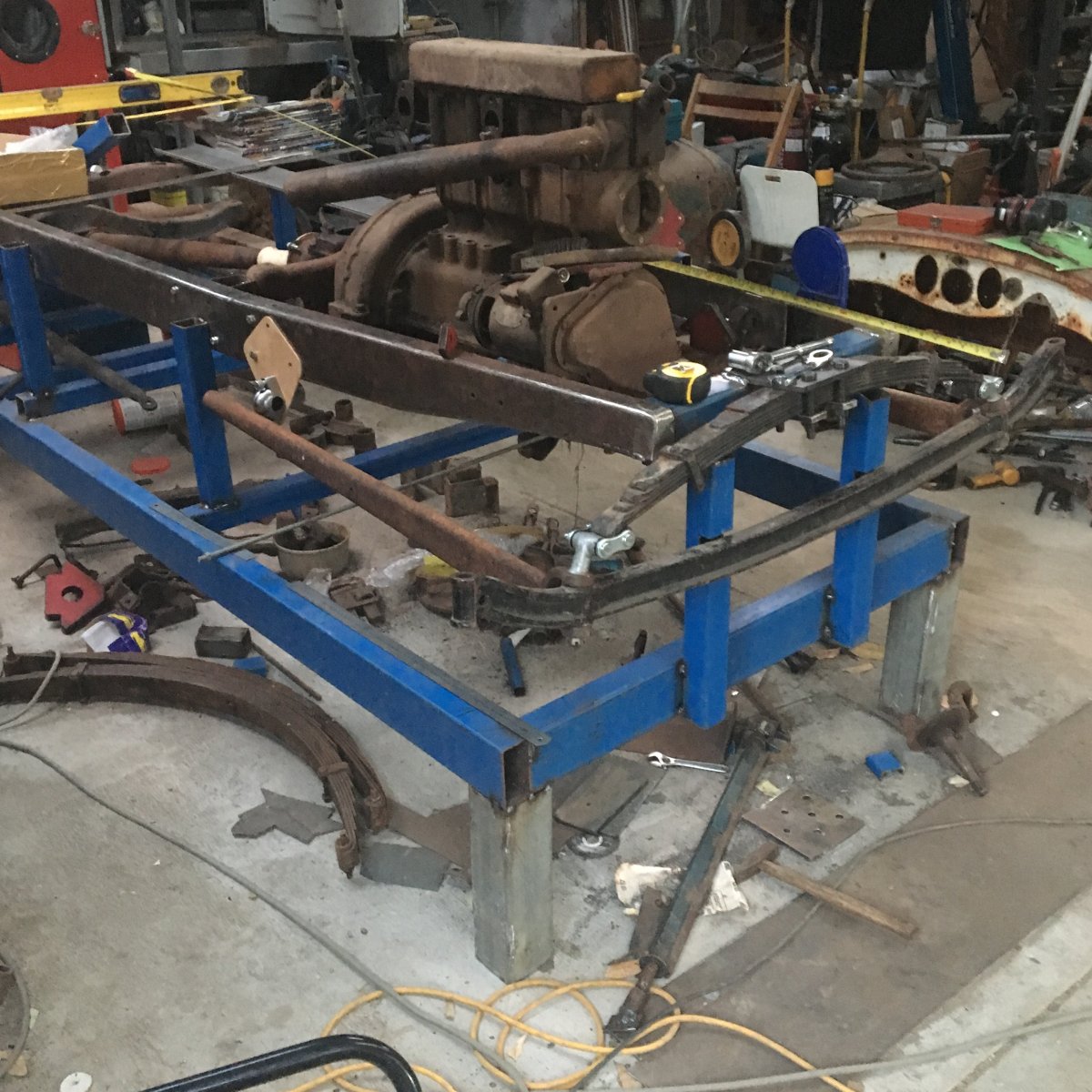

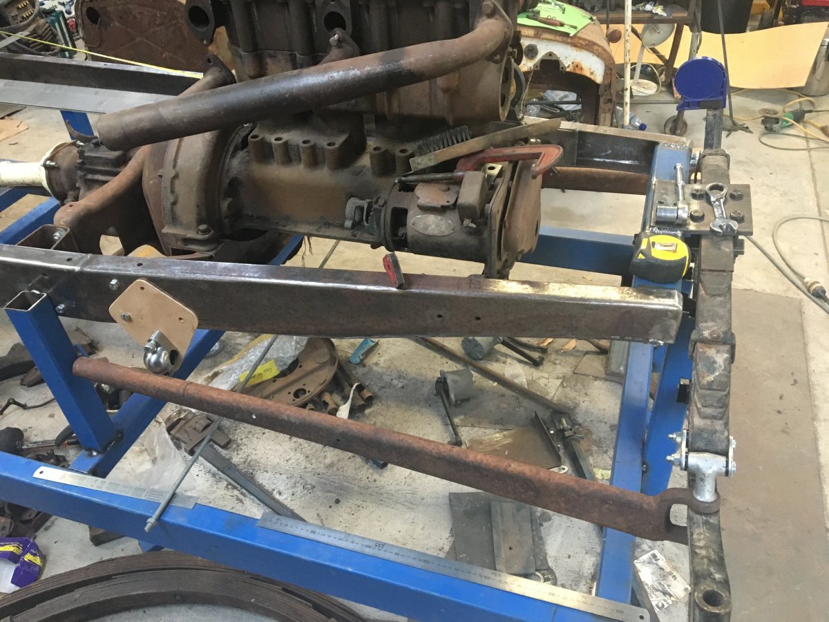

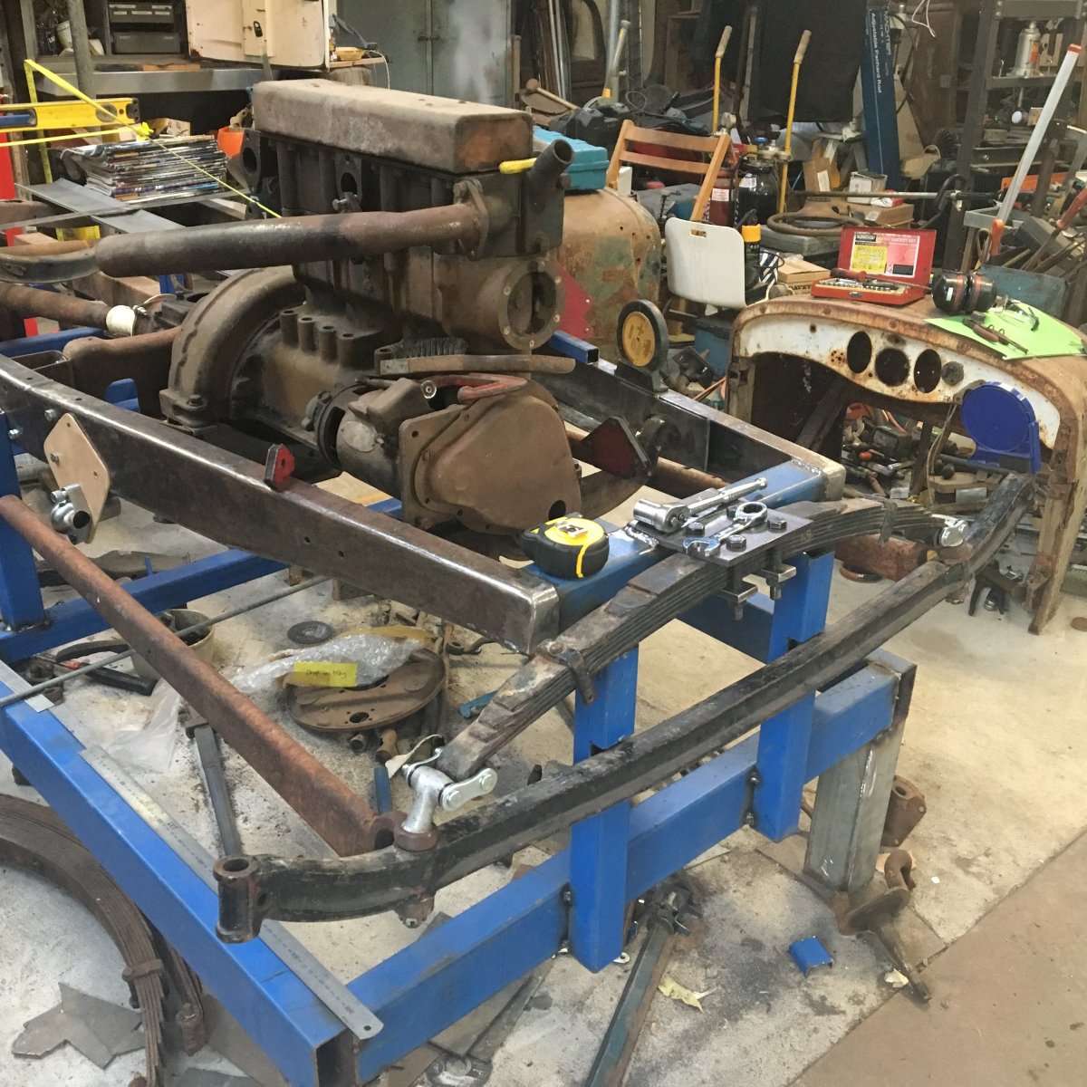

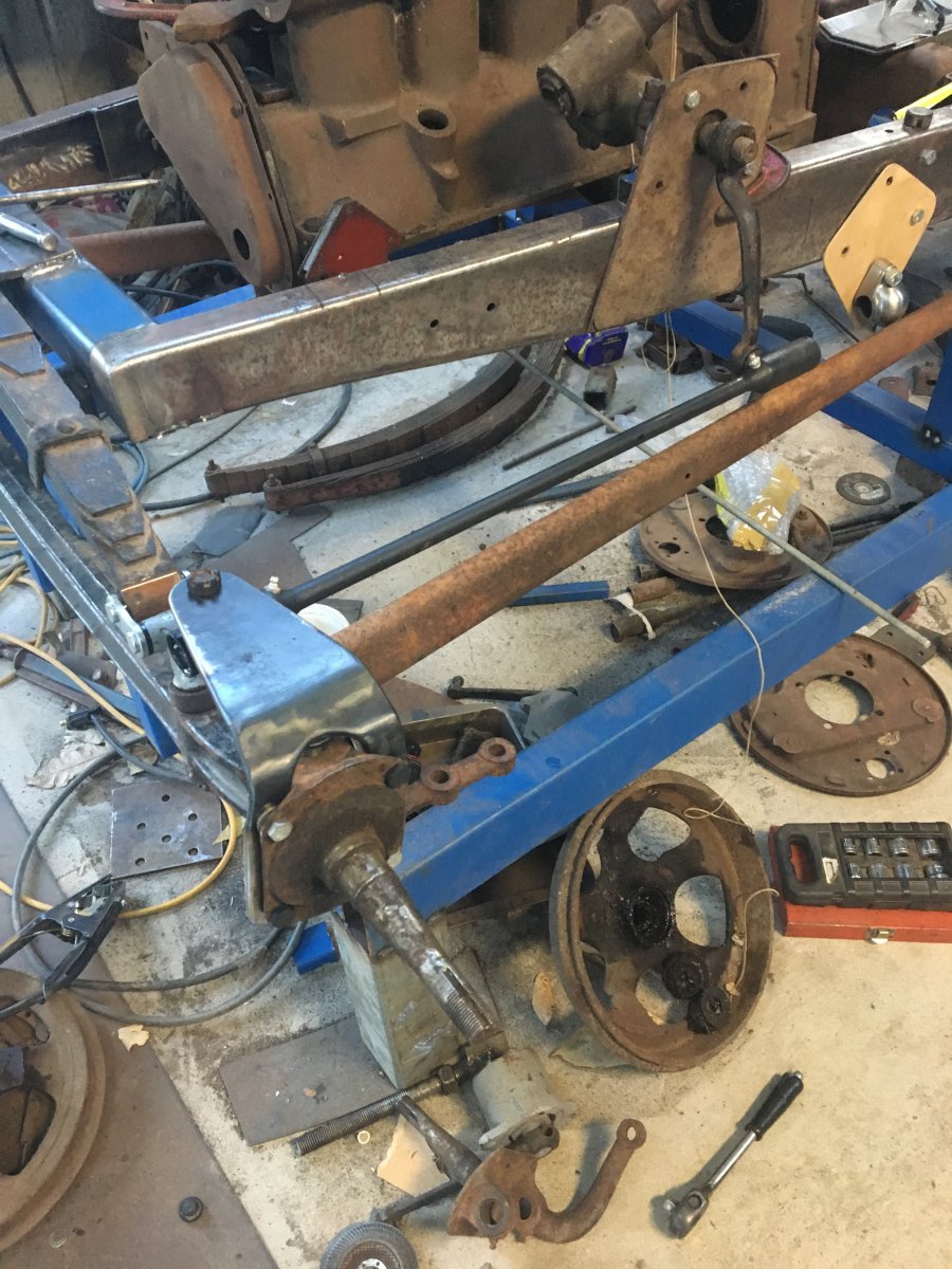

  8. So have cleaned around the ch***is, bought some parts. My taillights arrived finally. I have cleaned the ch***is & currently working out how to run the handbrake, I have a few ideas will stew on them a while. Will start work mounting the front shocks.

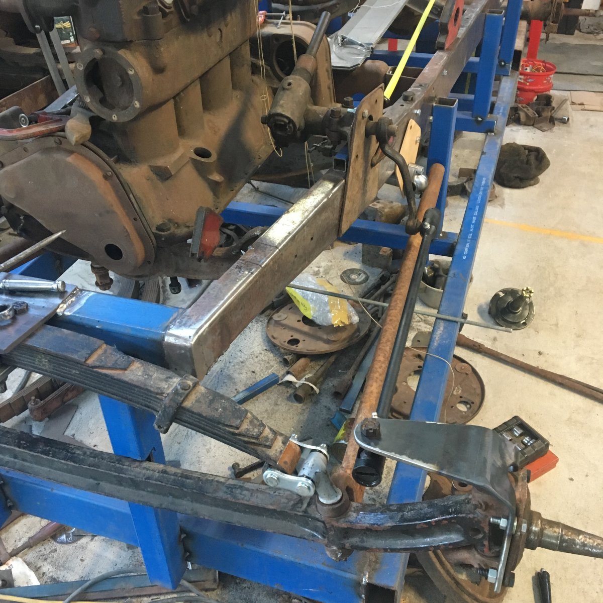

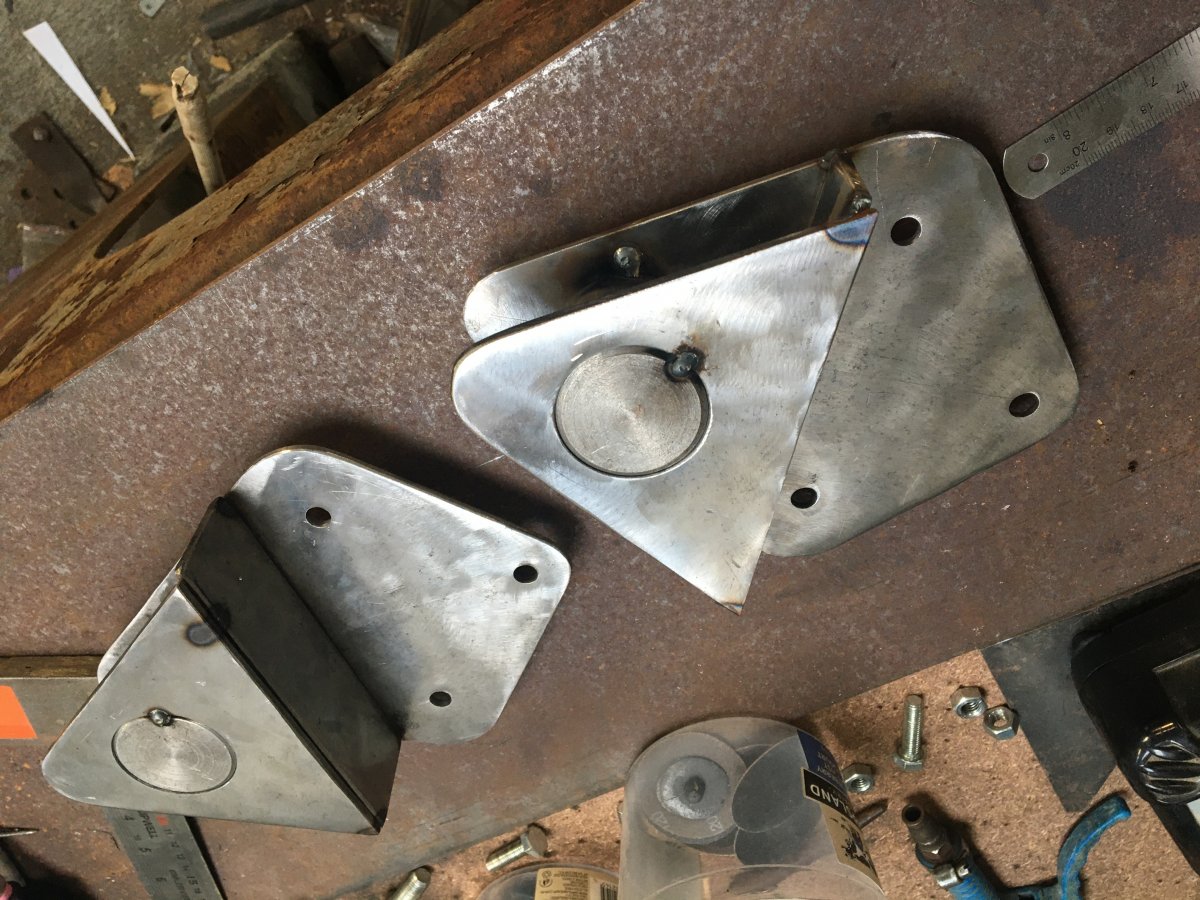

  19. Sorry for the delay in updating, progress is.... slow as I go. I have been waiting on parts and material to start the handbrake. I purchased a hand pressure pump, I may use this or save for my '25 T. I bought the Willys tie rods so I could run the '36 spindles with '32 wishbones without dropping the steering arms.
    IMG_4724.JPG IMG_4727.JPG IMG_4728.JPG IMG_4730.JPG IMG_4731.JPG IMG_4732.JPG IMG_4733.JPG IMG_4716.JPEG

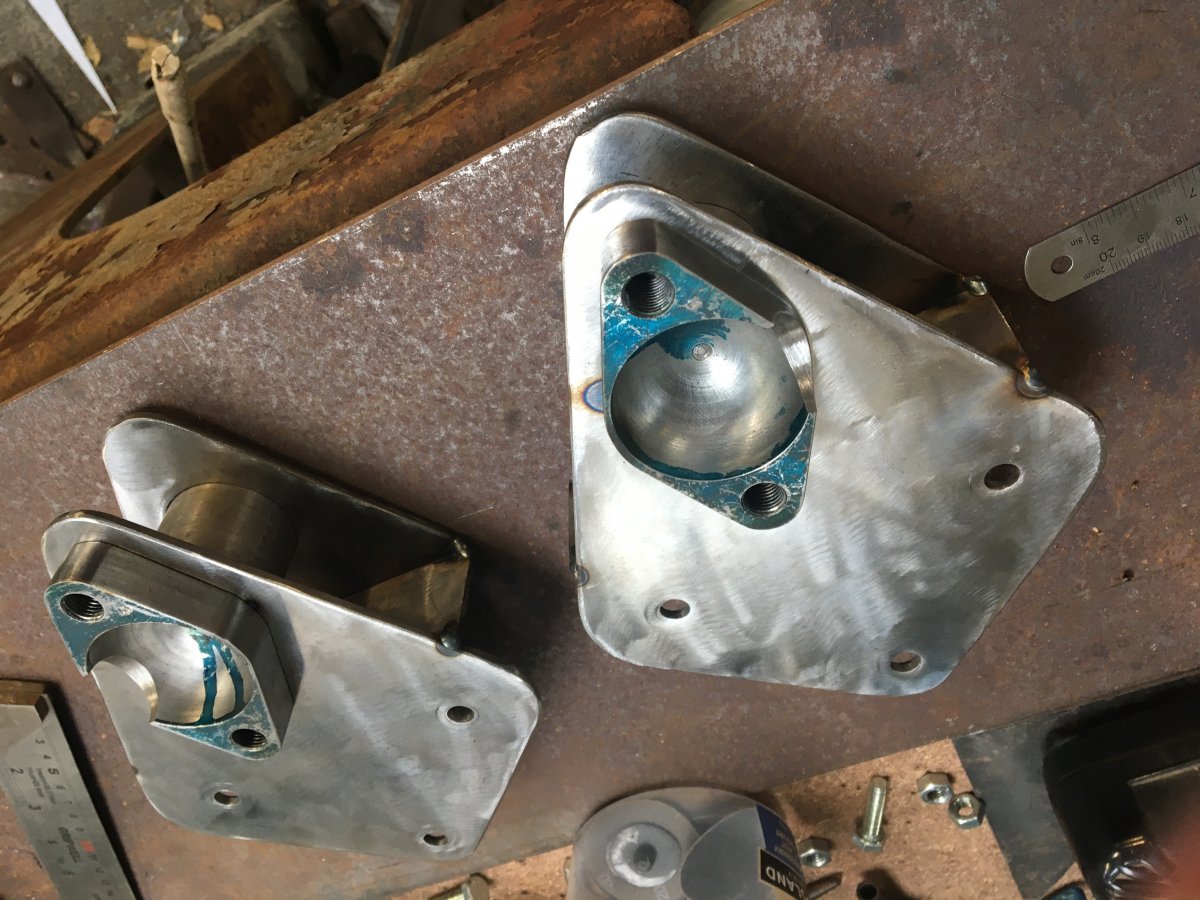

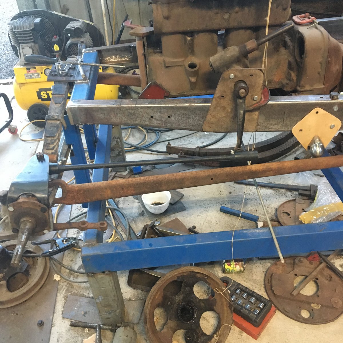

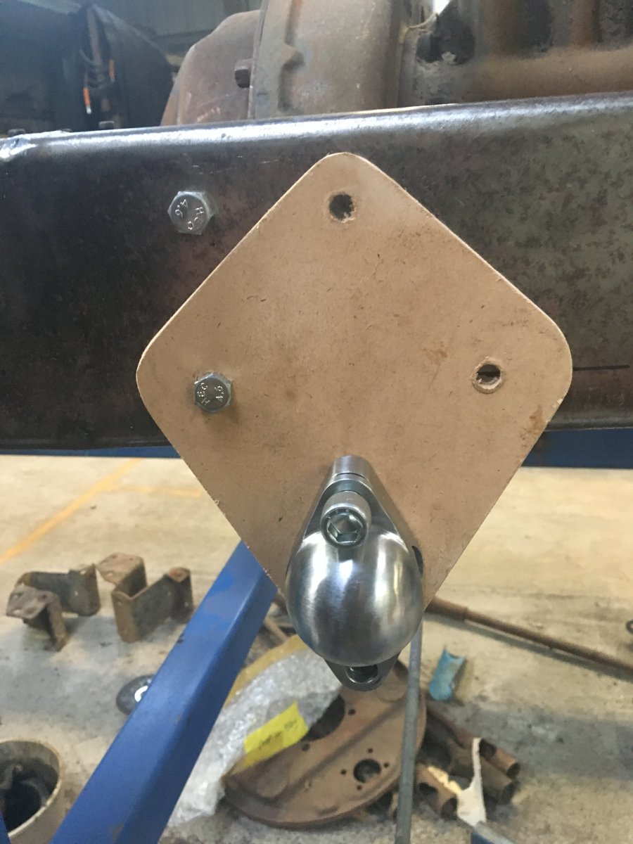

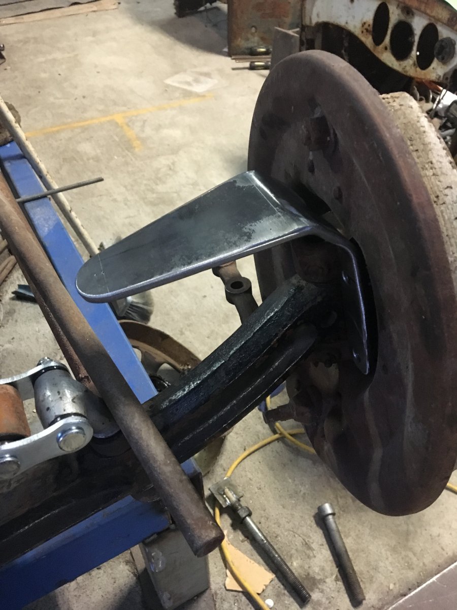

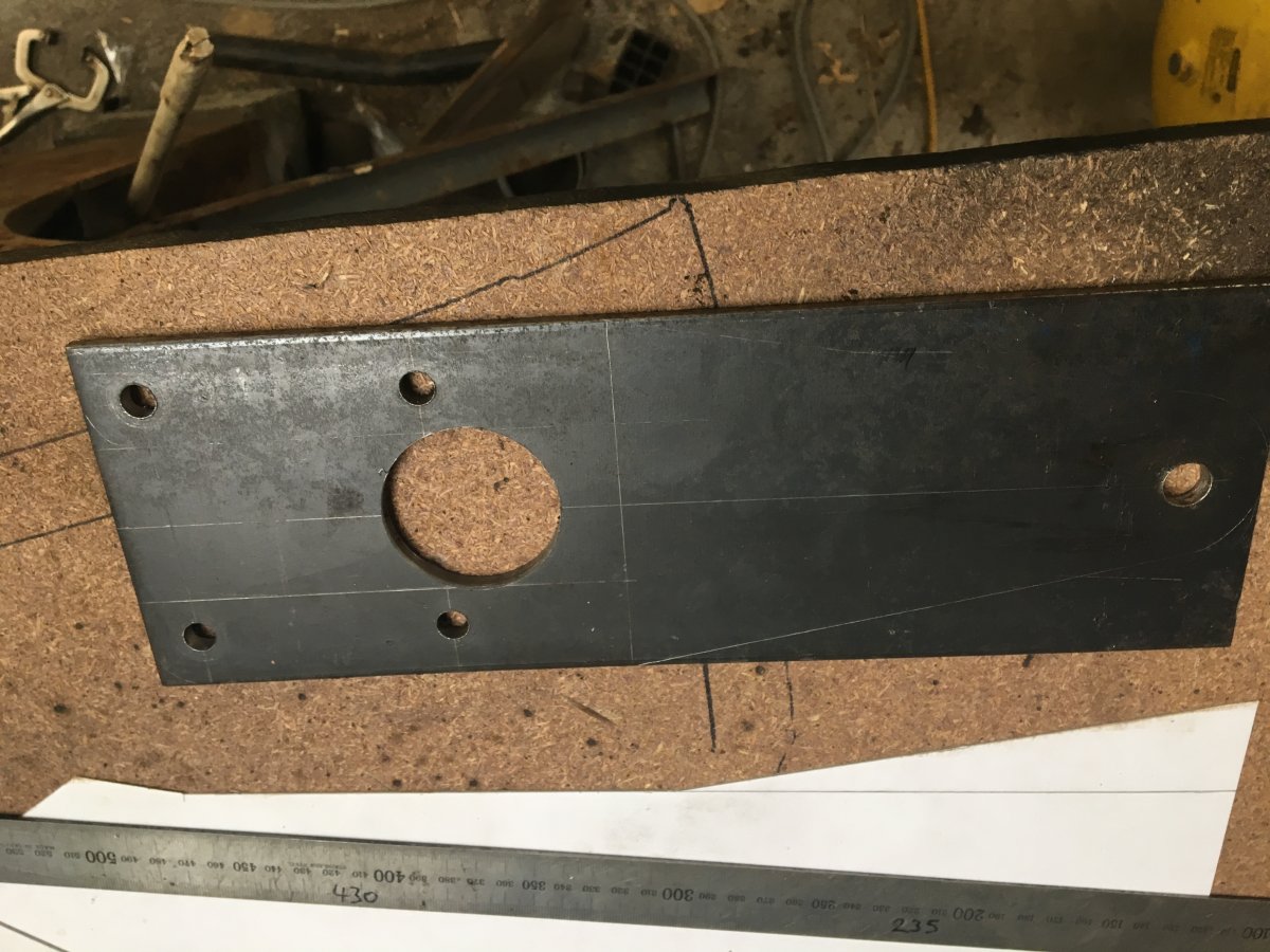

  20. Starting the handbrake mechanism...
    IMG_4737.JPG IMG_4738.JPG IMG_4739.JPG IMG_4741.JPG IMG_4742.JPG IMG_4743.JPG IMG_4744.JPG IMG_4747.JPG IMG_4748.JPG IMG_4749.JPG IMG_4752.JPG IMG_4725.JPG

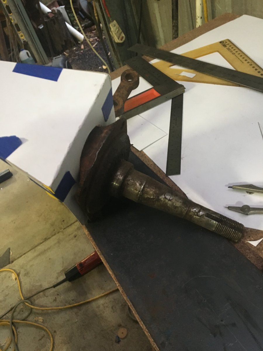

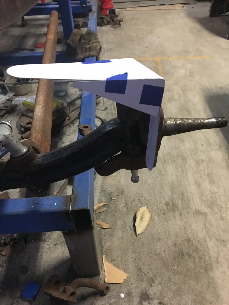

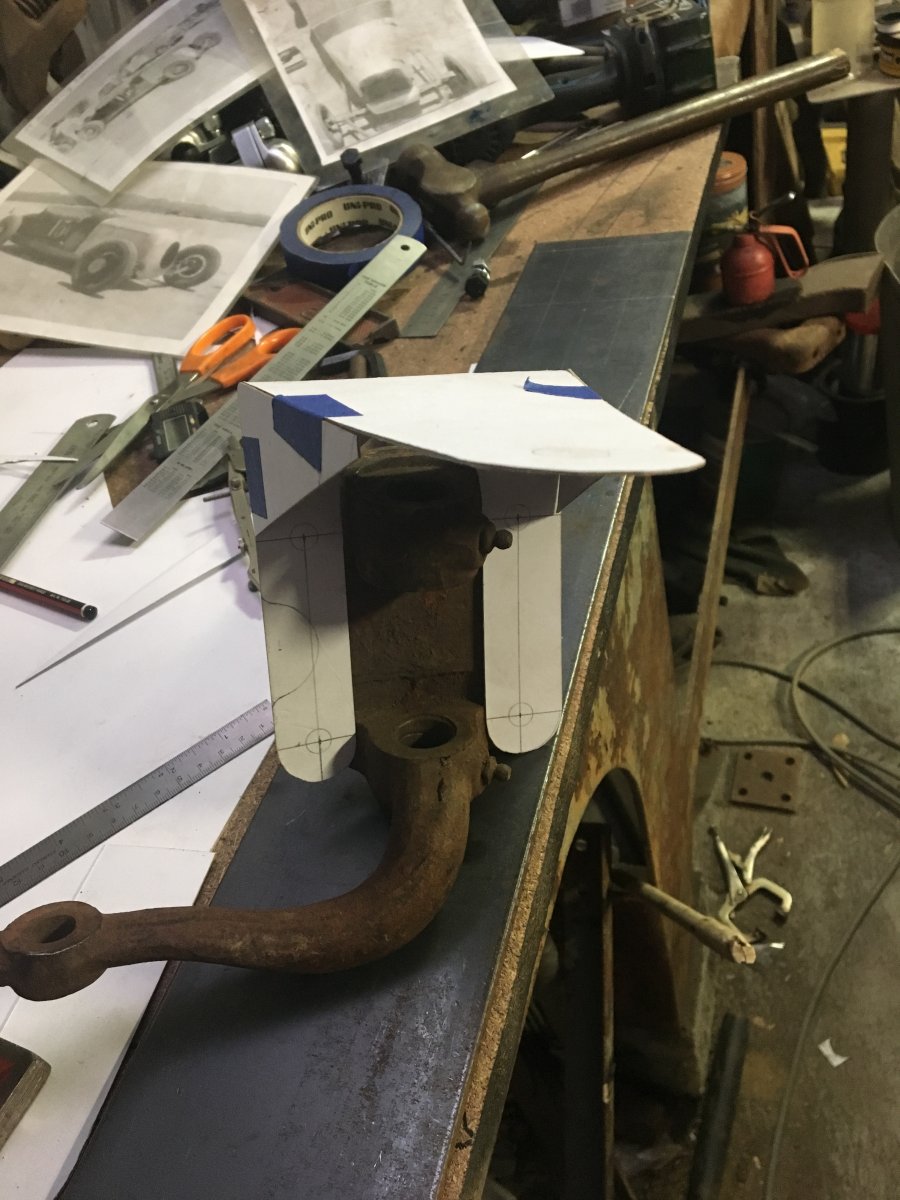

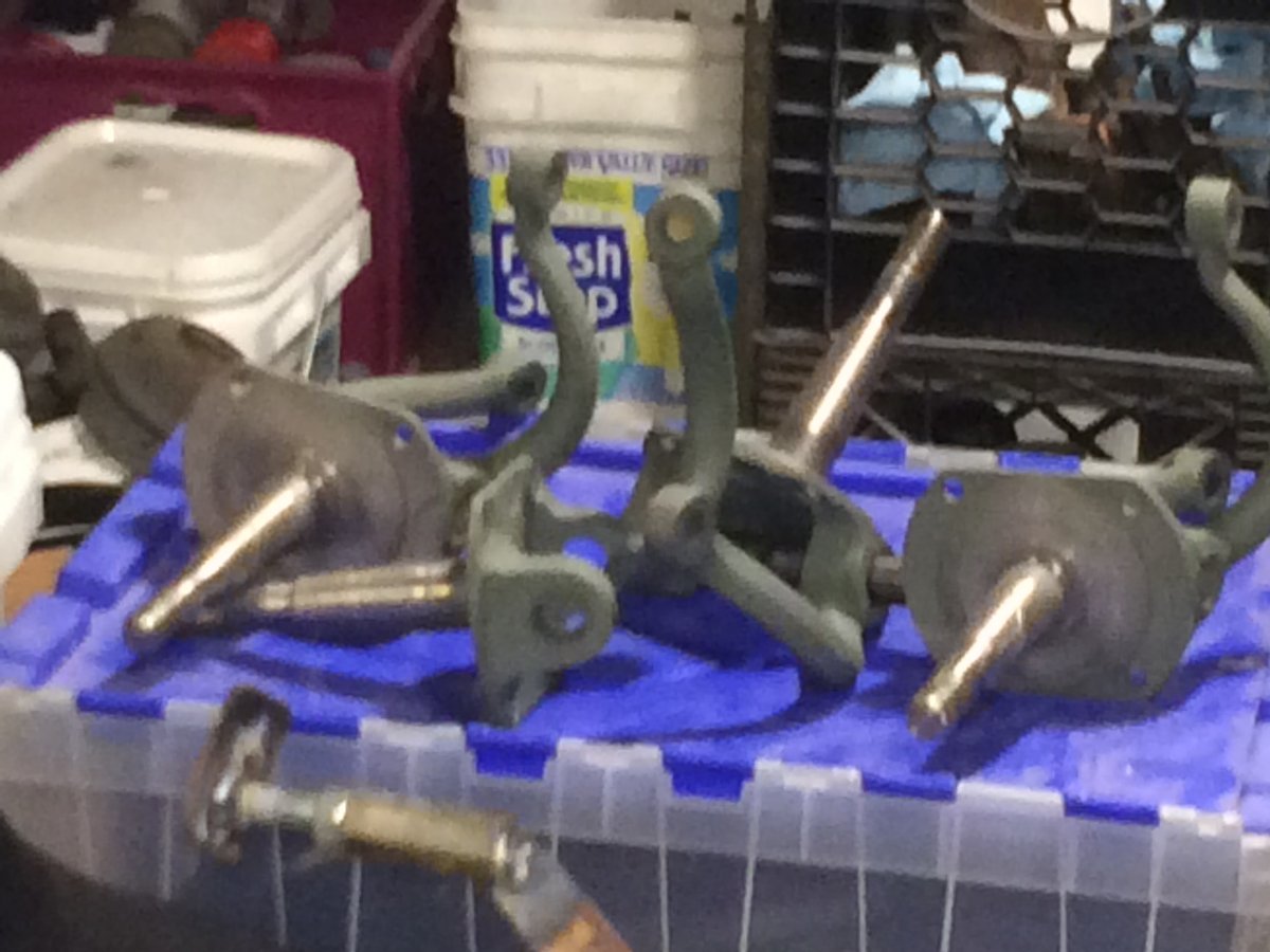

    Now on to the important part. In the post about the steering arm, if the engineer gives you grief, have you thought about using a 32-34 left front spindle? The steering arm is forged in like the tie rod arms. I know it's not like the roadster you are inspired by, but it might be a way to get that engineer to sign off on it.
    I sure am glad we don't have that requirement here in the states, at least not anywhere I have ever lived.
    IMG_0148.JPG Sorry for the poor picture quality, it's all I have tonight. The leftmost and rightmost spindles in the picture have the steering arms forged in. I'll take a picture of one tomorrow (that's Sunday am our time...) and post it for you to see.

    It is a left side steer spindle, which appears to be the side he is steering from in his pictures, to be faithful to the Spurgin roadster. But I wonder if they have to turn the steering wheel the other way down undero_O. Coreolis effect...

    Thank you for the suggestion about '32-'34 spindles, I do have a pair of '34 spindles I will use if the steering arm I made is not accepted. The engineering requirements are a hoop to jump thru but the end result is a much higher standard of builds.

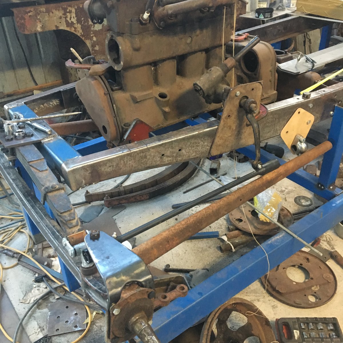

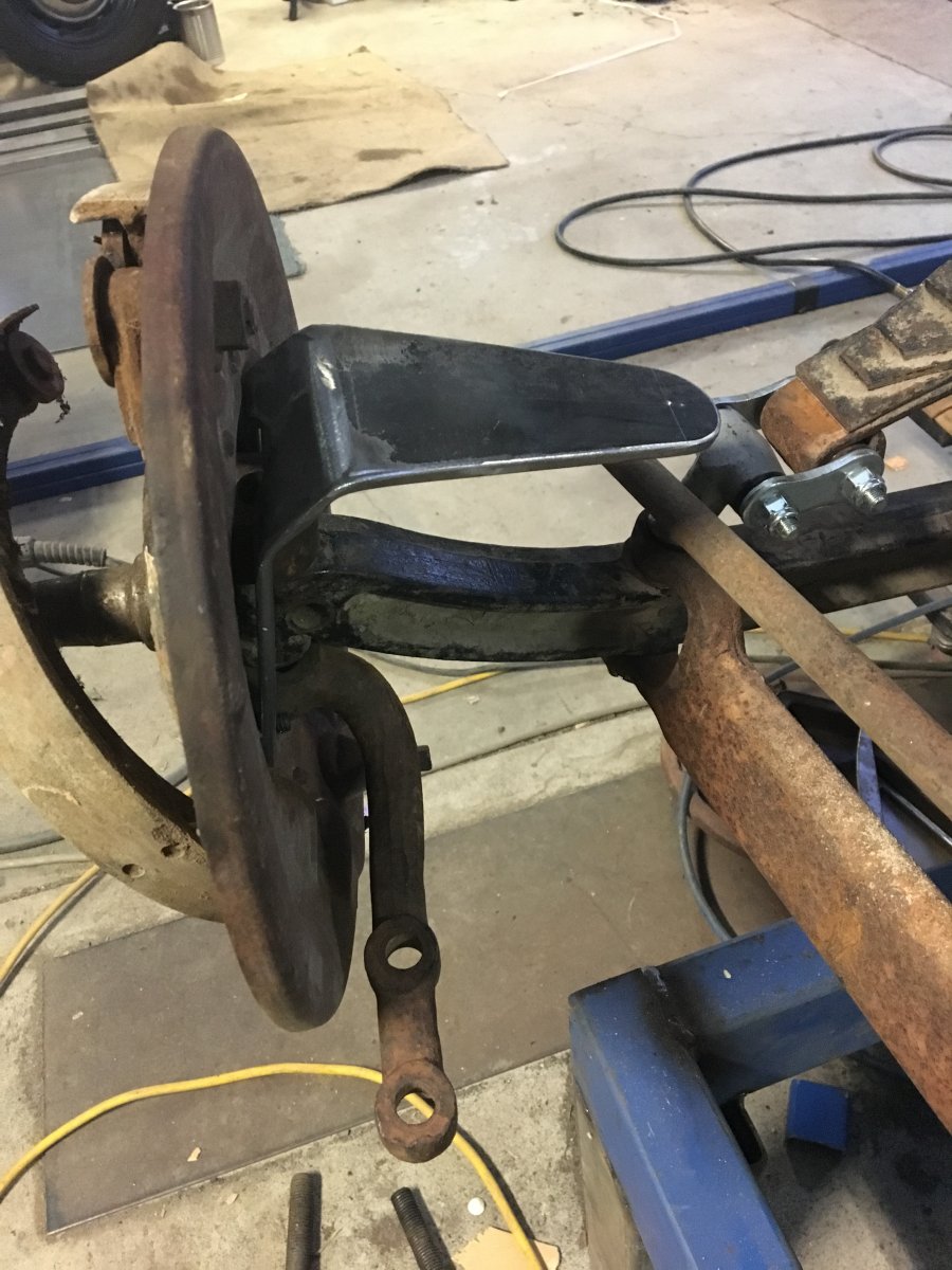

  29. Started on the handbrake cross-shaft. I finished one side & will turn the other side this afternoon. IMG_4805.JPG IMG_4806.JPG IMG_4807.JPG IMG_4811.JPG IMG_4812.JPG IMG_4813.JPG
