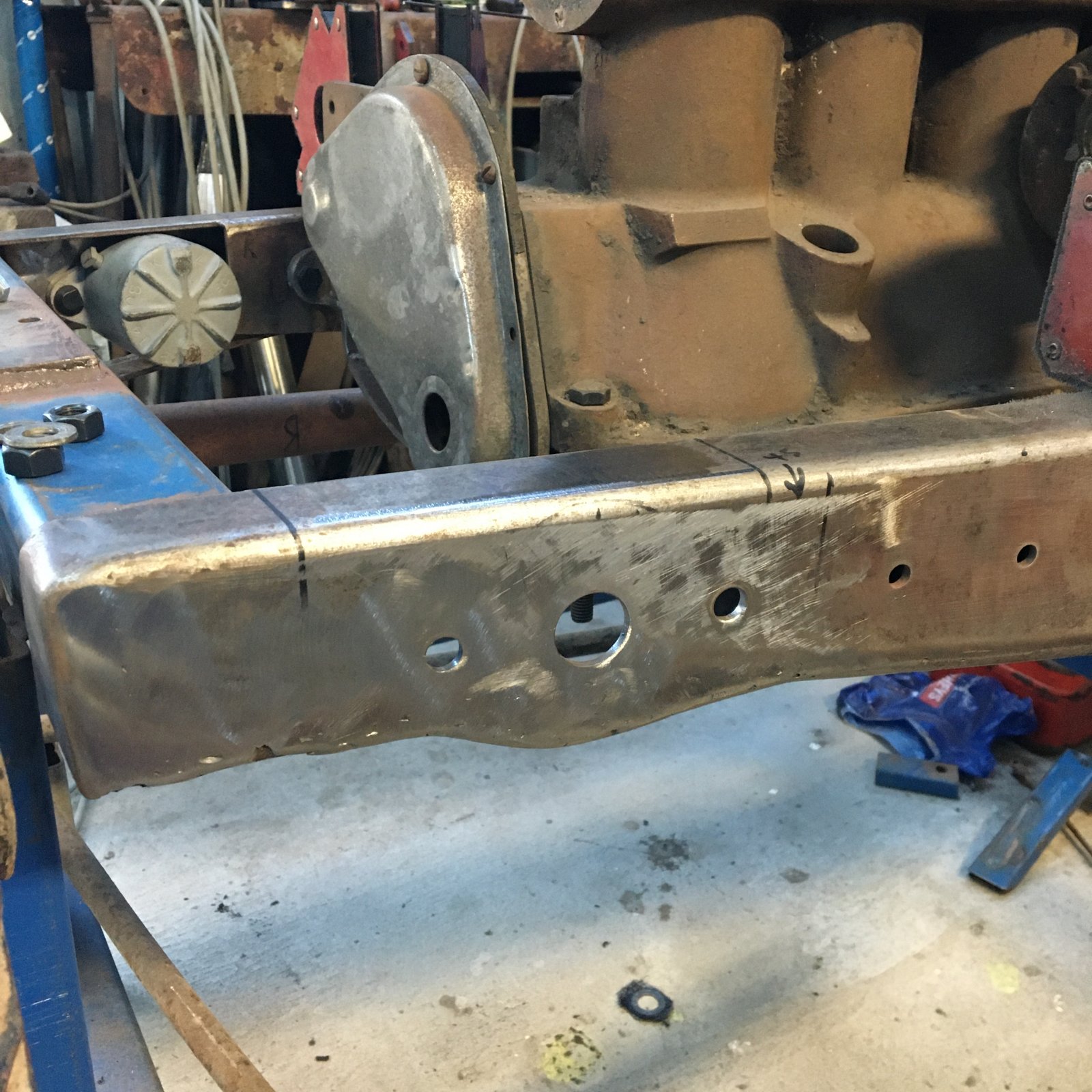

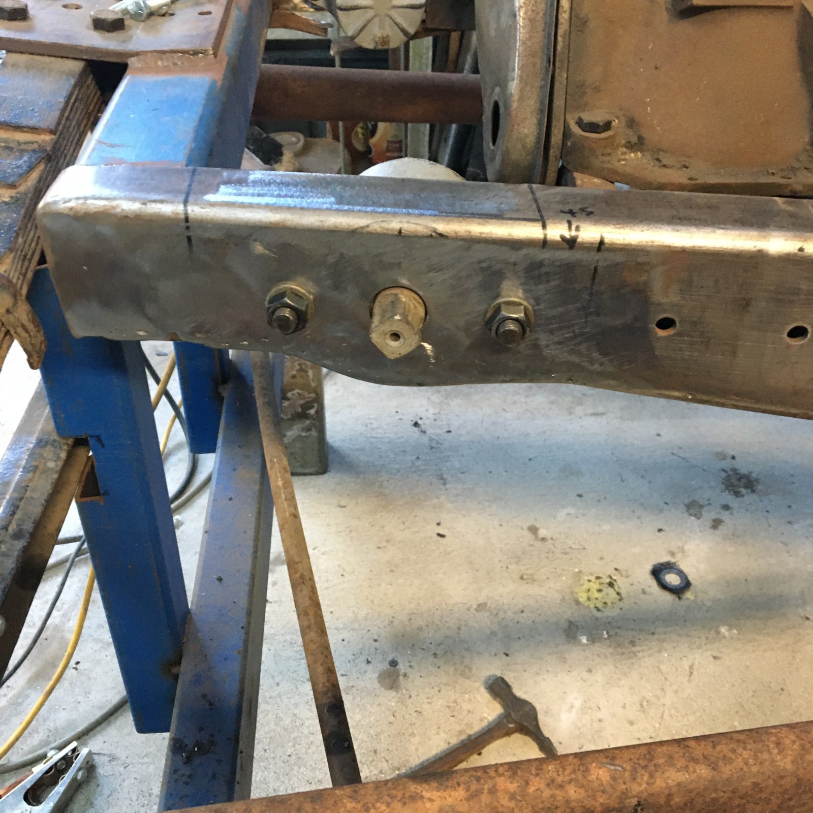

    Some more progress on the roadster ch***is, finished up the rear horns now need to do a little work at the front then I can flip it over and get to the hard to reach places.

    Very nice work on that cross member blending!!! I see that you have started your log intake. Too bad that we are not just up the road from each other, I think that I could have saved you some time on the LHD pedals and bell housing.
