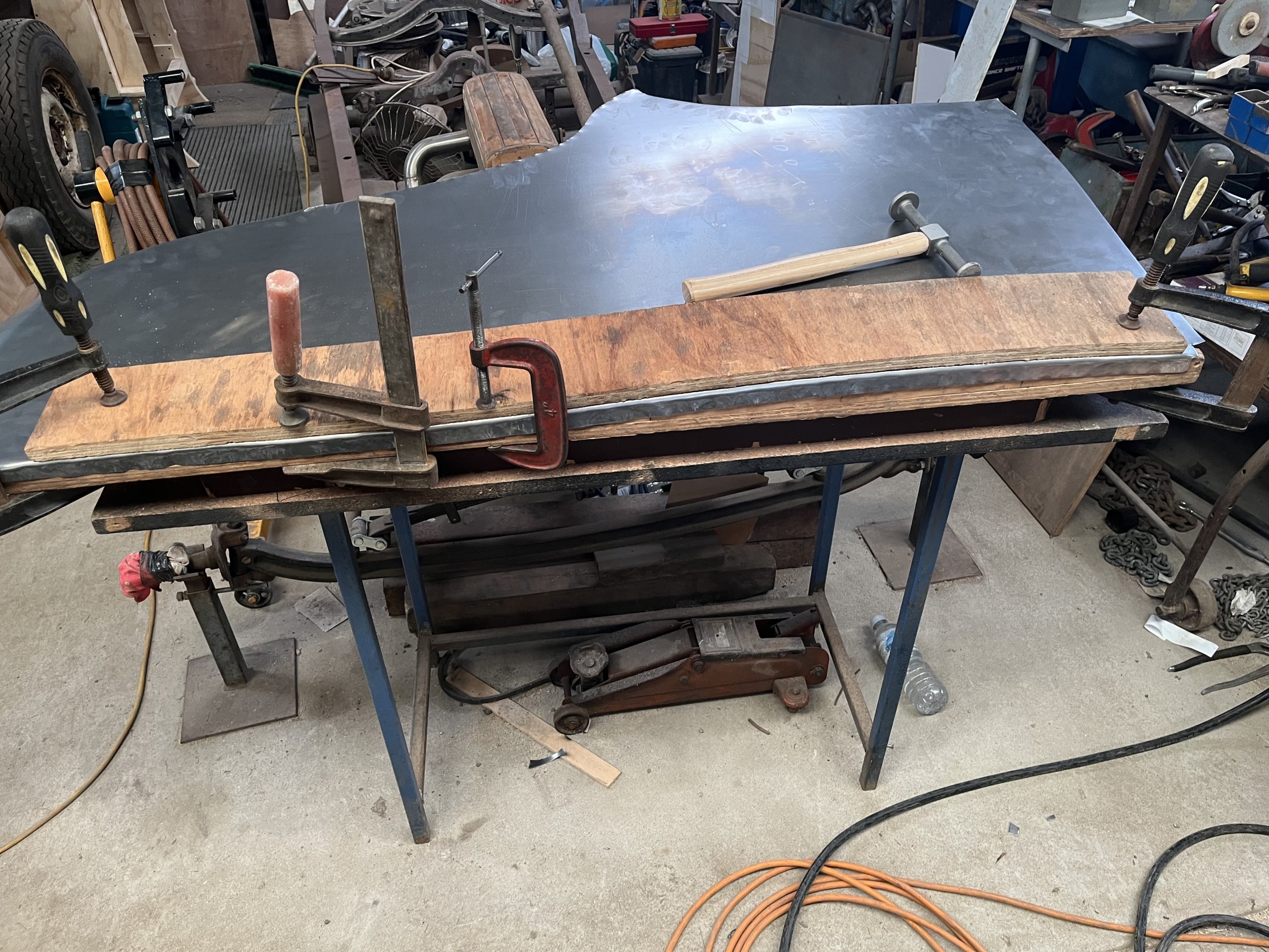

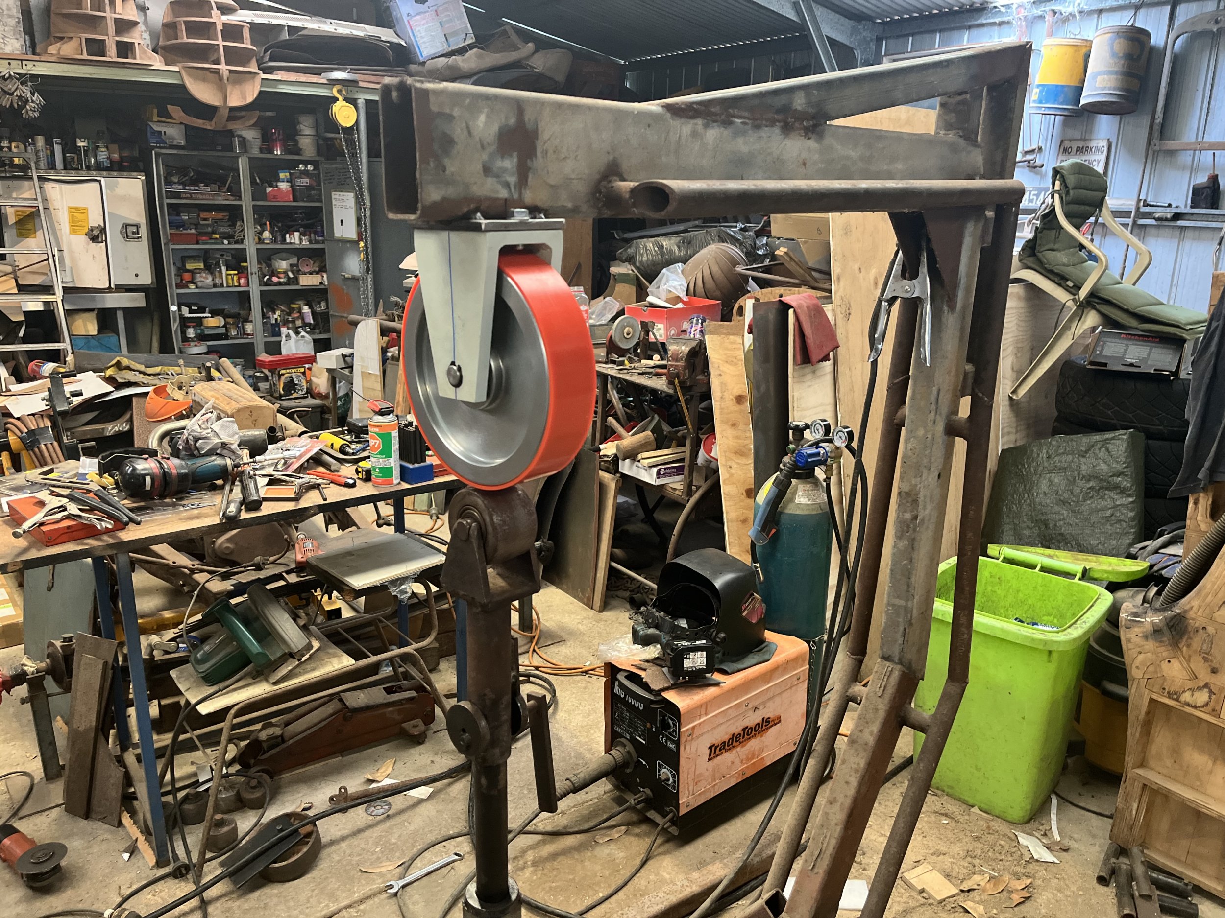

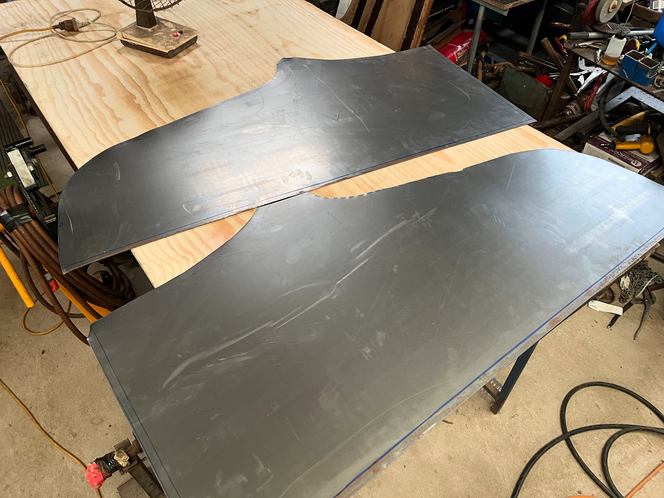

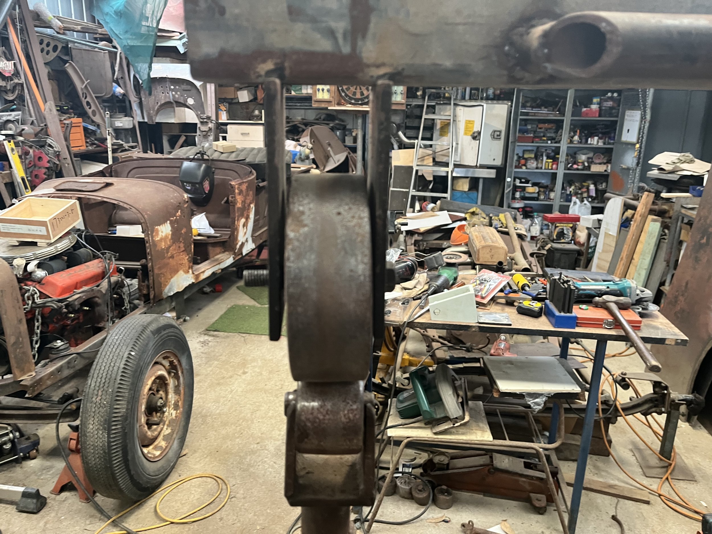

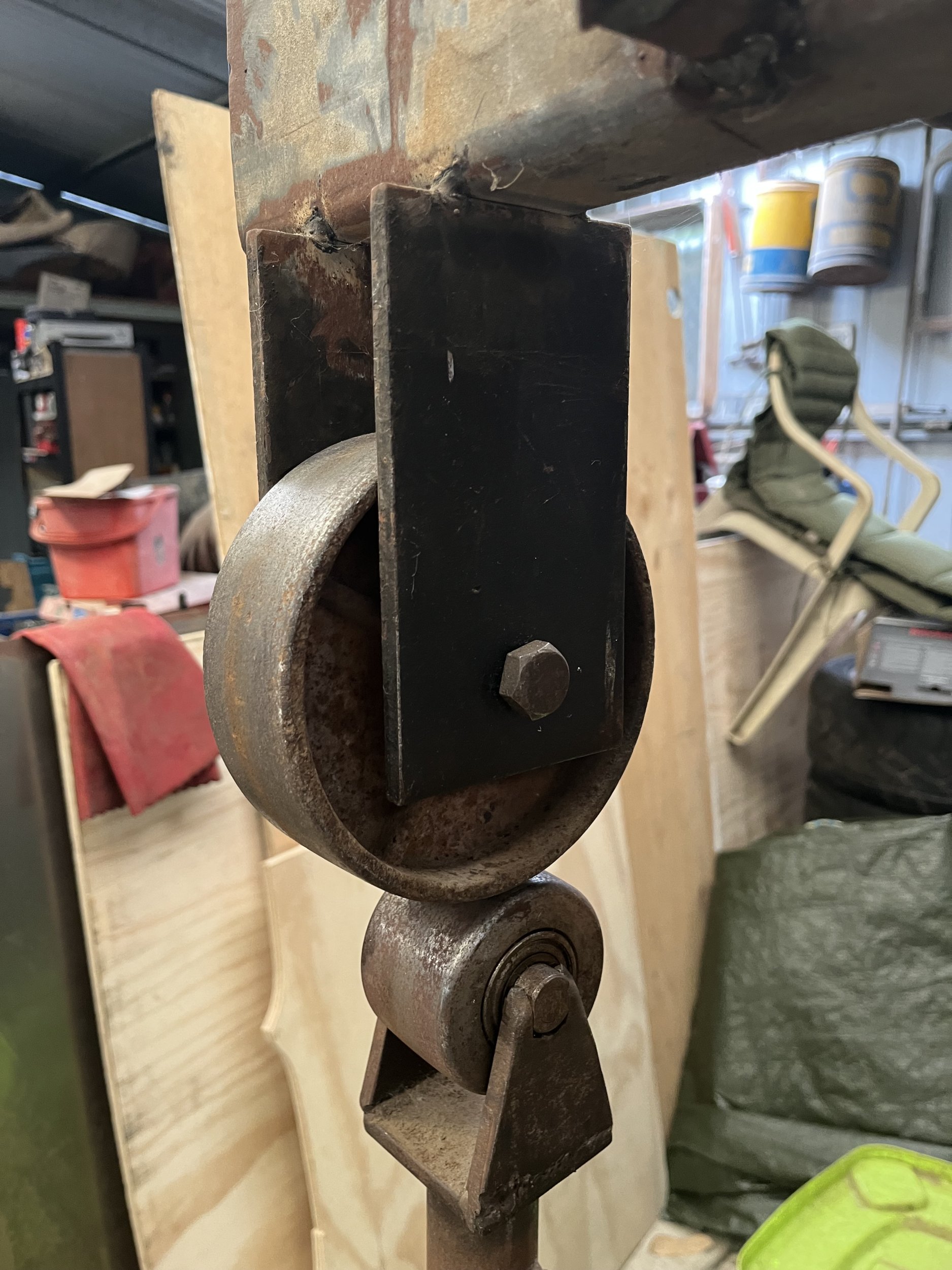

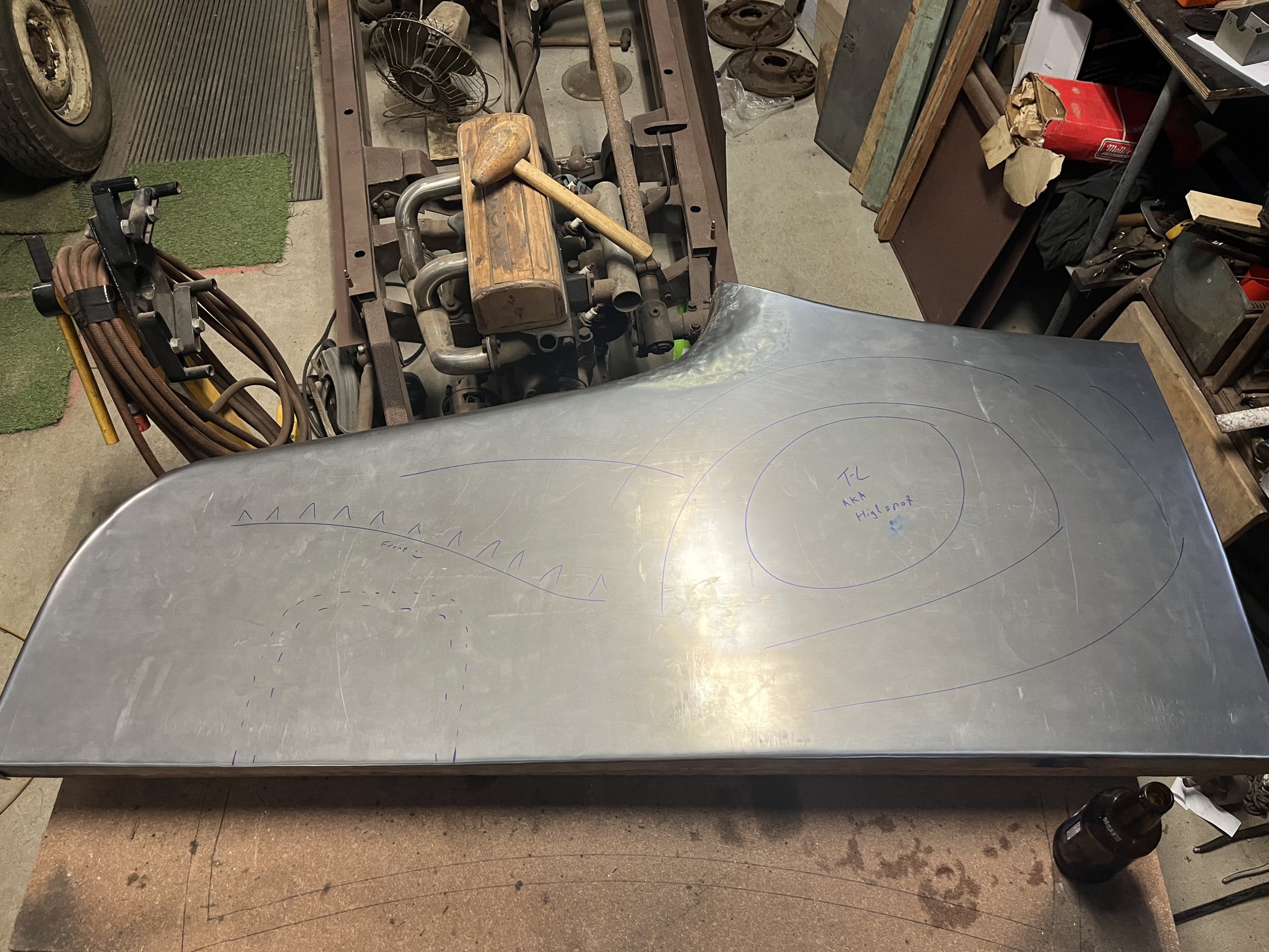

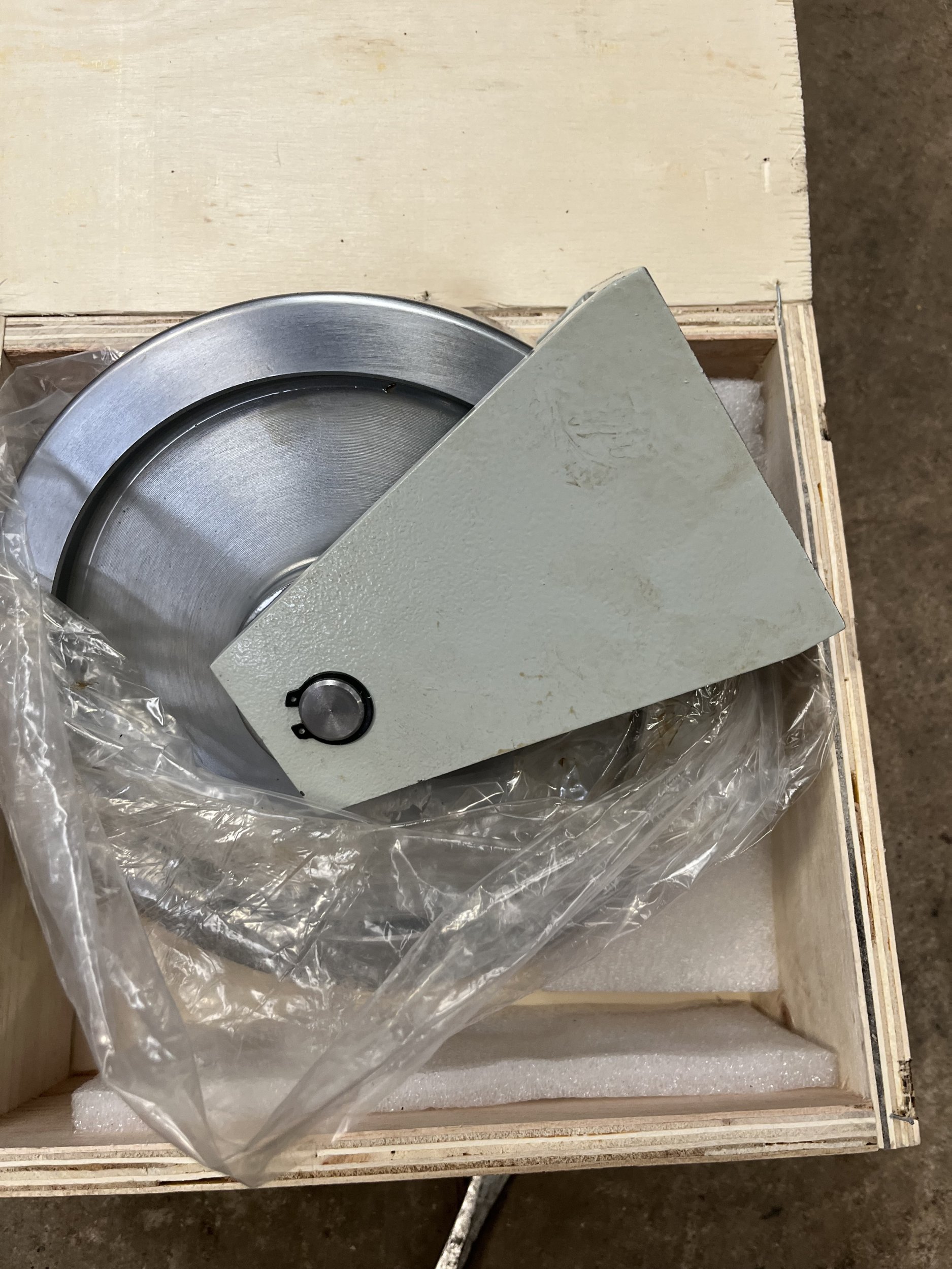

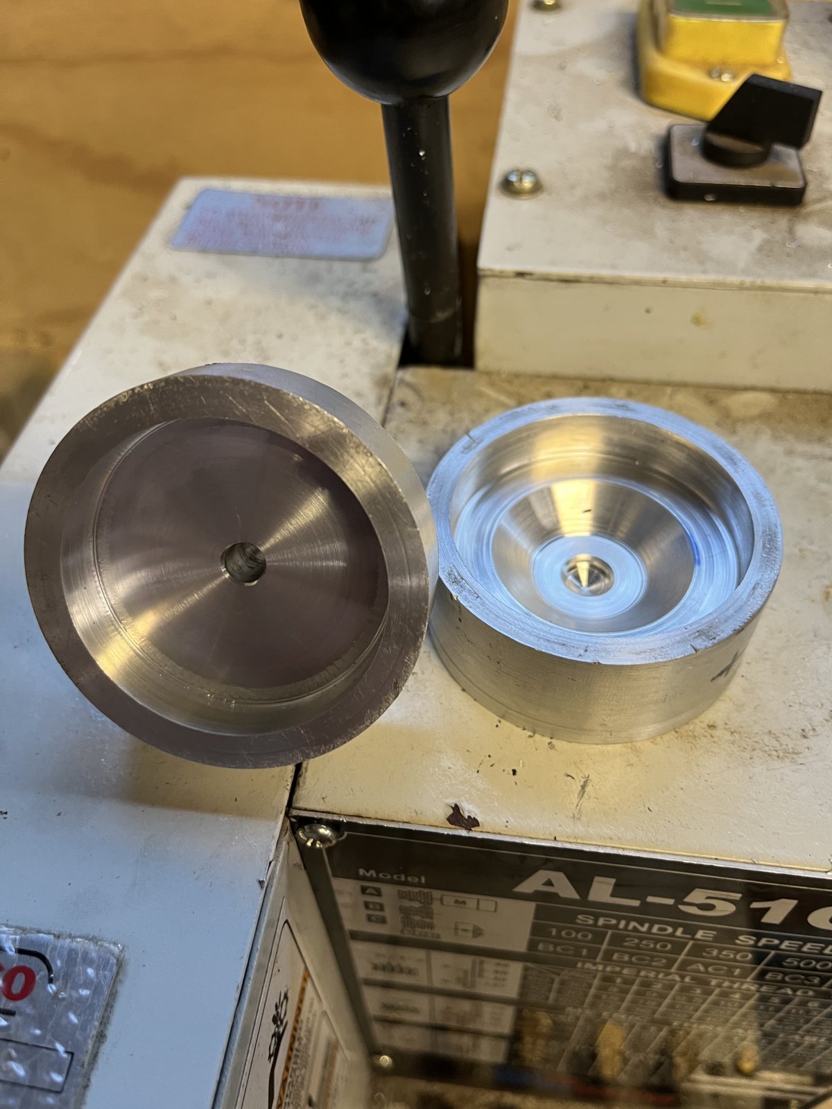

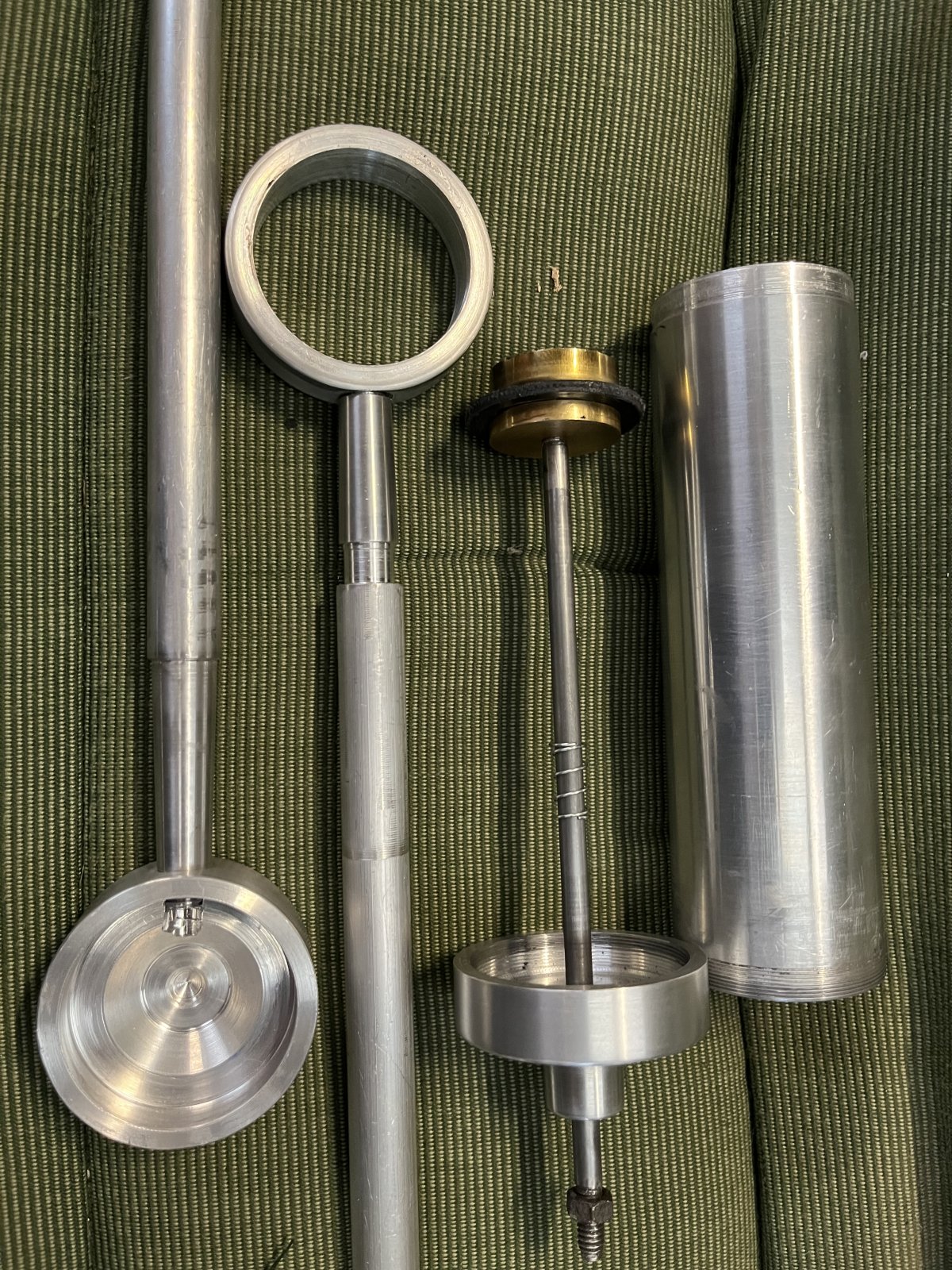

  17. My ****ty homemade English Wheel got an upgrade with a new top wheel.

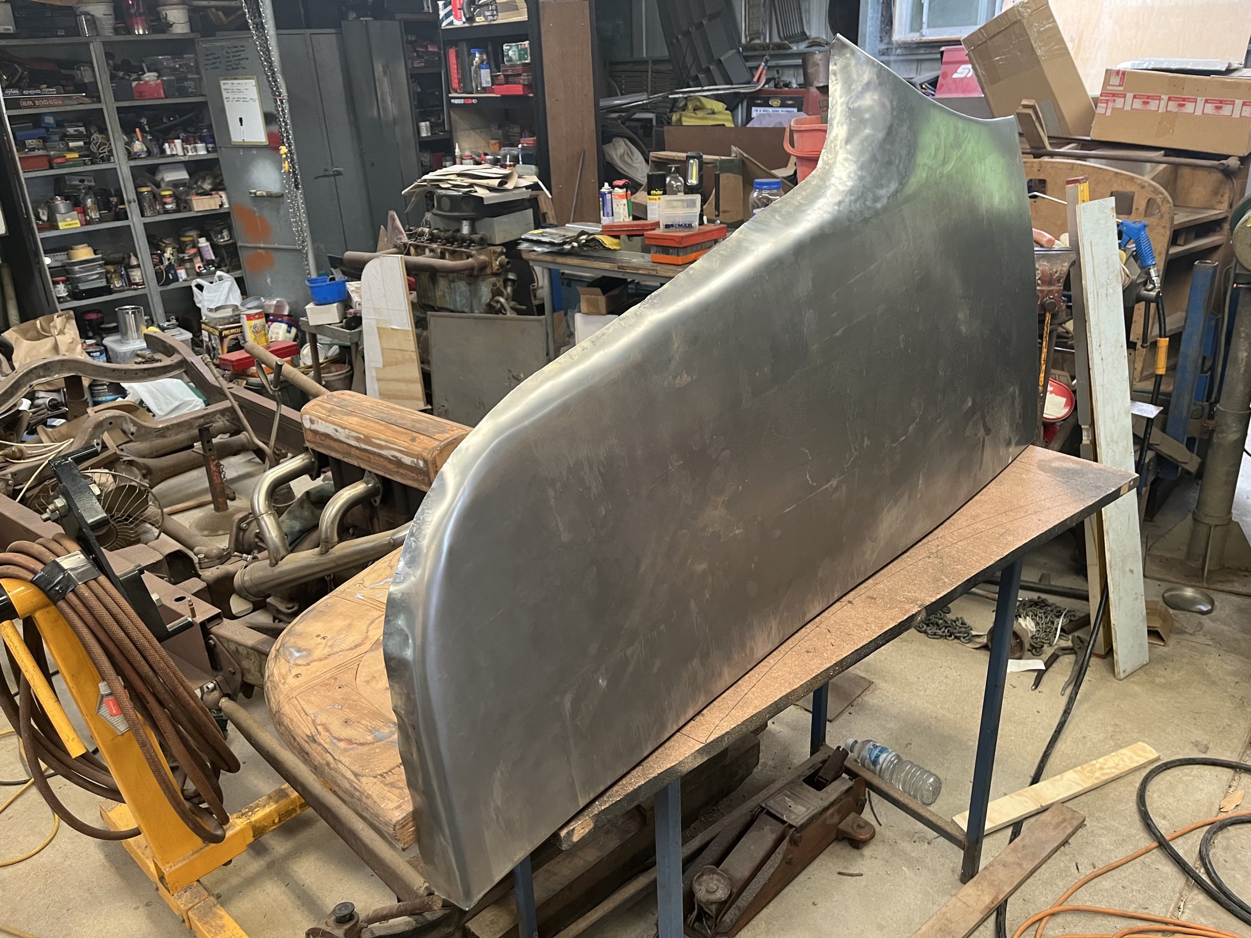

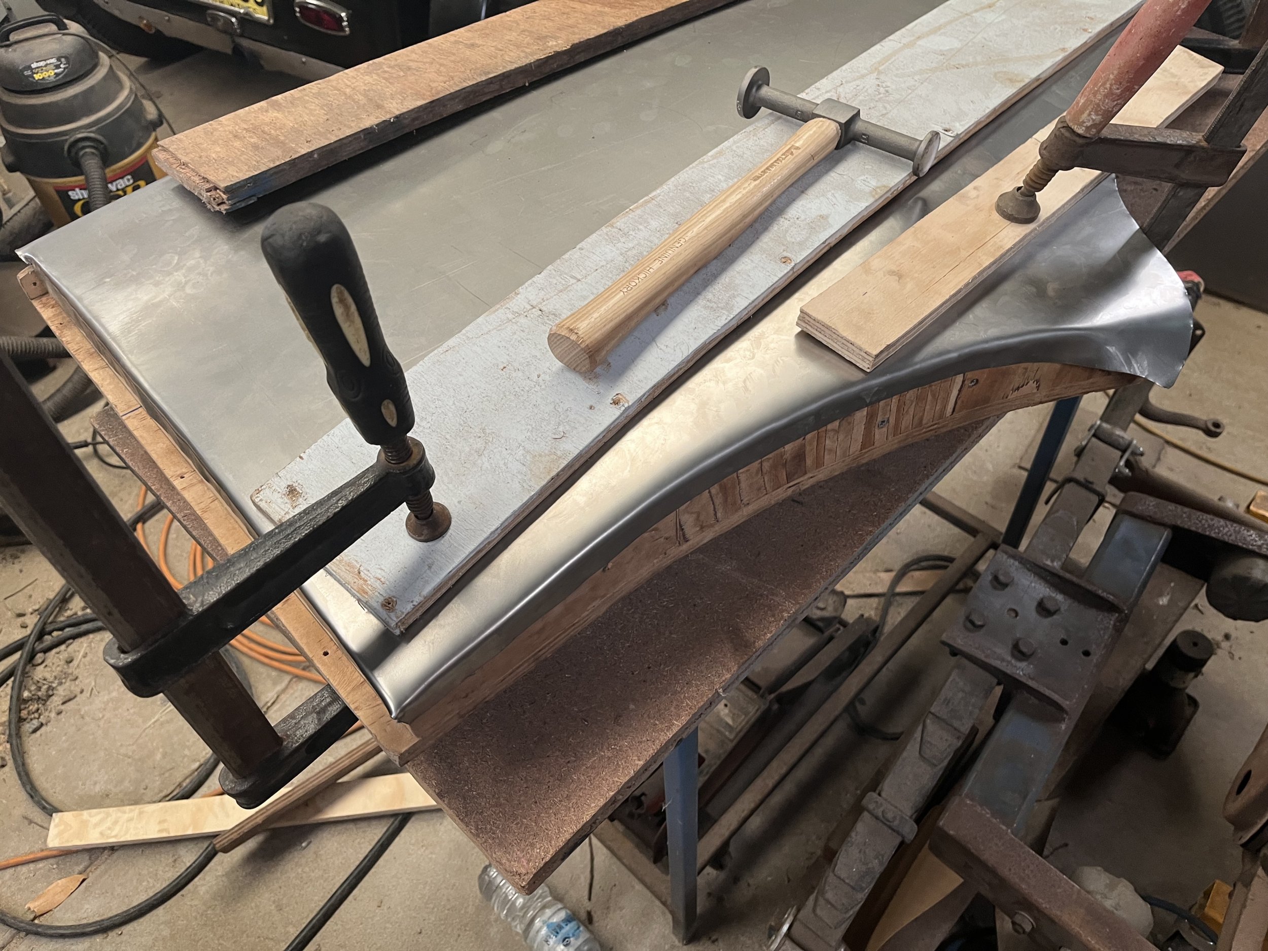

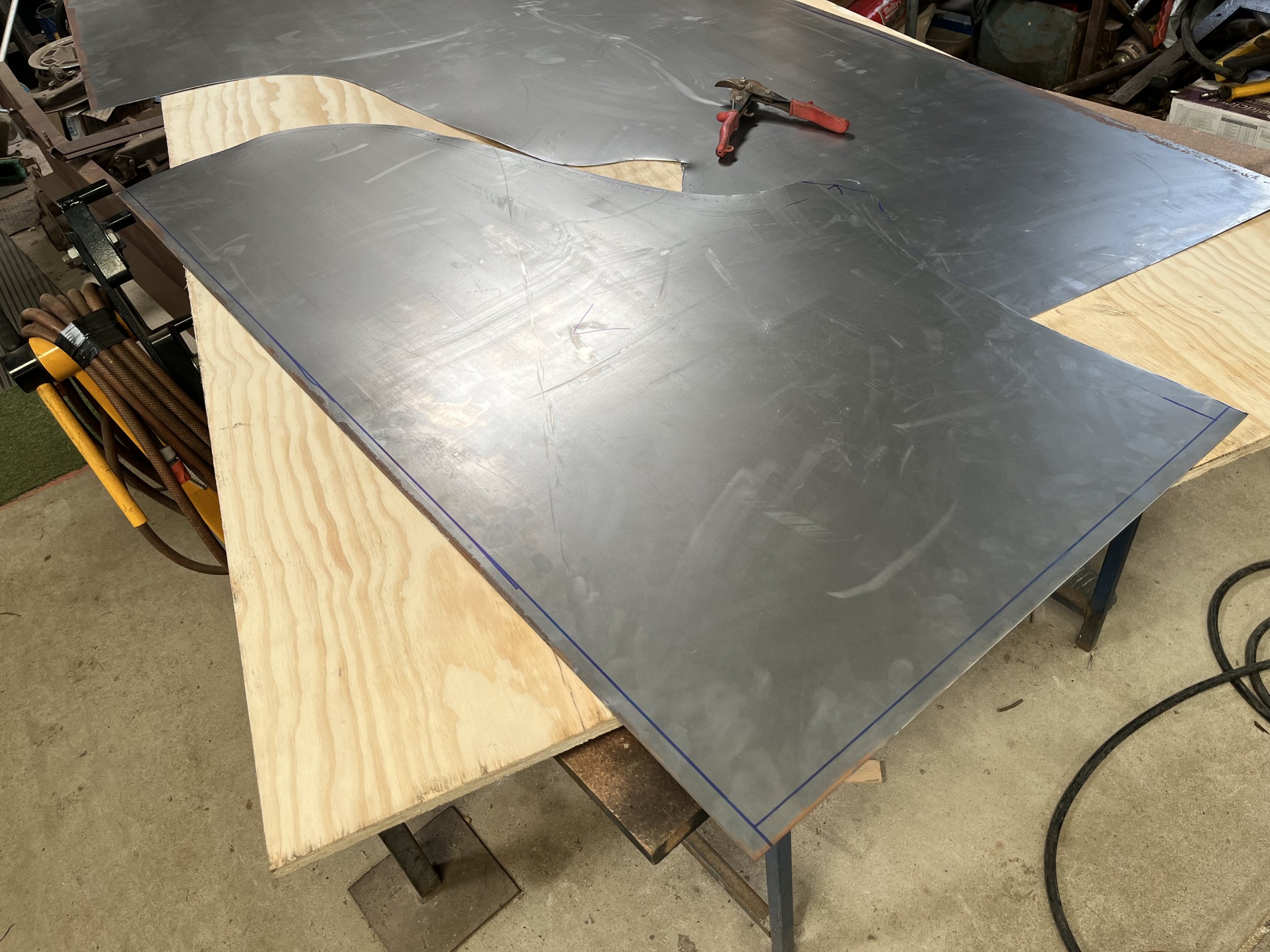

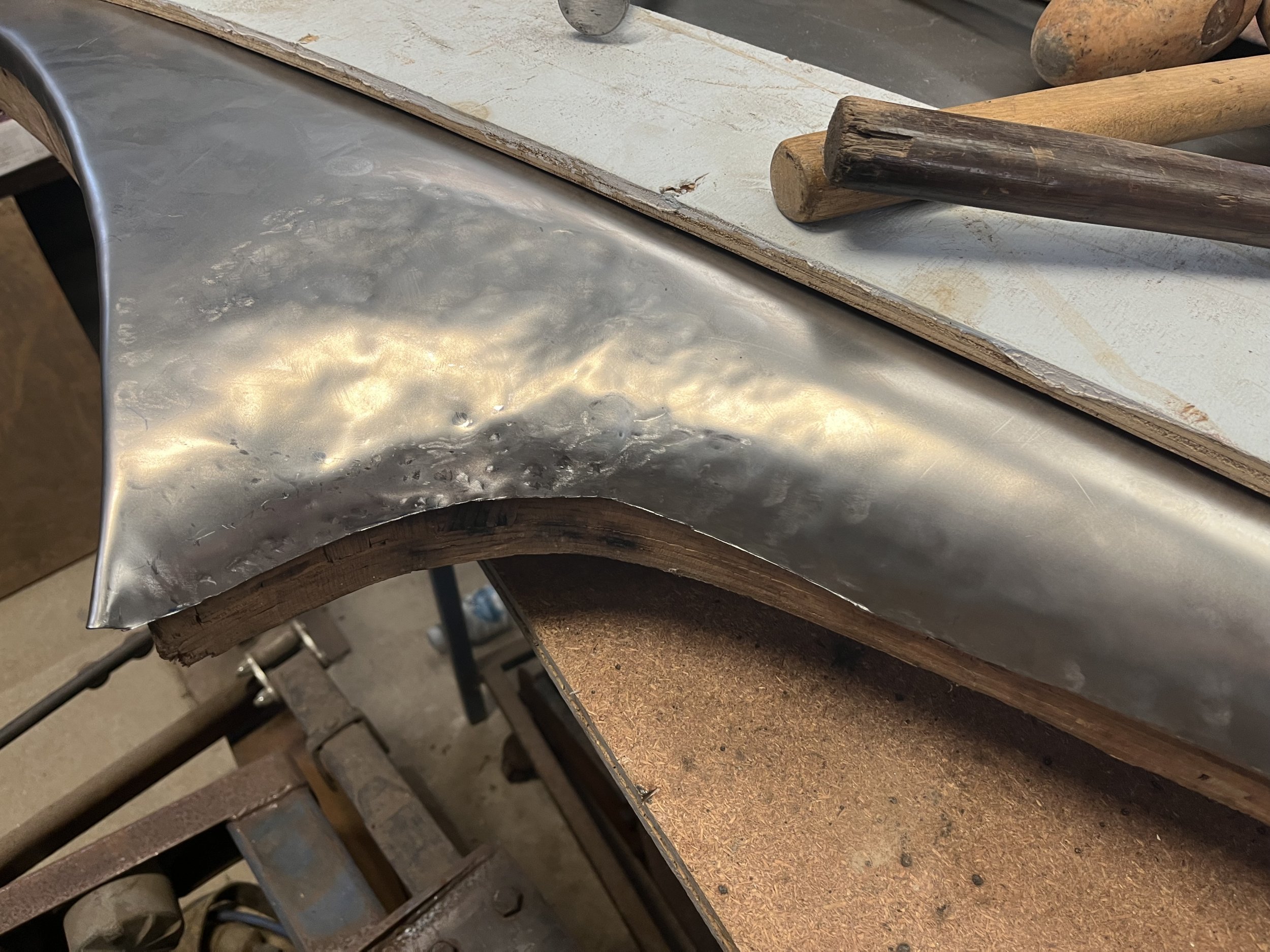

    Will get back to the quarter panel I got roughed in and get the other side started

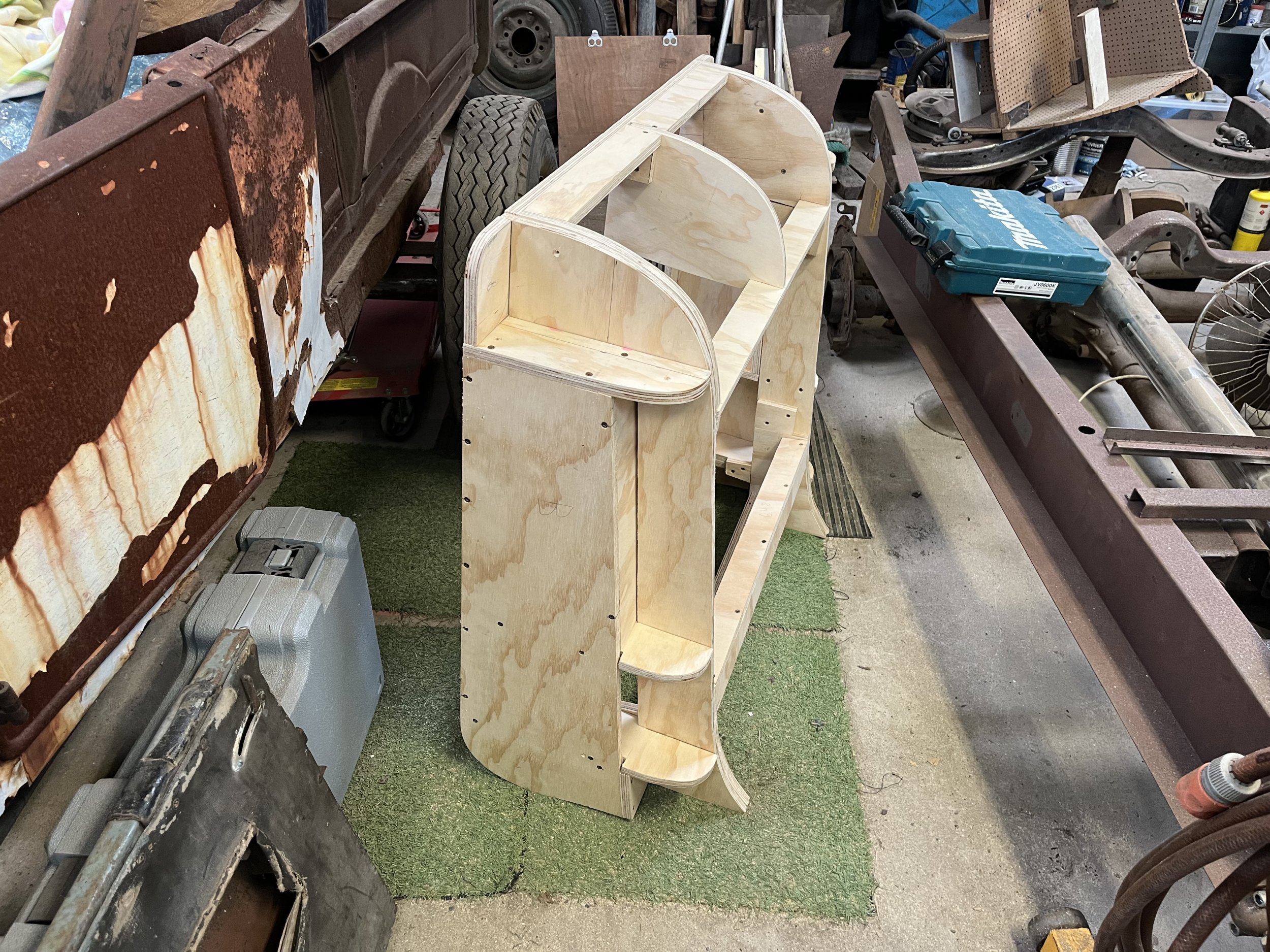

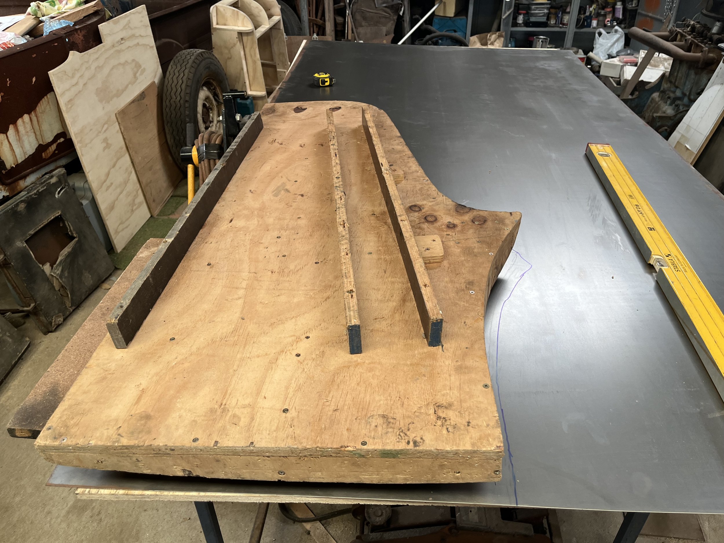

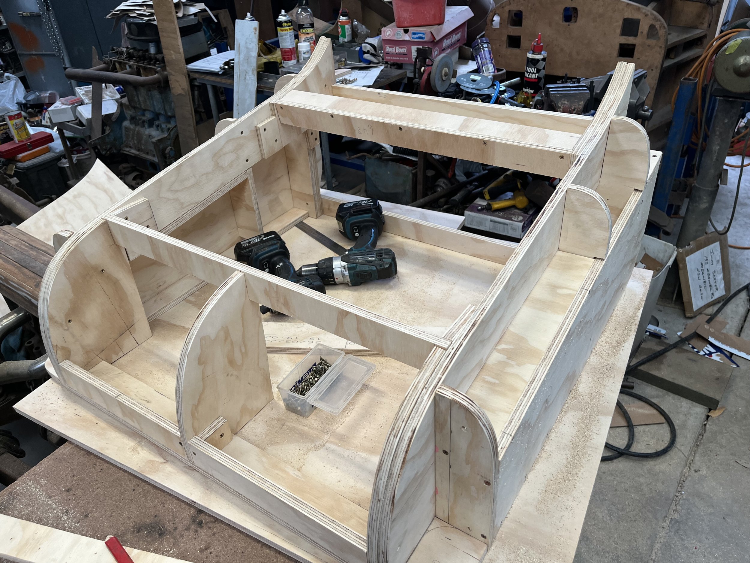

    Started this buck for a '25 T Turtledeck
    I purchased a good solid pair of '25/'26 Chev doors that I can take patterns off. These will go on a body that will have the original woodwork replicated.

    What kind of wood are you using for the buck? That little T deck looks bang on!
    Six Ball, duecesteve and Jimmy B like this.
  20. Cheers Glenn! Gotta do something and can't think of anything better to do then work on these ol' relics, This keeps me going!
    Cheers Tim! Took me a long time to move forward with this buck lots of procrastination from idea to start wanting to get it close, the wood used is "Structural Plywood" 15mm 5/8"-ish easy to cut and shape.

    I have the bulk of the original wood and have photos of missing pieces so will get to that when I have completed the steel structure on build 2. Build 3 is a quiet a while away but might at least build body, we'll see. Also I need to find a local source of Tasmanian Oak in right thickness and I need to fix my wood bandsaw, lots of projects not enough space! I need to make better use of time!

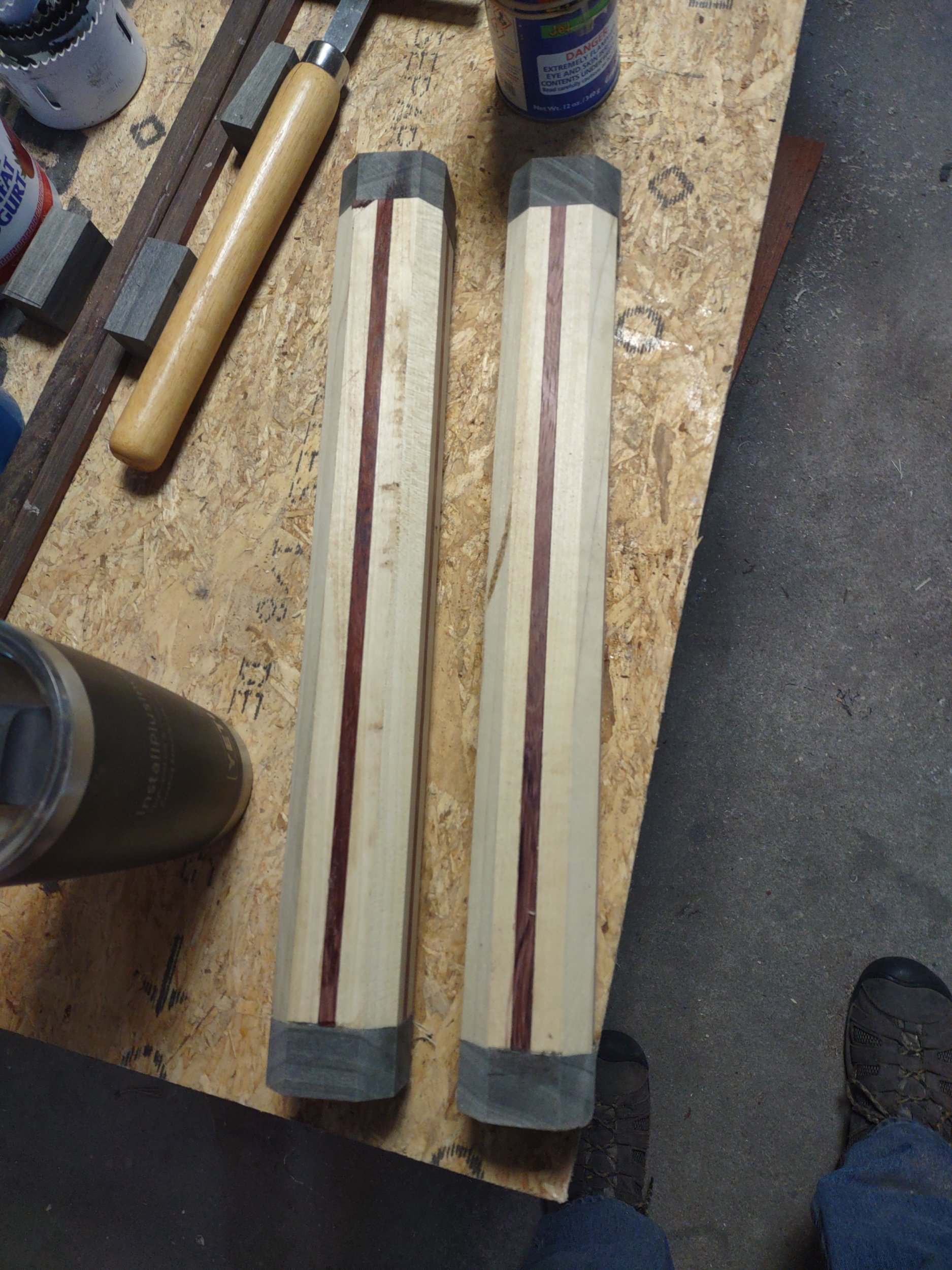

    We've started using this wood called Accoya it's a hard pine from New Zealand, it's light and strong really nice to work with , it's mainly for outside decking. It's treated with vinegar , and is guaranteed to last 50 years!! It comes in 5/4 thick and it's 5.75 wide. I've used the dark gray to make some rolling pins on my lathe . Fun stuff :) . I like how the later "T"s have more of a tub to sit in there is more protection around you. a061e9a0-77dd-48de-a9a1-d73f5a851aac.jpg
