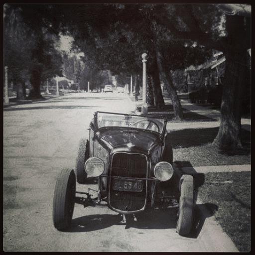

    My mate John the Hippy in the uk in 89

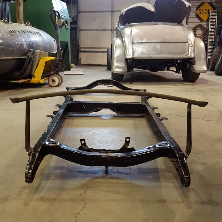

    @gwhite I've seen a couple of those pics and love the high headlights. If I were to run a V8, a 32 shell would be on my list. I've just started looking, again, for one for my coupe and, man... prices are crazy.
    Regarding the headlights and the bar. I'll be running a pair of Guide 903Js, if I remember correctly.

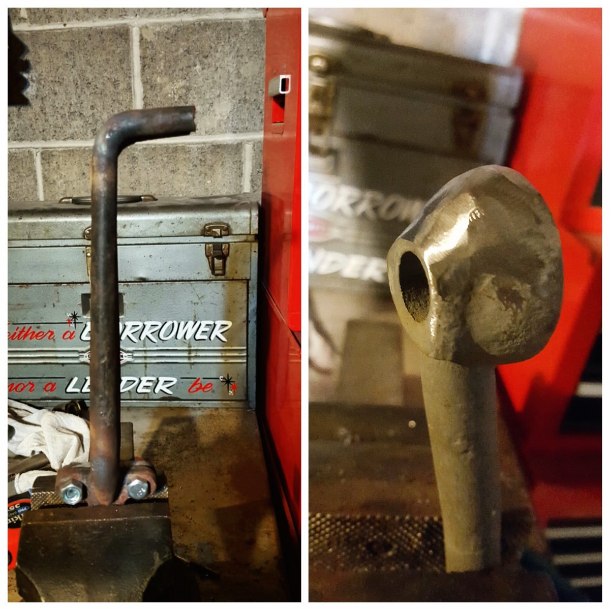

    I had been fabbing a bunch of stuff because I had a small crack in my crossmember at the corner of the square spring bolt hole. Since @Salt Flats Speed Shop and I had a small trade deal going on I got a few things together to be welded. Now that the frame is ready, I'll get it to a roller.
    Anyway, the headlight bar. I'm all about the tall headlights. I know that in lots of places (especially So. Cal., where so many of these inspirational pics come from) had headlight laws, which kept them high. I've asked some old timers and the memories conflicted about Salt Lake. It didn't much matter, to me, as I wanted them high anyway.
    I dug through some junk on the shelf and came up with two different fender brackets. I put the word out on Instagram and to a couple other buddies and @BCCHOPIT came through with a match to one.
    I trimmed them high, not knowing what it'd look like on the frame.
    Set them up in the vise... (sorry for the pic, the HAMB wants to landscape them).
    First round of heat and straightening.
    First mock-up. I tossed a bar with lights on them and it was too high - way too high. Also, the uprights needed to be more vertical. My neighbor probably thinks I'm a weirdo with some of the stuff I bring out of the shop, into the yard. I just needed more space to get perspective.
    From the side.
    Back at the bench for more heat, cutting, and grinding.
    The next day, at Salt Flats' place.
    It turned out to be one of my favorite items, so far.
    Truthfully, I just heated, bent, and cut until it looked good, to me. And, I'm really happy with them. When it comes time to mount it, for good, I'll grind off the markings on the bolt heads. When I have a better shape/detail pic, I'll post it up. But since the topic came up, I figured I'd post.

    YES! Such nice work...these details look odd to our modern (street-rodderized) eyes, but they are spot-on historically.
    I did some research on CA headlight laws and found this reference to the California Vehicle Administration law (section 100, chapter 876, effective Aug 4, 1943); "Two headlamps, no more and no less, mounted on opposite sides of the front of the vehicle, and, except as to vehicles registered prior to January 1, 1930, they must be mounted directly above or in advance of the front axle of said vehicle. Said headlamps shall be located at a height measured from the center of the headlamps of not more than 54 inches nor less than 28 inches above the level surface upon which said vehicle stands."
    With my ch***is mocked up at approximate ride-height, that's about 12" above the top of the frame rail. I'd say you're definitely on the right track!

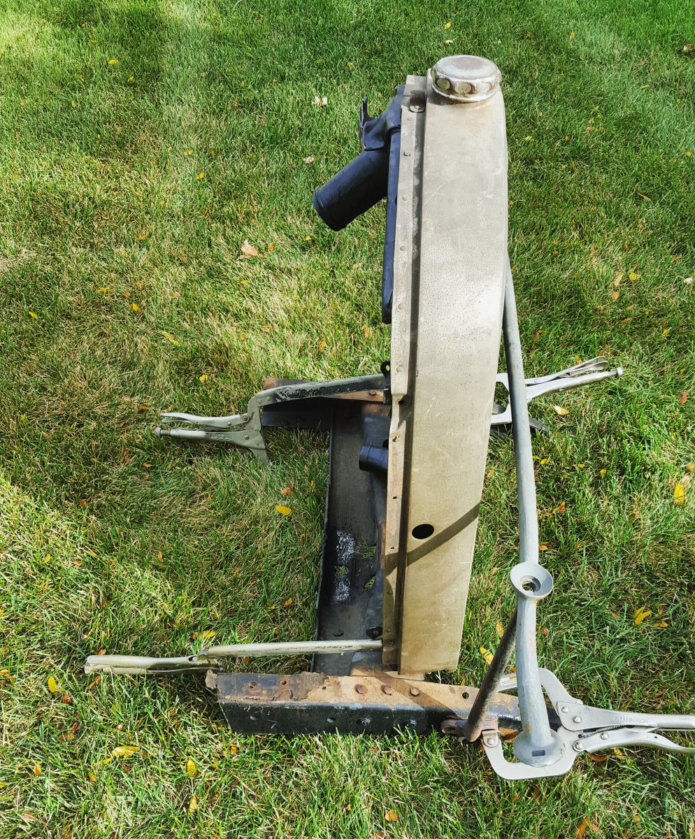

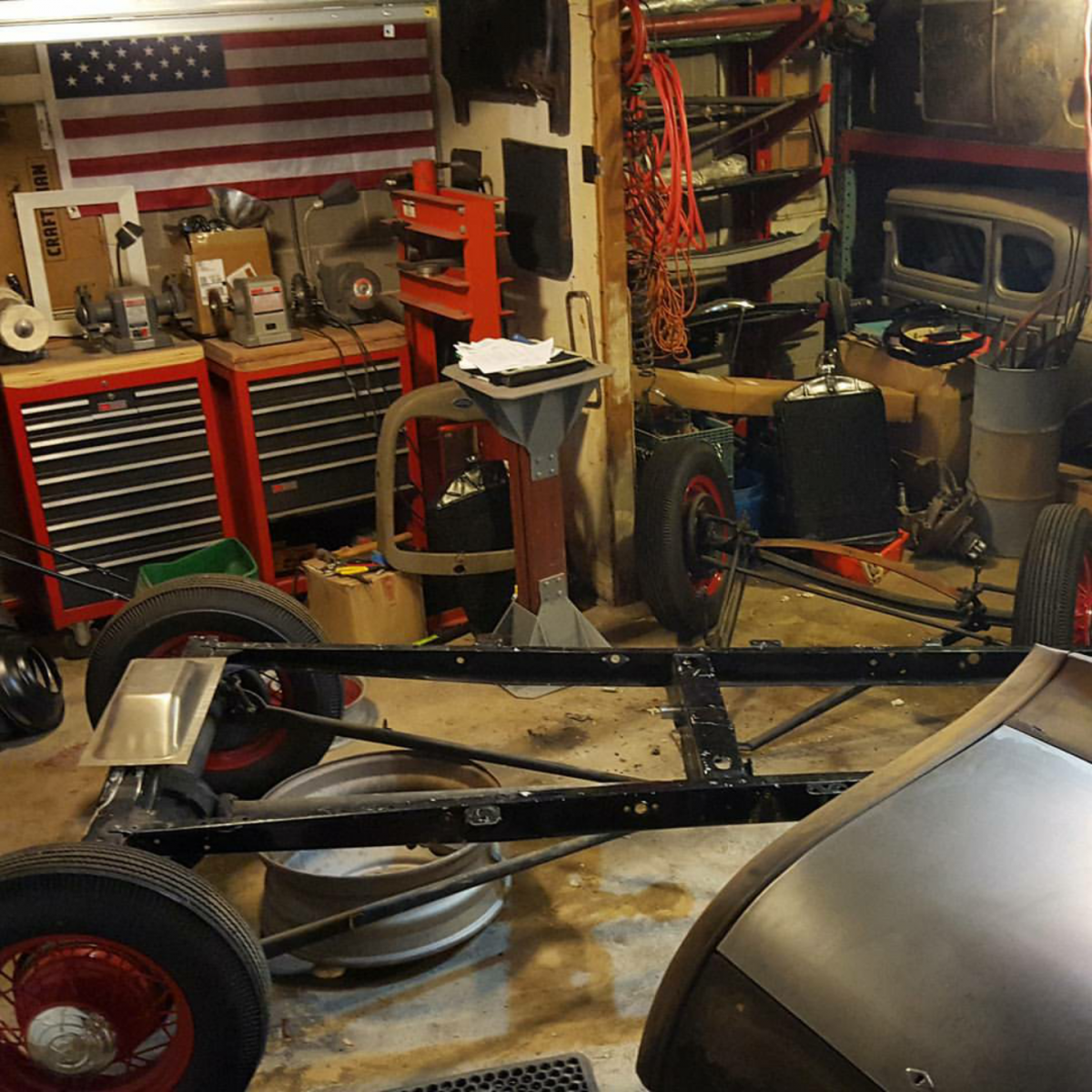

    Spent a few hours in the garage, Sunday, as the kids (and their sugar rush) hung out with their grandparents. Most of the time was spent cleaning and organizing. Usually, I don't mind doing it but having everything I need right in front of me (or in the case of the garage - exploded all over everywhere) I really just wanted to get something done.
    So, before I headed back into the house I figured I'd get at least one little thing knocked off the list. It's nothing major but needed to be done. The square hole in the front cross-member had a crack and was no longer flat. The crack was addressed last week but the bend needed to be heated and hammered flat.
    I also stole the gasket out of the Stant cap that came with the filler neck and it was a perfect fit in the A cap that I used. Now it closes snug and seals.
    Earlier, I picked up a new battery tray tin from one of the suppliers. Chris had welded it, last week but I forgot to post up pics. I want to do***ent the build as best as I can for later reference.
    Here's the embarr***ing IG pic I posted of the mess, two hours into cleaning.
    I'm committing myself to get more cleaned up and orderly before I dig into the front end. I'll be swapping the A axle for a 32 "heavy" to get a little drop. I reversed an A main leaf a while back and have been contemplating throwing that in there, as well. I'm back and forth on that, though.
