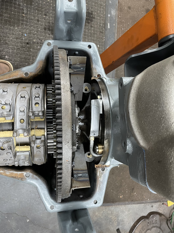

    For future reference, top view of the transmission hanging on the end of the crank with the oil pan underneath and the bands wrapped around the drums. You can see the paddles on the back of the flywheel where the magneto magnets would normally go. And down in the cavity you can see the two funnel mouths of the oil tubes that move the oil to the front of the pan.
