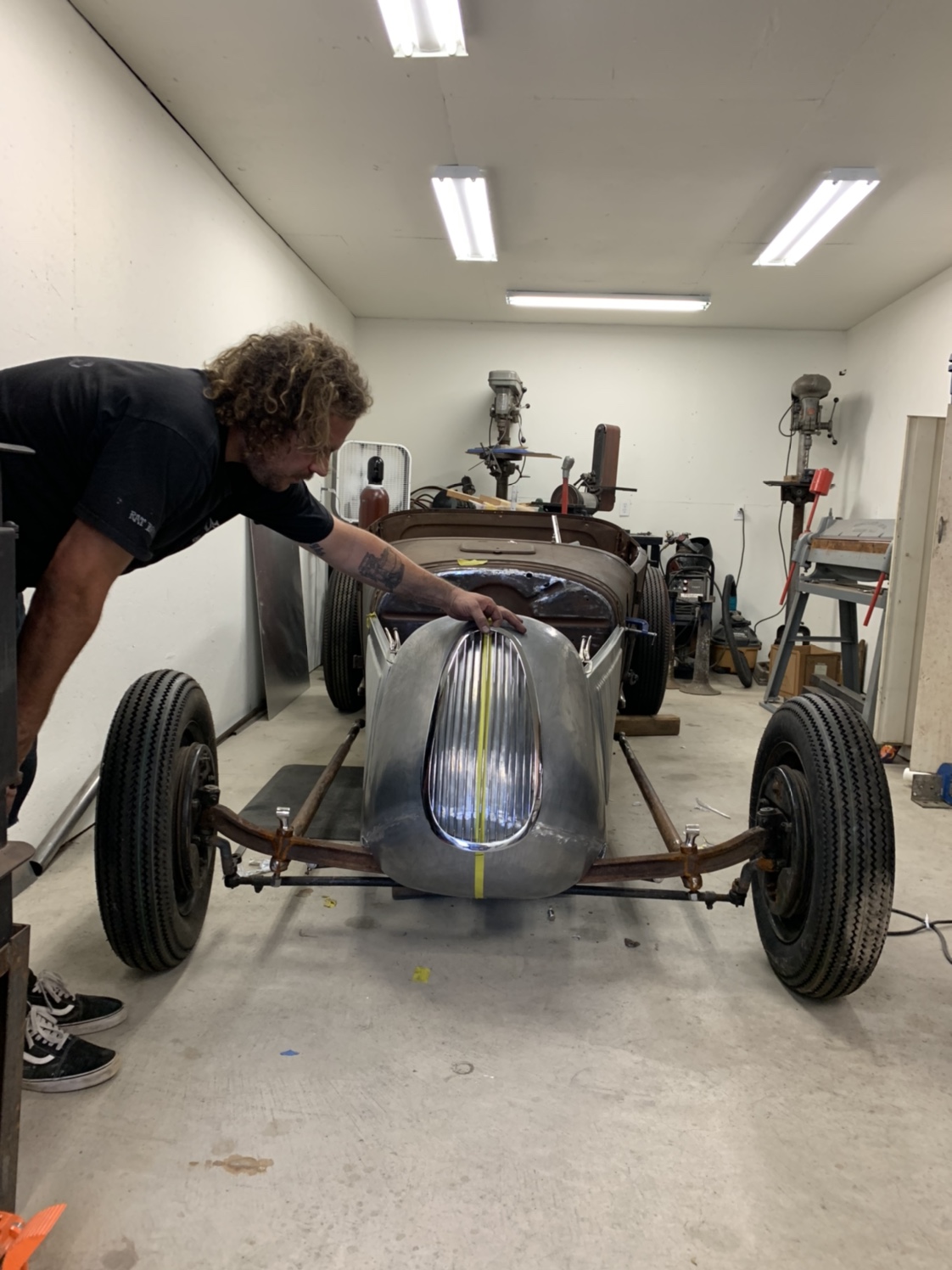

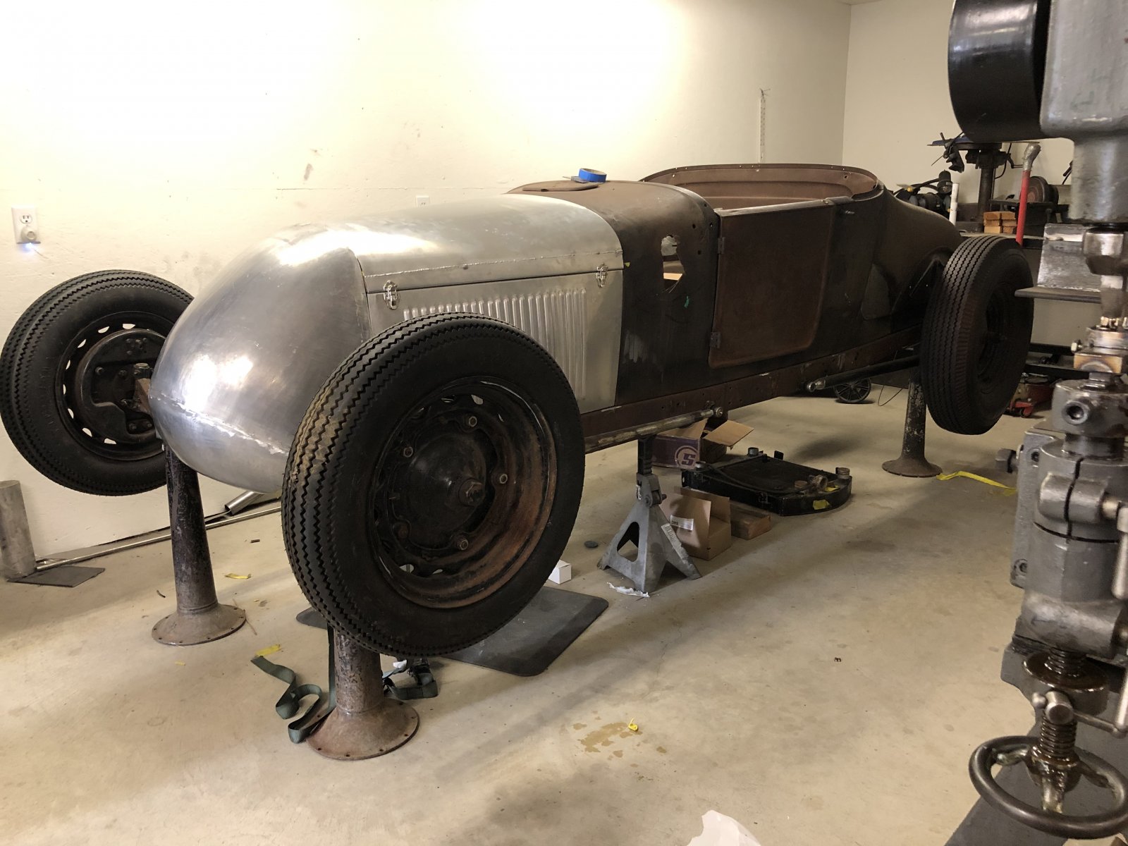

  12. flyin flattie
    Joined: Oct 13, 2005
    Posts: 602
    flyin flattie
    from Redmond OR

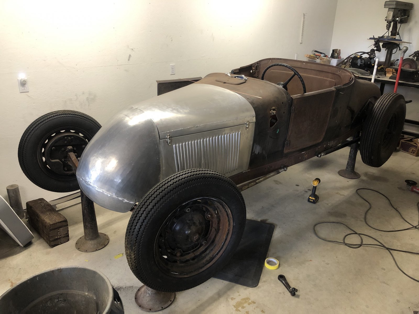

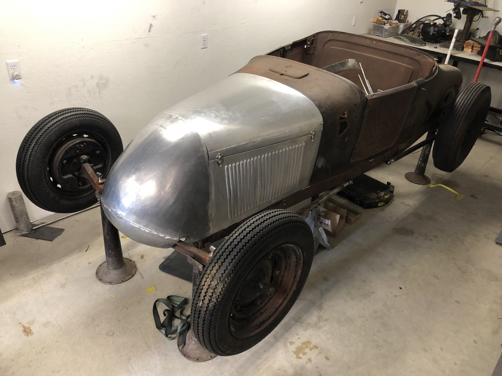

    Basic story is a good customer friend Tom dropped off this early 2000 rat Rod with body mounts for a crossly 4 banger which was gone. The ch***is was mig welded suicidal madness so I decided to start fresh with new A rails.
    I split em fit em and in the process flipped the rails backwards because the rails have a much better taper in the rear. Then I found a bad *** GM fire wall ( cowl said body by fisher). The front crossmember is as flat as a 2x4. 2” tube supports connect the trans crossmember to the kick up in the rear.
    I rearranged the front end by welding a bung to hold the spring behind the axle, in the
    To dep the rear I used 2x3 x 3/16 square tube and tapered it to now fit the new back of the rails, then jogged it in and up and put the A crossmember as Low as it will go ( I need to C notch it all now including the sub rails)
    The motor is a late 36 insert bearing polished to the hilt bottom end! So it seems to be solid so we decided to go with a T 5 for pickup and go! The only kicker is the offer adapter needed a C ground where the starte is [emoji85]but it’s good.

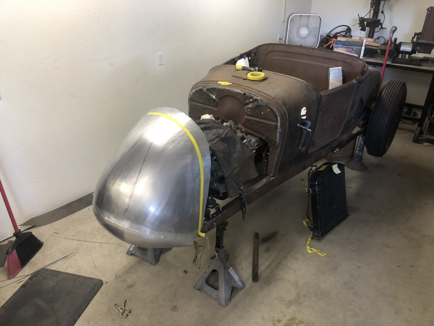

    The nose is a story. I wanted to make this thing but was apprehensive for good reason. I finally grew some and made dellren shrinking dies for my vibro shear and went to town ( make sure the thumb is only .1/4” tall! Max because I didn’t first go around and we’ll it wasn’t compressing the metal as you pulled it back out there in it wasn’t shrinking very well. Long story short I fixed the die and there ya go. Also made the back hem and welded it in. The hood sides I ran full beads ( model A size) and that’s where I’m at so far. Oh and the grille is a xk 120 flipped on its head!

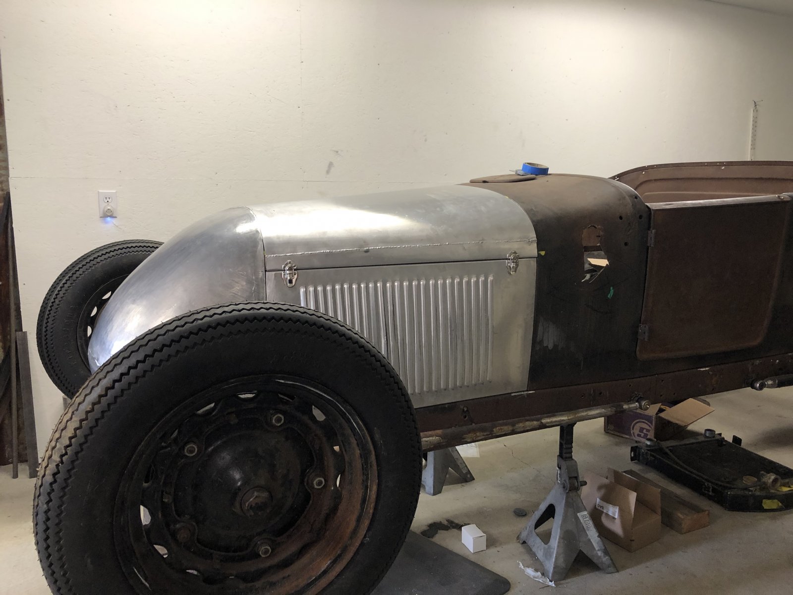

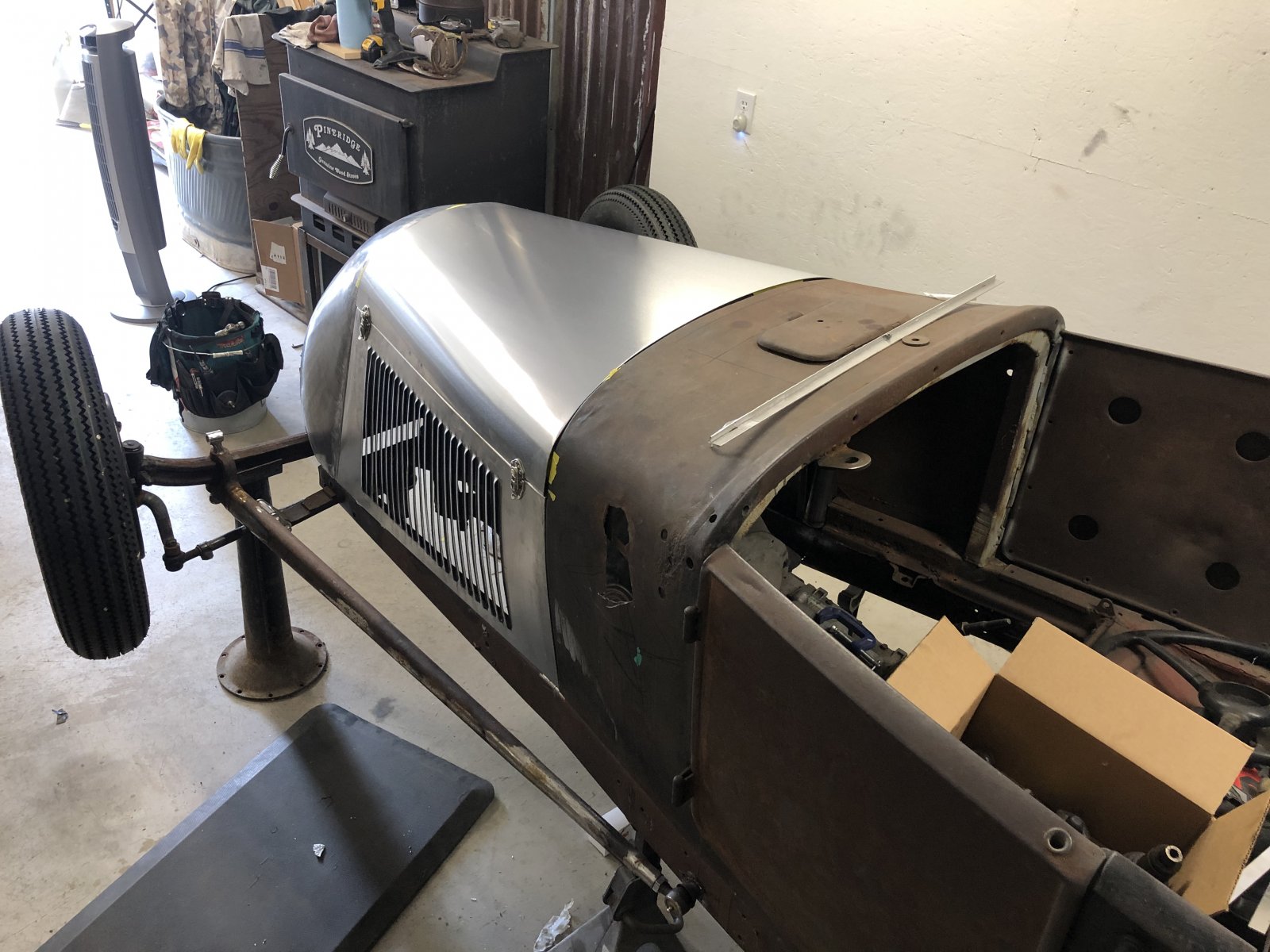

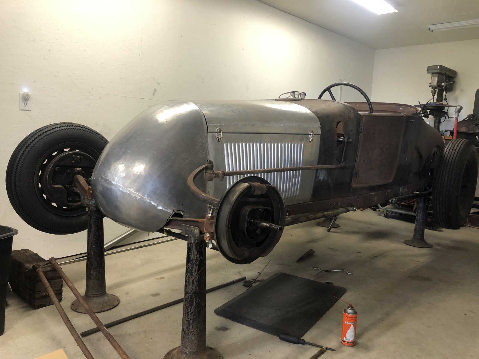

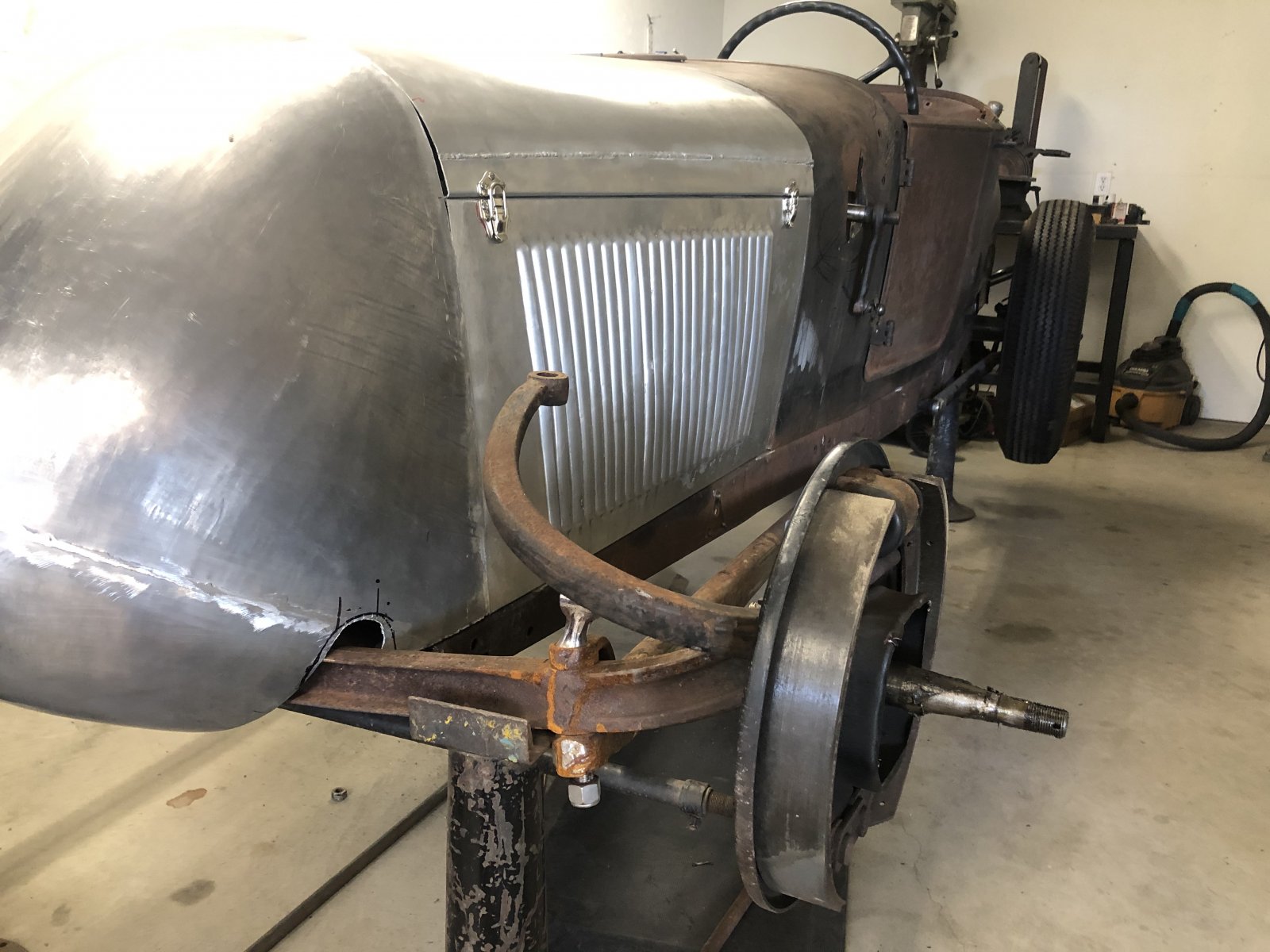

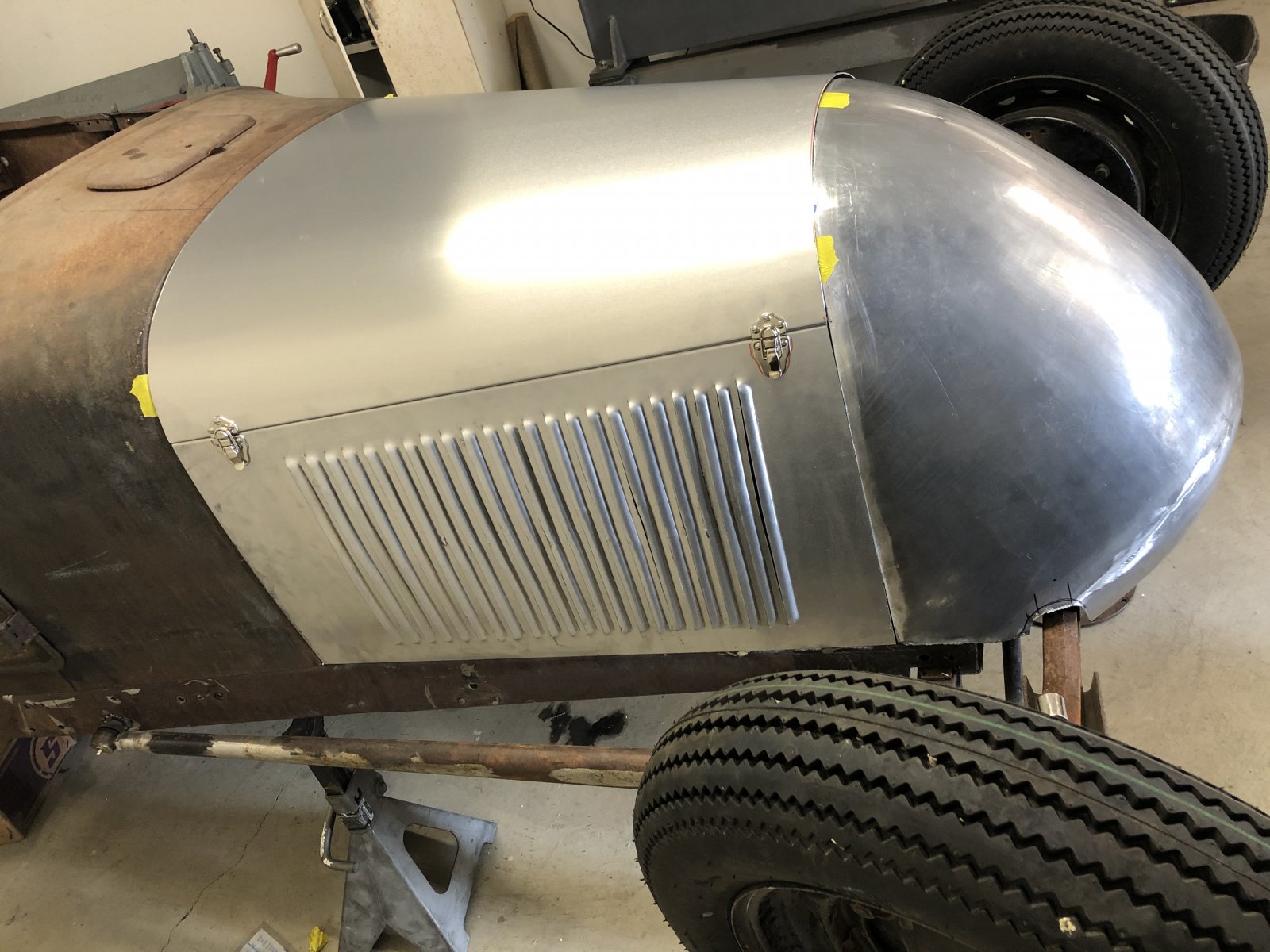

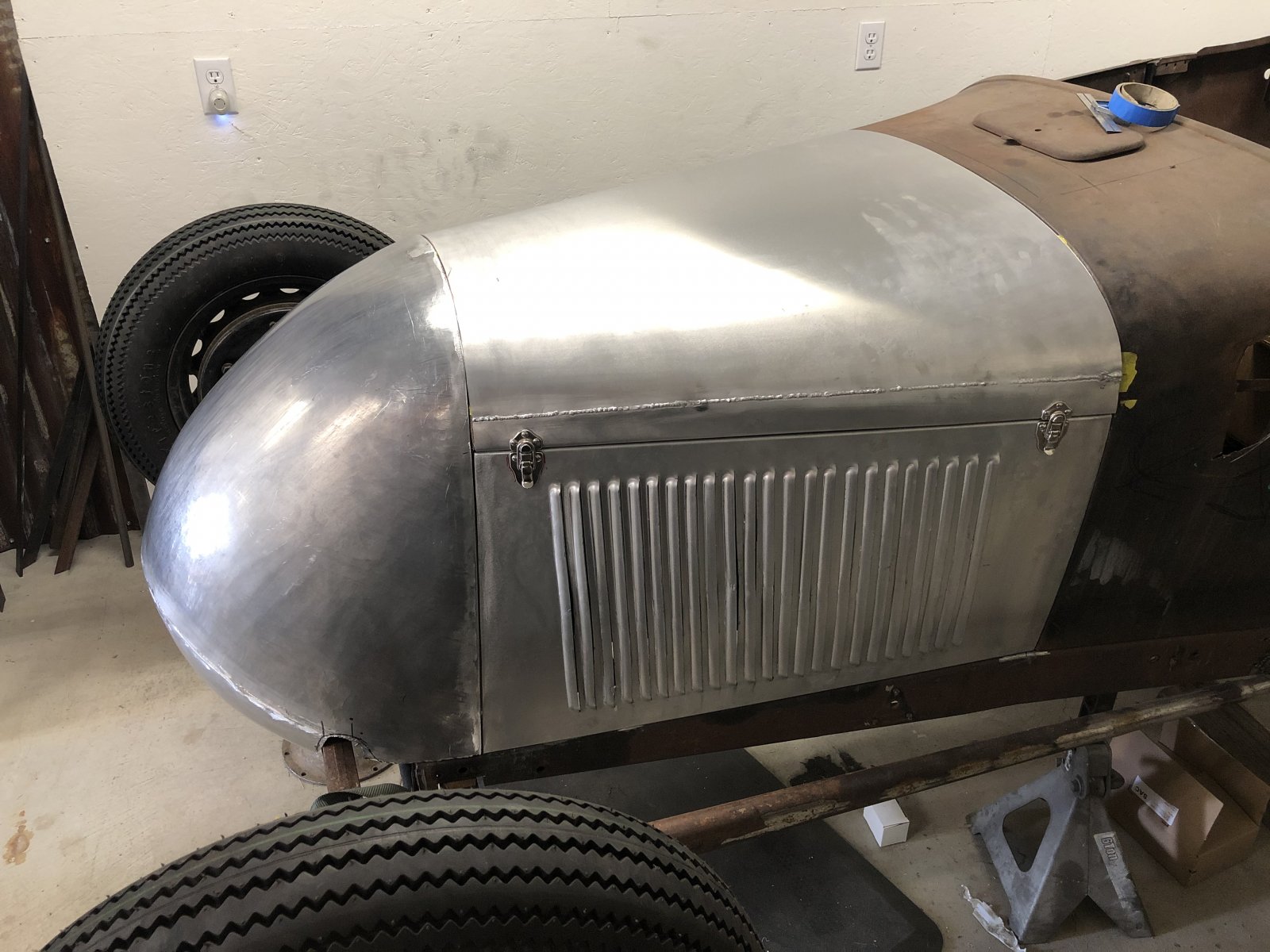

    Little update on the hood
    vtx1800, alanp561, GordonC and 16 others like this.
  27. Tim
    Joined: Mar 2, 2001
    Posts: 21,580
    Tim
    from KCMO
    Look killer! The hood top really ties it together.
    with out the top I kept getting distracted by the shape of the hood sides. I think they must have kind of a twist to joint the cowl and track nose shape? Maybe it’s just the louvers messing with my eyes. Either way with the hood top on I love it all.
  28. flyin flattie
    Posts: 602
    flyin flattie
    from Redmond OR
    Hey thank you! Yeah the hood sides do have a twist in them. I made them flat to begin with then shrunk the back top edge and it kinda just found it’s way to twisting into shape. Matt Seret thought me about doing this type of stuff and his great words of wisdom were to do one thing at a time. Not to ***ume what worked on one side will just simply work on the other.

    Well it looks fantastic man. Louvers look spot on it’s really going be be a car to sit and study when finished. Thanks again for sharing!

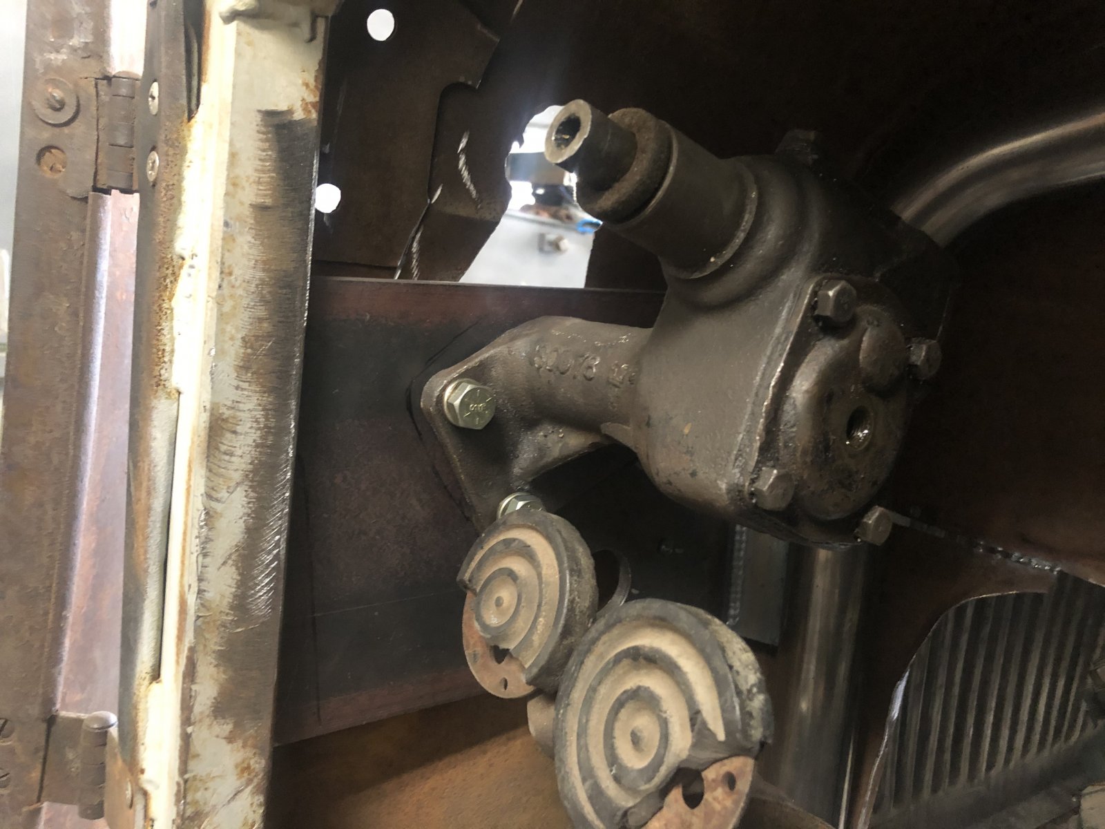

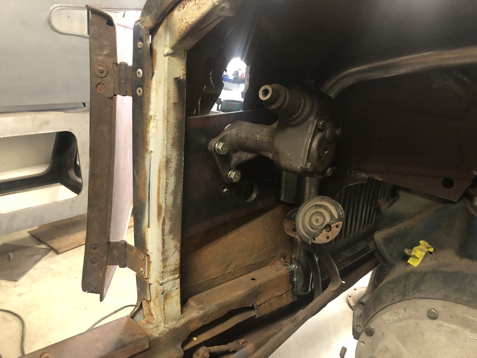

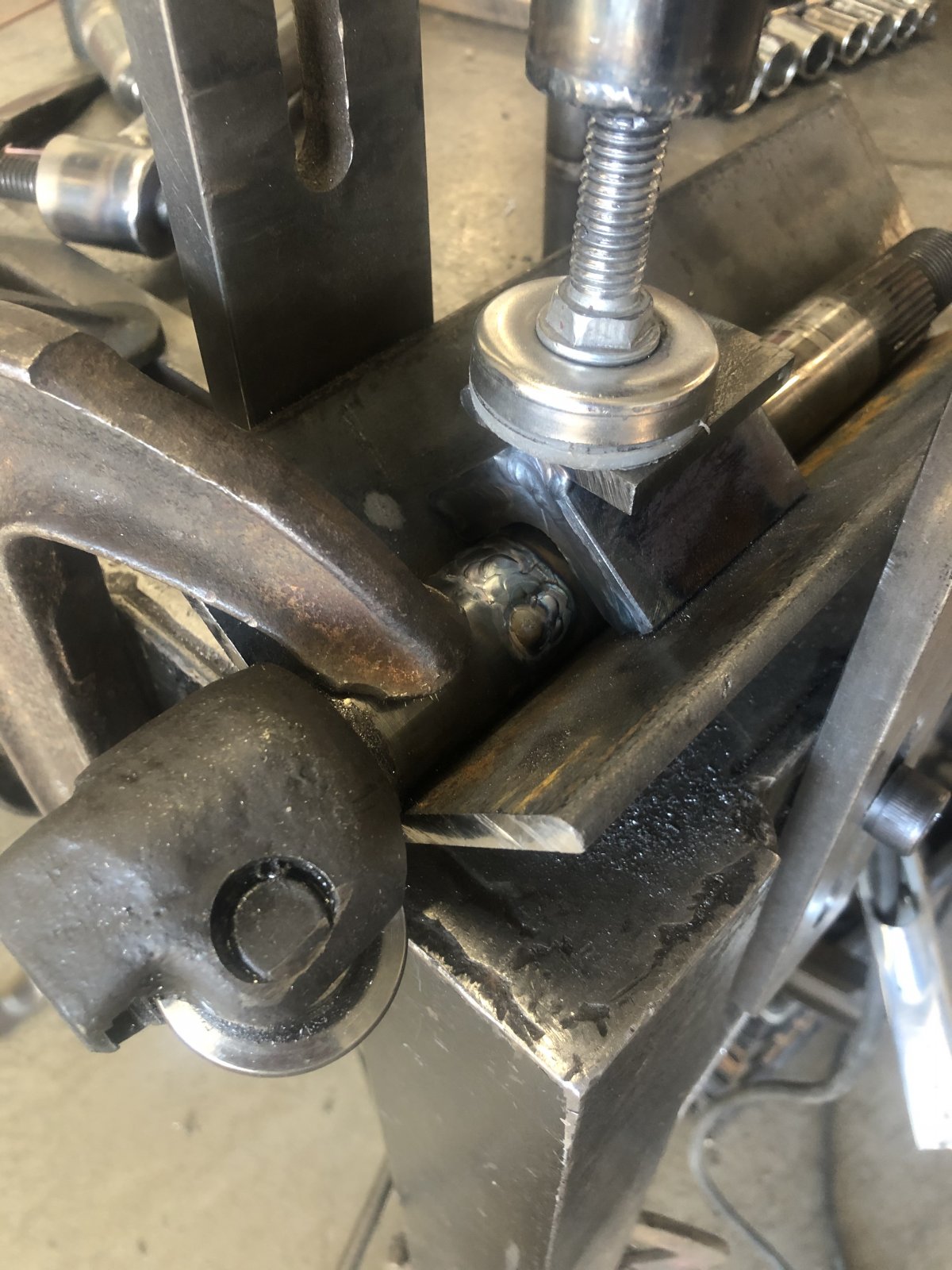

  30. flyin flattie
    Posts: 602
    flyin flattie
    from Redmond OR

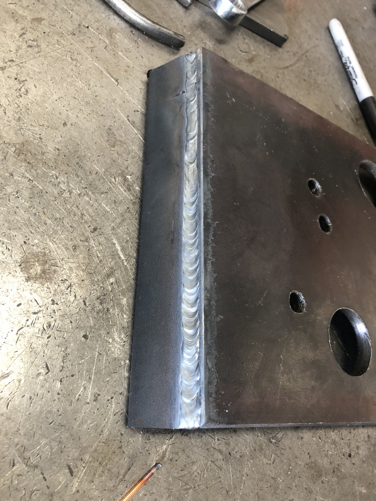

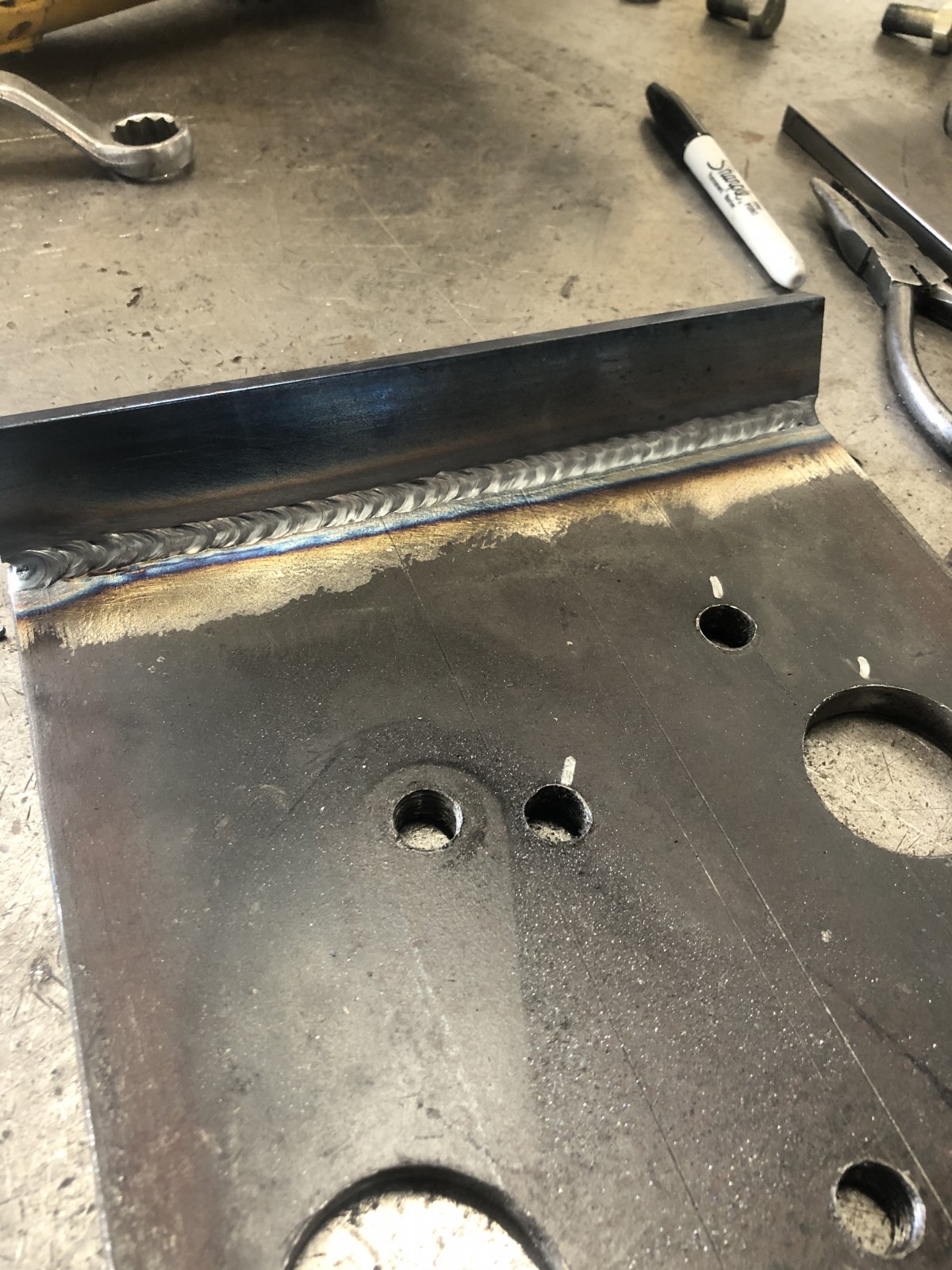

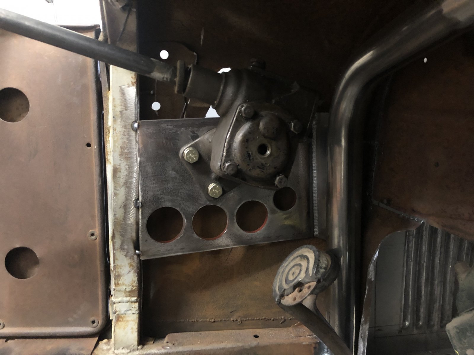

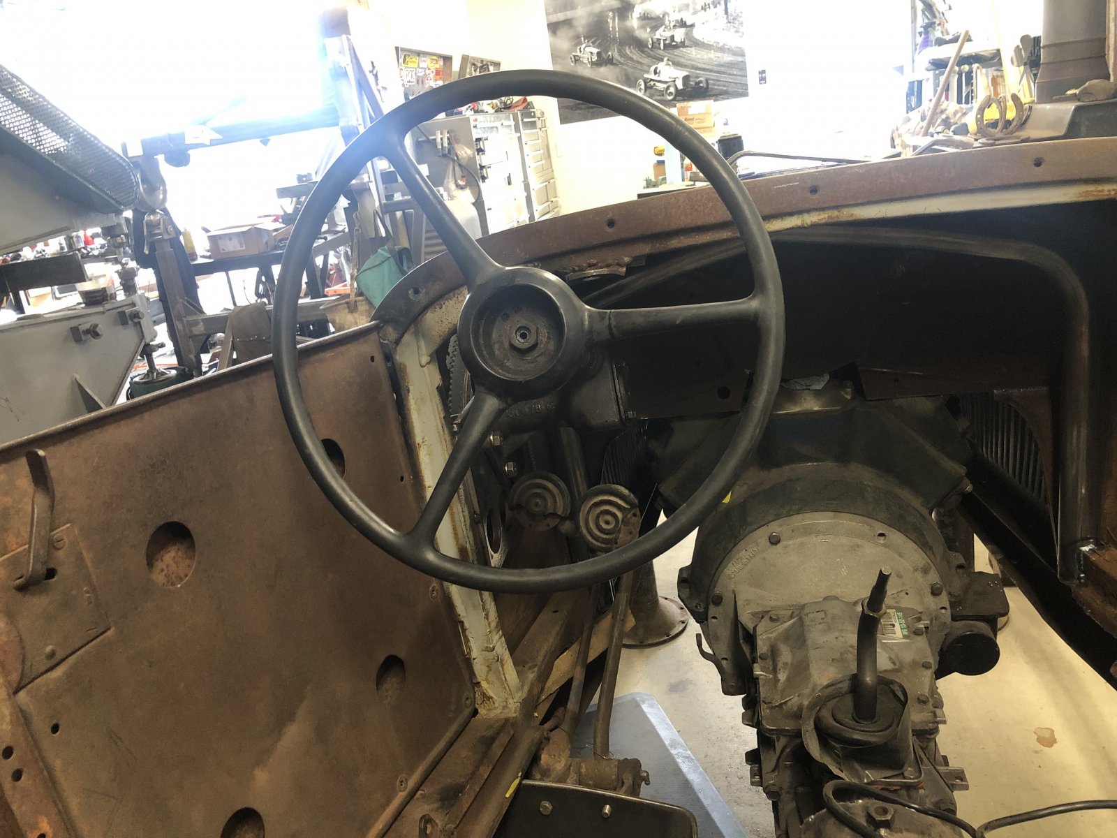

    Did some steering figuring. Got the 2”tube cowl support body mount in and the 3/8 x8” plate welded and tacked in. I extended the steering shaft 2” in the middle and it all worked great. I’m planning on case hardening the shaft now that it’s all test fit. then I modified a 38 dodge steering arm to work and it all fell into place. Just have some welding to be done and on to the next stage..
