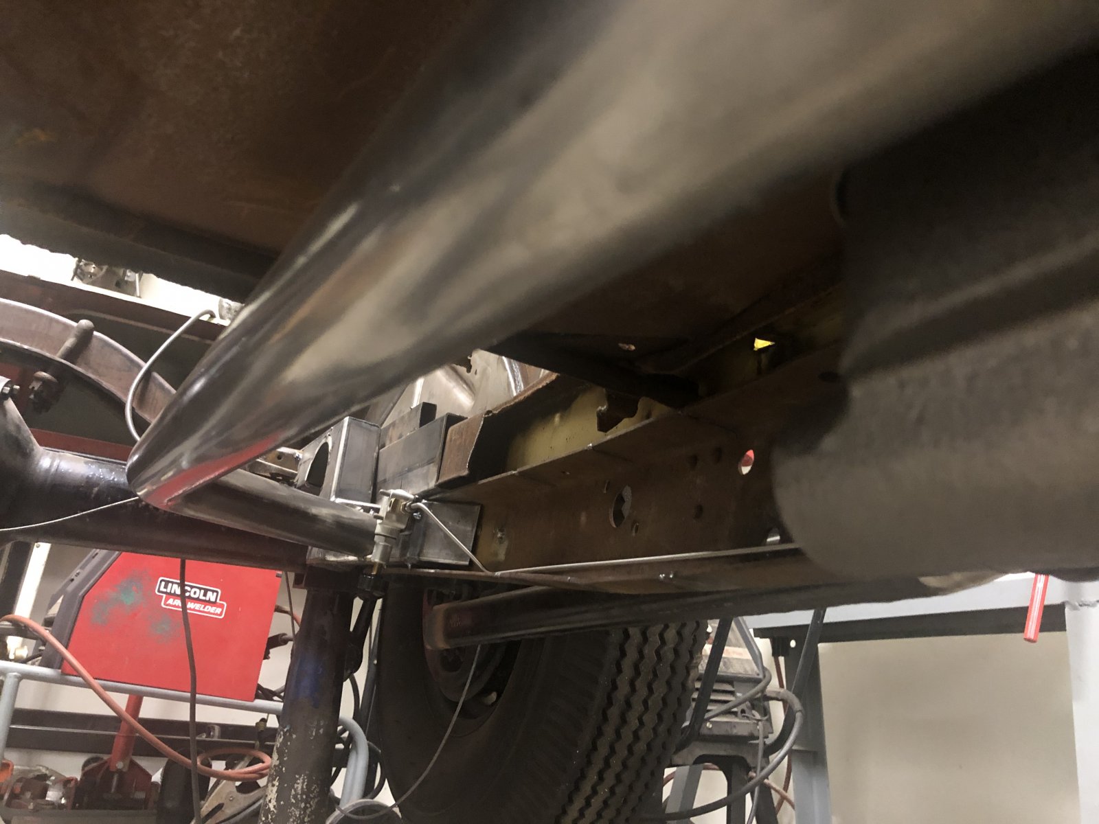

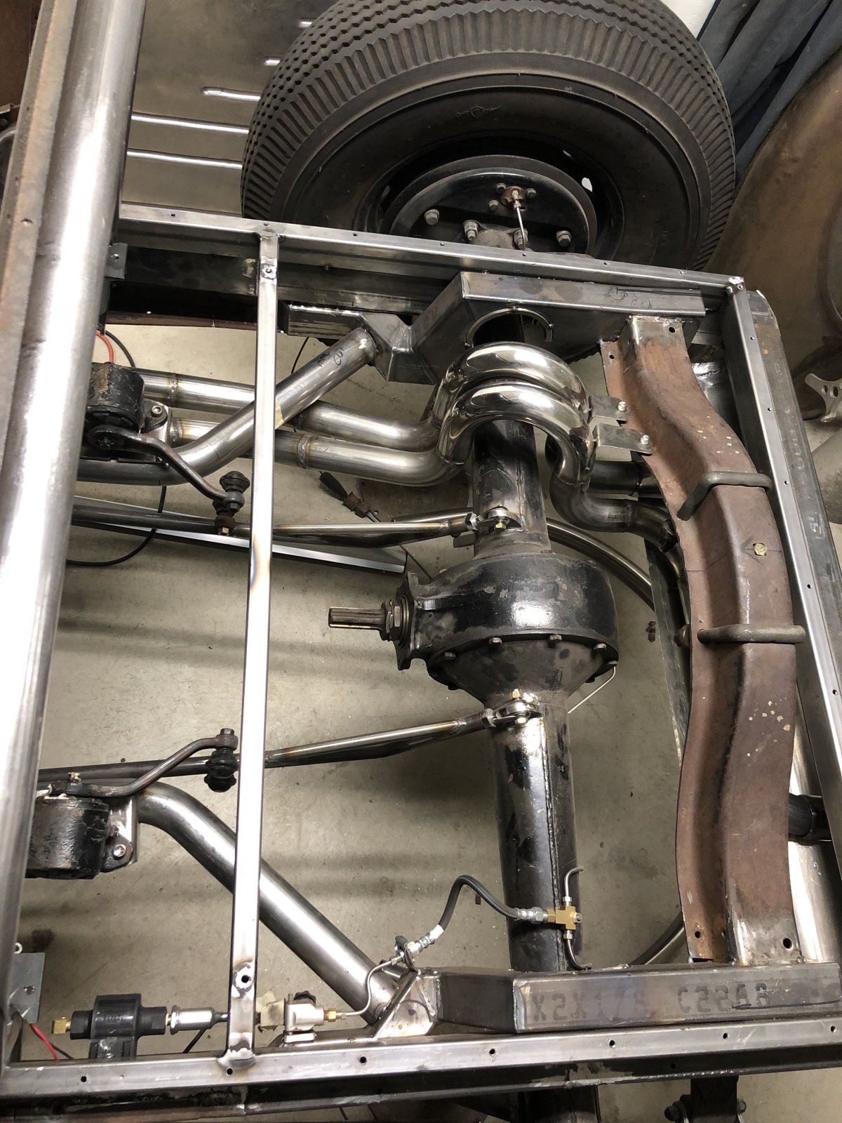

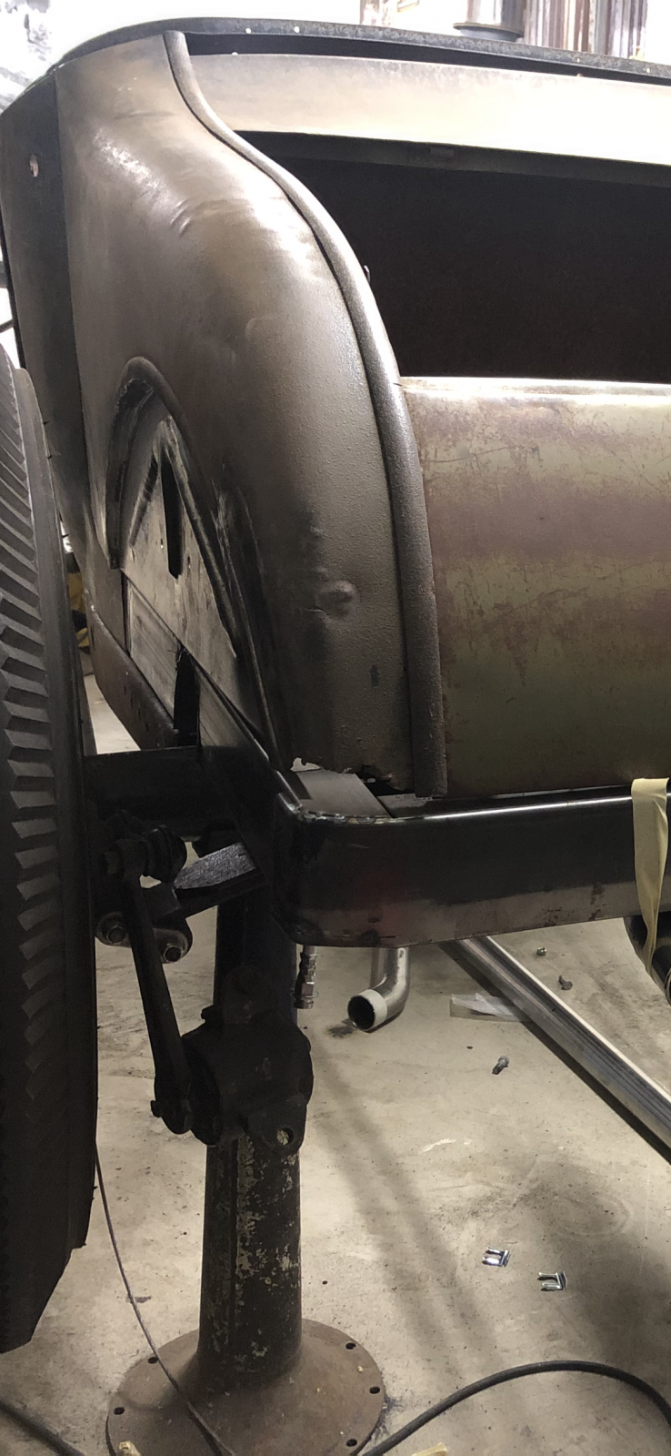

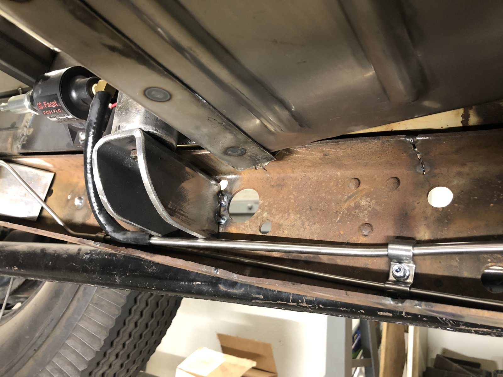

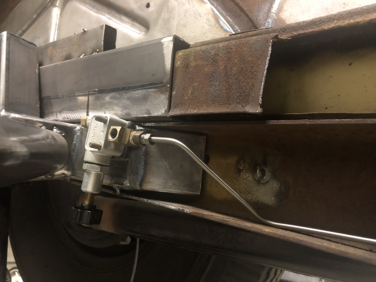

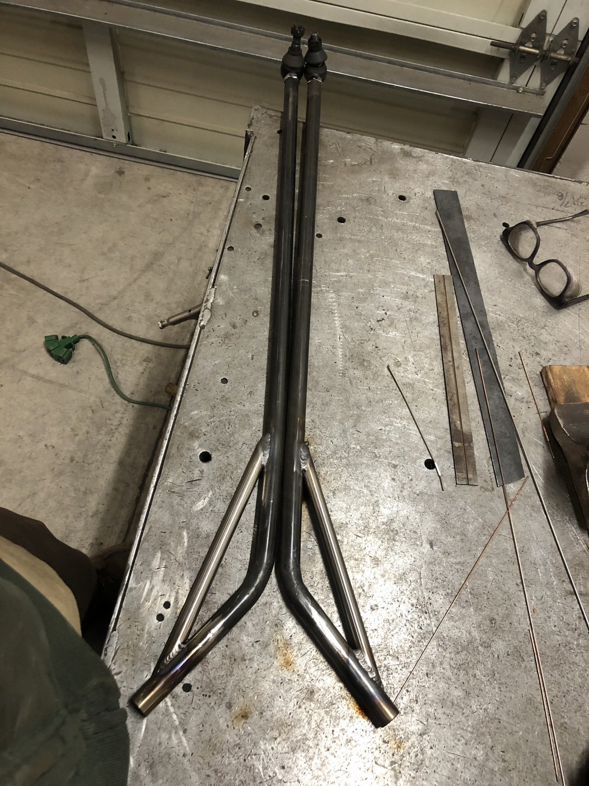

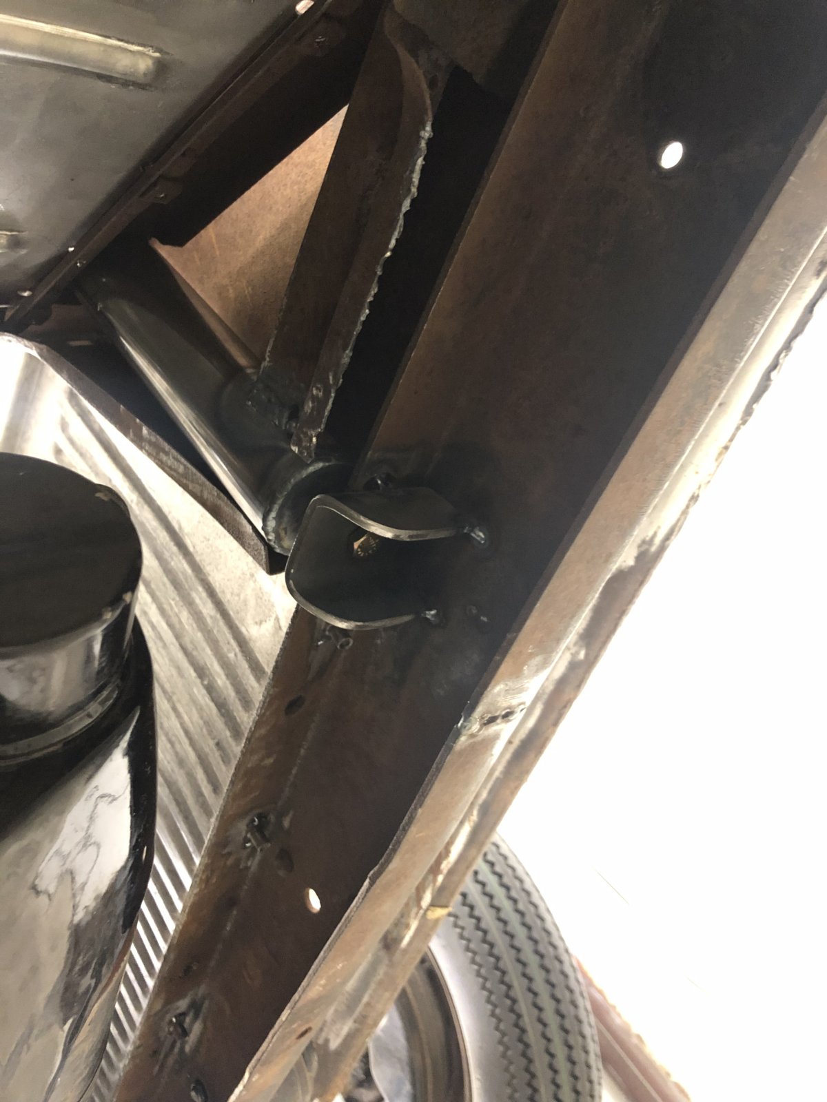

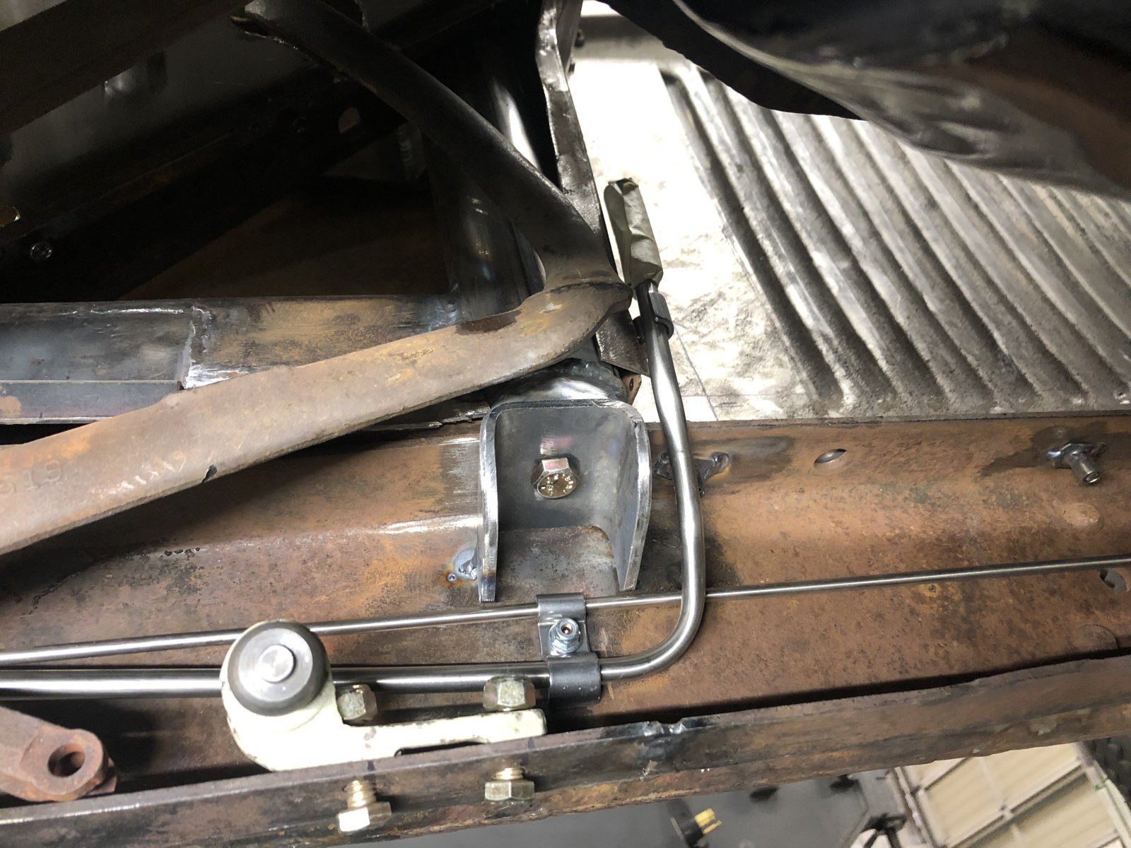

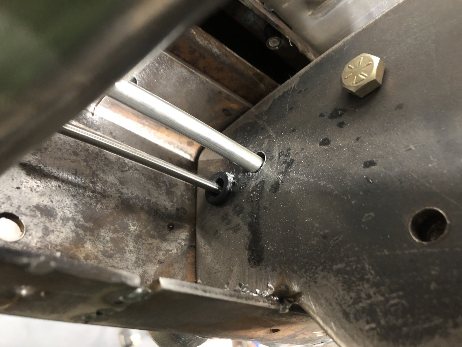

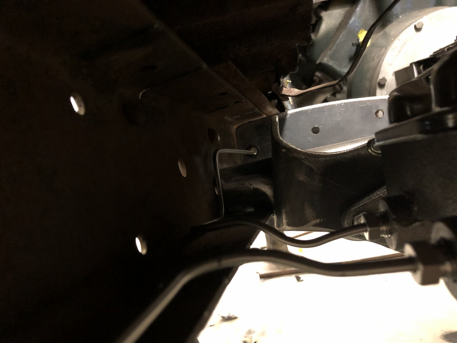

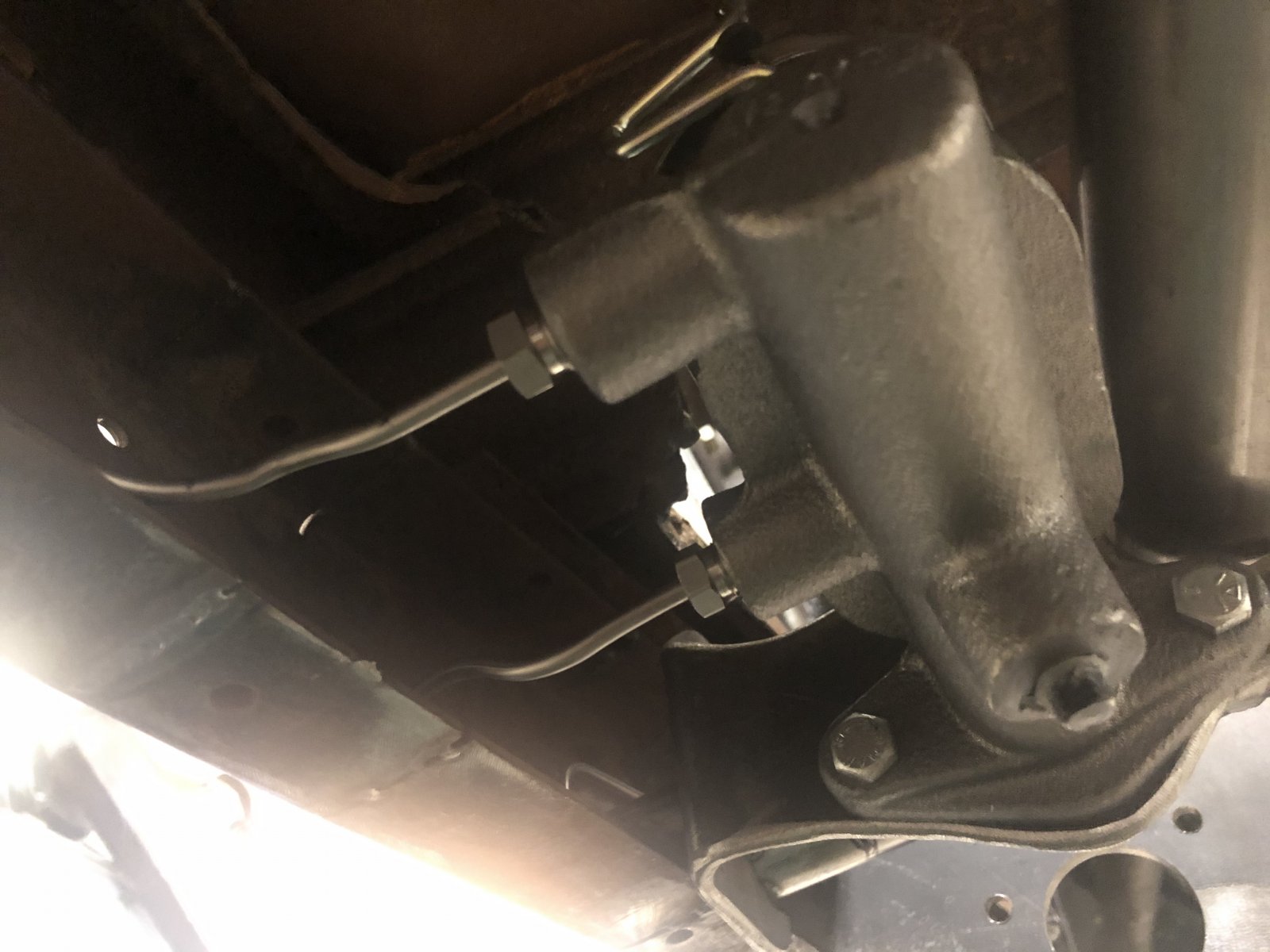

    I started running the round stuff, brake lines using a drum drum jeep master. 2” exhaust started and some wicked upper torque links made to hold that pinion angle where it belongs at 3 degrees headin north bound

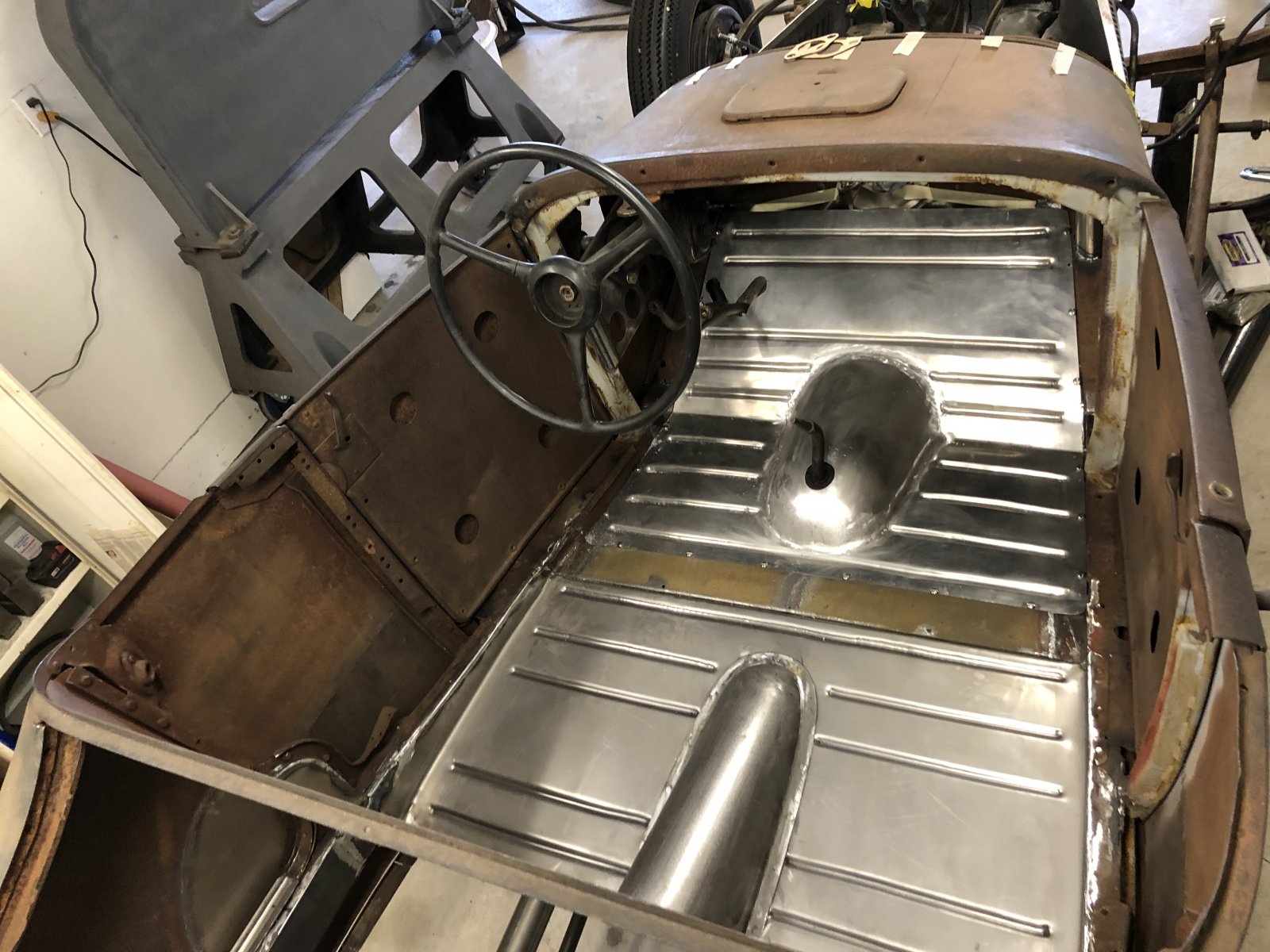

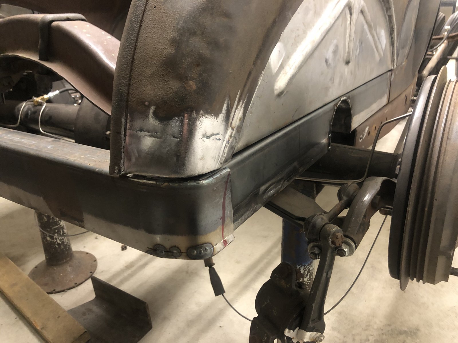

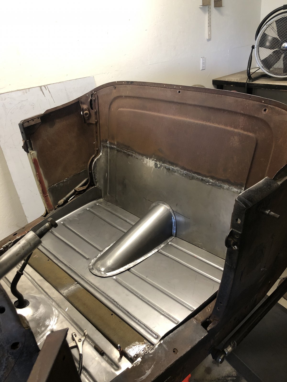

    Coming together got the floors done too 1E64F7FF-8047-422F-B62A-24B6E49A1D94.jpeg F9D3E2B4-0BB5-4512-BD17-85CB30118B24.jpeg C781FC20-2424-44E1-B83E-6D8658799176.jpeg DDFFB464-57D1-480F-AA92-B2D1AA3F2ED9.png

    Floor looks like it should be nice and solid. Great looking work

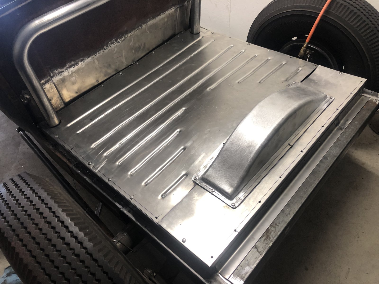

    It is! I sunk the seat as low as I could go and the floor panel is aluminum due to well I like aluminum and less weight means better gas mileage at 6 dollars a gallon give or take
    oliver westlund, Jet96, OFT and 7 others like this.
  14. flyin flattie
    Joined: Oct 13, 2005
    Posts: 602
    flyin flattie
    from Redmond OR
    Oh and the seat and tunnel are 16 gauge. Makes making that tunnel easier and gives my buns some safety

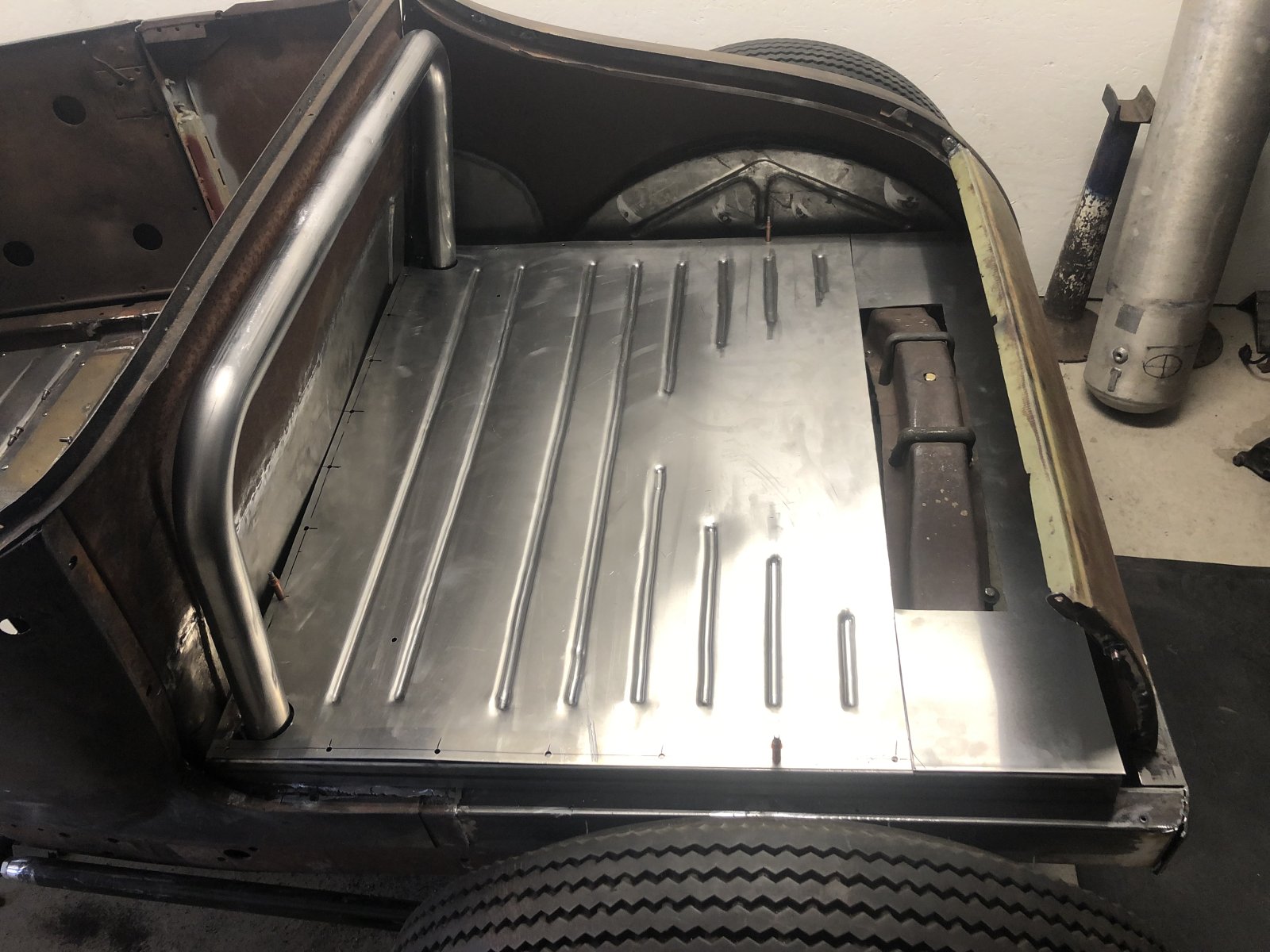

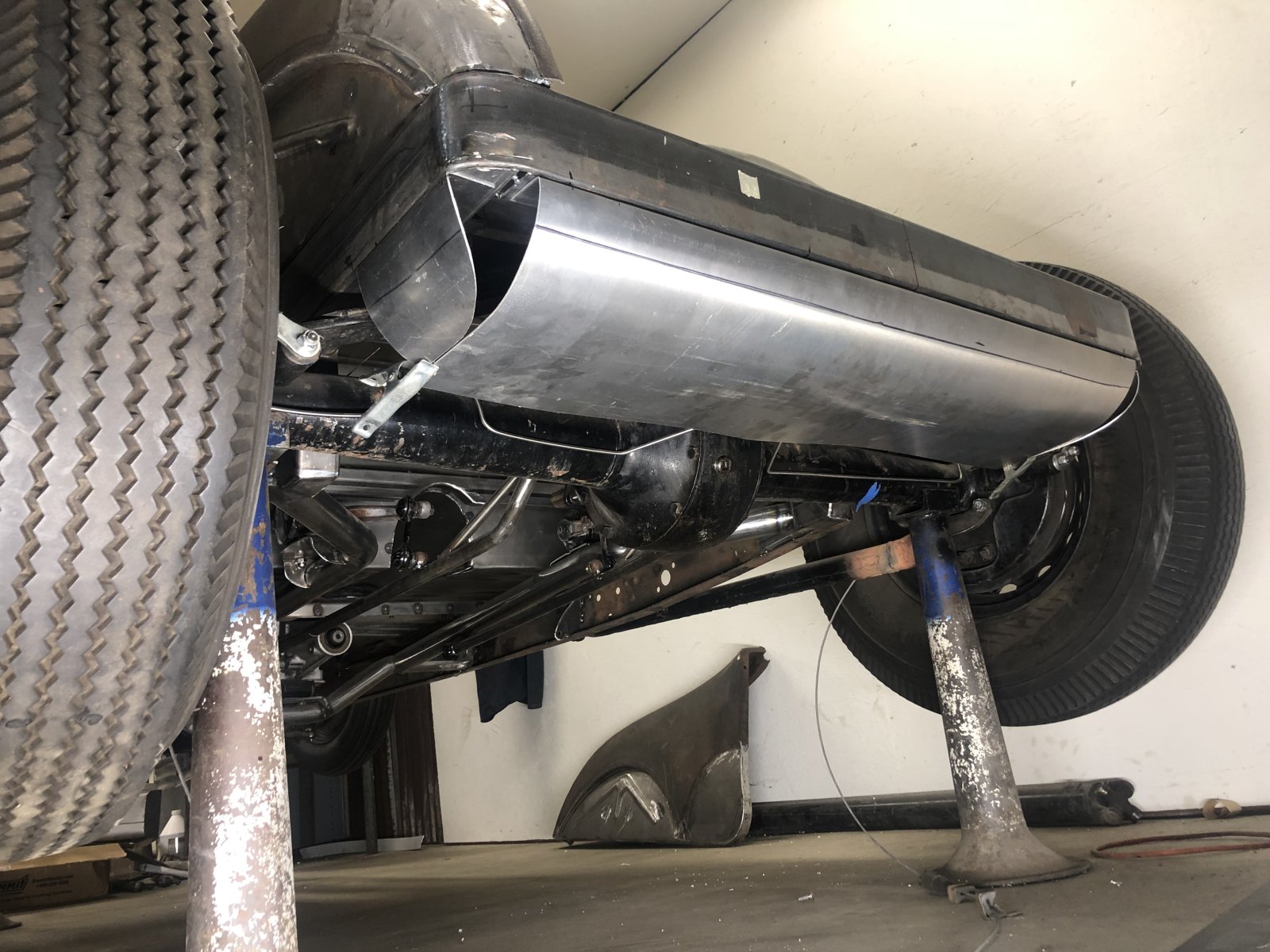

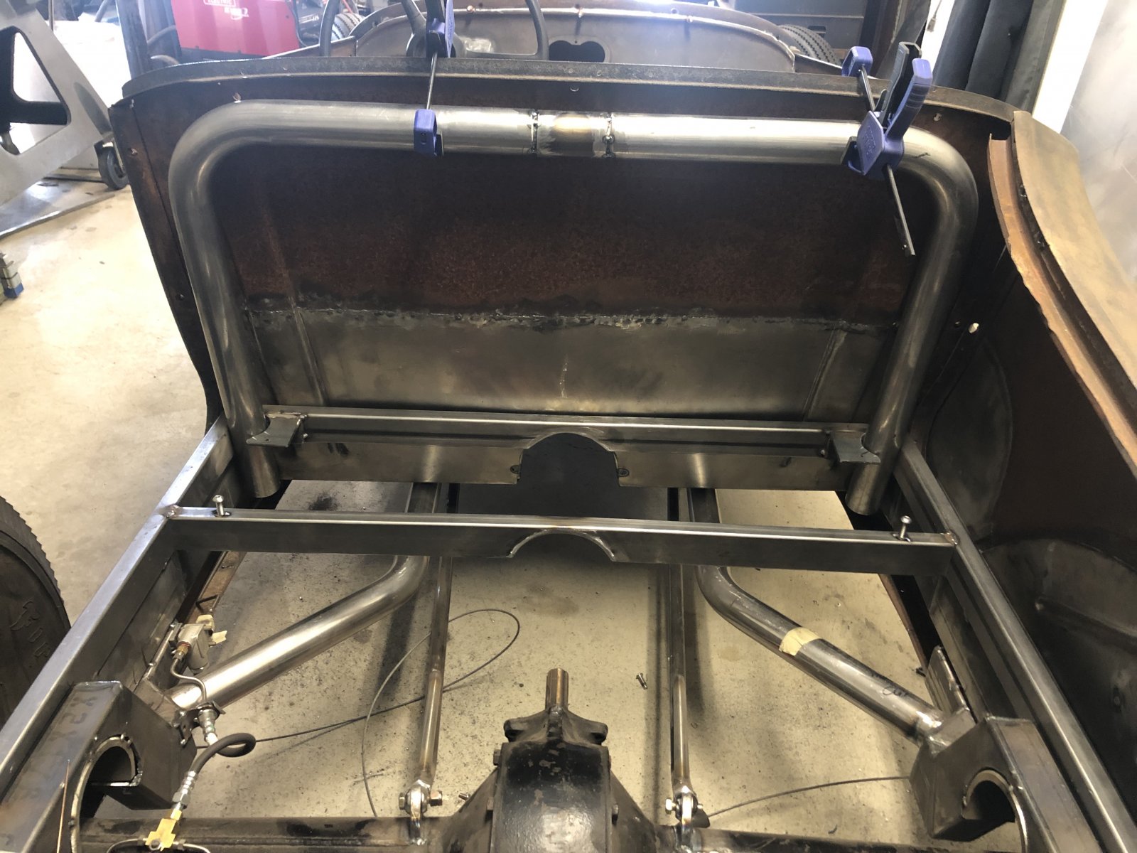

    I don’t always see the point in roll bars but the customer wanted one so here it is and tank getting fit with my 2” floor riser to allow for a flat floor. C24CD8BC-CA4D-4271-B996-3CF9015CC415.jpeg 50BB21AC-01F7-441F-B0F3-12F84D4BE305.jpeg D039A4BF-5818-4492-BE7B-44CD95B494D1.jpeg
    Oh and the steering wheel of the dreaded cowl steering

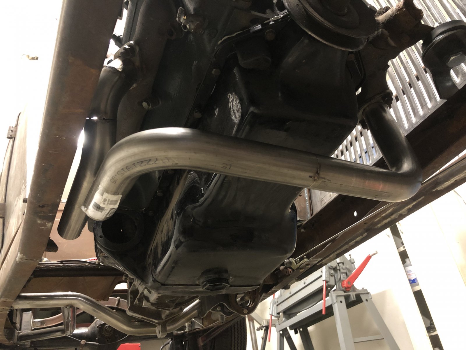

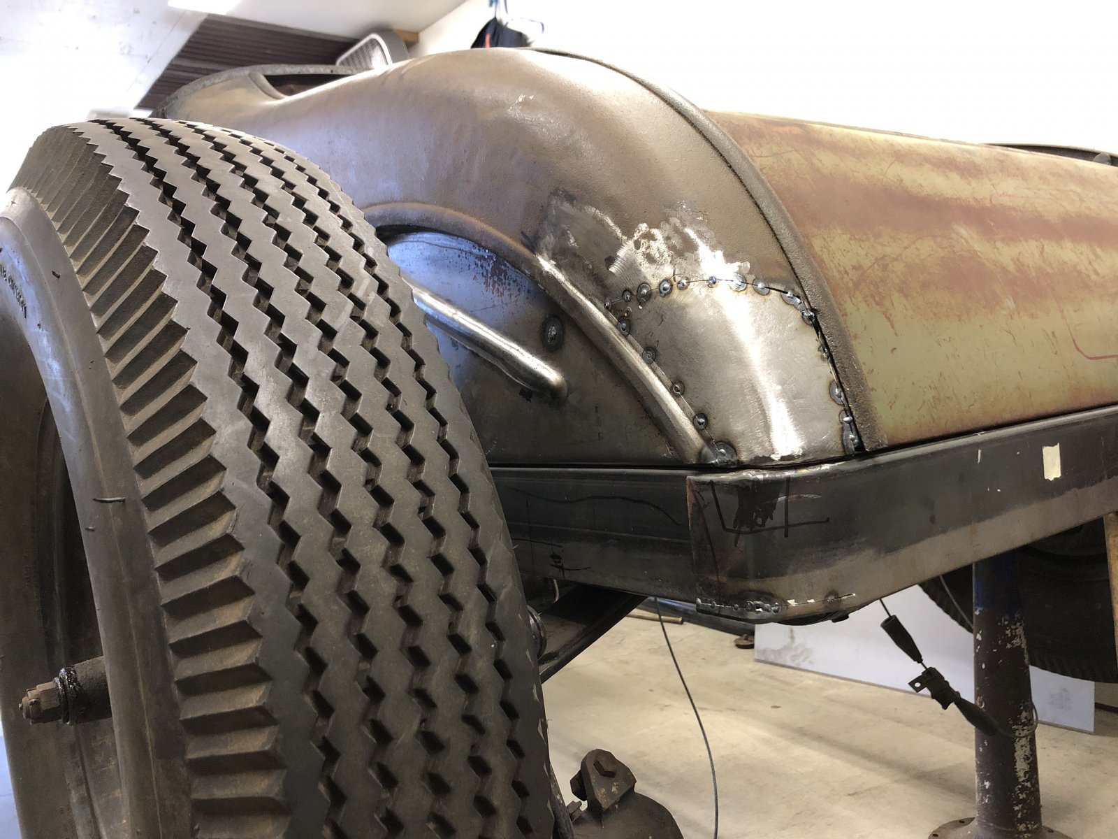

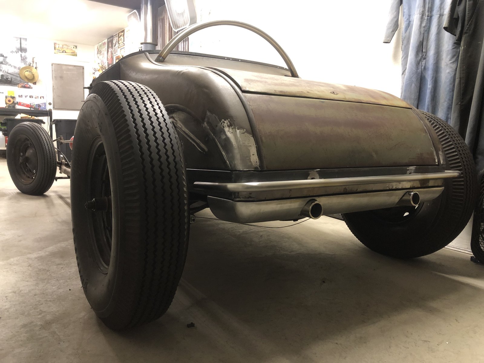

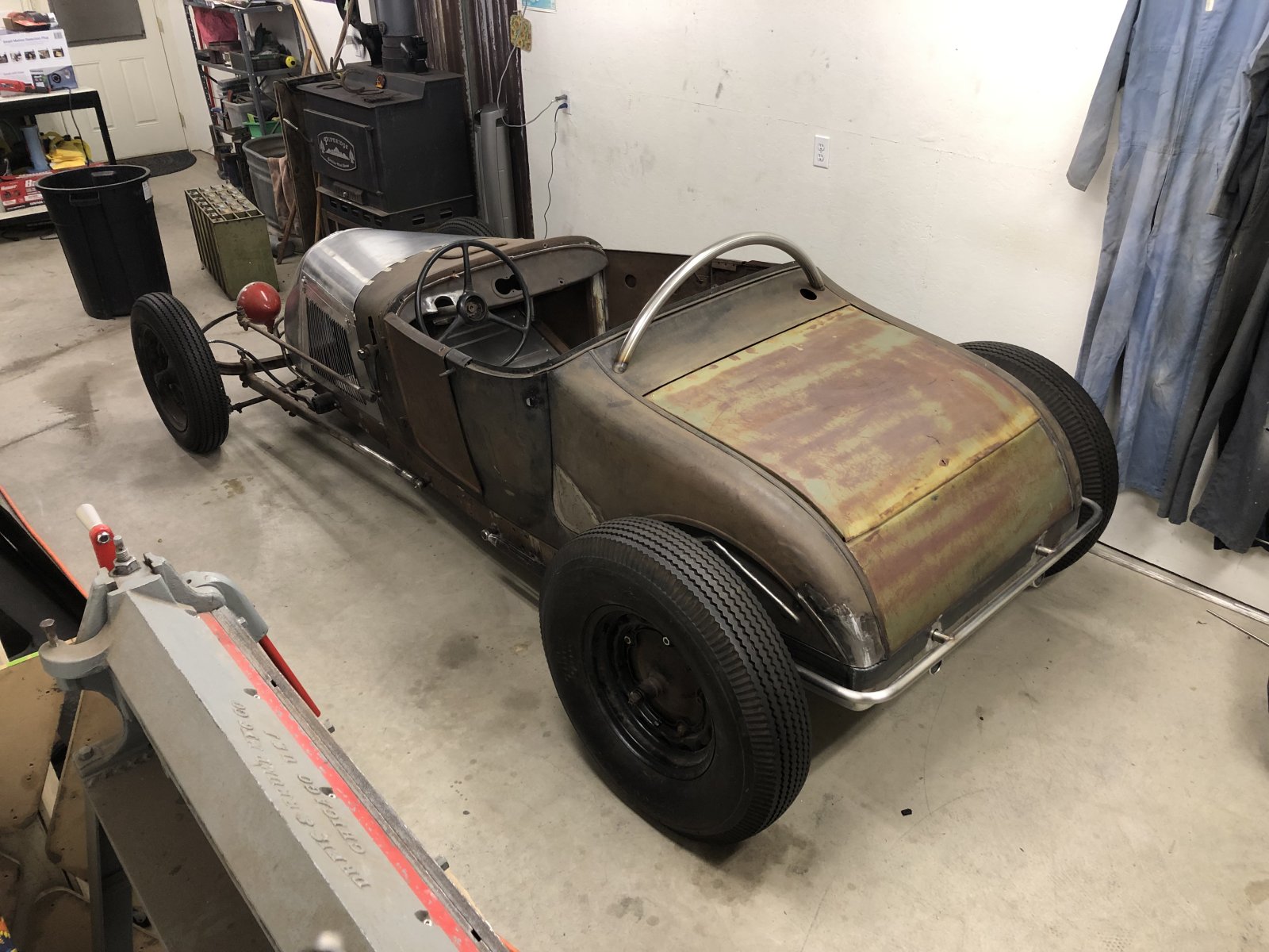

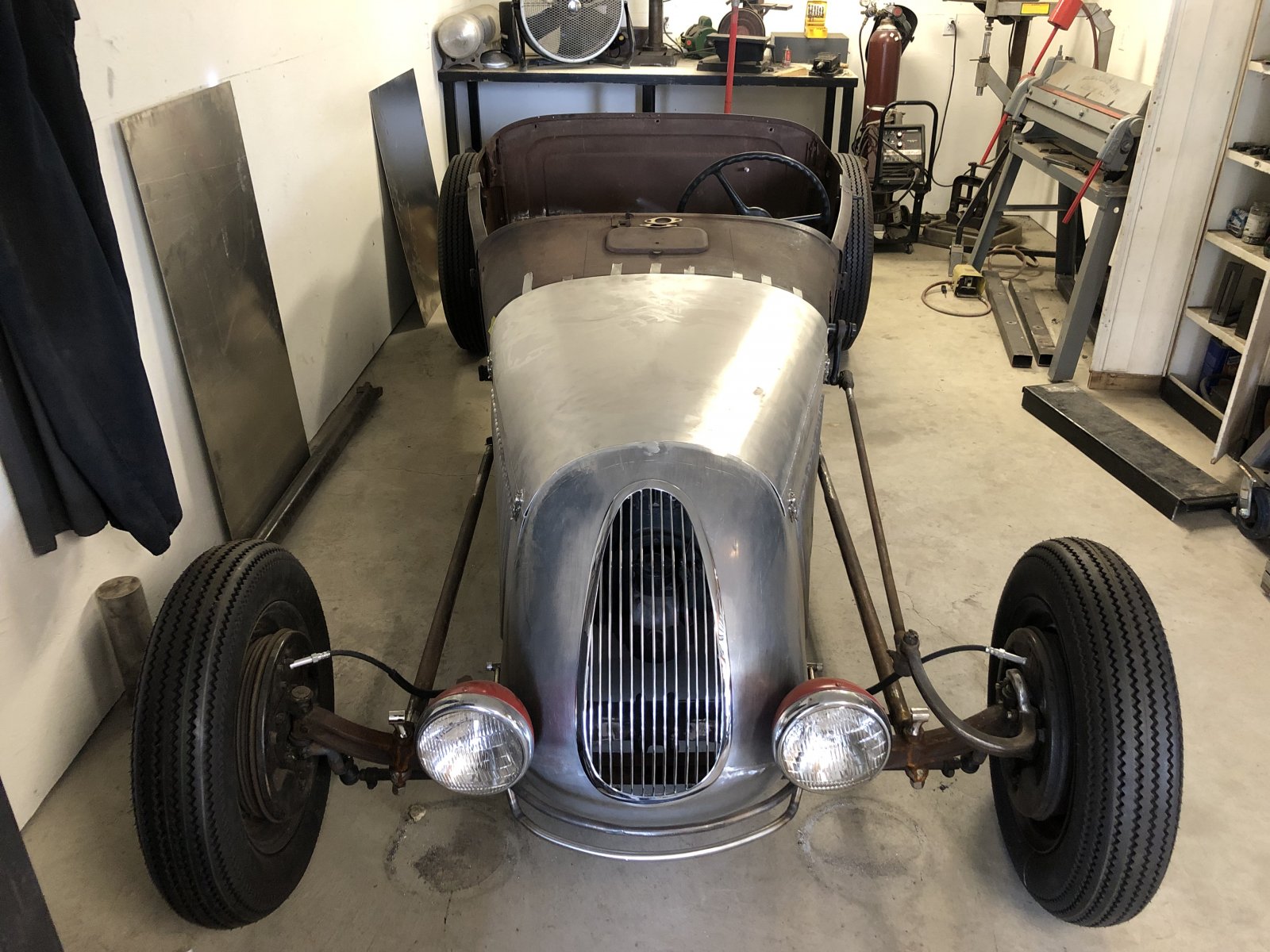

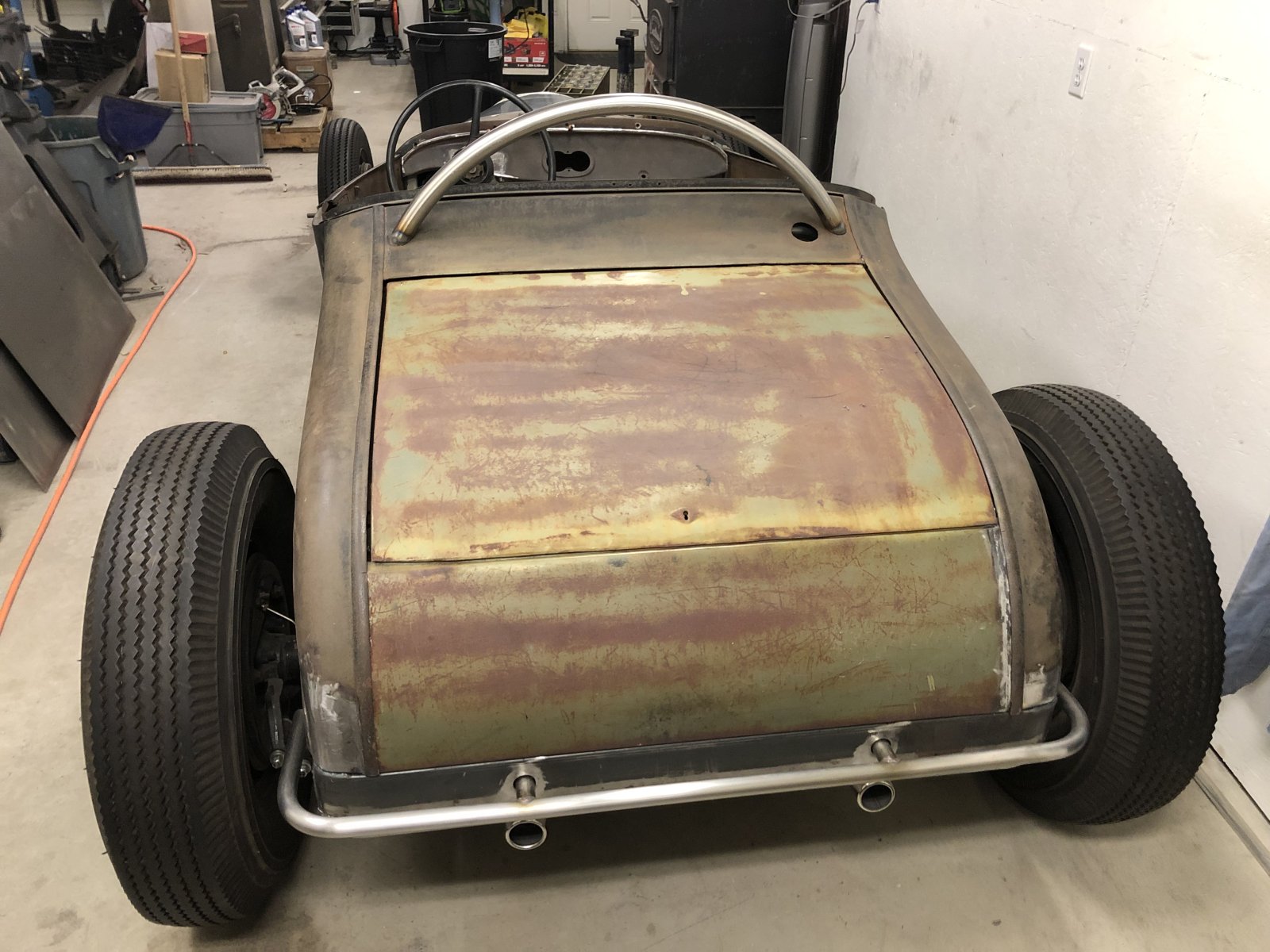

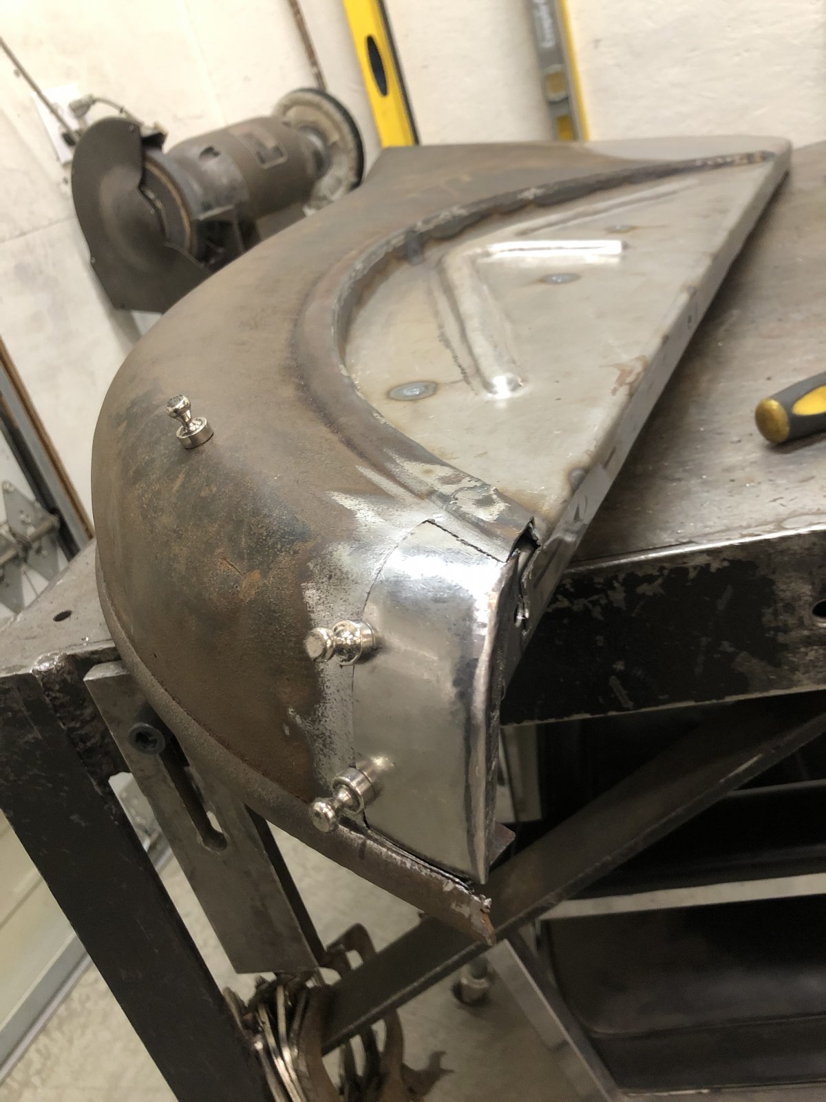

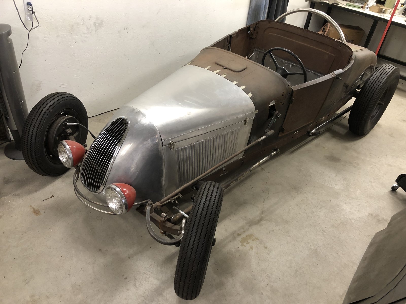

    Time for another update! I finished the exhaust, did the rear floor. Made a rear pan, bumper bar/ nerf bar. And got the external roll bar. Oh yeah and windshield set up is off to chrome

  27. Tim
    Joined: Mar 2, 2001
    Posts: 21,580
    Tim
    from KCMO
    Oh man that’s great progress and photos to zoom in on! Thanks for the update!

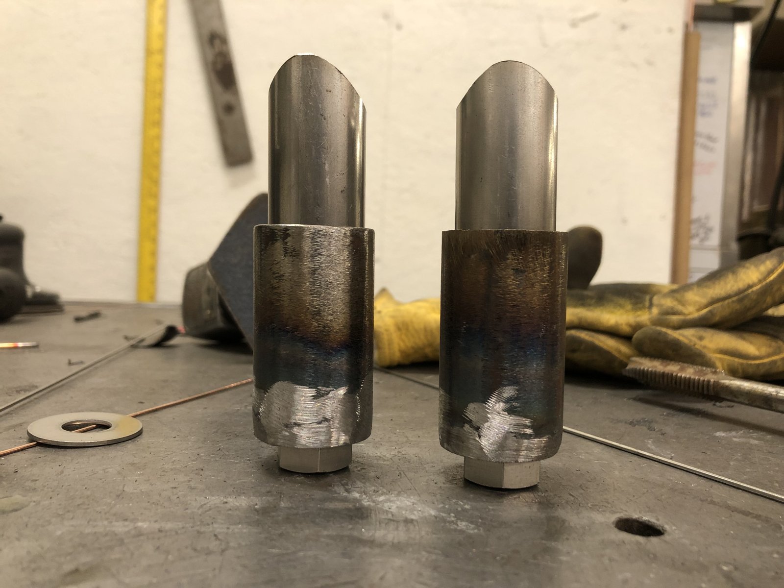

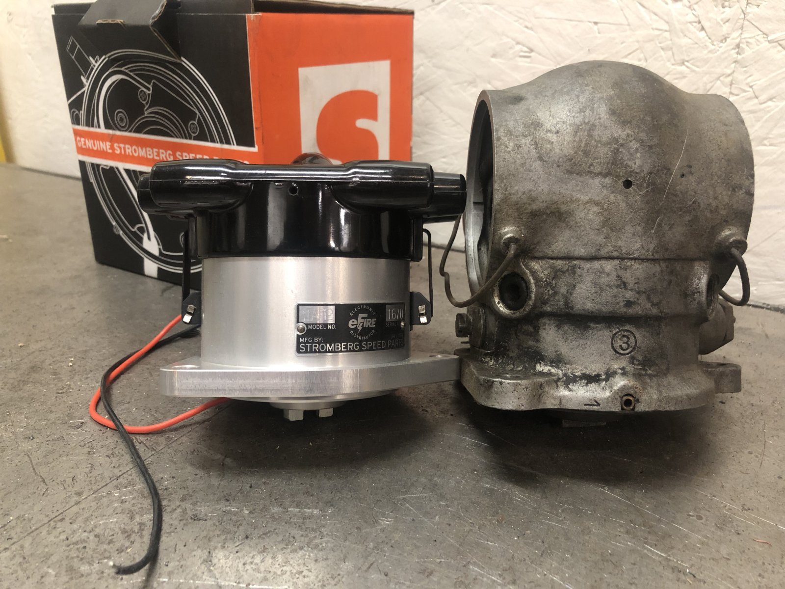

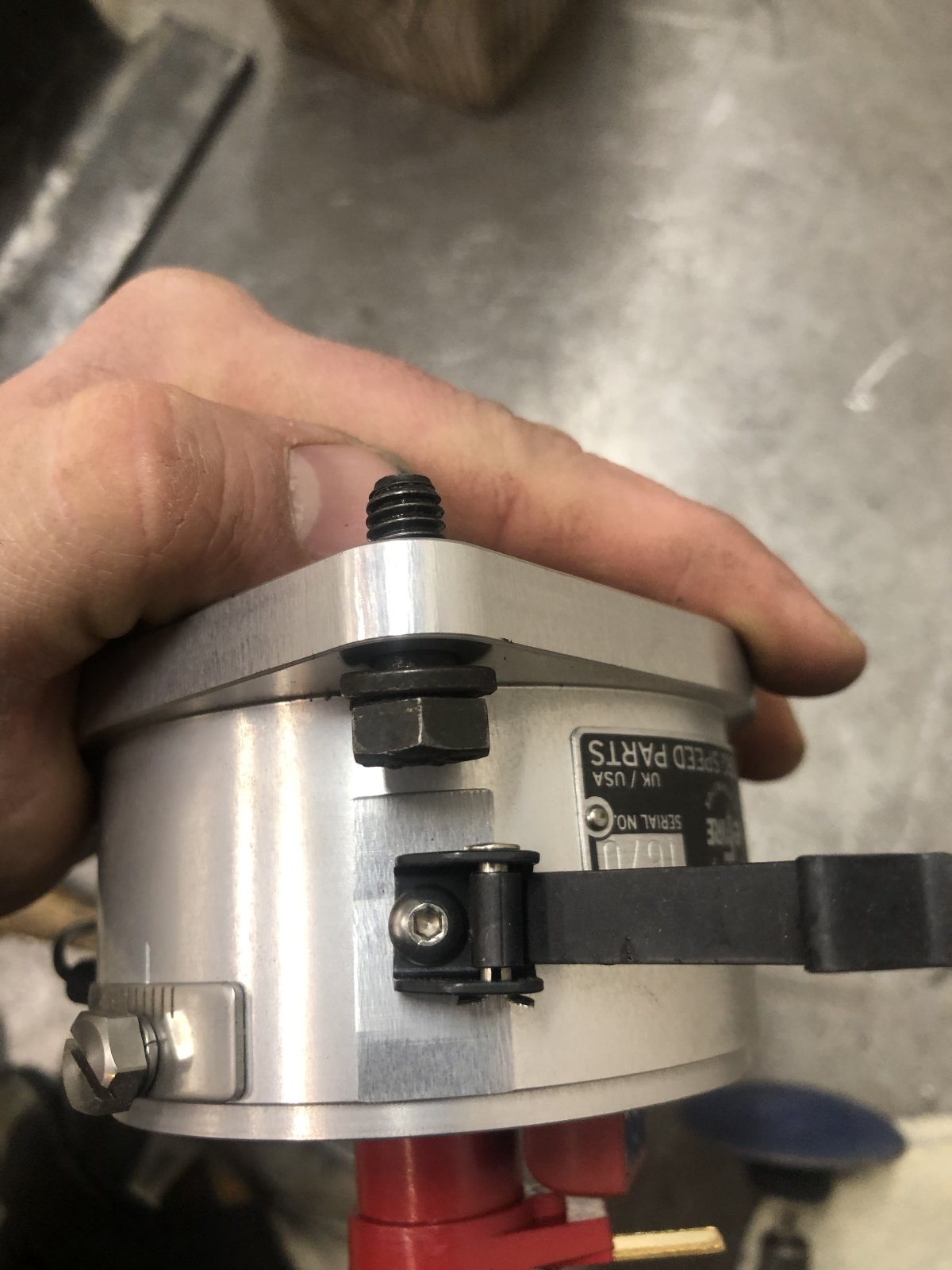

    75CC0649-D794-457B-B951-FF85C14CBDEC.jpeg 49937AAE-661F-4C58-8363-5D36E2B7A6A6.jpeg Distributor goin on too. Had to crack the Allen ceeper loose to get the bolt in.
