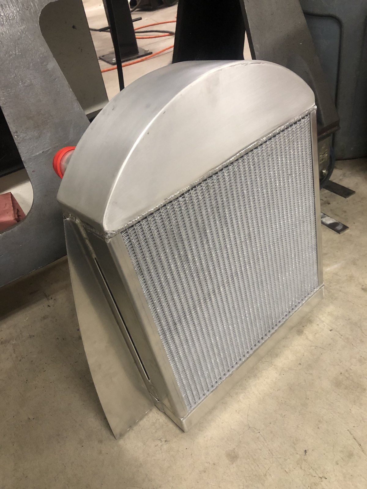

    Got a beautiful radiator from Brice Thompson. Can’t say enough great things about my experience with them. Now to shift some things around and sadly I’ll be slicing the front corners to fit under the tiny nose. All in the name of style and sleek.

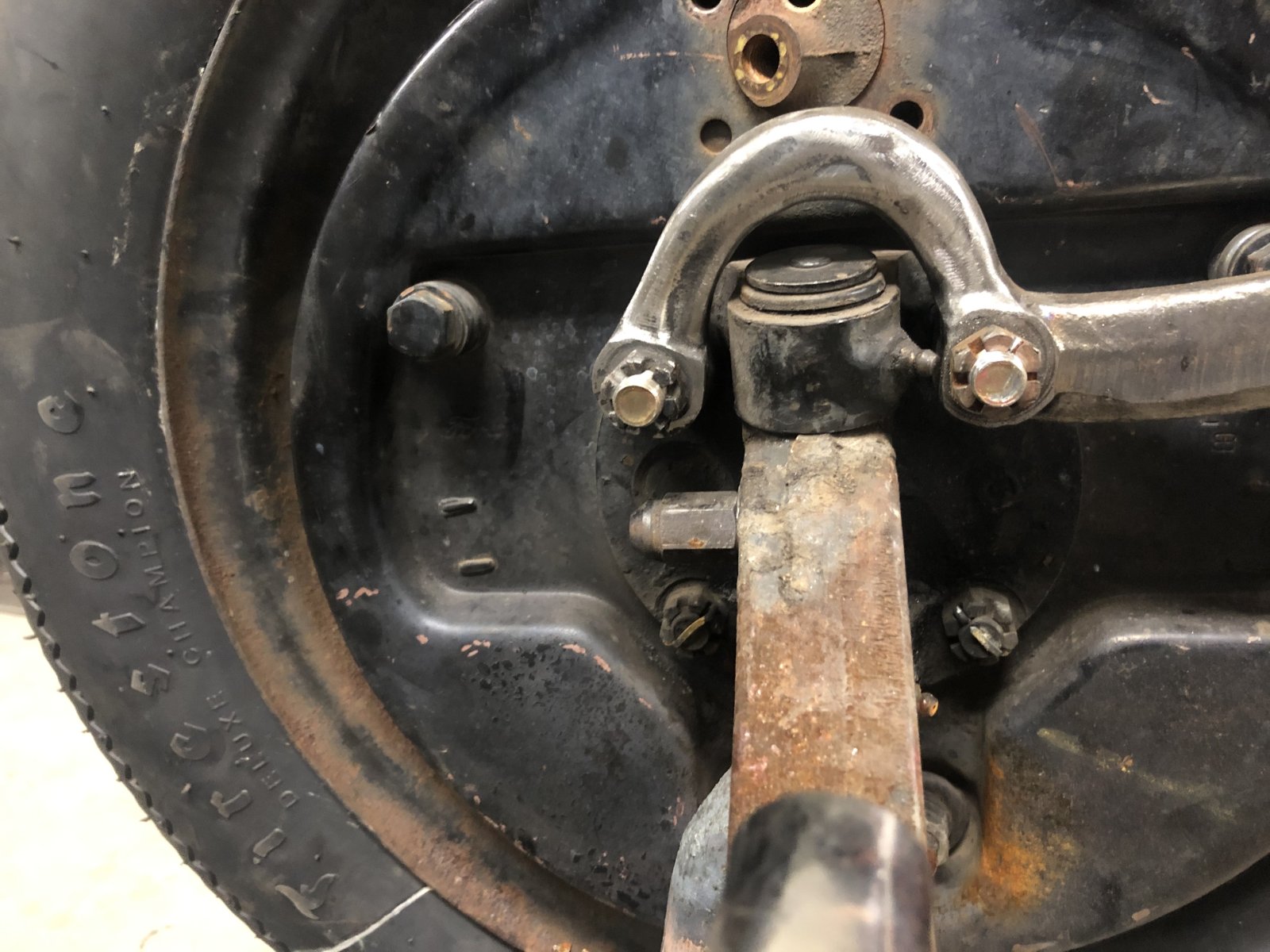

  3. jebbesen
    Joined: Aug 18, 2015
    Posts: 811
    jebbesen
    from Winona, MN

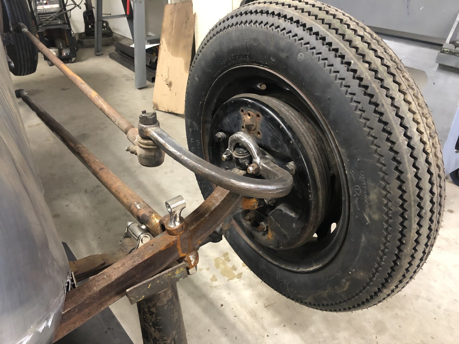

    What is that steering arm? Do you know what it's off from? Can you show a picture of it where we can see the arm as well as the backing plate/spindle?
    Stogy likes this.
  4. jebbesen
    Posts: 811
    jebbesen
    from Winona, MN
    Sorry I looked back thru and saw it was a modified 38 dodge part. Still would like to see a close up of how you mounted it to the spindle if you don't mind.
    Stogy likes this.

  8. flyin flattie
    Joined: Oct 13, 2005
    Posts: 602
    flyin flattie
    from Redmond OR
    C4EAB43C-EEDF-4DC2-A650-EEBD30F29F54.jpeg 50ED8ED0-456A-4E52-B94C-B32F4420F93A.jpeg
  9. jebbesen
    Posts: 811
    jebbesen
    from Winona, MN
    Thanks!

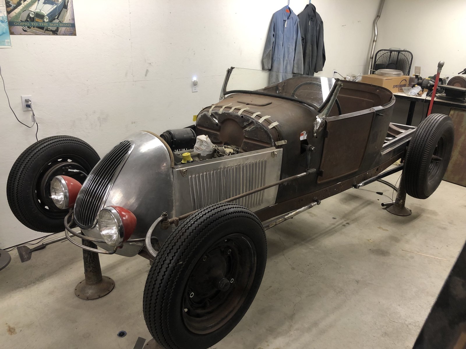

    Hey just want to say thanks everyone! Sorry that I’m not always responsive and might just dump pictures. I’ve got a wife and two toddlers soaking up a lot of my time when I’m away from the shop so I’m doing this right as I’m treated by the first kid in the morning. Look forward to the last couple things then blowing it apart for body and paint.

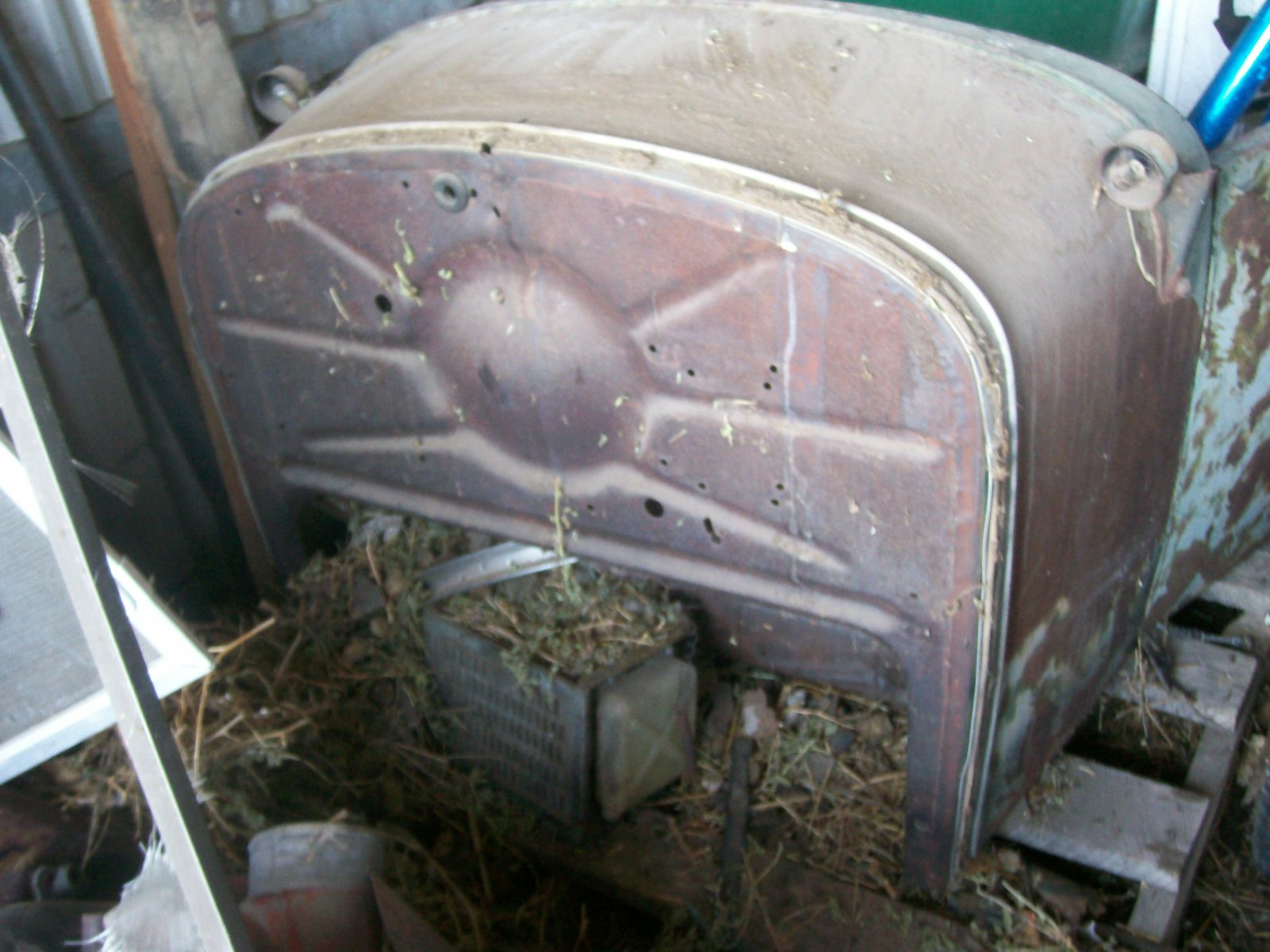

  12. Wow!! Just saw this thread after Stogy commenting about it on the tired of homogenized hot rods thread… Love the nose and the quality craftsmanship, direction of your build!
    C3BCB5BD-19AA-4BB8-AB40-1419146E7820.jpeg 98DD7CBD-06EF-405D-8D8B-A4E1823A0339.jpeg
    I’ve been slowly trying to sort/finish a build with a different front nose along similar lines… Really great to see someone else’s approach and getting inspired to work on mine by seeing the progress on your beautiful roadster.

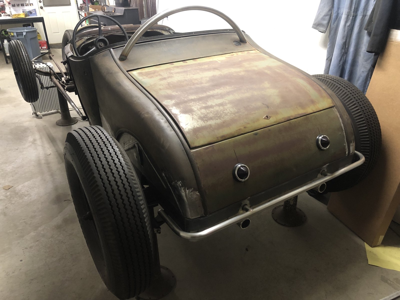

  13. flyin flattie
    Posts: 602
    flyin flattie
    from Redmond OR

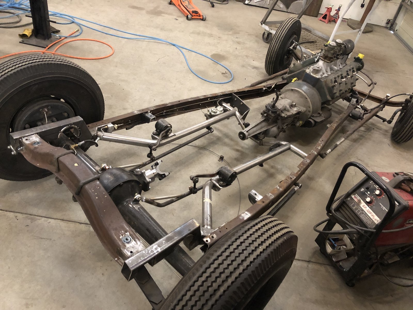

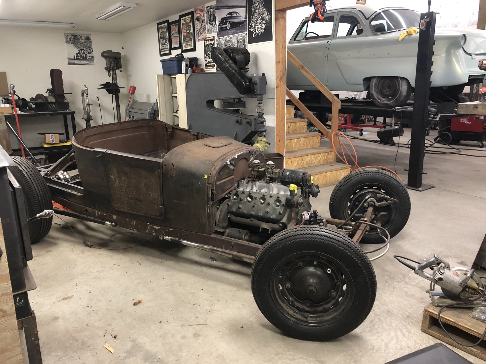

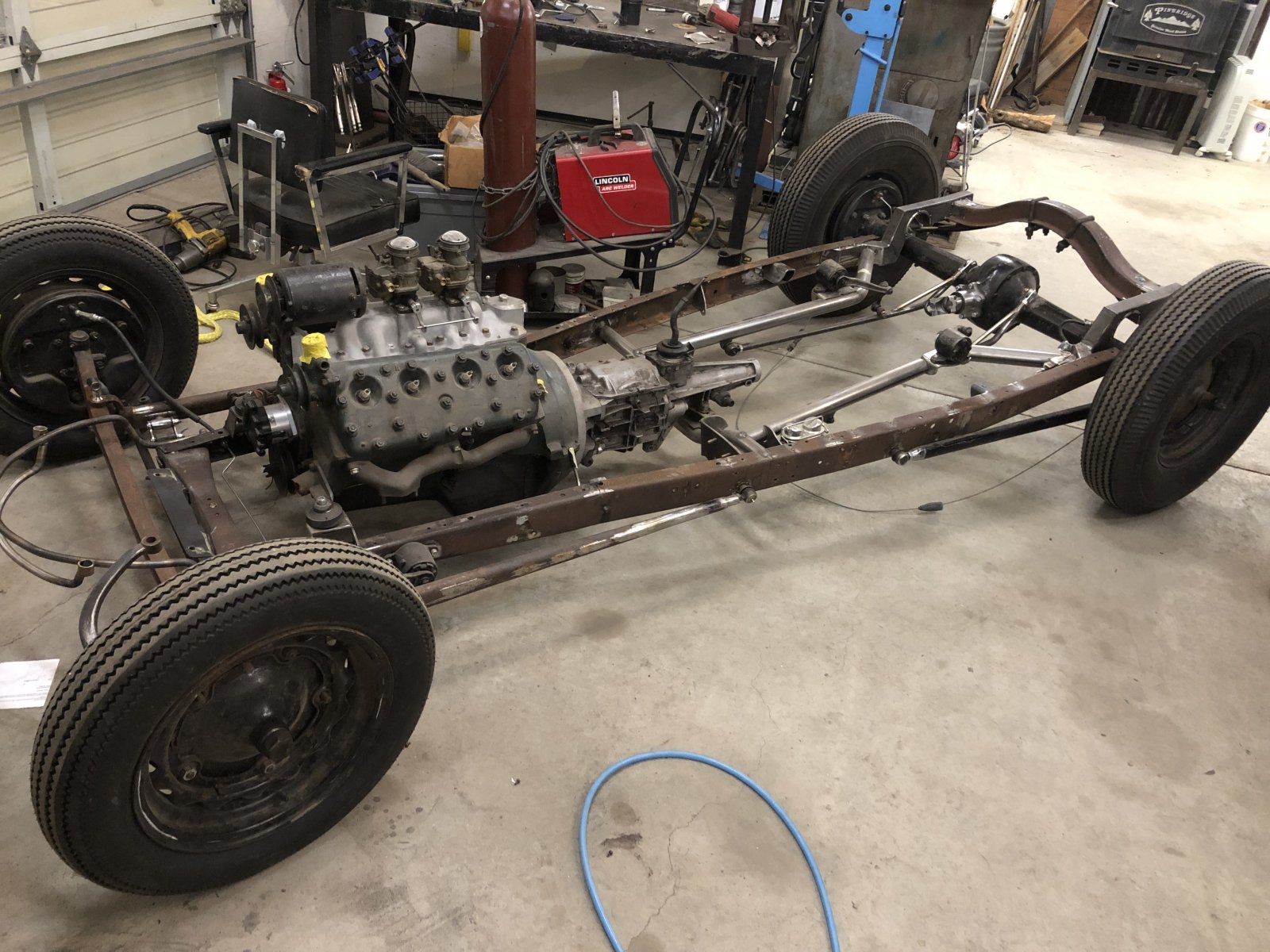

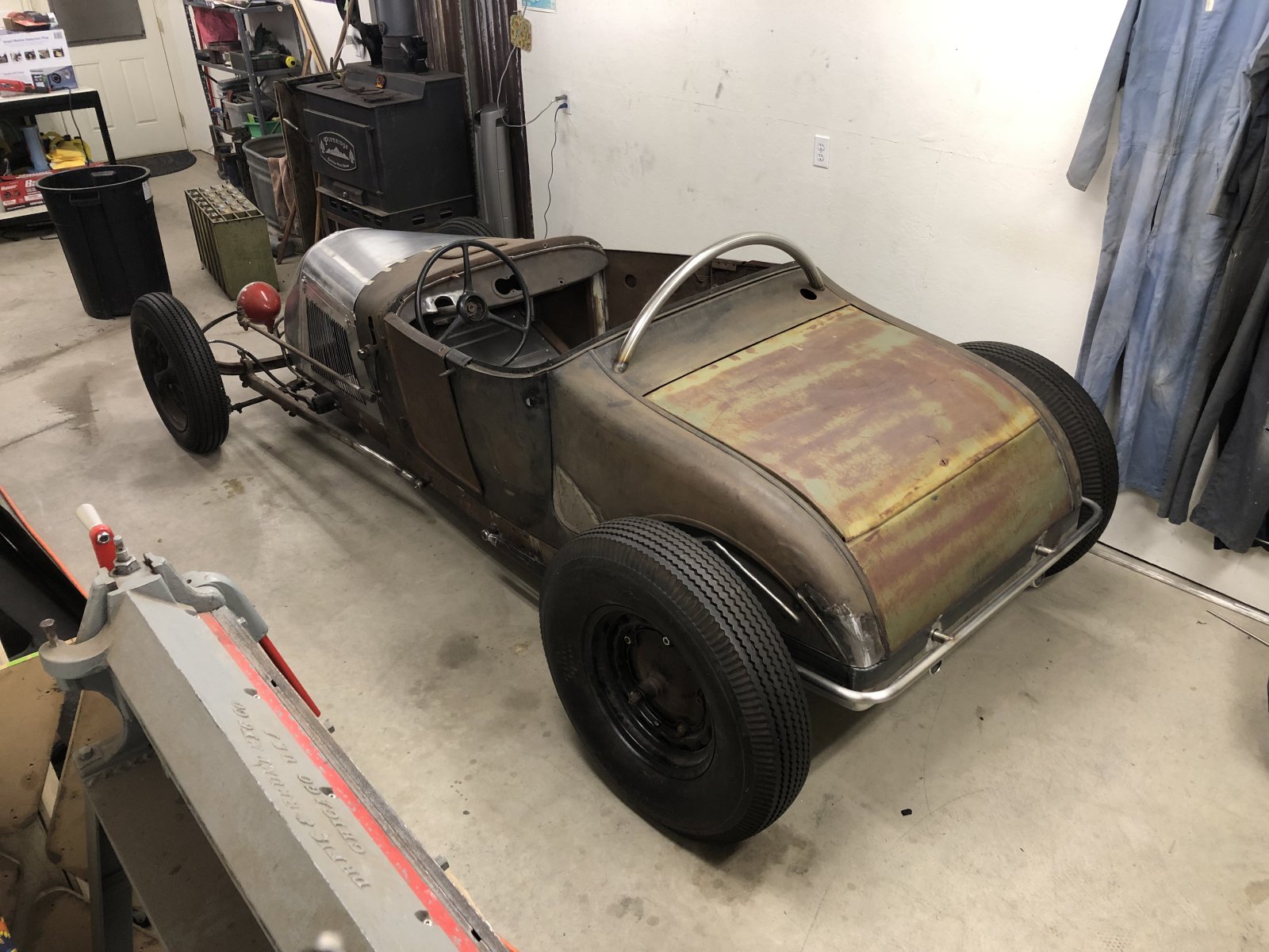

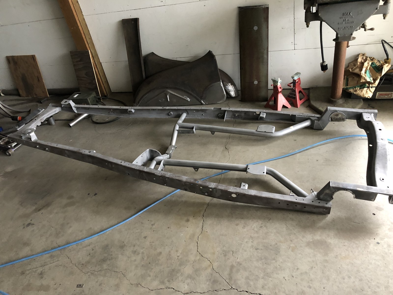

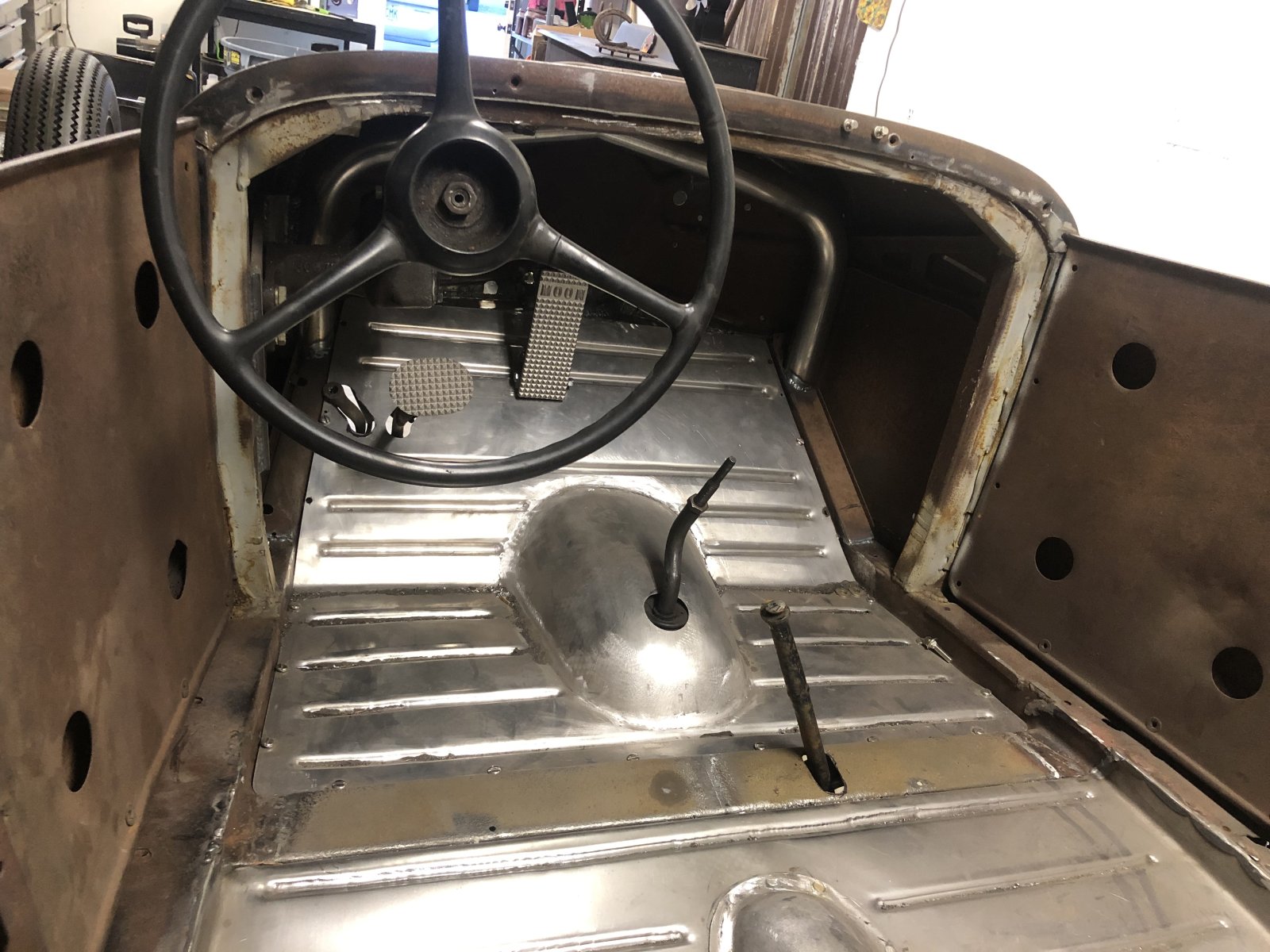

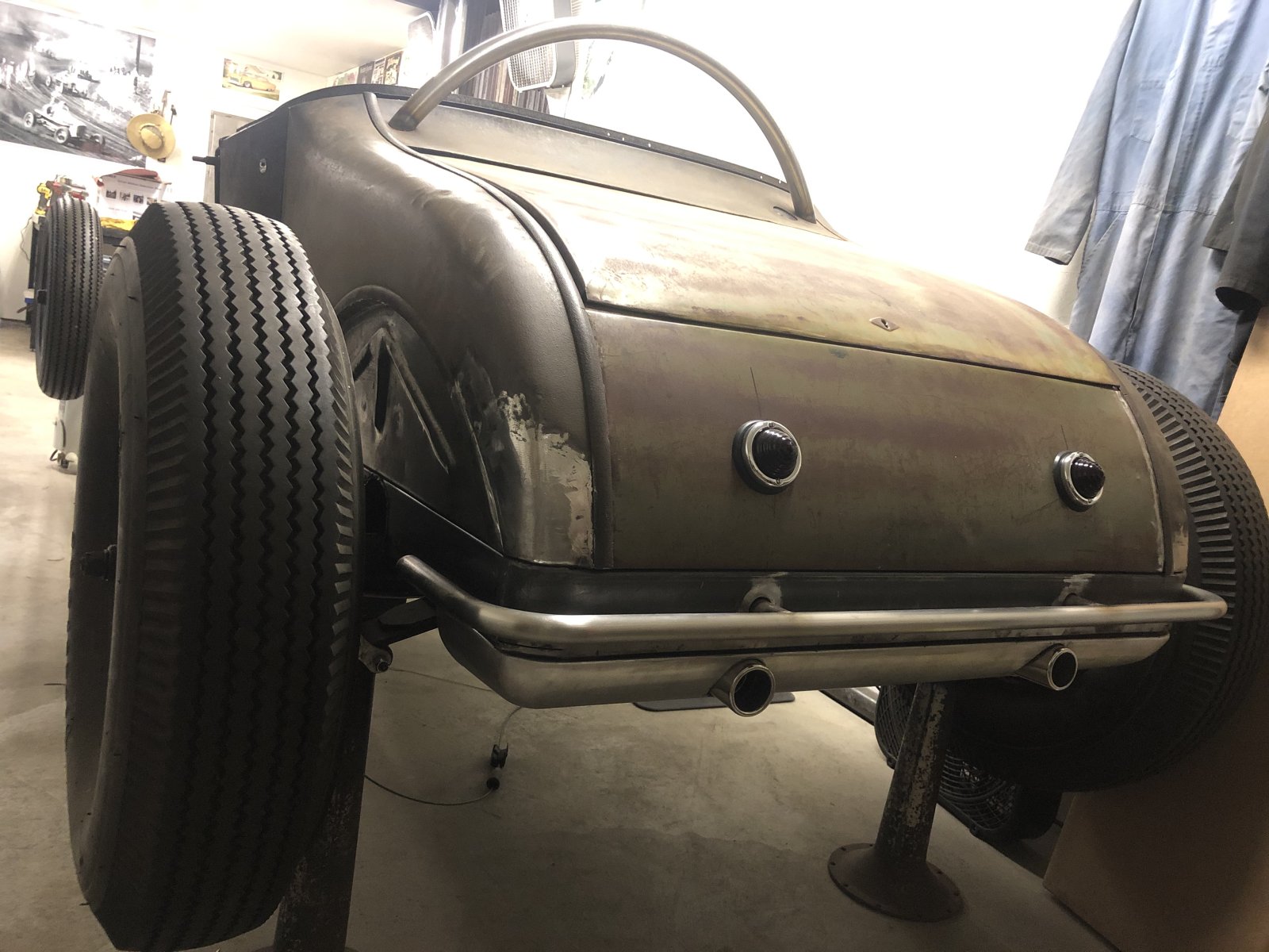

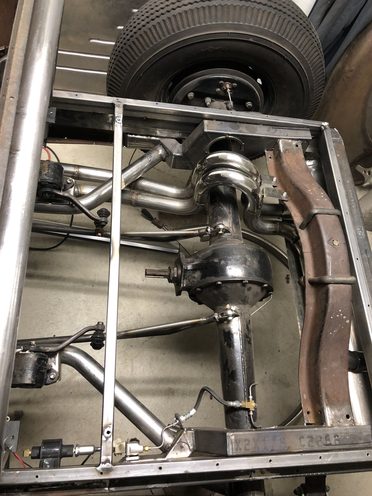

    10CCD53F-1333-42A8-A7F9-54E4C86D0A47.jpeg 4FAF48E1-DE18-4BE2-A201-DE41E17DB4C0.jpeg 356B0186-3AF2-4252-B8AC-C51B879D0B41.jpeg FF9AC9F8-CA30-4AD8-BA4C-8EA8F397A337.jpeg 3CD36A38-A5FC-4020-996A-4C3E1B5D0E6E.jpeg 6DD108AC-58AC-4578-8123-DC9943331D92.jpeg 473657DC-FA36-47CA-96AC-A31F6B4F636B.jpeg And just as quickly as I ****oned it all up it starts crumbling apart. Getting it all down so I can blast it and start body and paint!

    Looking good, love seeing the shots of the ch***is minus the body. Lots of a little tricks going on there. Thanks for the update

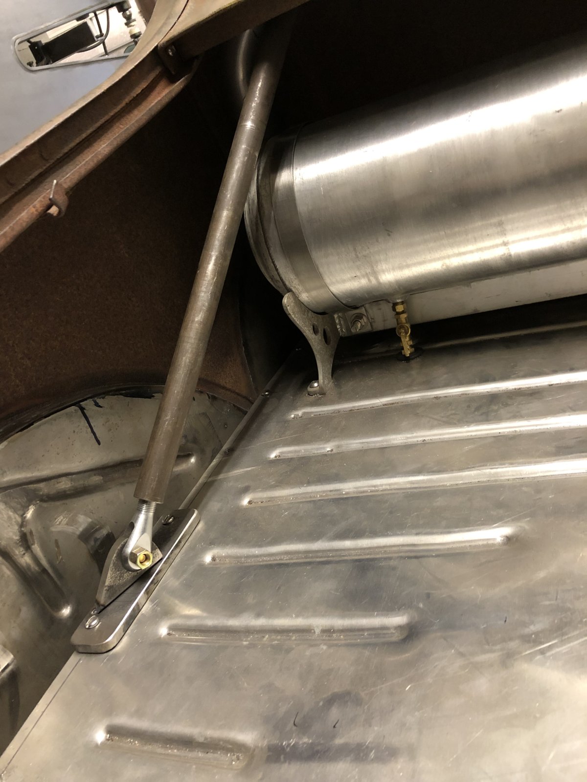

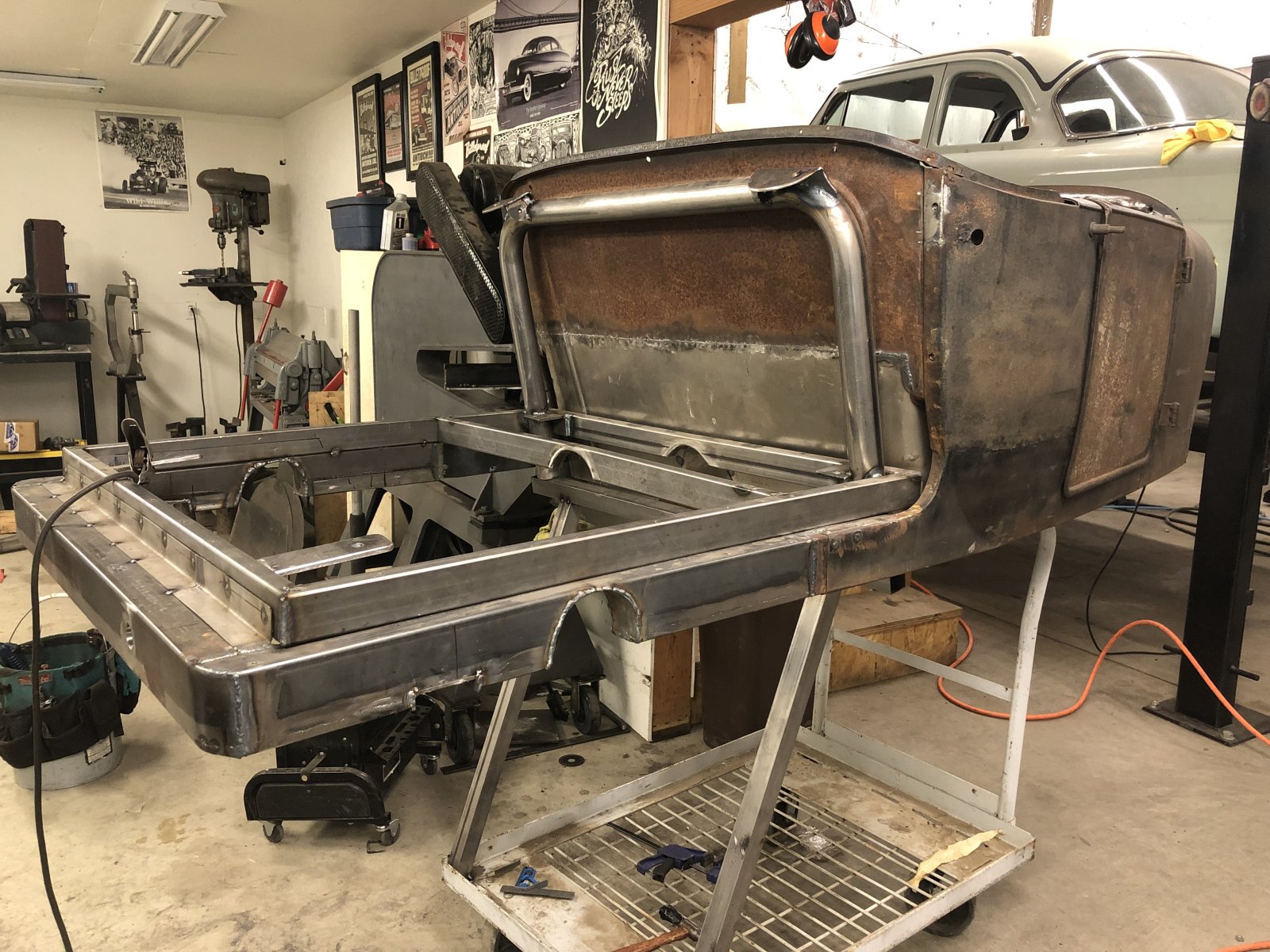

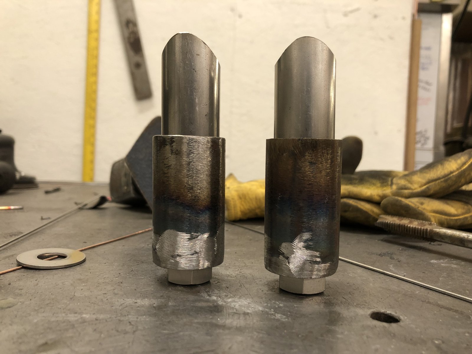

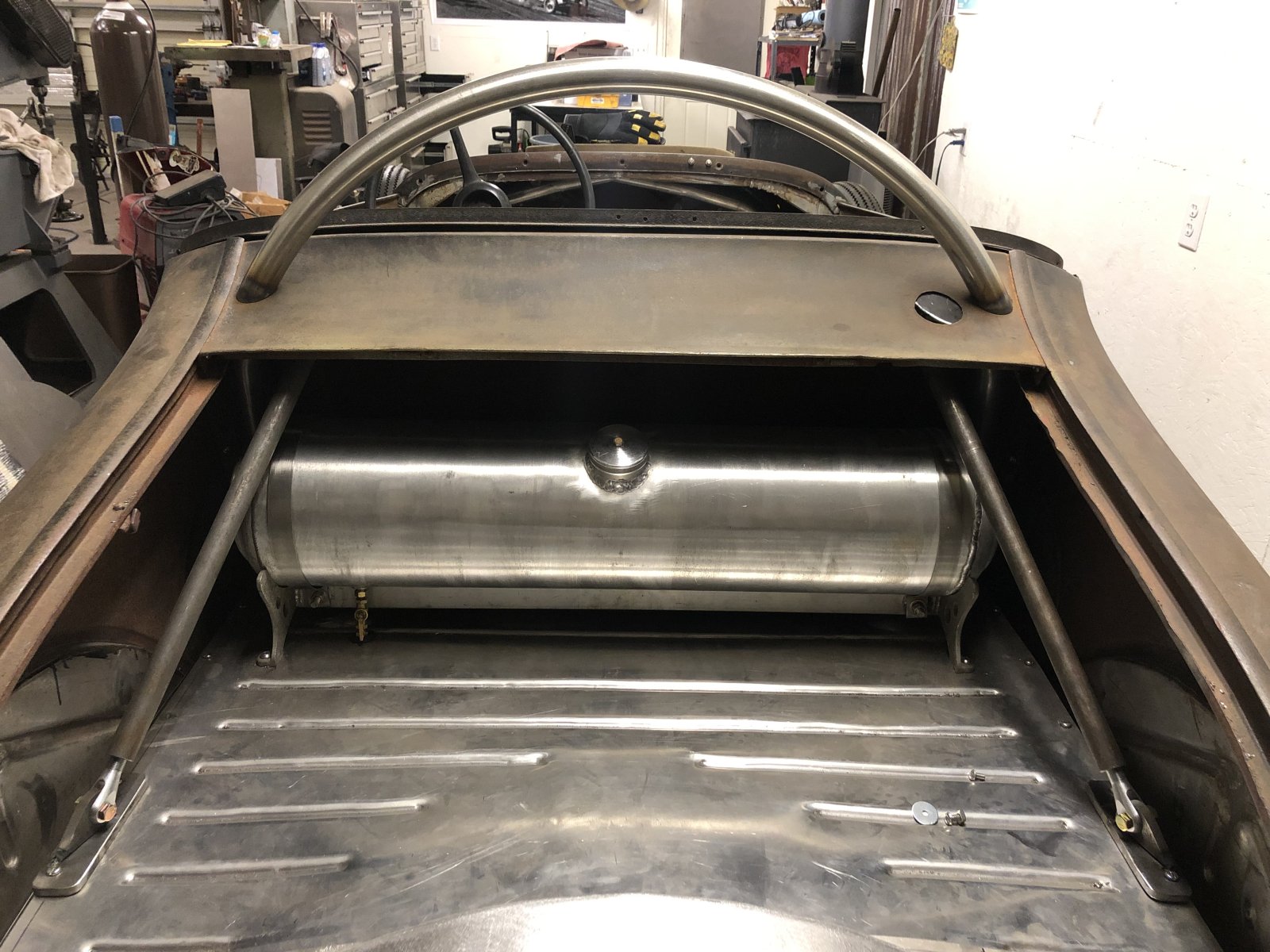

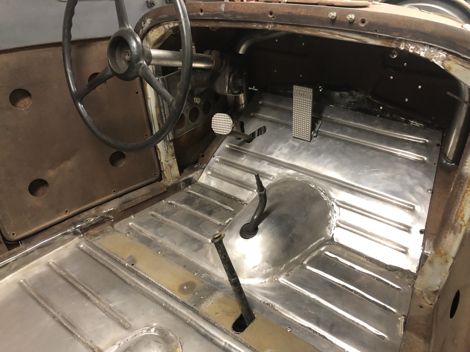

  25. I love the braces. And props for tacking that tab the RIGHT way. Jut a simple tack on the ENDS so you can run a nice bead along the side and around the end. Pro tip from my friend a pro race car builder. Dont weld it solid down both sides, just wrap your bead around the end and back about a scoche on the back side.
    Stogy likes this.
  26. Ziggster
    Joined: Aug 27, 2018
    Posts: 4,585
    Ziggster
    Just came across this thread. Great build. Looking forward to the finished product.
    Stogy likes this.
  27. flyin flattie
    Posts: 602
    flyin flattie
    from Redmond OR
    Hey T man I agree! What I like to do is tack it, fixture it’s on my little fixture table and weld both sides one right after the other so the heat fights each other while the fixture holds it steady. That only apples to 3/8 + If it’s 1/4 or thinner weld one.
    Stogy and Tim like this.

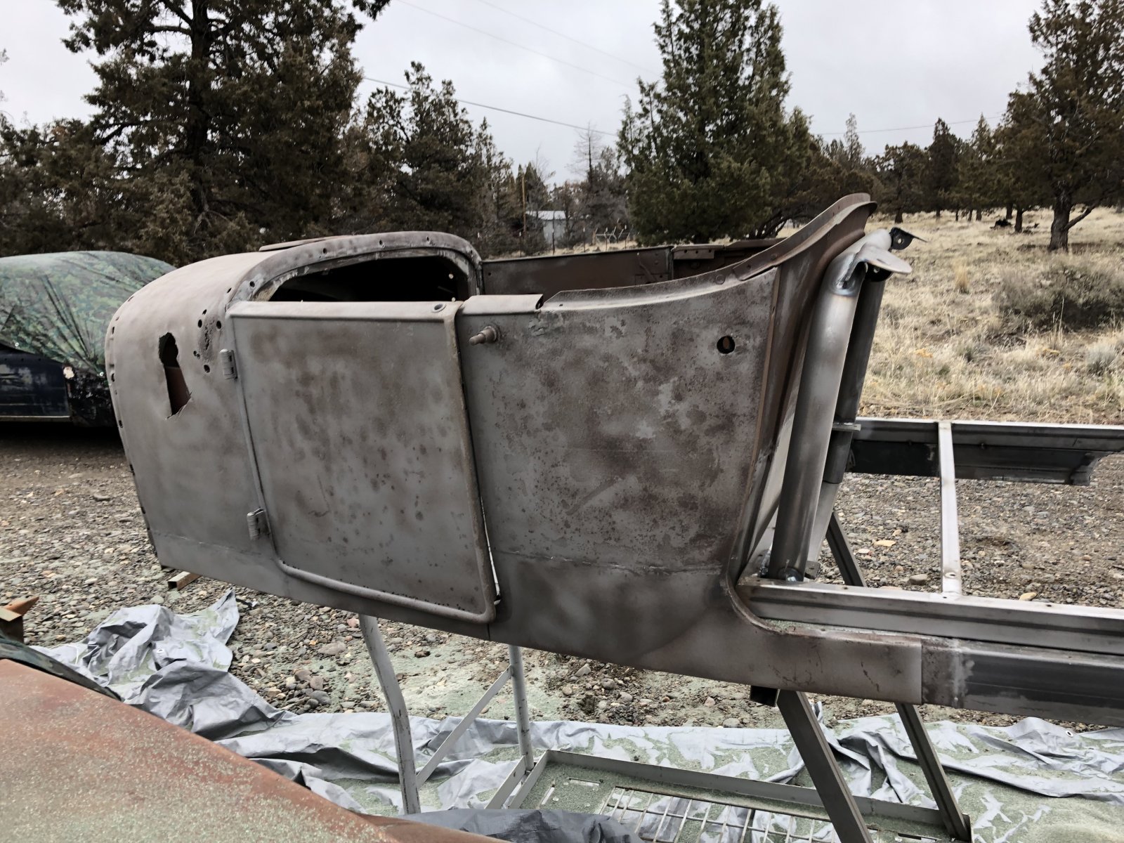

  28. flyin flattie
    Posts: 602
    flyin flattie
    from Redmond OR

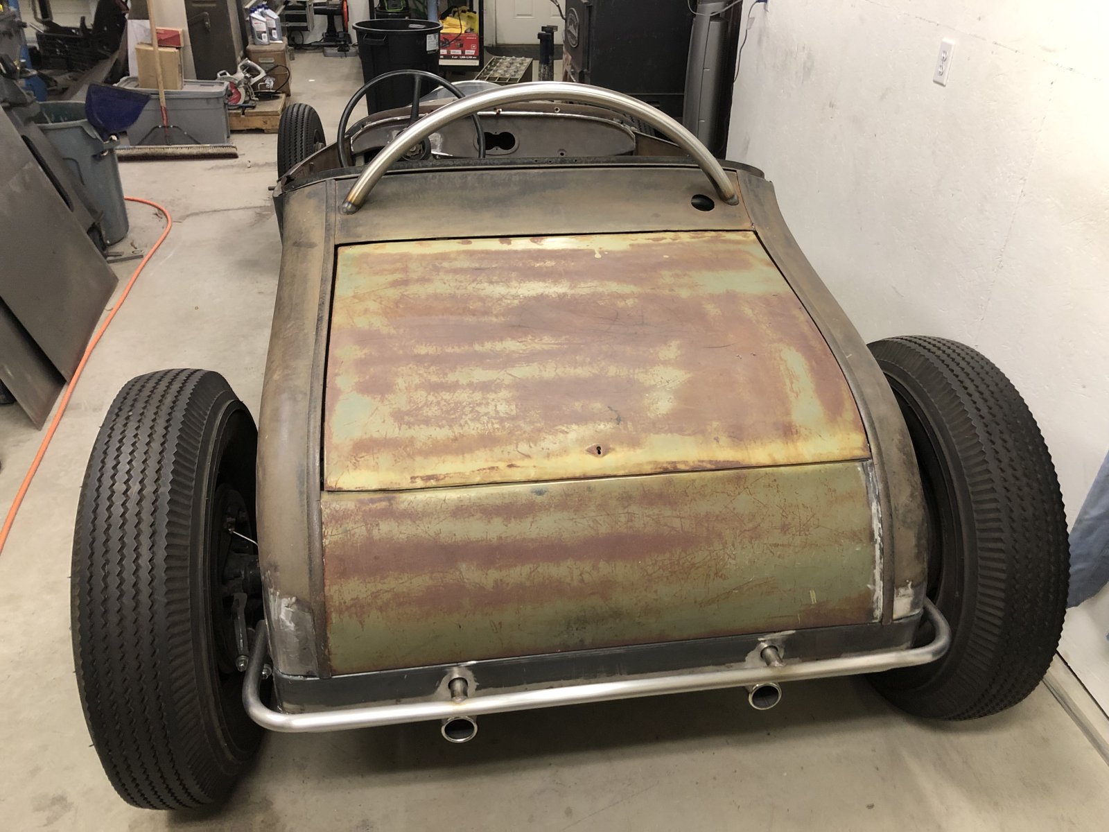

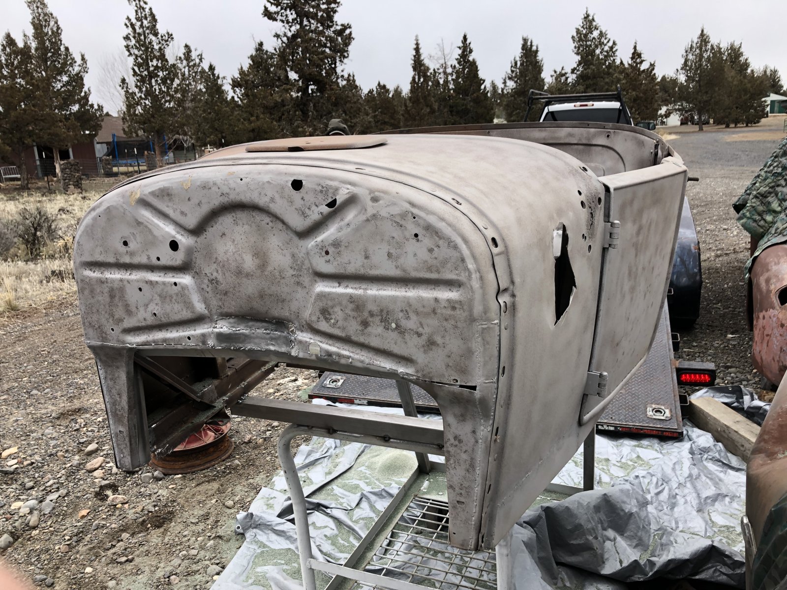

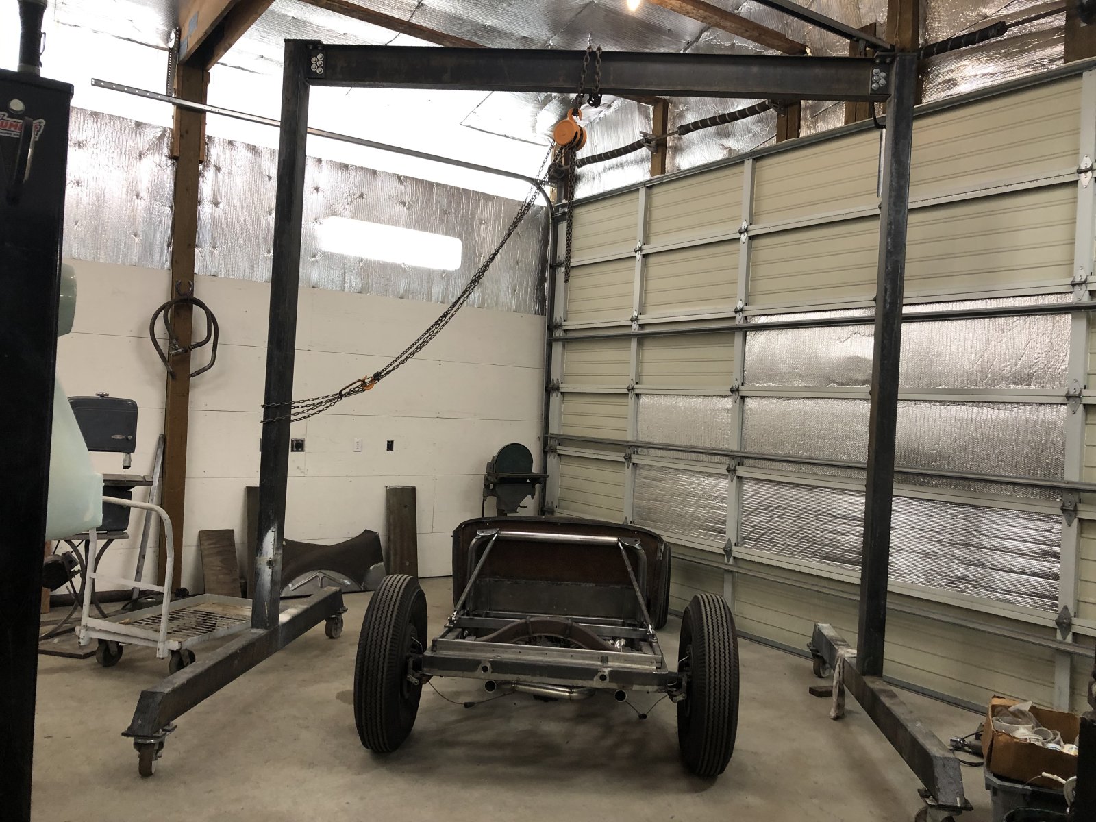

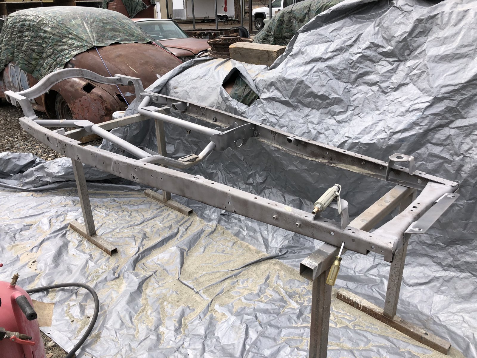

    The almost 100 year old body got blasted and almost finished today. The frame is ready to start welding everything up!
