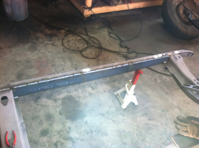

    Not much to show, but it's exciting to me :D. Frame is mostly boxed in so next step is to grind and smooth the welds and then figure out the kickup in the back.

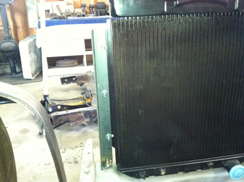

    I cut the grill shell at the bottom to bring it down two inches so that the top is in line with the top of the cowl. Then got the radiator supports made and bolted on. I just need to make the tabs to mount the shell to it.

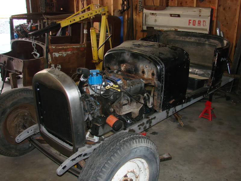

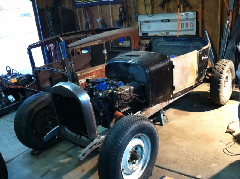

    A couple of weeks ago I went to the junkyard to get all the stuff to convert the motor back to a v belt (just need to get the alternator). With the mechanical fan in place we could start to figure where the motor is going to sit.
    Got the motor mounts made with the help of my friend Phil (he's doing the majority of the welding).
    When we first installed them they were flexing a bit too much so we added a little more strength across the top. They were much better after that. This is the first time I've ever made motor mounts and it was a lot of fun figuring this all out.

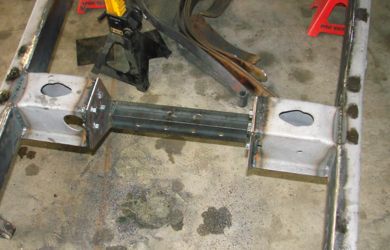

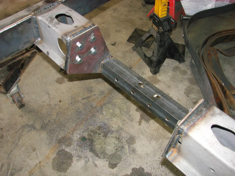

    We also got the transmission mount made, welded, and bolted up.
    It feels good to have the motor and transmission finally all bolted in!

    Sweet. Love that drop out trans cross member. Great bit of forward thinking right there. And the engine mounts are nice, simple and strong looking.

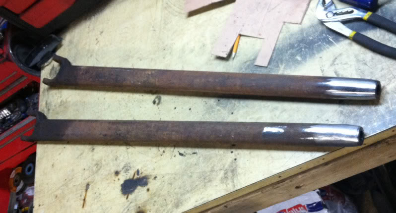

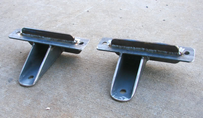

    I was able to get a bit of time to get a few things done today.
    Got the front wishbones split and the bung welded in.
    Also got the hangers made for the rear spring, so I can start to figure out the back end of the frame and get the ride height nailed down.

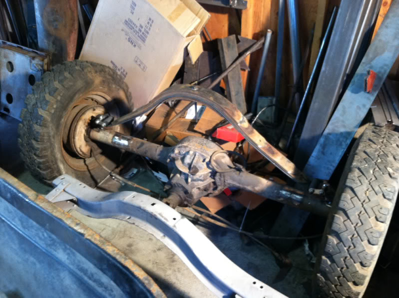

    Today I messed around with the spring pack in the front to get it sitting where I want it to. I have a reversed eye main spring that I got made and then the next three longest leafs.
    After that we tacked the rear spring hangers on real good. Then put the rear spring pack on. We lifted up the rear end and bolted it in place. With most of the weight of the car it gave us the measurement of where the rear crossmember is going to sit, so now we can start working on the rear kickup. The crossmember was looking pretty twisted but once we cut it out of the the rear of the frame it popped back straight. Looks like the rear kickup is going to be right about 6" and the wheelbase will be about 91".

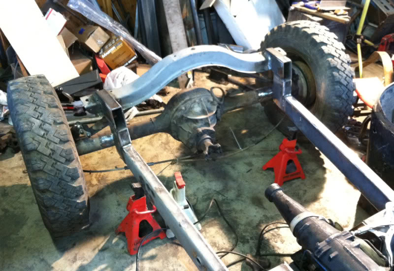

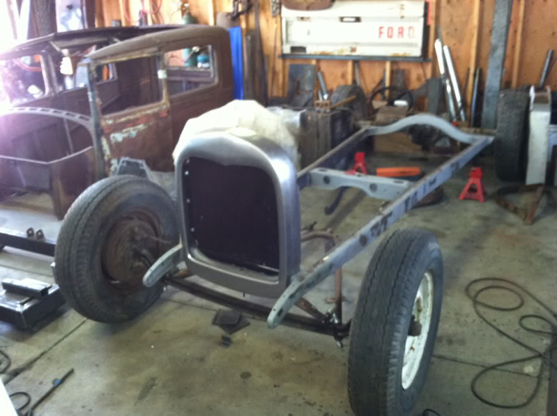

    This weekend I got the rear kickup welded in. I still need to make block off plates for the tubing and do some bracing.
    This is the first time it's been up on all four wheels and rolling. It's pretty short with the wheelbase right at 91".

    nice stance, i'm thinking my wheelbase will be around 96 inches. what are your plans to locate the rear?

    I know you're planning to block off the ends of that rear kick, but make sure you gusset and fish plate it too. There's a lot of torsional force right there.

    silent rick- I plan on making ladder bars that point in towards the transmission, sort of like the Pete and Jake styled ones.
    daddio - I plan on both fish plates and gussets to add strength to the back.
    48bill- The radiator is from an early mustang and you can get one pretty cheap from almost any parts store. It's really easy to make some supports with a little bit of angle and some plate.
