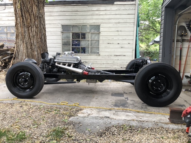

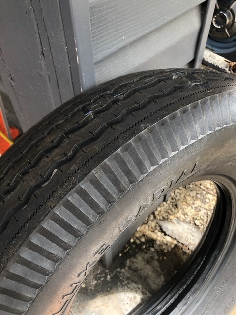

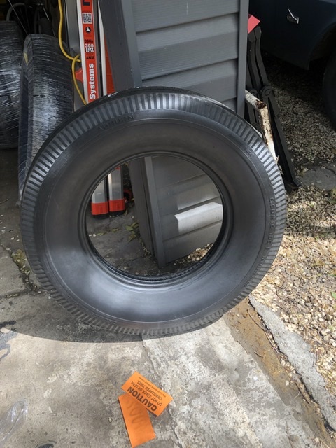

    New tires arrived today!!! I went back and forth a bunch on which tires to get. Finally, decided on the Diamond Back auburns with 650r16 for the back, and 550r16 on the front. The wheels are getting powder coated and should have them back in a couple days. Can’t wait to see it sitting on the right wheels!

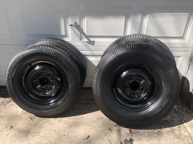

    Got the wheels back and the tires mounted. Really happy with the new look!

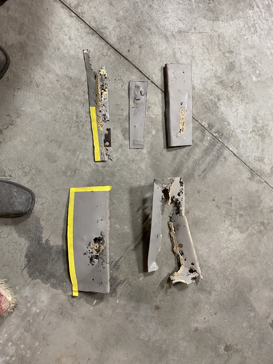

  3. kram
    Joined: Mar 16, 2011
    Posts: 124
    kram

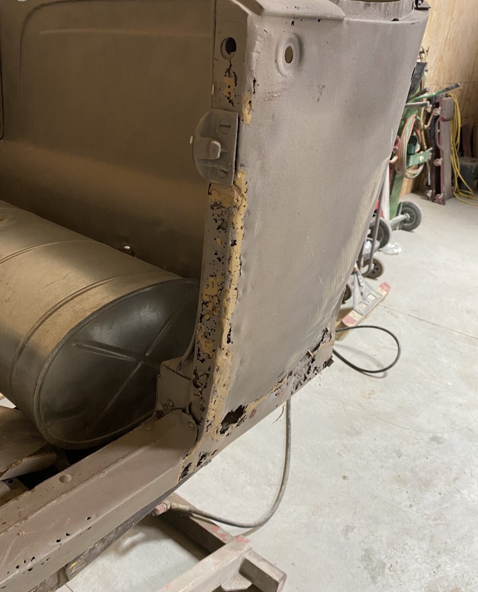

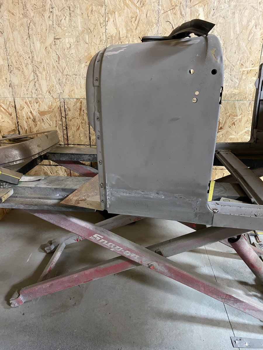

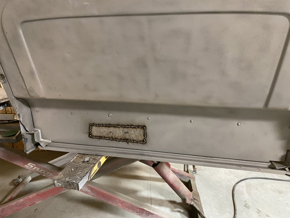

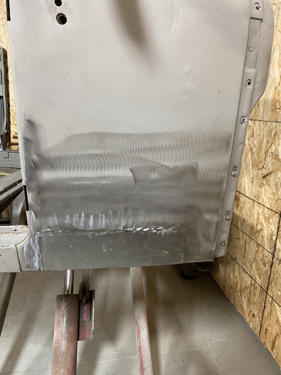

    Got a few pictures from my friend who is doing the body work. There was a lot of bondo and fair amount of br***, but it’s exciting to see progress!!! The color I’m going with is a Ford color called silvertone gray.

    Wow, I thought my "bun" panel was rough...

  5. kram
    Posts: 124
    kram
    Yeah, it was a real mess. There was br*** and then bondo on both sides, not a lot of metal was left down there. It's well on it's way to being solid again!!!

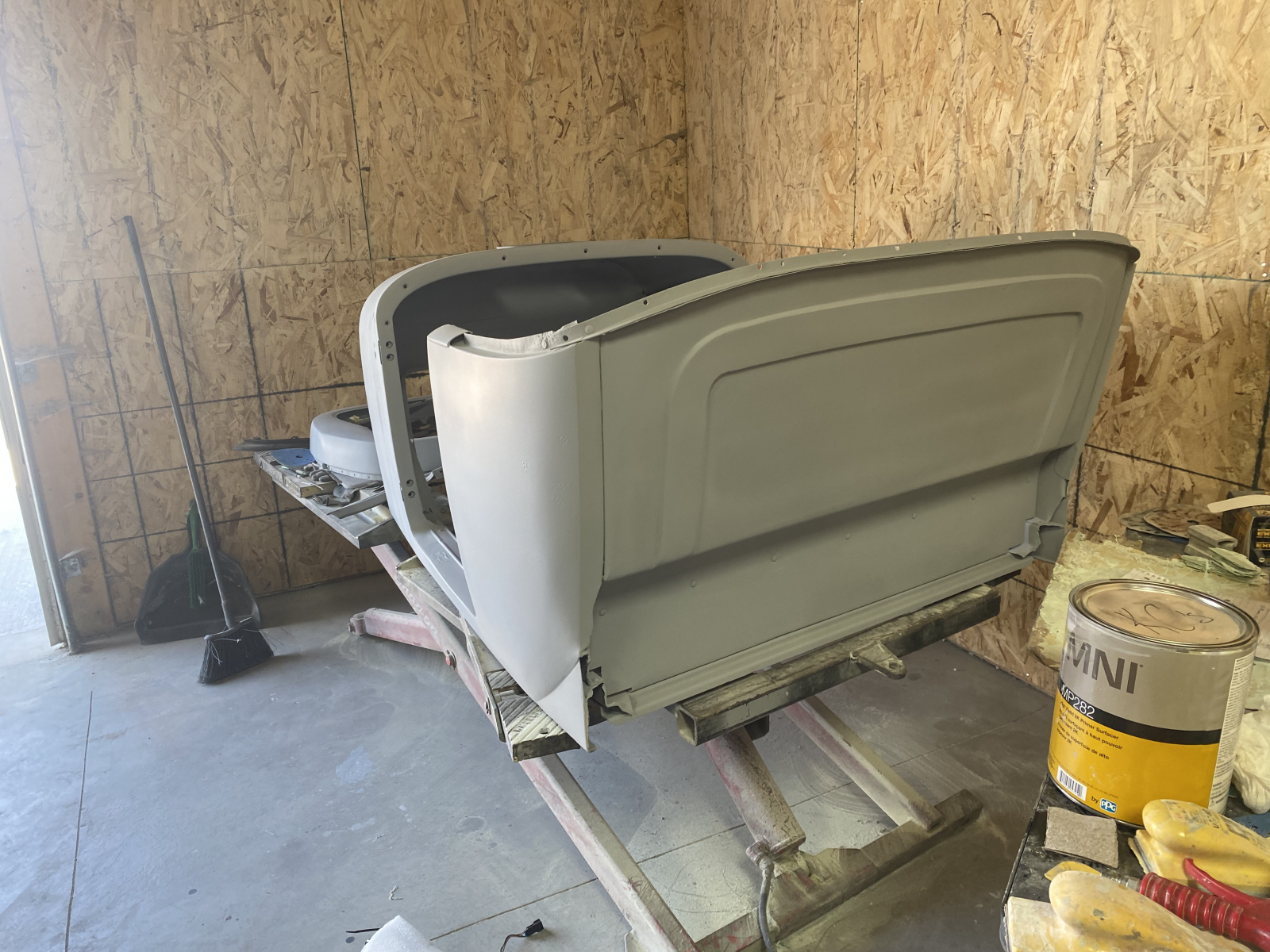

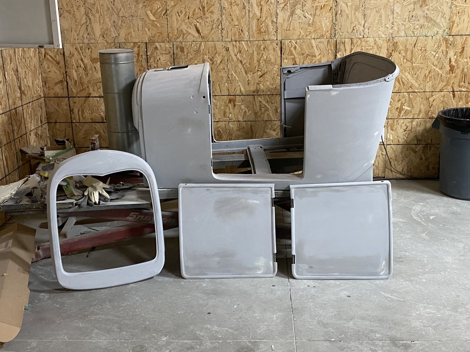

    It's hard to be patient. Got some updated pictures and the T has its first coat of primer. It's moving slow, but it's moving. It has come a long ways!

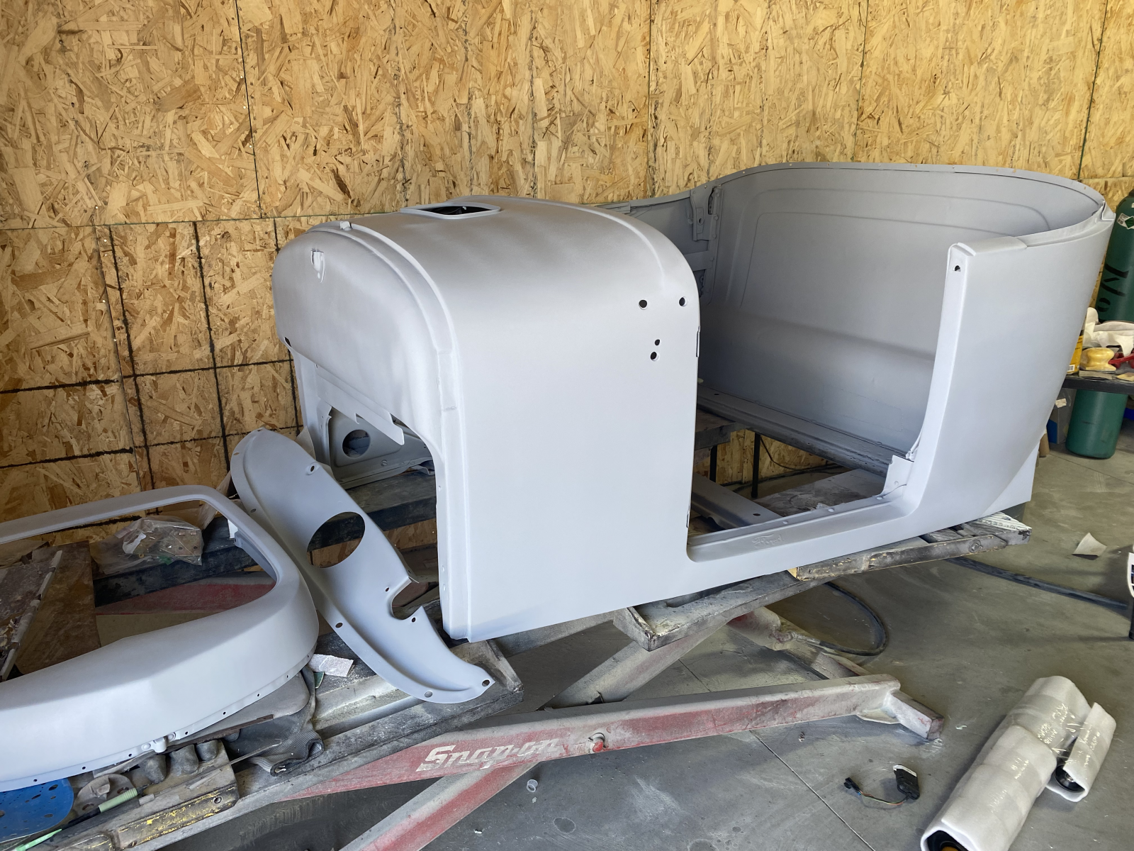

  8. kram
    Posts: 124
    kram

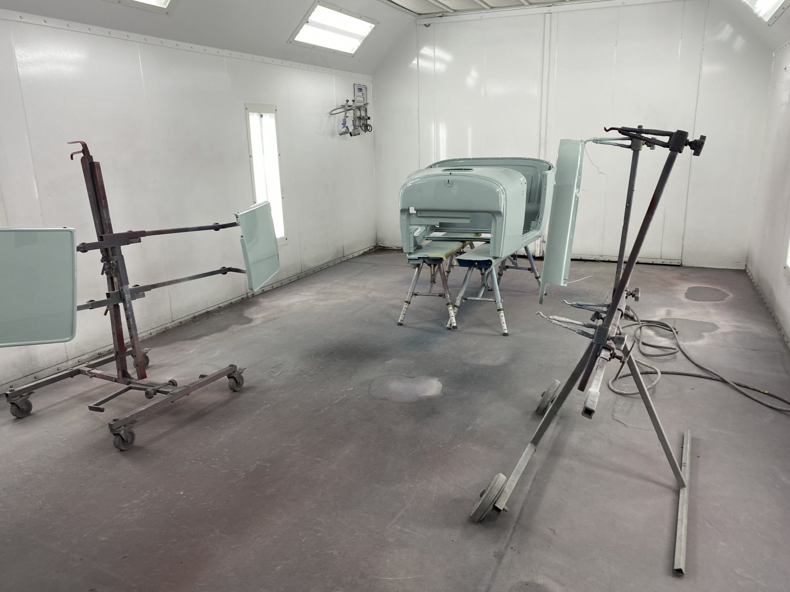

    8F17A783-1068-49C7-87BC-21CF09853EE2.jpeg Finally, it’s ready for paint!!! It’s taken a long time, but it’s looking fantastic. One step closer.

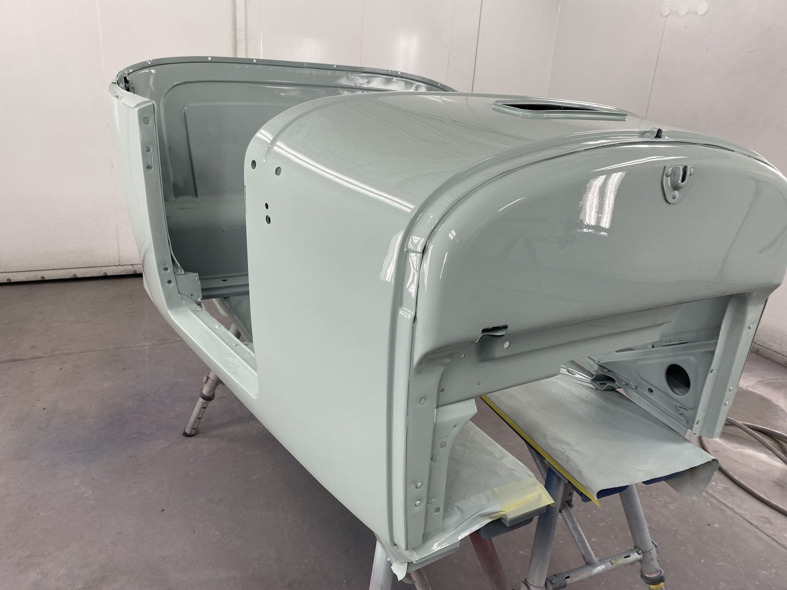

  10. kram
    Posts: 124
    kram

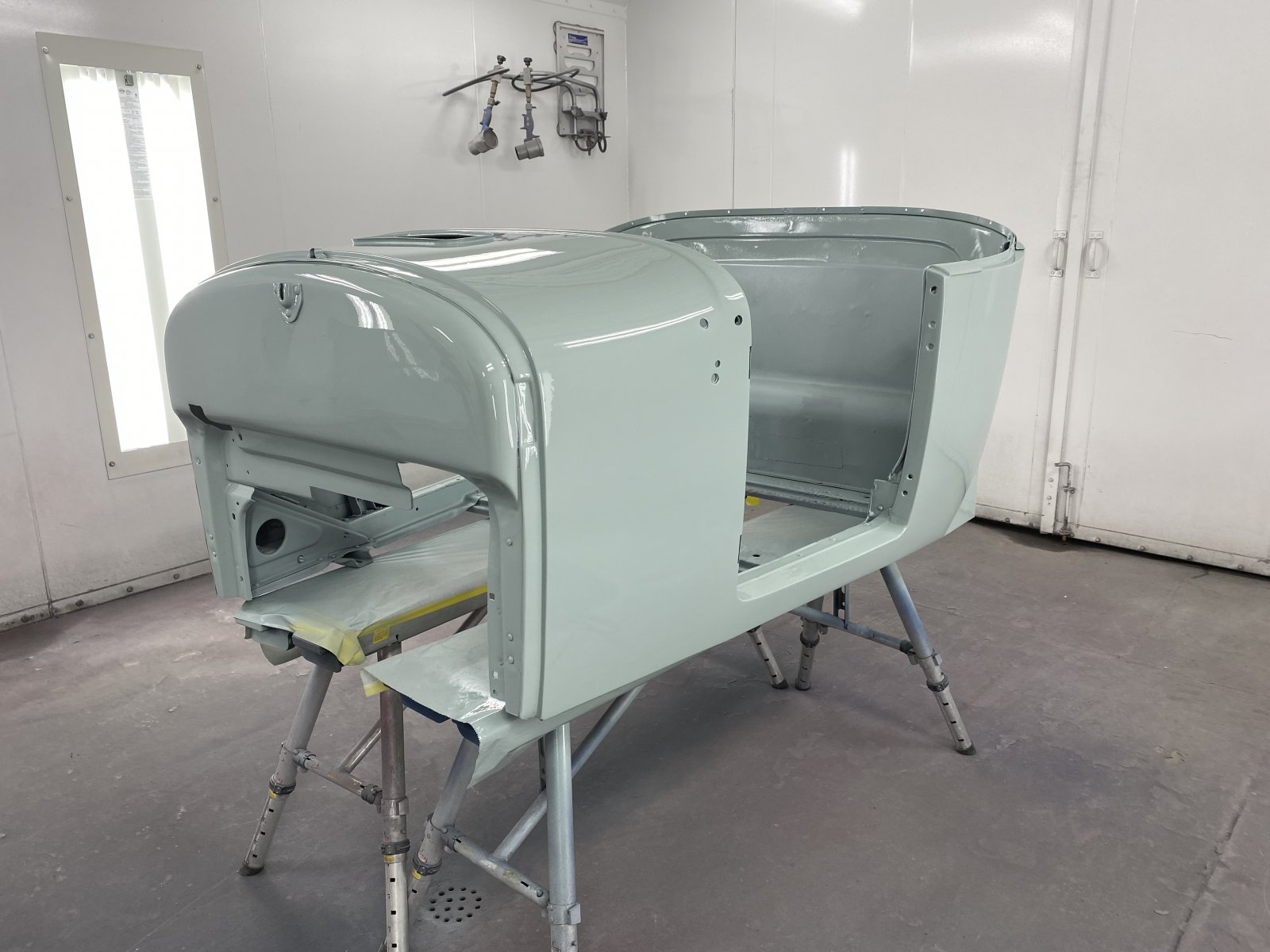

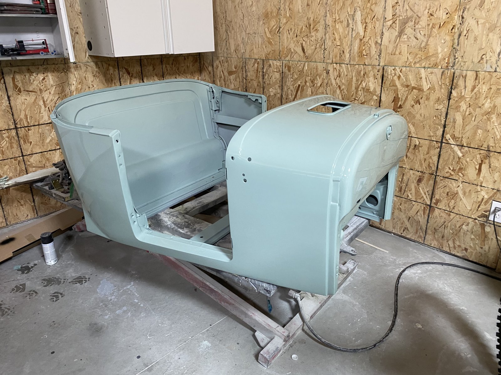

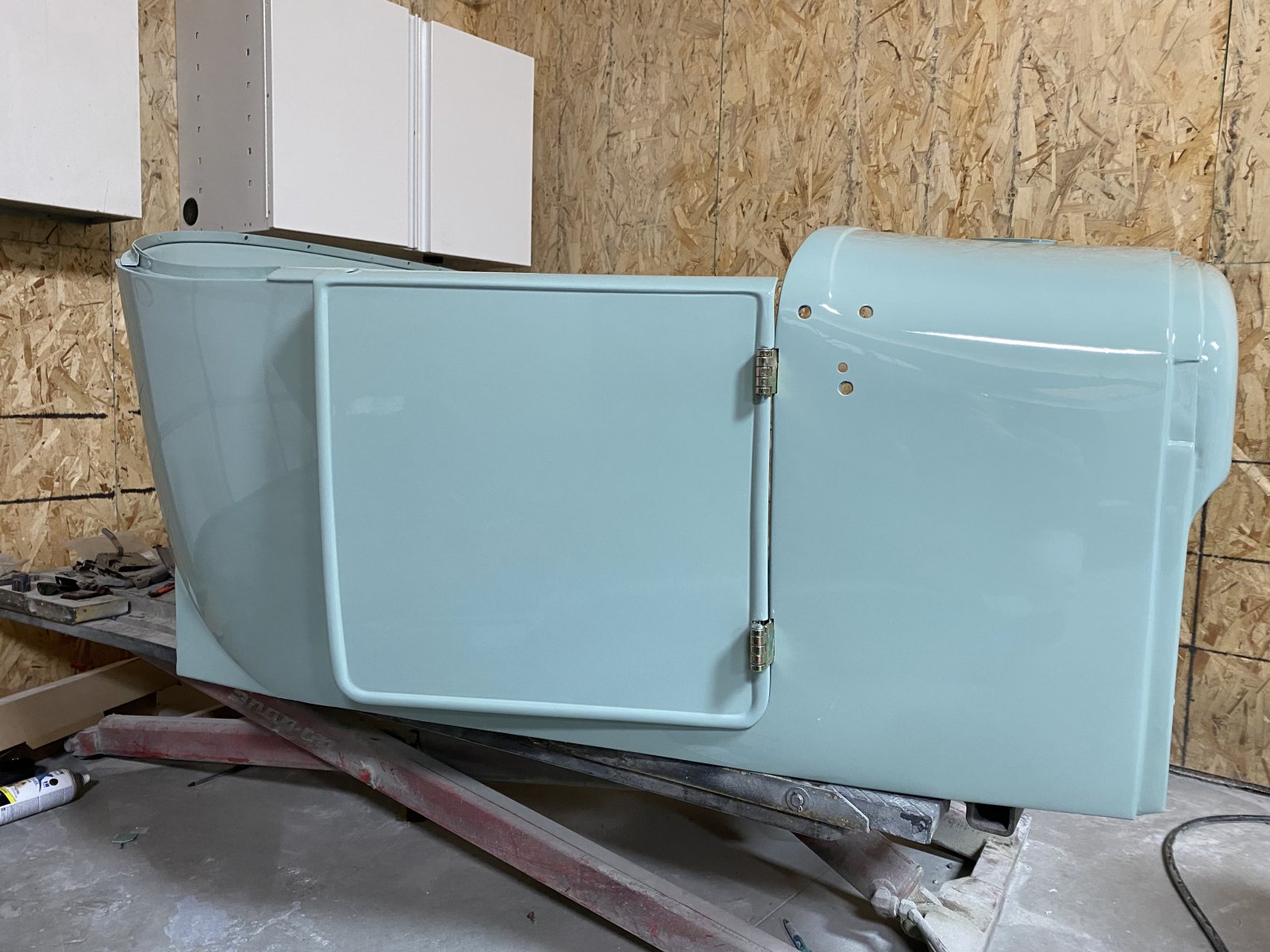

    Oh yeah!!! I got paint pictures today. This is going to look so good with all the black parts!

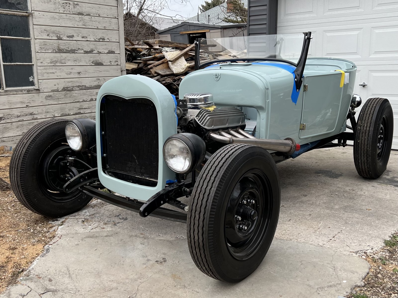

  14. kram
    Posts: 124
    kram
    Thanks. I like the color too. It's definitely different.
    Stogy likes this.

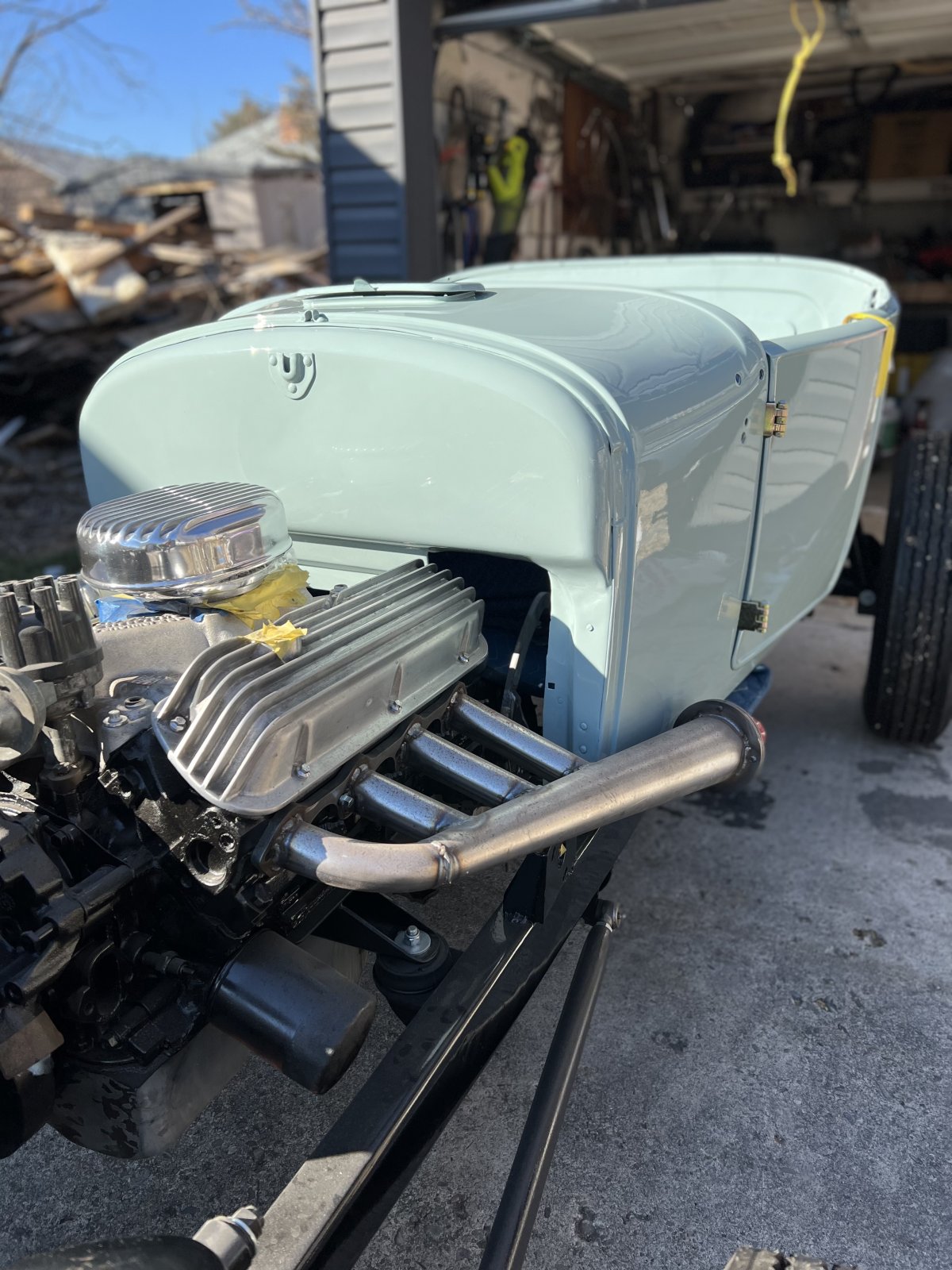

  15. kram
    Posts: 124
    kram

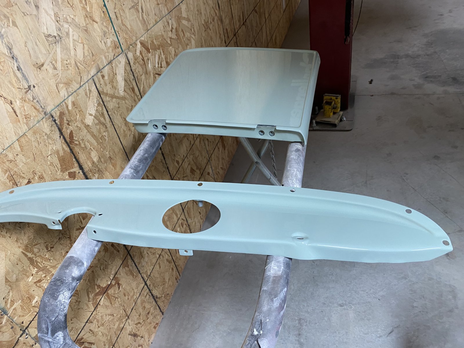

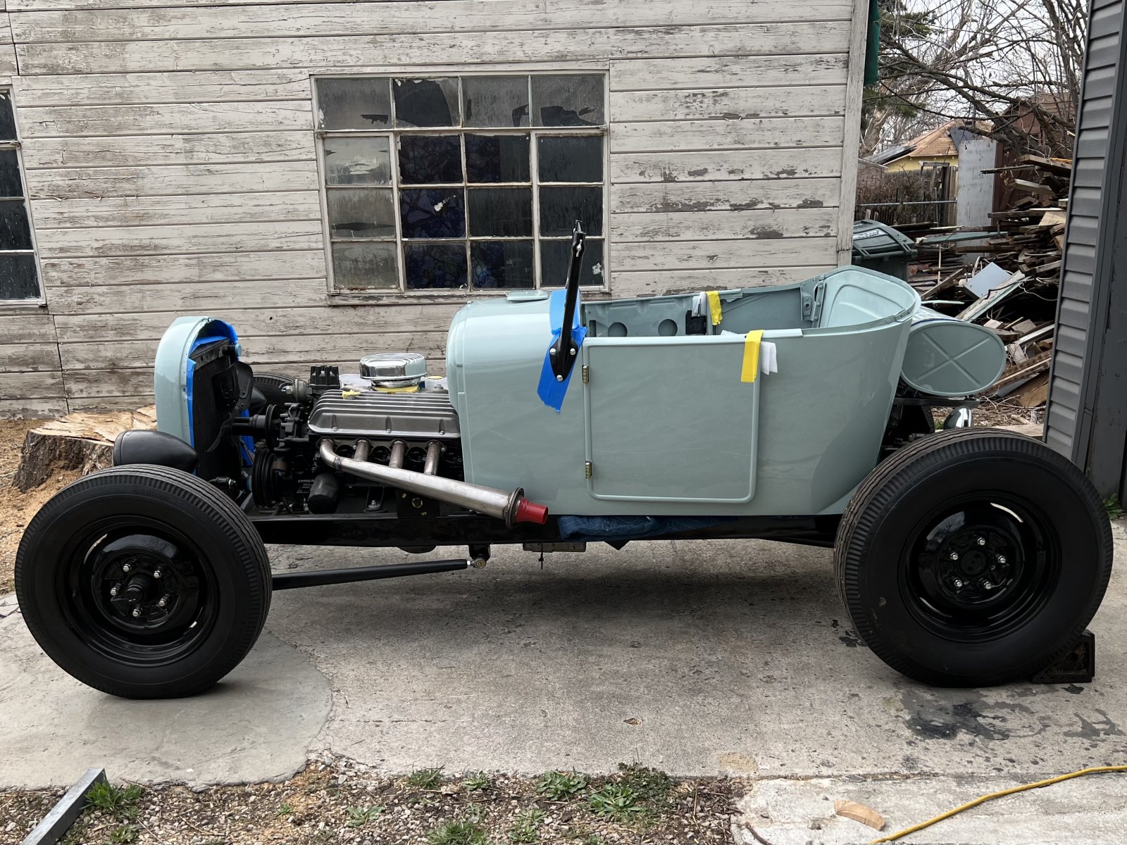

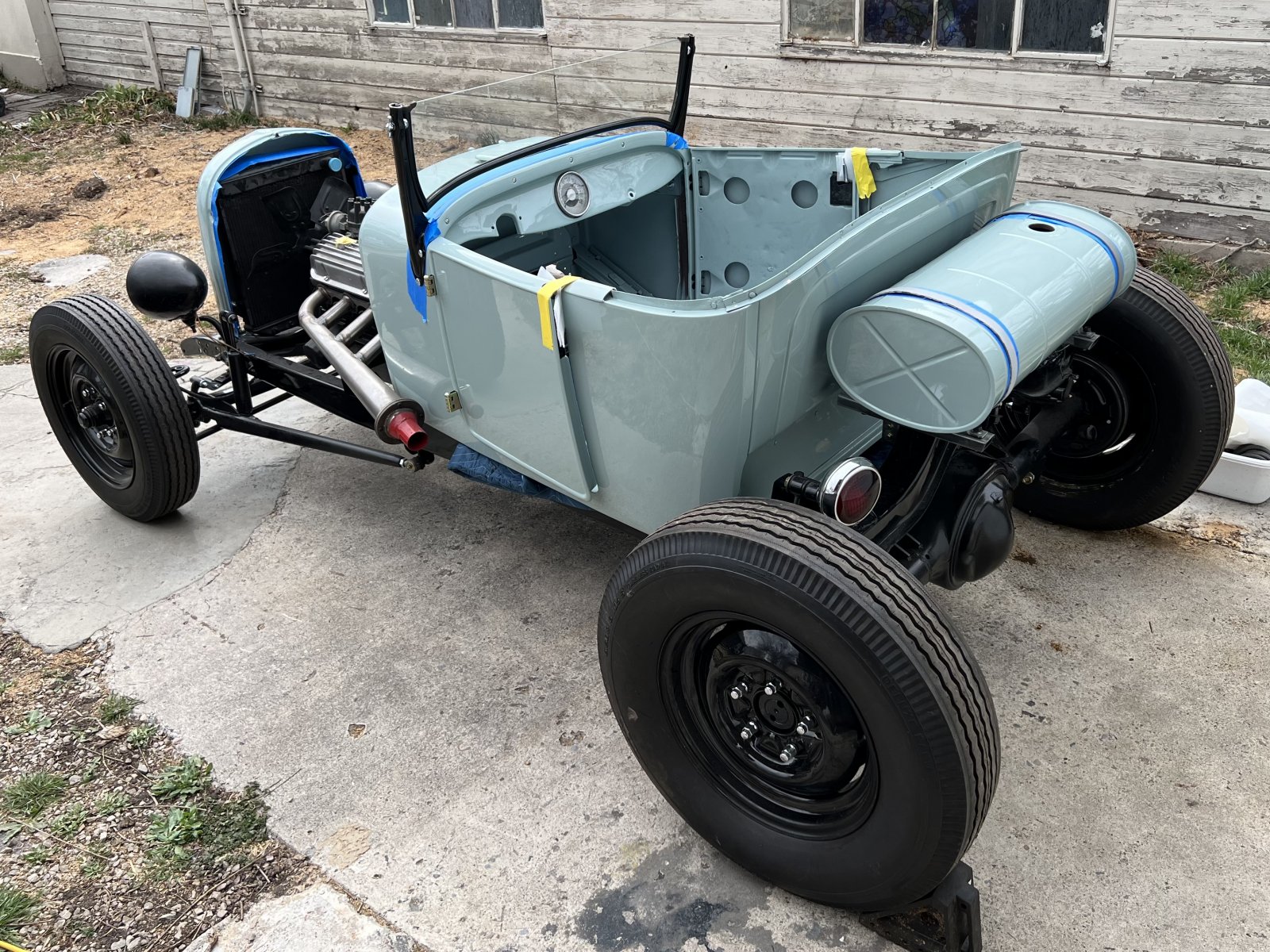

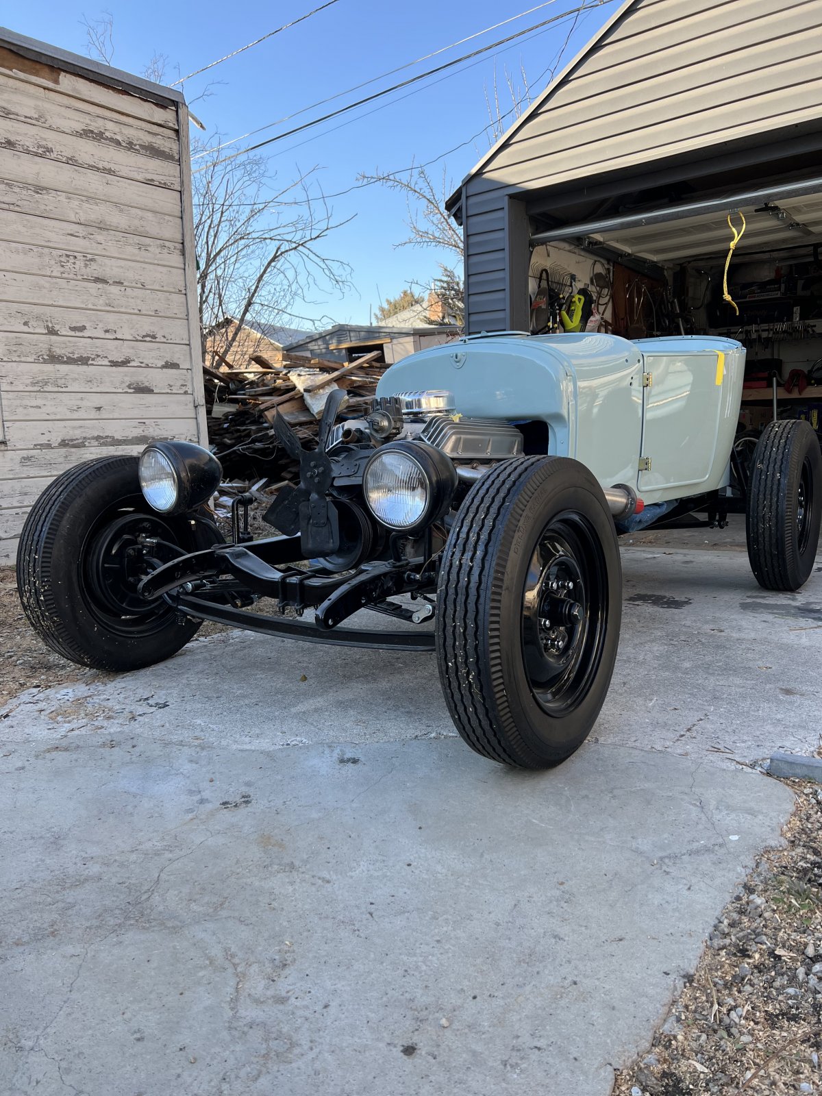

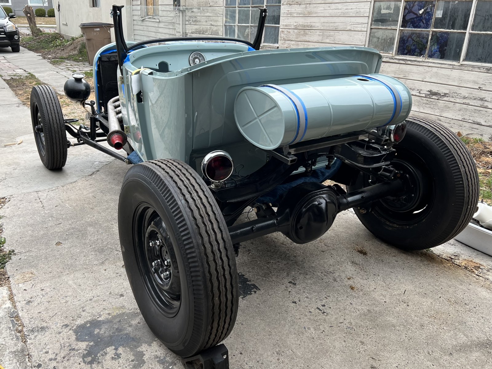

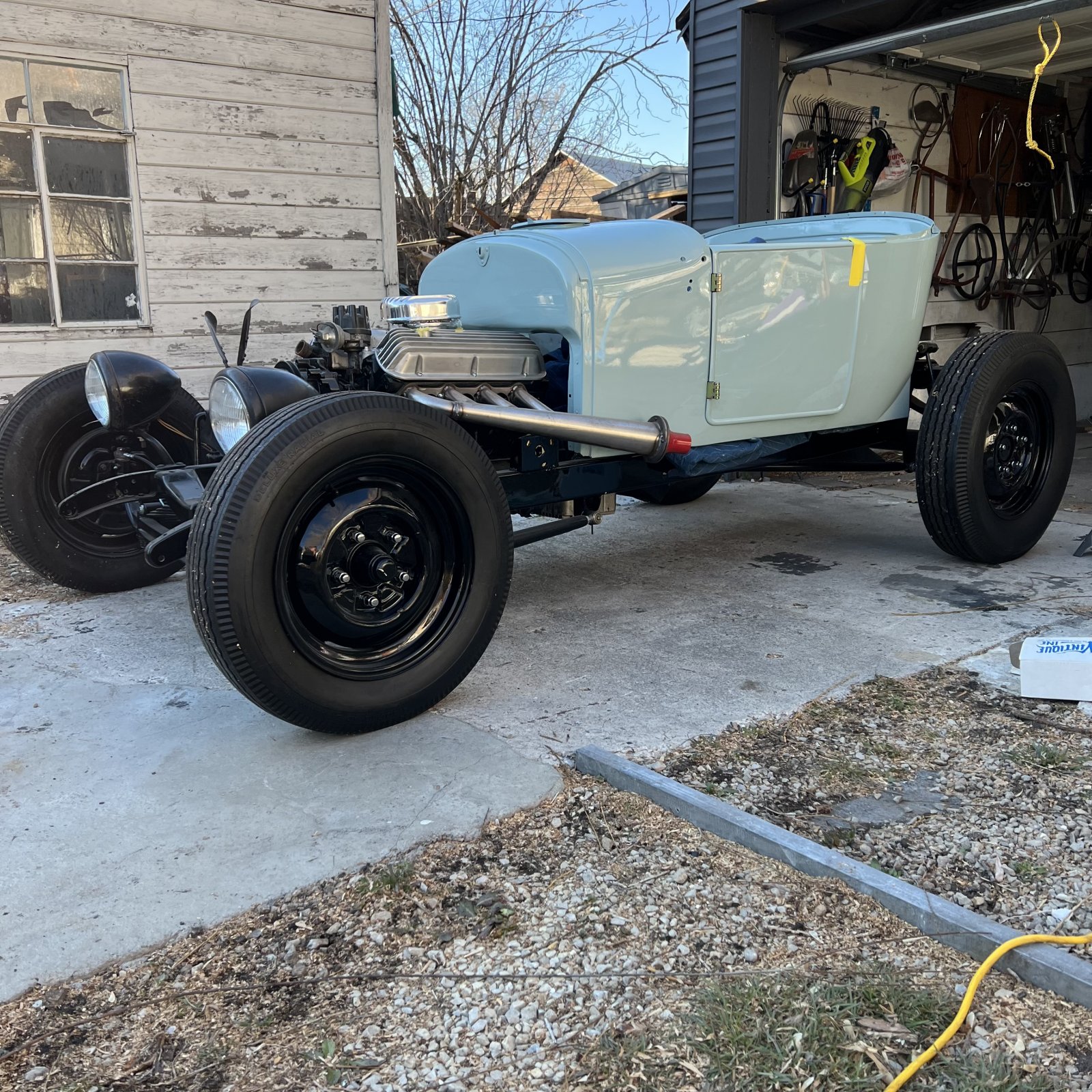

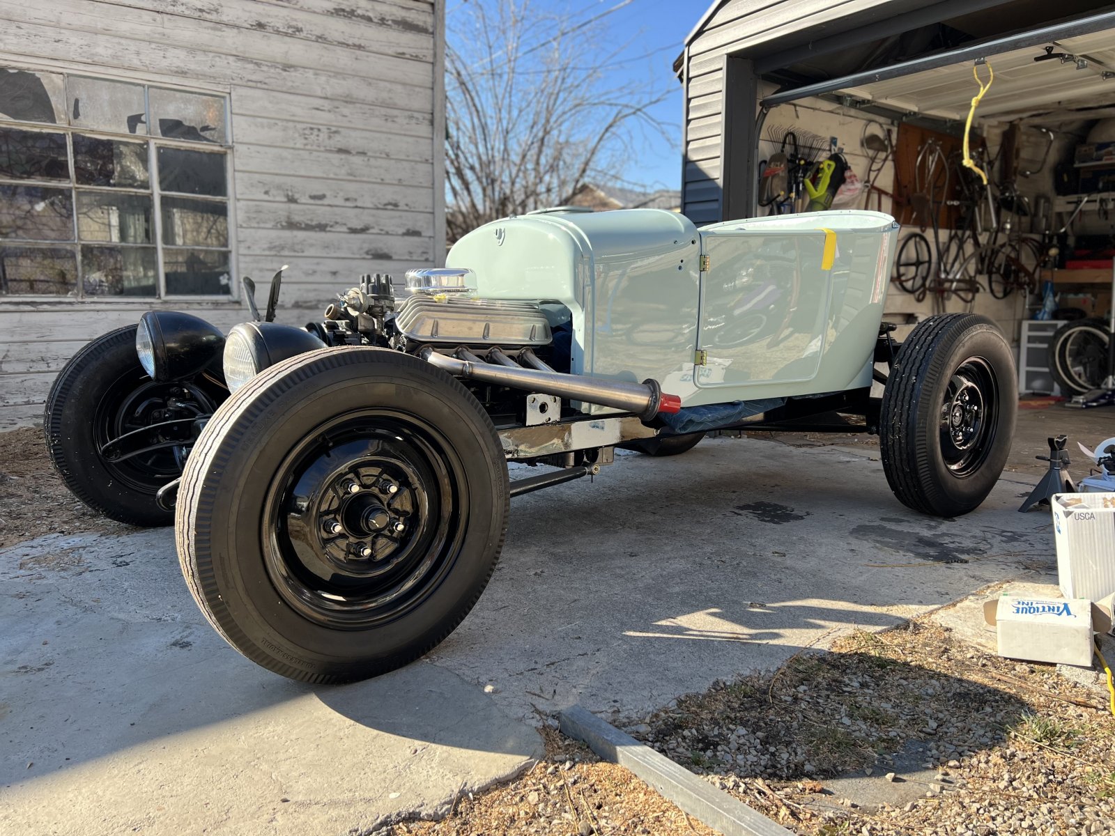

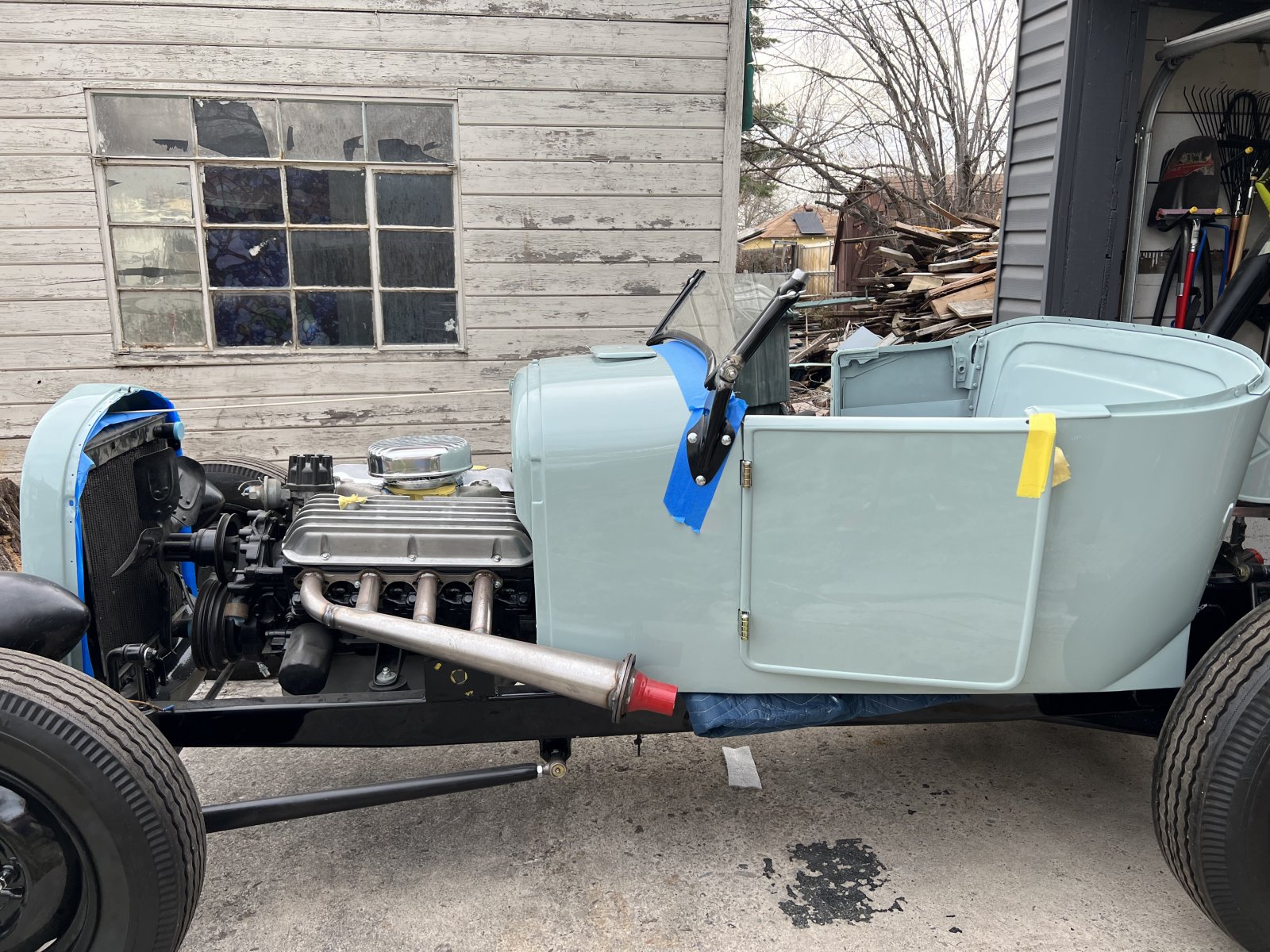

    Finally, the body and frame are back together. Even if it’s just zipped tied on at the moment. I’m really liking the silvertone gray against all of the black parts. The grille shell, dash, and gas tank all also painted in this color.

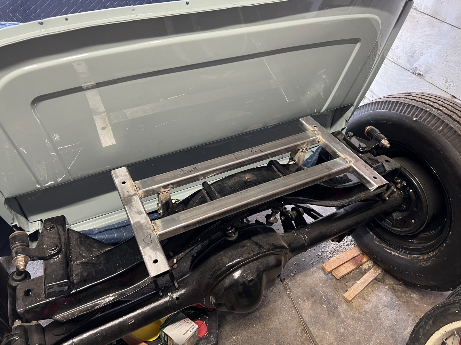

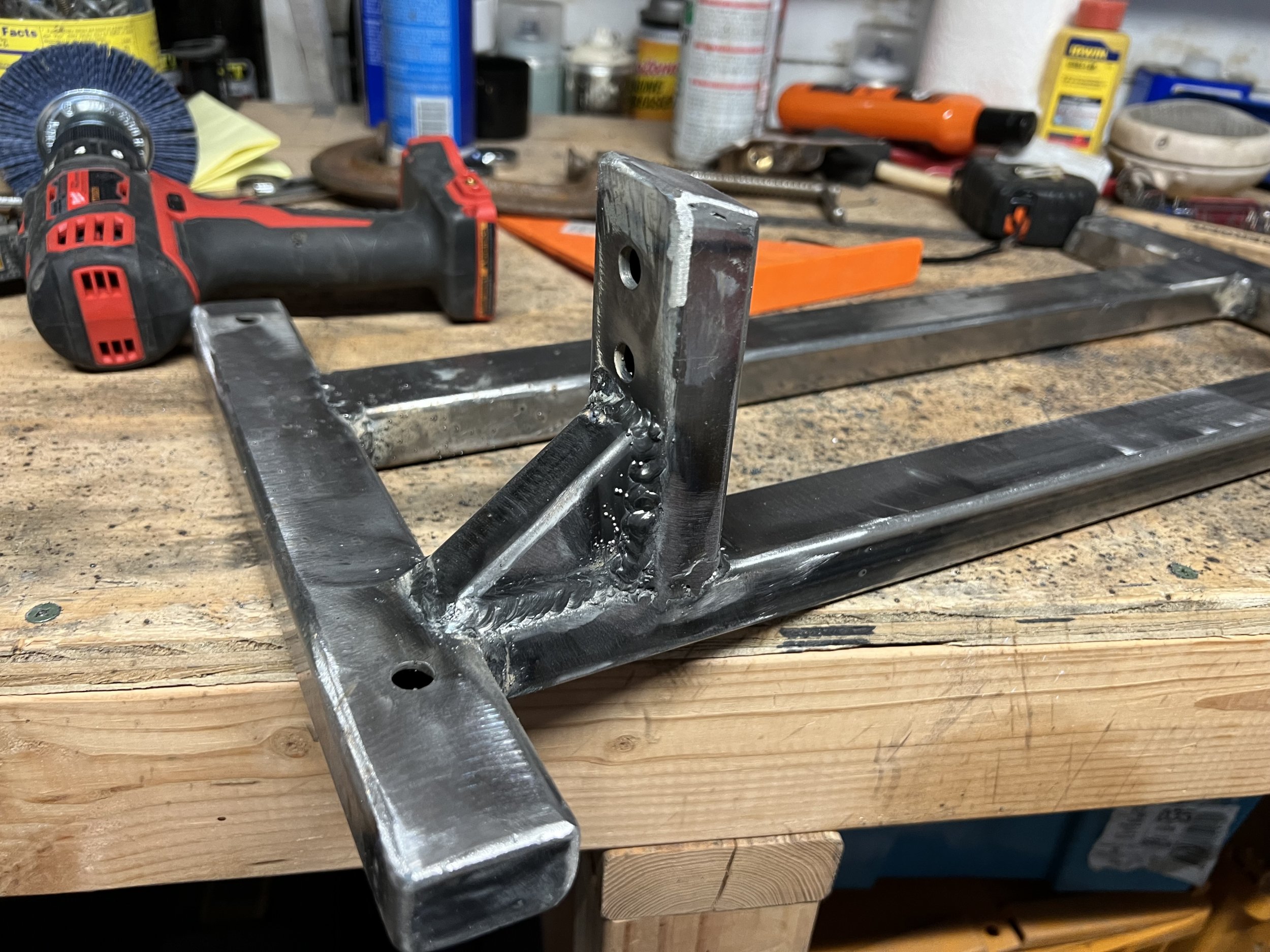

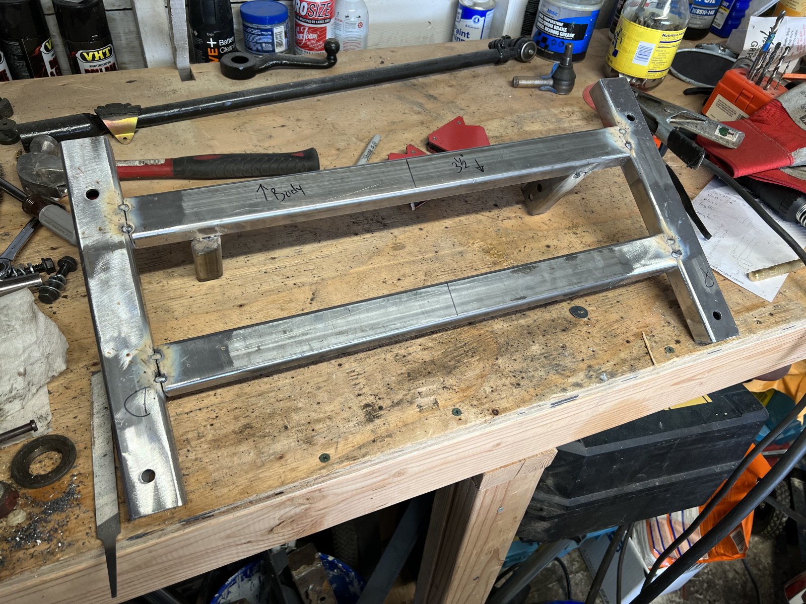

    This weekend I had a chance to get the mount for the gas tank made. I still need to finish up all the welding and paint it, but I’m pretty happy with how it turned out.

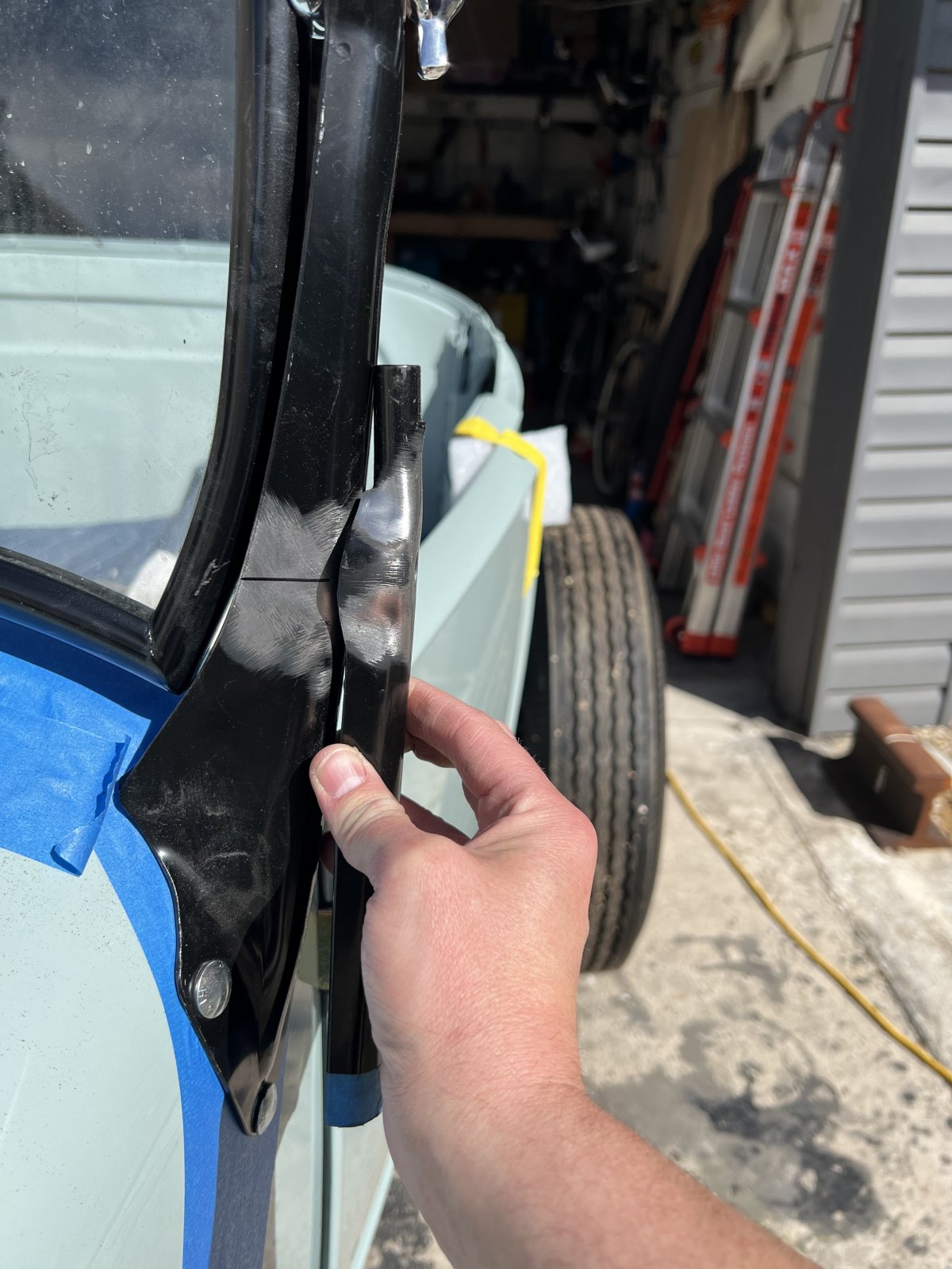

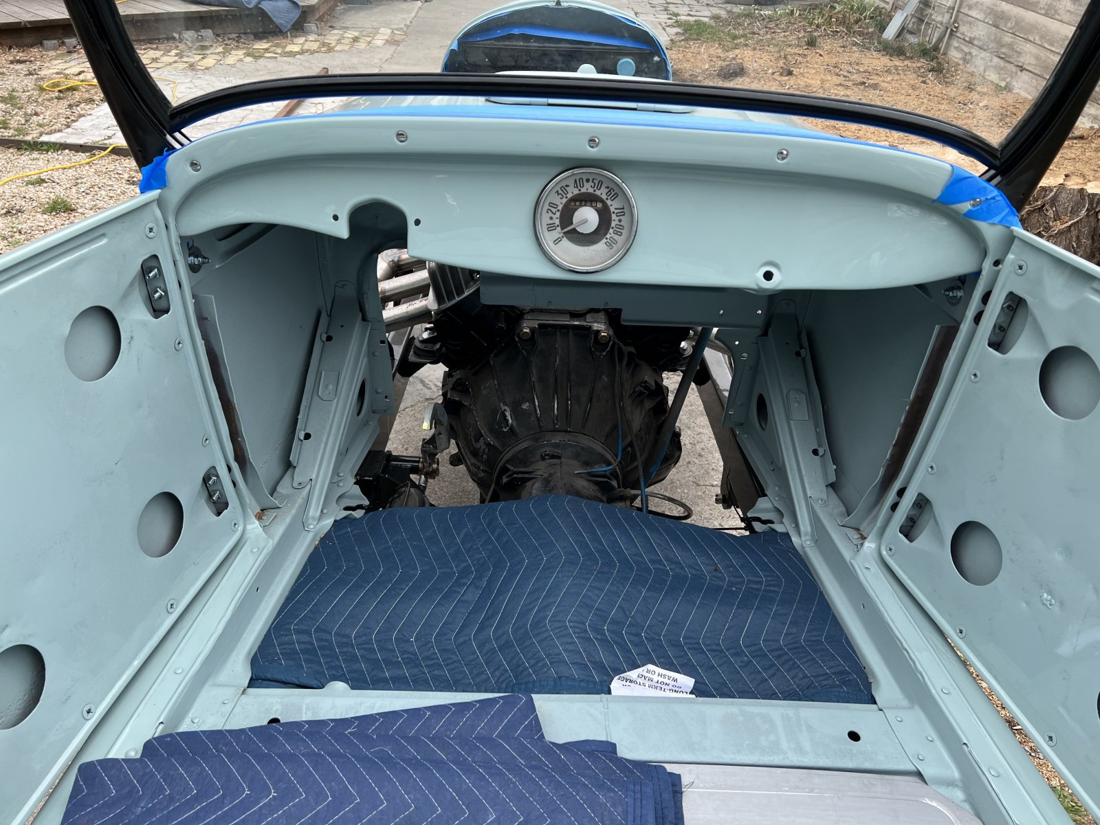

    It felt like I needed to get all the sheet metal mocked up. It’s been a lot of years since it was all together and I was concerned about the decisions I had made back then. One of my main concerns was where the radiator shell was sitting. The body will come down just a little when it’s permanently mounted, but I think everything is in a good place.
    Also, when I put the windshield stanchions on they weren’t even close to fitting on the body. Some time with a bench vise and large crescent wrench and I’m very happy with how they are fitting now.
    2C0C7B51-6DFC-4E9A-BA1F-2921CC65B7BB.jpeg C2B6463B-DA5D-4448-BC1B-28927C571802.jpeg 3FDC6FE6-BFB0-412F-9649-A89D60BC1CA6.jpeg 1C49A65B-AFE7-419D-8189-8E84D0A16250.jpeg B3CB813F-B7F8-48C4-9FE1-338043AD2CEE.jpeg

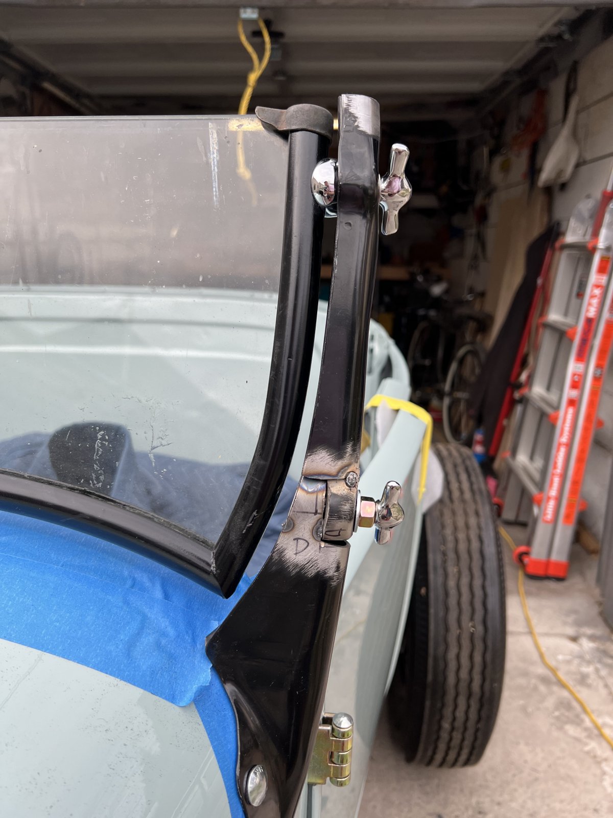

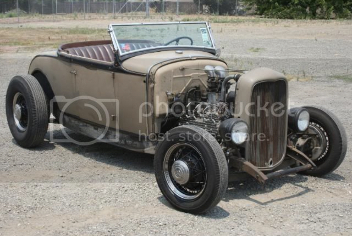

  25. kram
    Posts: 124
    kram

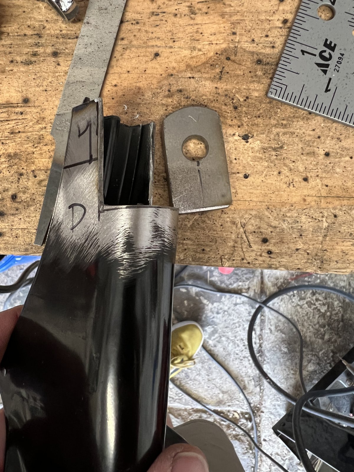

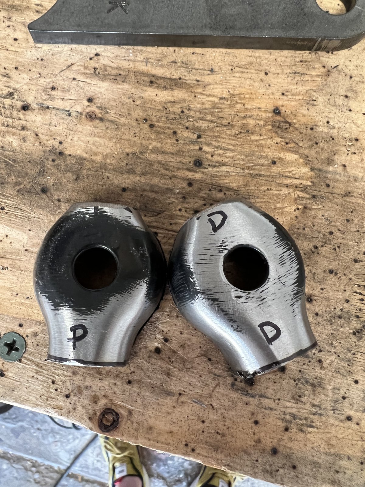

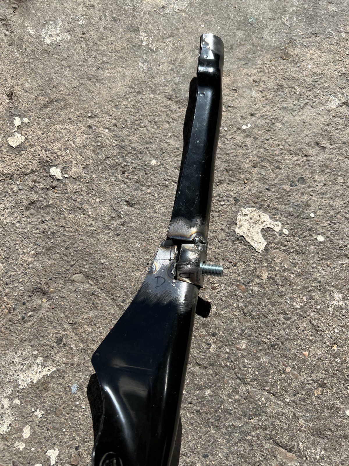

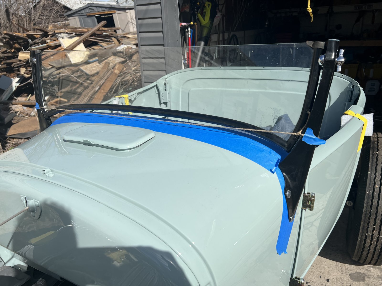

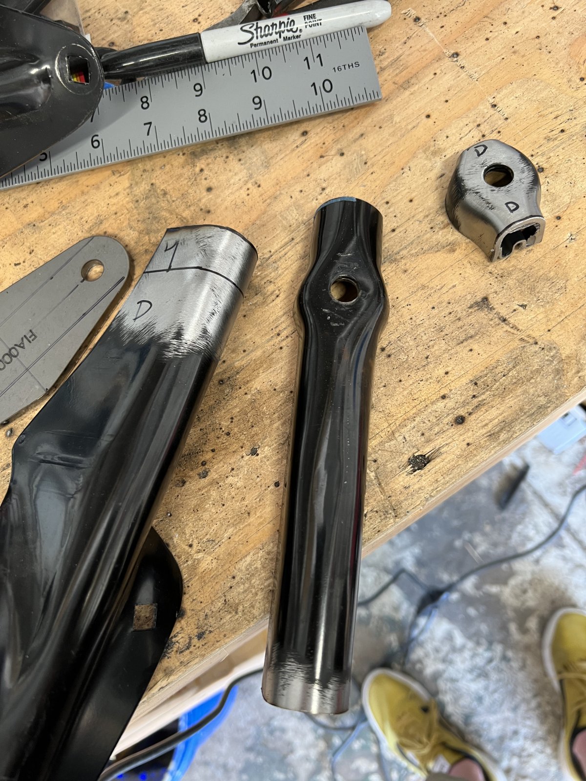

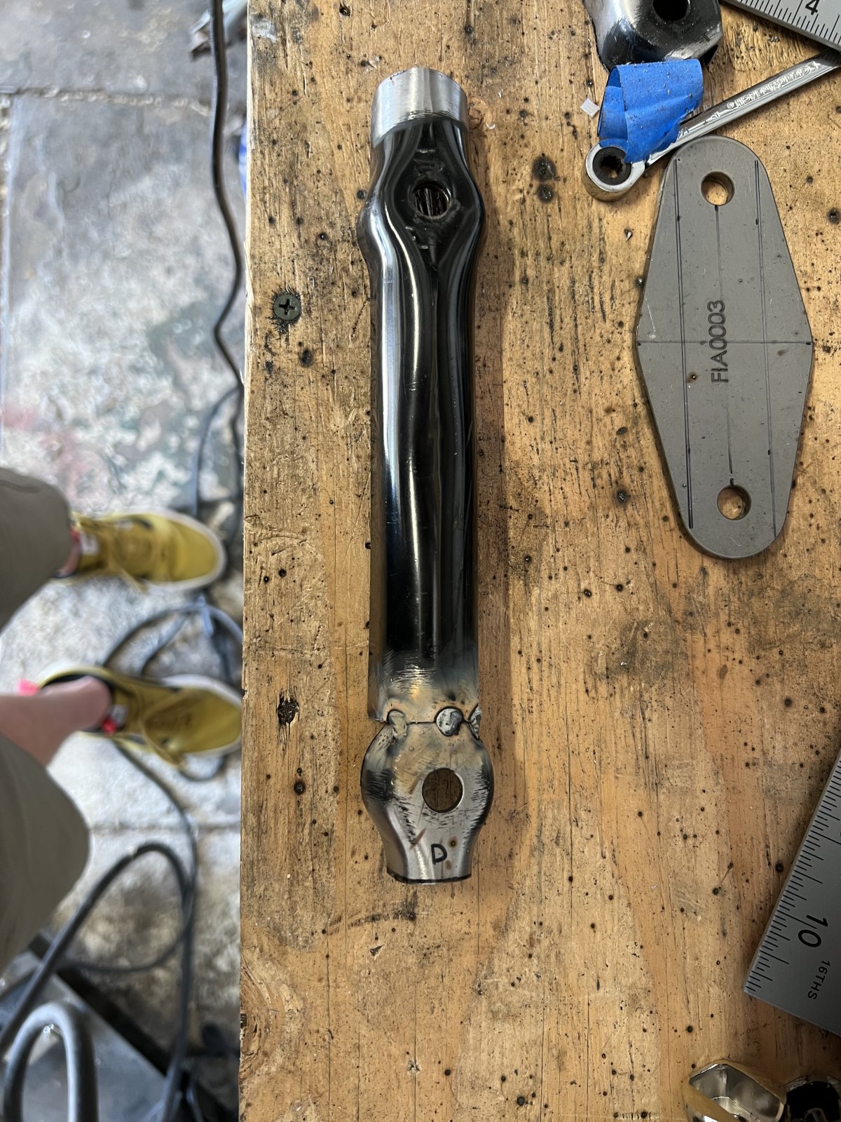

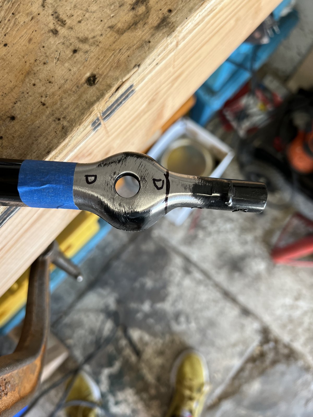

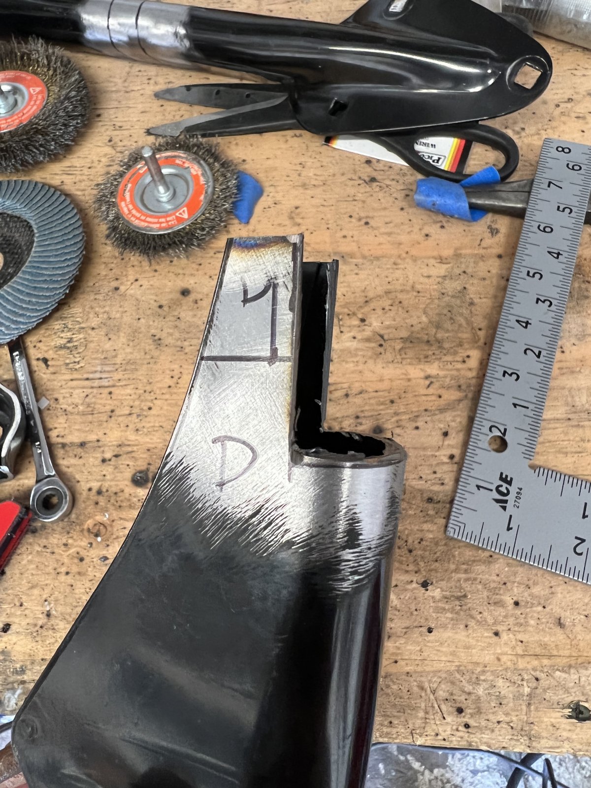

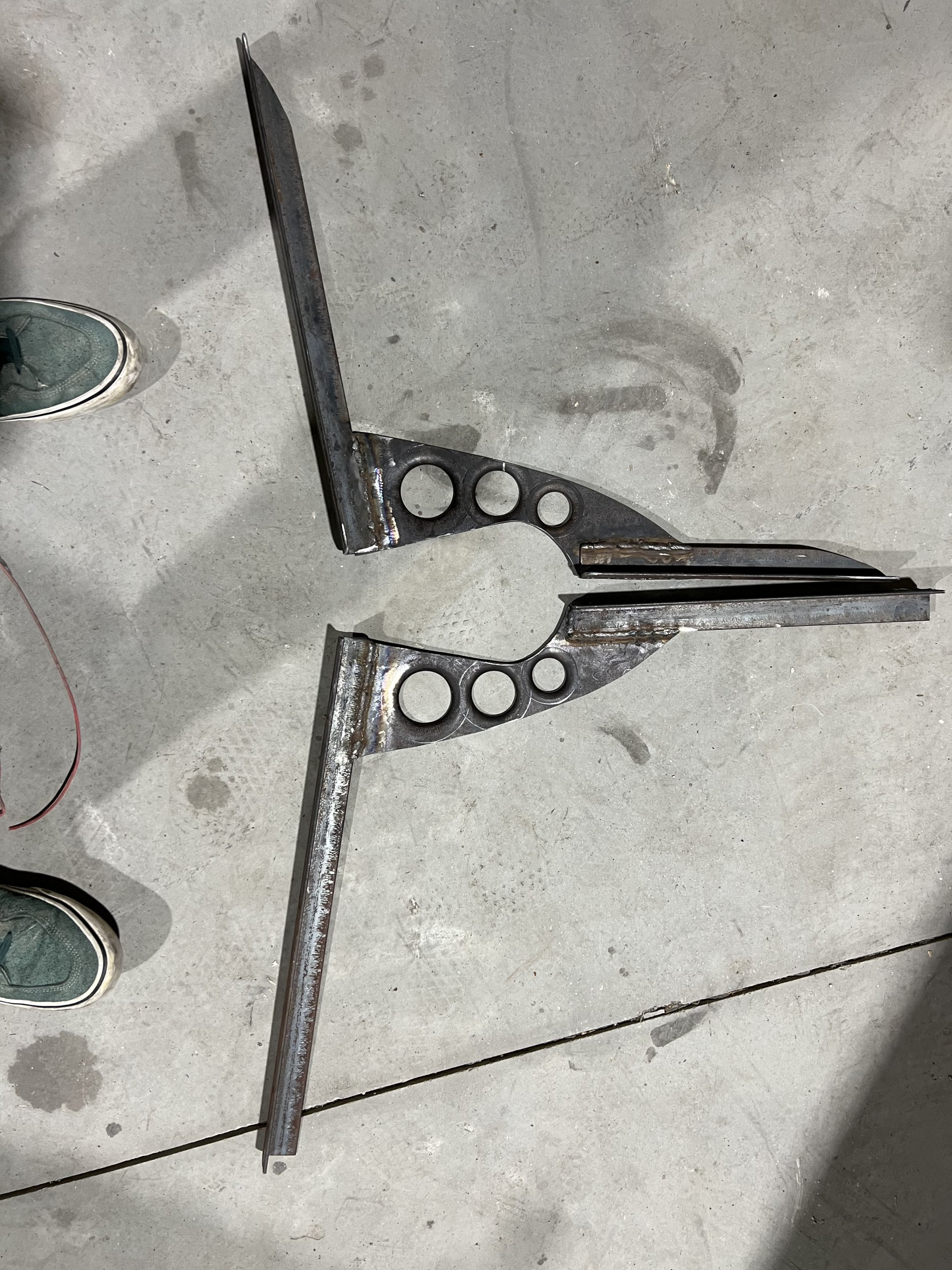

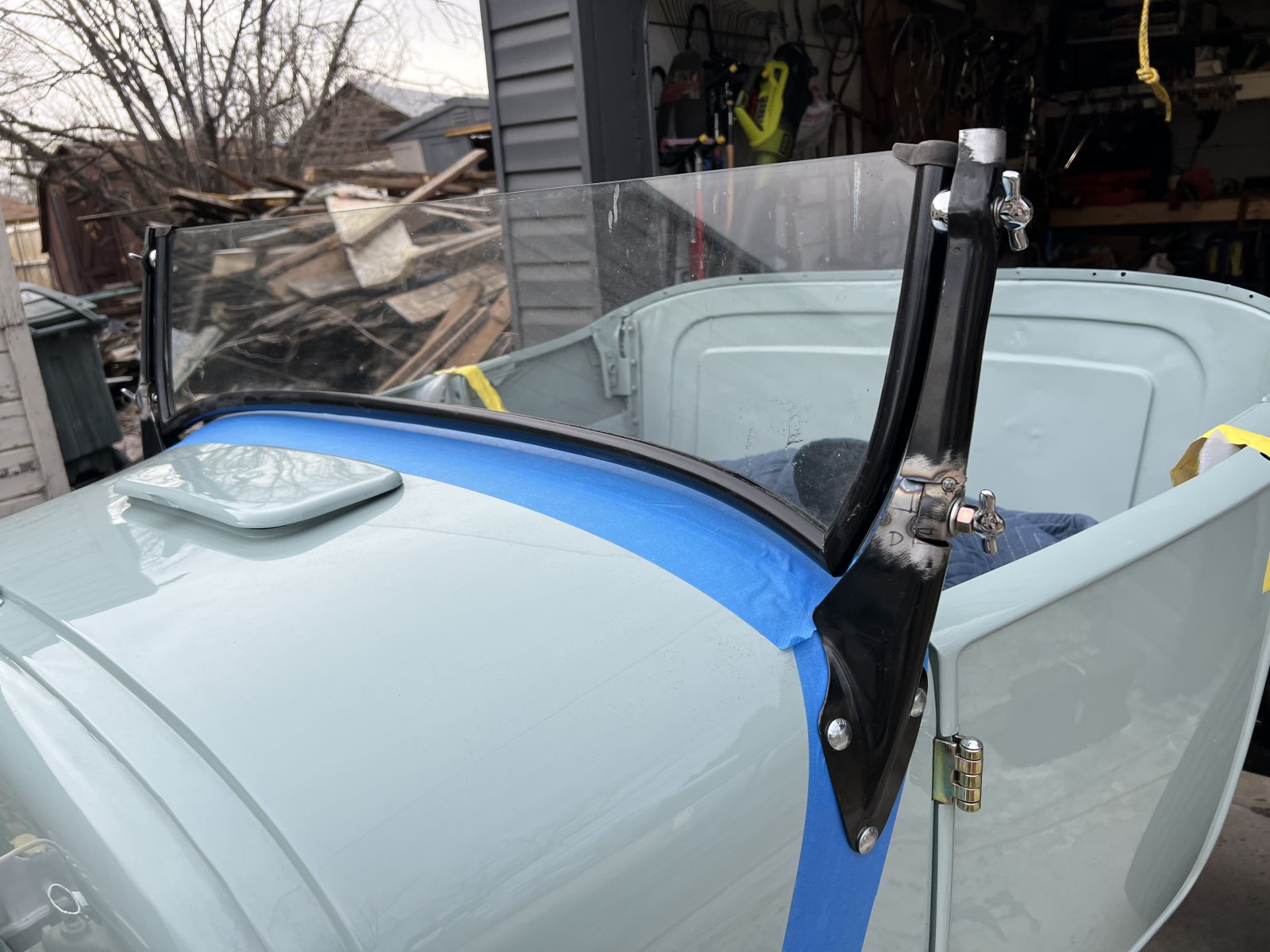

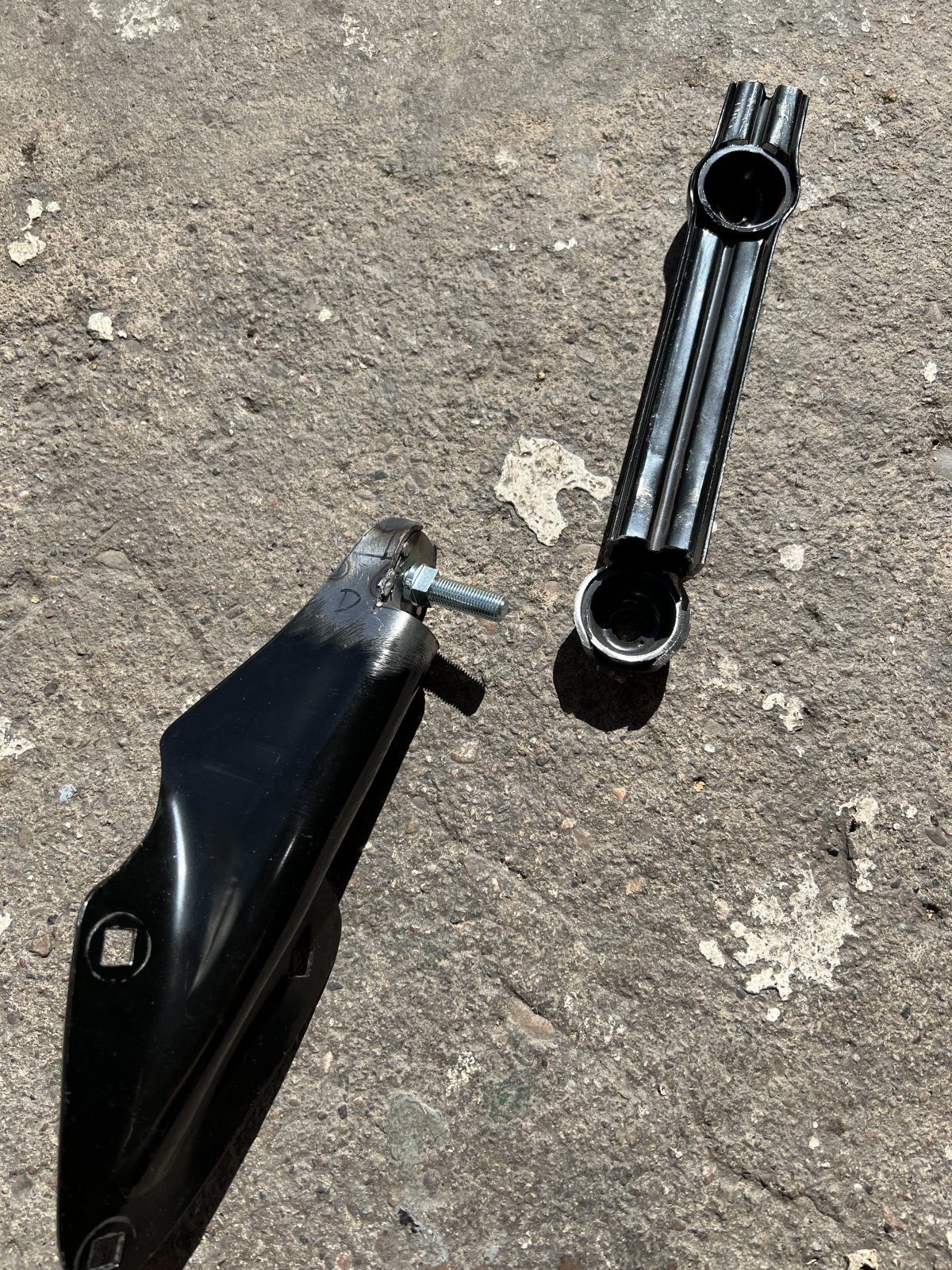

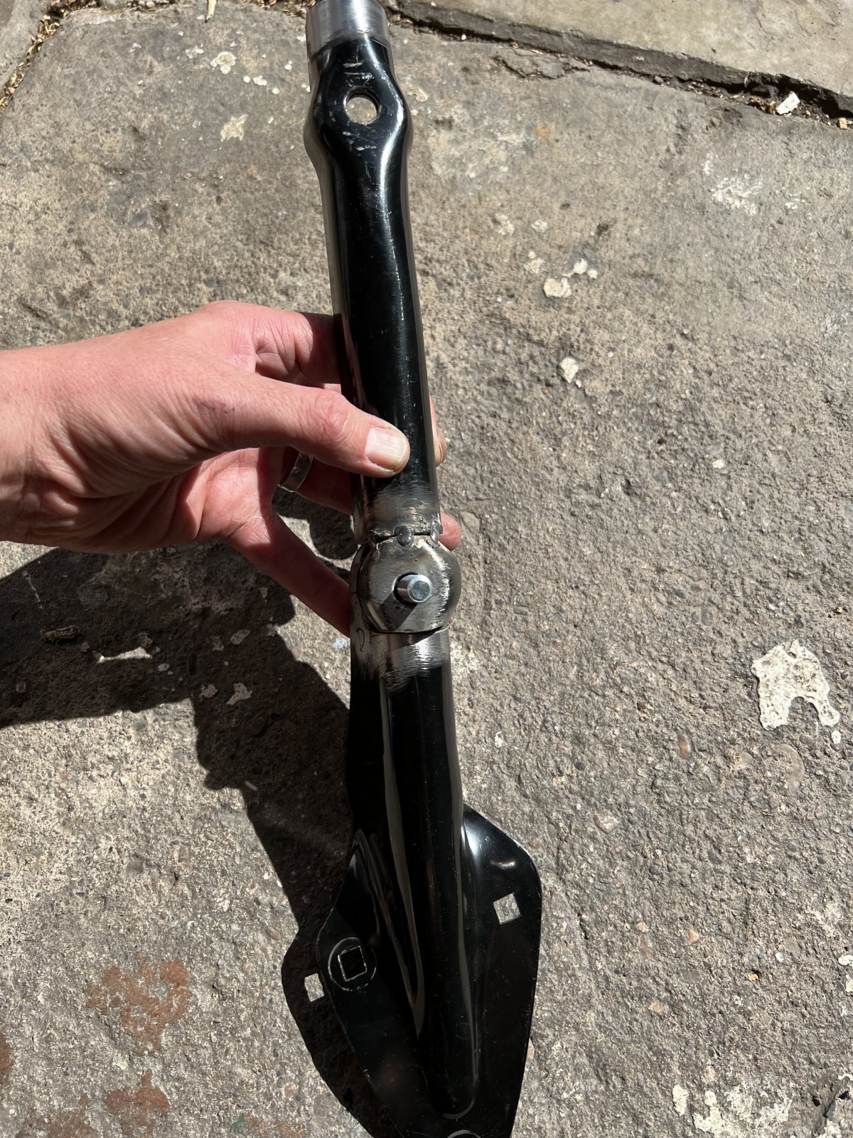

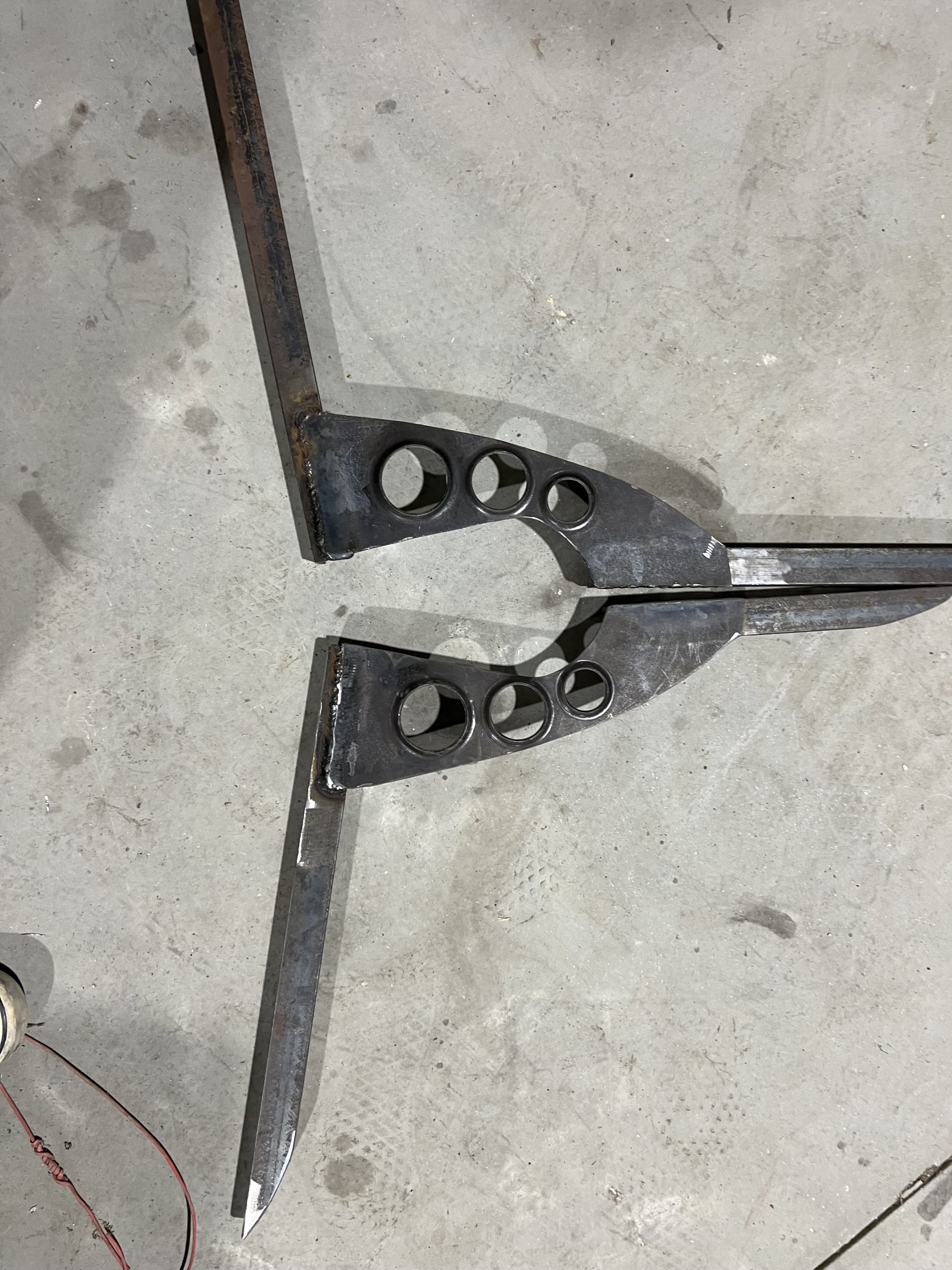

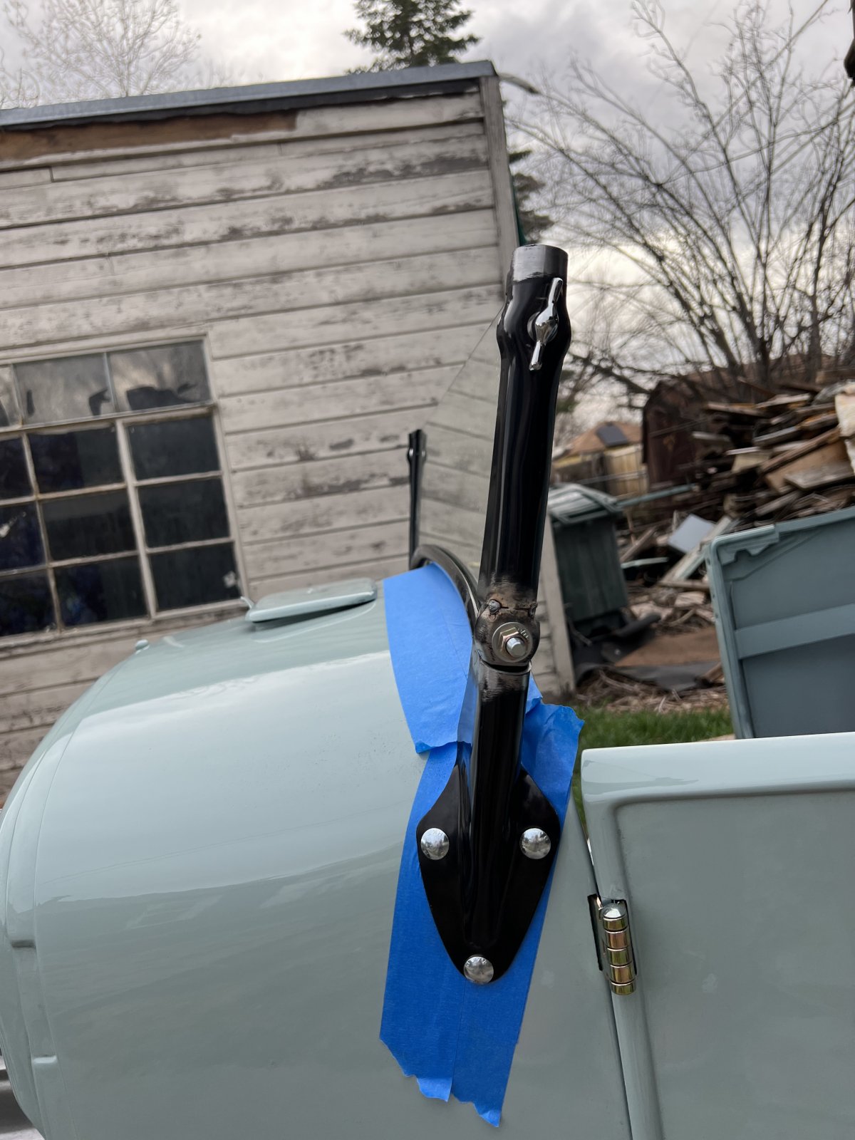

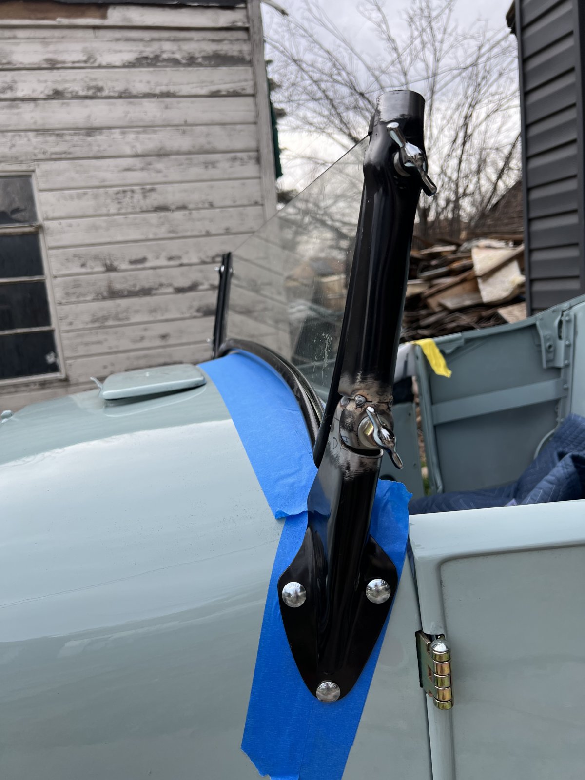

    Found this older thread and I couldn’t get over the leaned back windshields on the roadsters. I really liked the model a style ones that you could adjust. It got me thinking thus they would be awesome on my little roadster.
    https://www.jalopyjournal.com/forum...leaned-the-roadster-windshield-thread.700778/
    I found a few pictures of T’s with laid back windshield but on the 1926-27 they weren’t adjustable. I searched but couldn’t find any, so I decided to give it a try making my own.
    I started by using some string to decide where th think the pivot should go. I wanted it just above the cowl, so that the windshield frame wouldn’t hit when leaned back.
    I still had the pieces left over from when cut the aftermarket stanchions down, and planned to use them as the new pivot.
    I got the pivots cut out, and everything marked. Then I cut the stanchions, and tacked the pivot to the top portion.
    99F0814F-8102-4DF2-85B2-20E426548FE8.jpeg 10D915E5-60D2-43F2-8338-8CE0DD689F39.jpeg
    83746371-B118-4D3A-8DA5-FA0879D430CA.jpeg 8BF6DEDE-5788-4F3F-951C-9284DDC0EA6E.jpeg
    Figuring out where to notch the lower section was the most difficult part. It’s on a curve and the stanchions narrow towards the rear. If I didn’t get it close to strait the windshield wouldn’t pivot.
    Then I welded in a little piece for the lower stud.
    With that in and lot of grinding, tacking, and re tacking I got it together where it was working pretty good. 8EAFC910-B4F1-4D67-8A64-AF6027D386B0.jpeg 2ED86B13-92D5-49DF-BFF8-2193CEA51C8E.jpeg 6795897B-19DB-4491-8182-DF605FE06D6C.jpeg
    Tim, Shitbox and OFT like this.
  26. kram
    Posts: 124
    kram

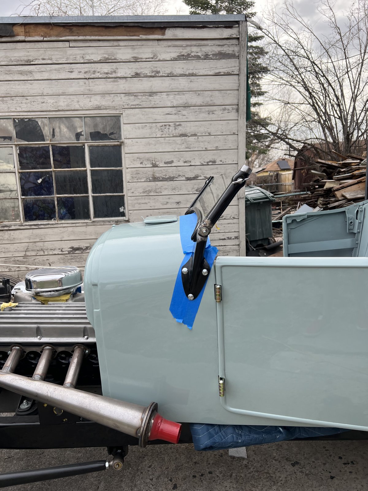

    Doing the other side was a lot faster. They still need to be finished off and some adjustments made. That being said they turned out better than I expected. 16D83F34-B338-4203-AFB7-8F1C14E97170.jpeg FCCFE0C1-6D4F-4DDA-91DA-DFD58B4E0B84.jpeg 4651D05D-2E8F-425C-84F2-35D2607591CA.jpeg 9A3ABF5E-CB76-4CB6-8918-C850FC4ED9DB.jpeg D44E2628-639C-4D88-AF39-7BE15FA6B91E.jpeg 5DCFEFAD-1D1C-4BF5-BFB7-821B8C4EEA61.jpeg

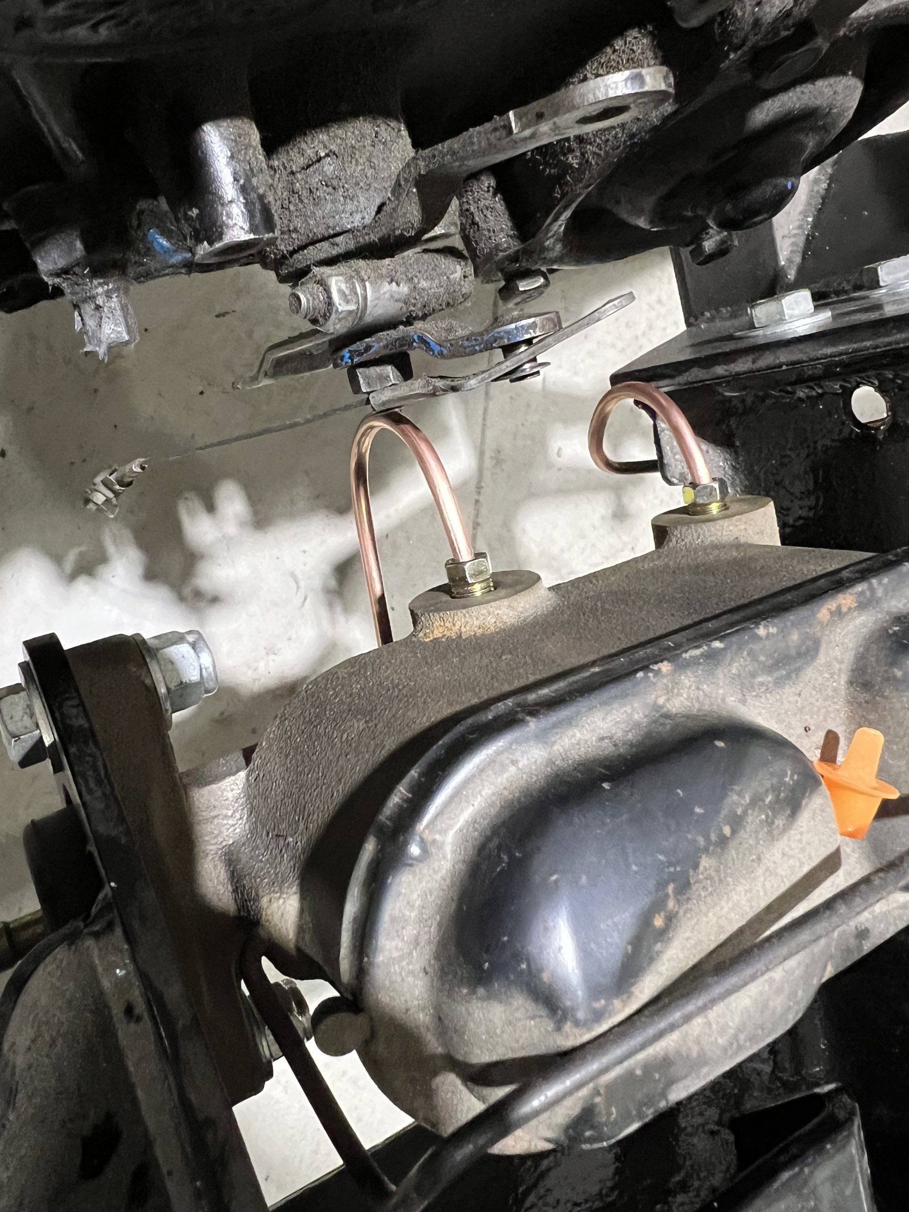

    Life, kid, and house projects are limiting my time to get this car finished, but I’m still slowly chipping away at it. I’ve been really bad at taking pictures. Here the few that I have:

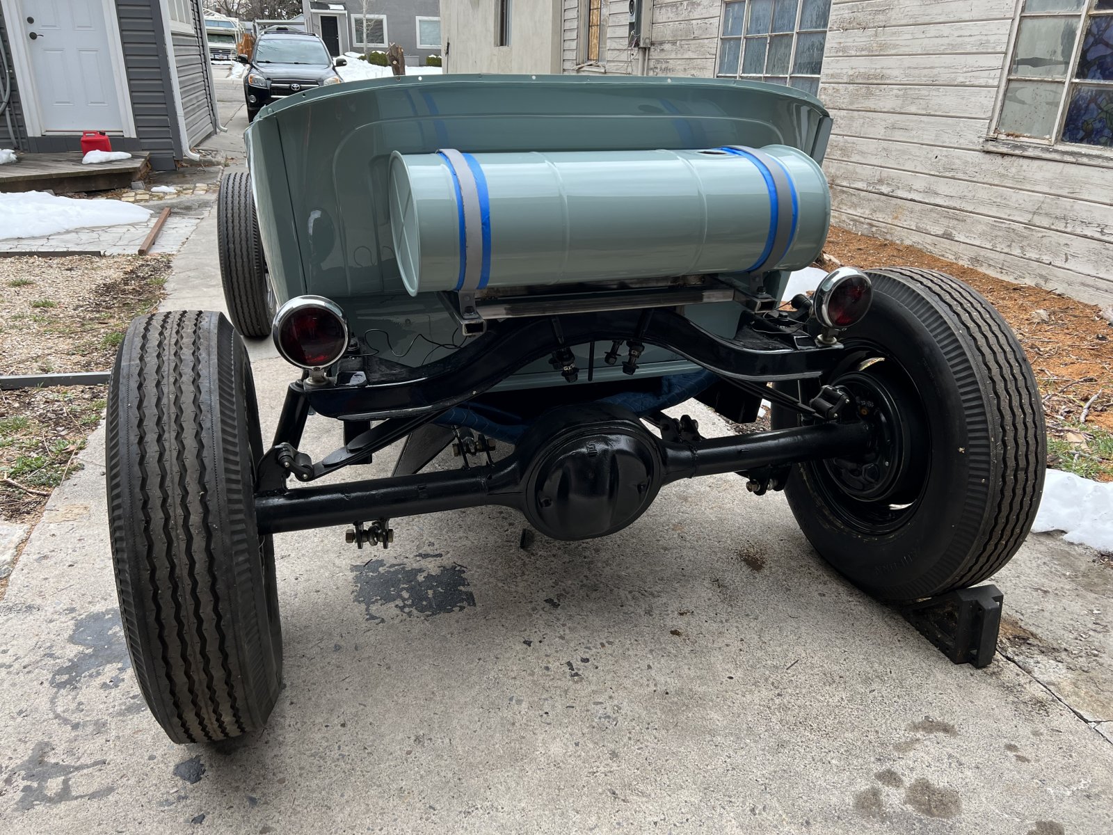

    I got the frame for the gas tank all finished up.

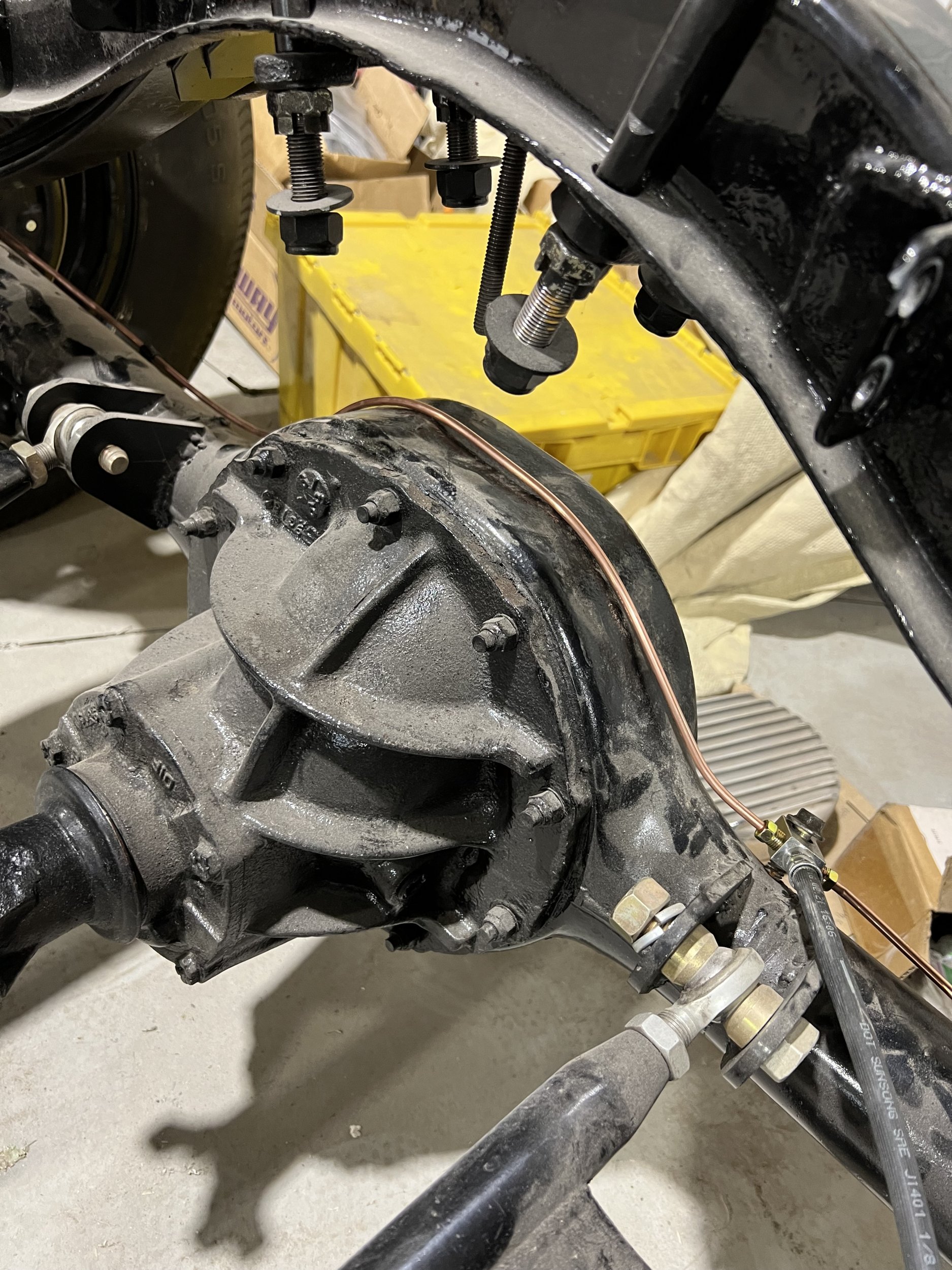

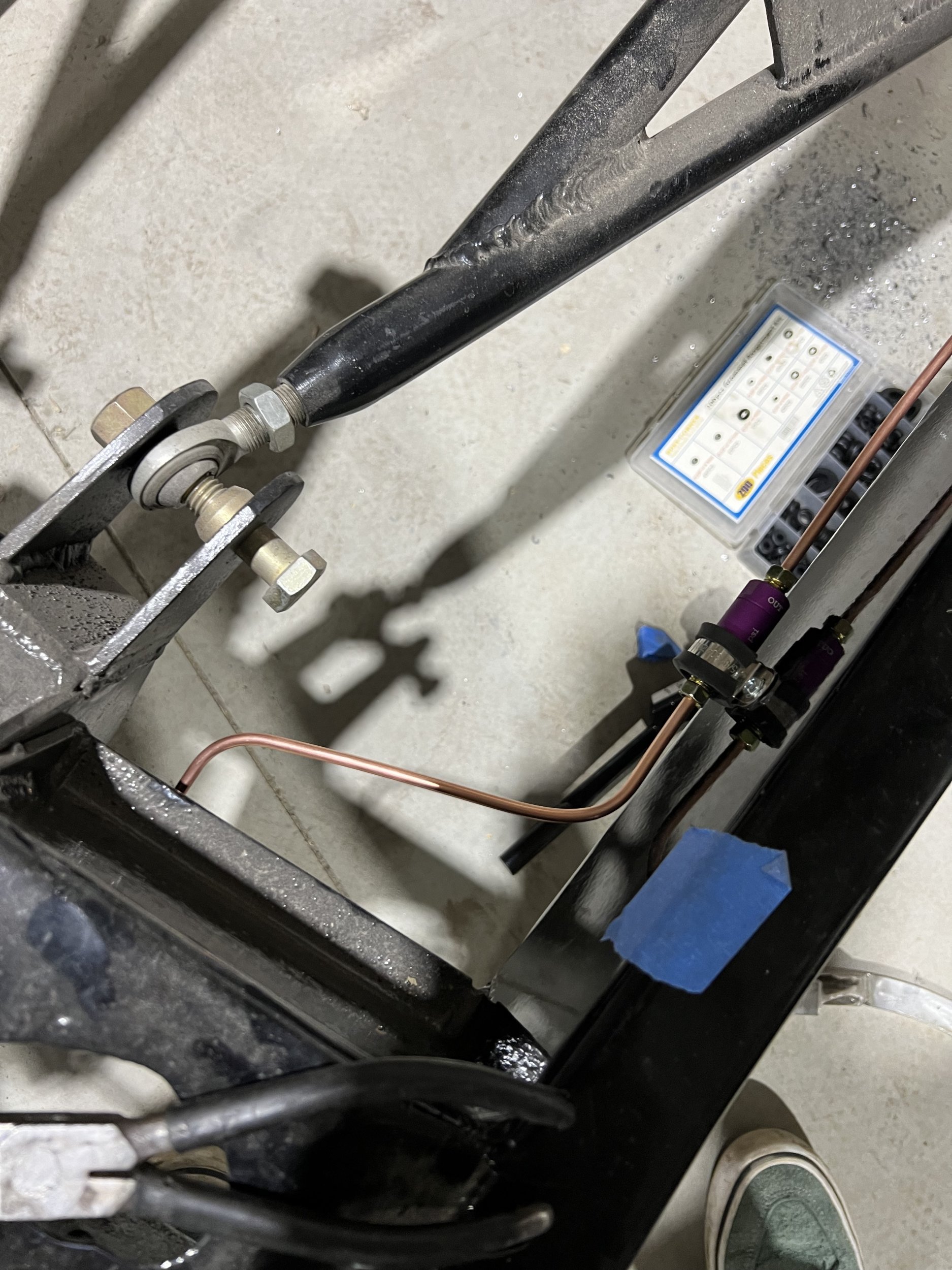

    Brake lines ran.

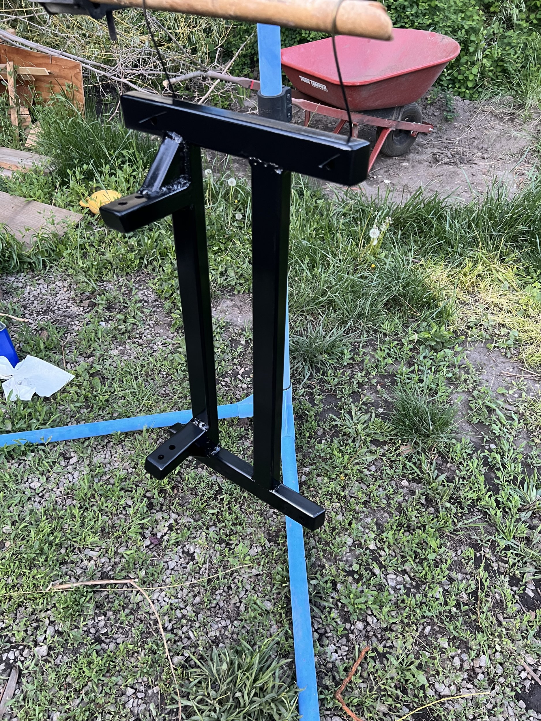

    I finishing up the seat brackets.
    I also got the modified windshield posts finished welded and cleaned up. I’ll take pictures when it warms up enough to paint them.
